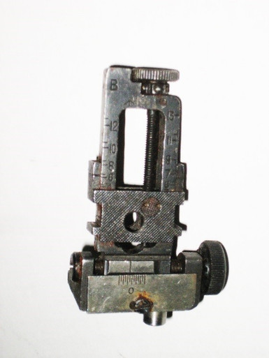

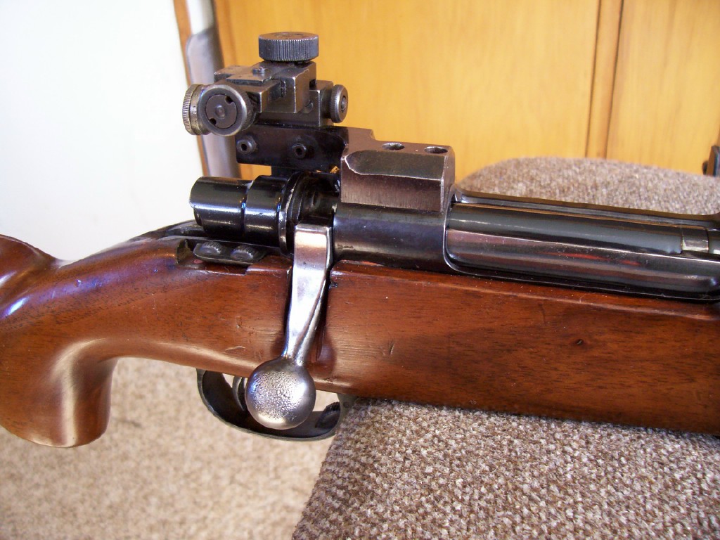

Sorry Sandwarrior but that’s a bit off the mark, The correct sight is a Parker Hale 5E .
The struggle will be finding the correct mount for it as most have the direct mount which screws into the rear action mount holes , whereas the M82 has a mount which attaches to the Parker hale rear scope mount (they used a 2 piece mount system) .

The Parker Hale PH5E is the correct sight,but the mounting bracket for the M82 has a thumbwheel clamp to clamp over the rear sight block.

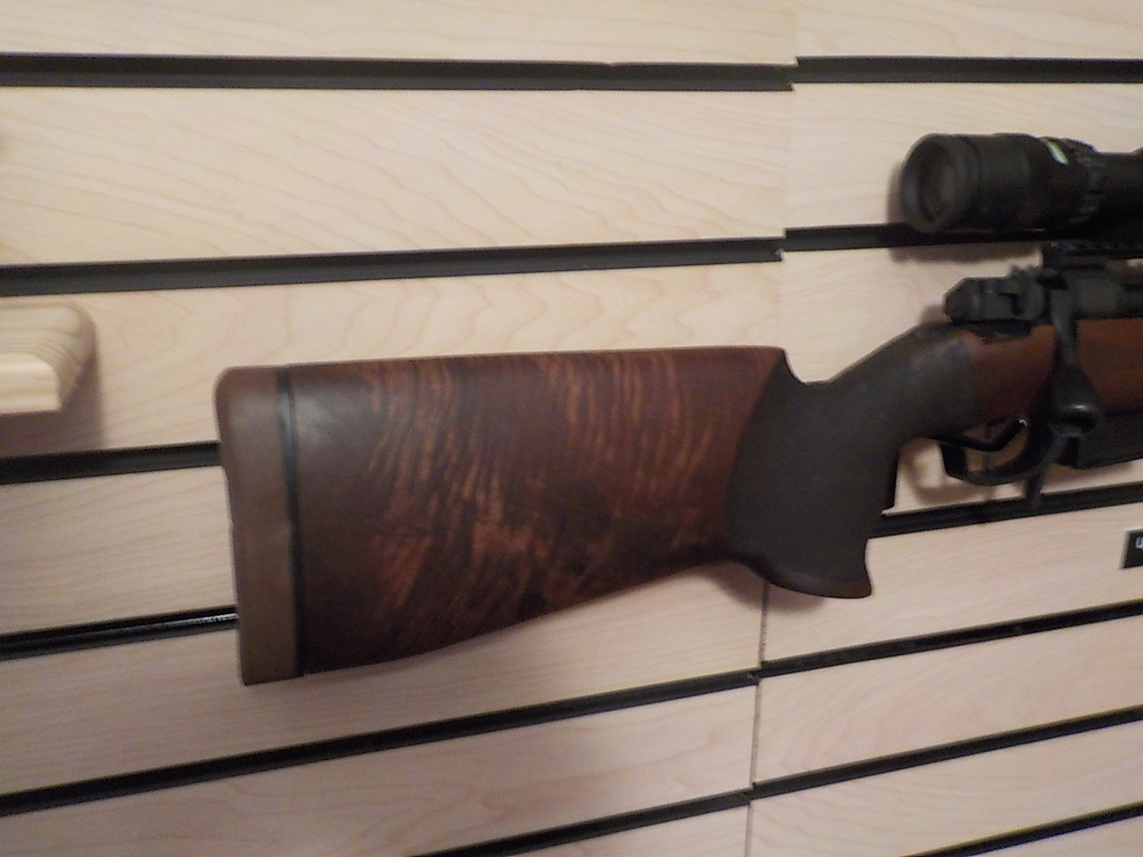

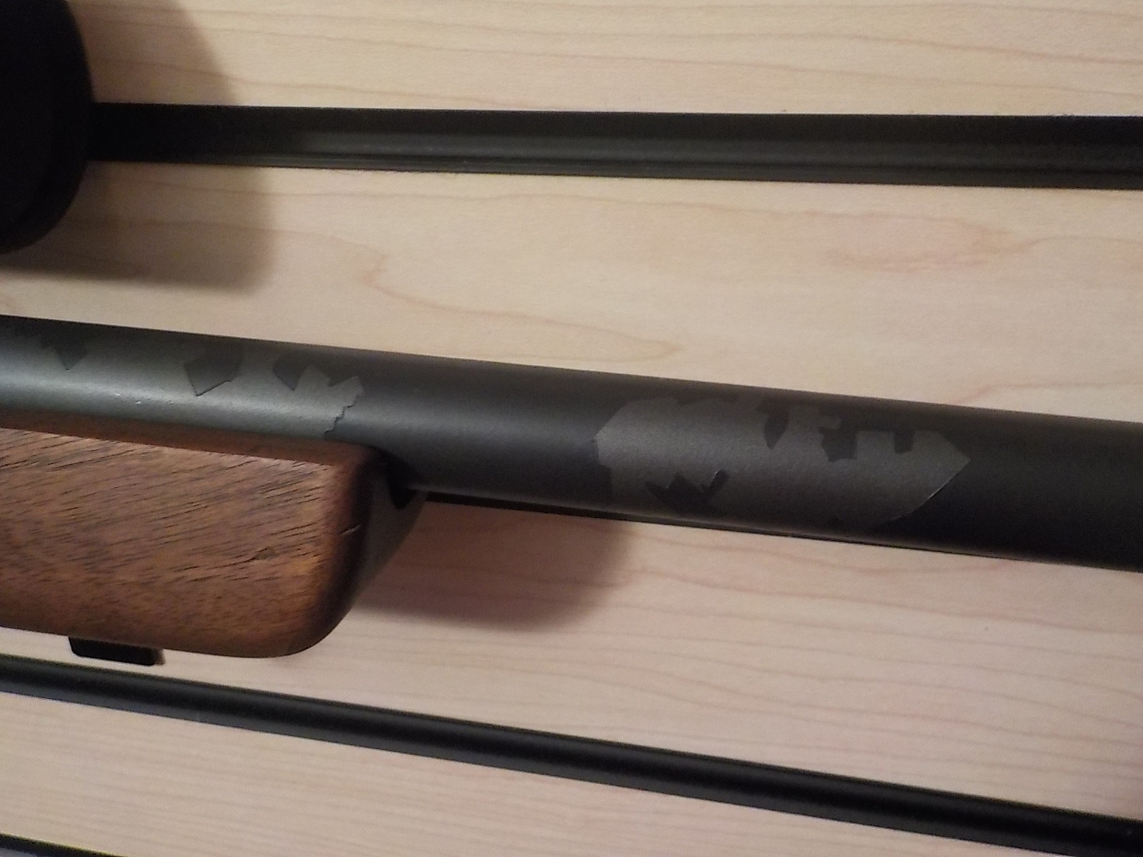

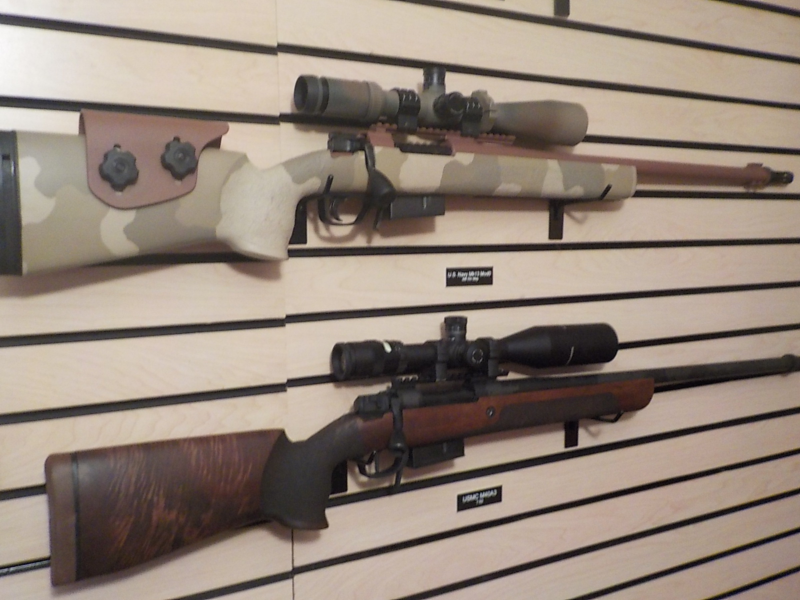

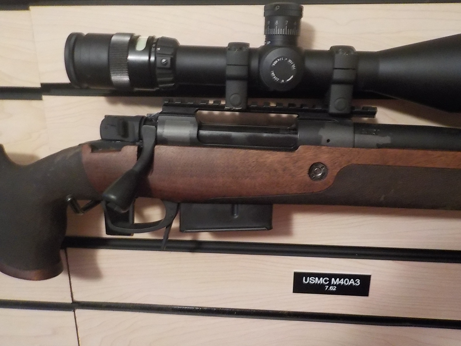

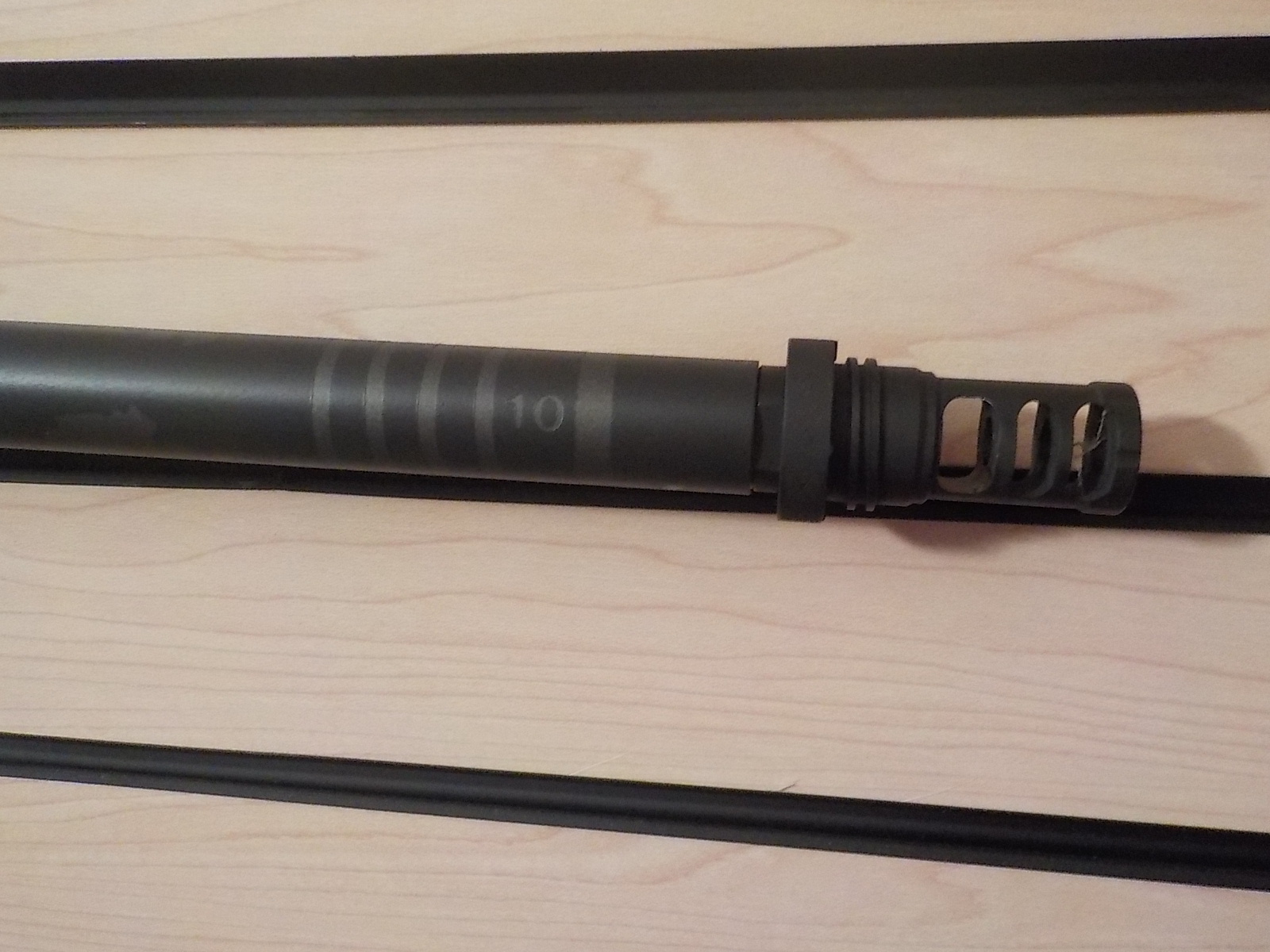

Here are some "sort of, kind of" m85/C3a1 clones. The desert camo Mcmillan stocked M85 is based on a Parker Hale 1200 action with a Douglas Premium Match Grade stainless barrel. It has been modified with a R700 DBM that takes AI magazines. It has been pillar bedded and has a Kydex adjustable cheek piece and Anschutz rail. It has a NEC single set trigger and large bolt knob. It has a YHM QD Flash Hider to accept a suppressor. It has a PH front sight and picatinny rail. This guns shoots under .5 MOA . Custom Cerakote.
I picked up a beautiful surplus PH walnut stock so had to build another gun around it. It has a Dumoulin Mauser action with large bolt knob and Douglas Premium Match Grade stainless barrel. It has a YHM QD brake to accept a suppressor. You can really notice the recoil difference between the YHM brake and the YHM flash hider. This gun also has a Rem 700 DBM for AI mags. It is pillar bedded and has an Anschutz rail. It has a Timney trigger I fished out of spare parts and I think that accounts for its relatively poor .64 MOA groups. I am waiting on a NEC single set trigger. Of course it has only 50 rds through it. Custom camo cerakote in Graphite black and Titanium. I watched too much history channel and put some "kill rings" on the muzzle like the German Panzers had.
I built both of these guns. Barrel install by LRI, everything else by me. Ignore the tags for the M40, etc. I put these up on the wall to take pics.

That's correct. The sight on the L39A1 'Enforcer' is 7.62 Calibrated Parker Hale 5E/4. The M82 used the Mauser Action mounted 5E. The No.4 .303 used the 5C and the P14 the 5A and SMLE 5B.

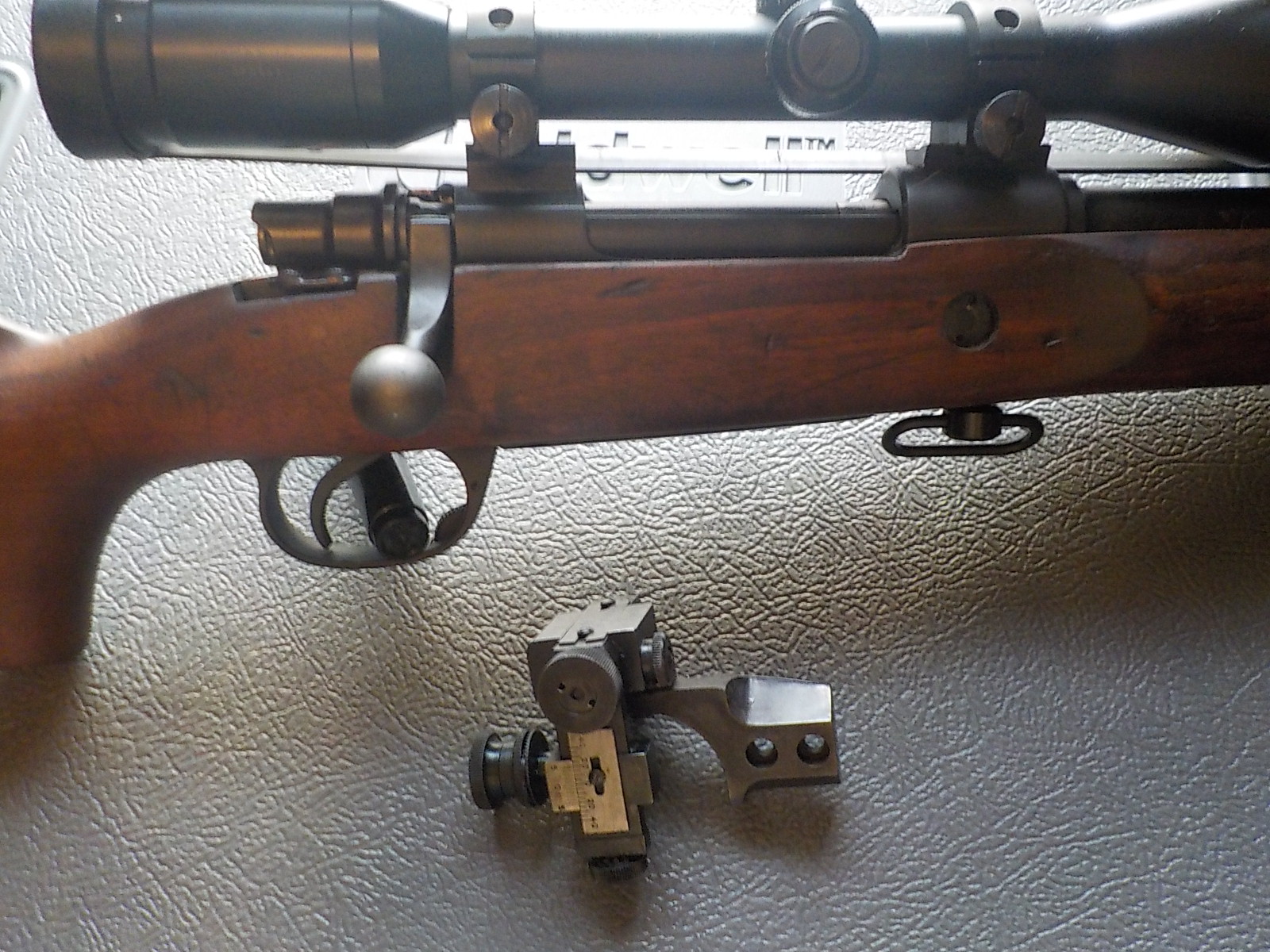

M82 replica based on a magazine fed PH TX1200. PH rings RAL drilled out to 26mm. Instead of a Kahles 6x42 ZF69 scope I (eventually) , after an era Kahles 3-9X42 mounted a Swarovski 6x42 Nova.

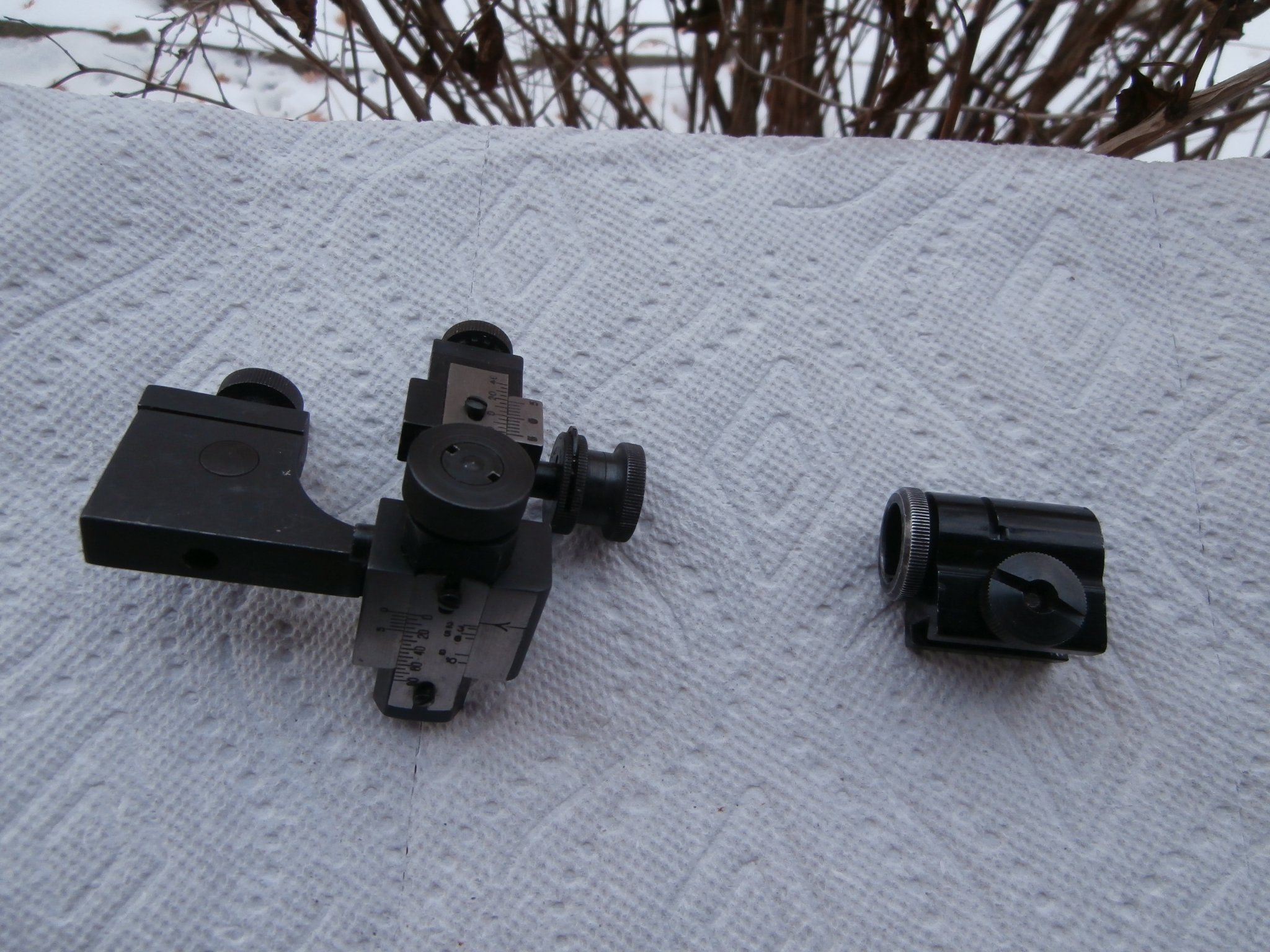

The iron competition sights are unique to C3. The rear sight is a Parker Hale 5E with a very rare mounting base. Front is a Parker Hale S159. These will only mount to the steel scope bases provided not the commerical aluminum bases. The globe sight uses a .500" high front mount - again not common. These when not in use were kept in the scope case.
The sights I'm seeing in previous threads are for the Parker Hale 1200 TX - not correct for C3.
