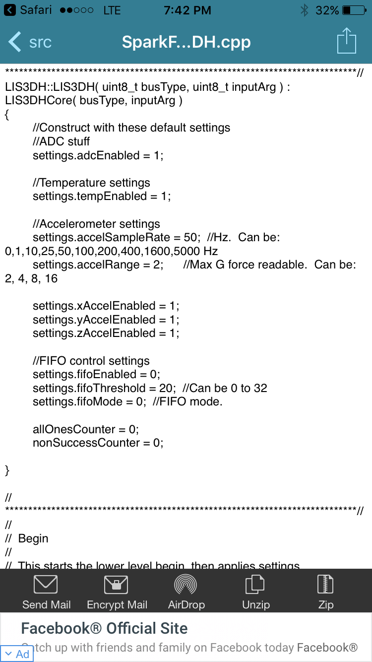

I did some reading on SPI, essentially you slave the breakout by setting a pin low that you designate and then connect the other 3 wires to the same 3 pins (think it is clock, master in slave out, master out slave in) the feather has dedicated pins for these 3. It shouldn't be an issue to use SPI for the accelerometer and the I2C for the rtc/sd. I think i am just going to order the same stuff you have that way I can also help.
Reactions: ammolytics
I am looking into the standard config file it appears that you can set the refresh rate.
Might need to change it. Should be able to do it the same way you change the change the range of output.
I believe you're viewing the code from Sparkfun. They sell the sensor on a breakout board too, but their code is different from the one I'm using which is from Adafruit.
I believe I am looking at the source code for the library that works in the back end to give you your sensor values based on the commands you are giving (read acceleration method call etc). Yes it is the sparkfun source but I would bet the code for the adafruit sensor is pretty close. I didn't find the library source for the adafruit sensor.
The Adafruit LIS3DH source code is here:
https://github.com/adafruit/Adafruit_LIS3DH
There are similarities -- the data rate can be set with this function:
https://github.com/adafruit/Adafruit_LIS3DH/blob/master/Adafruit_LIS3DH.h#L128
I wish it were as simple as changing the settings though. As the GitHub commenter pointed out, this only changes the frequency at which the sensor updates its values. The current performance limitation I'm hitting is how quickly I can get the Arduino/Feather to run it's loop.
Running almost no code within the loop, the fastest I can get the Arduino to run is just under 3kHz.
Also, there may be a minor bug in the Adafruit code which is preventing it from running at 5kHz:
https://github.com/adafruit/Adafruit_LIS3DH/issues/14
Anyway, I highly recommend creating a GitHub account -- it's definitely a better place for this type of detailed technical discussion & for making contributions!

I suppose I'll make an account on github, but at 3khz you have to be able to get way more data than you were at the 100hz orignally, even if you have to post process the data.

I picked up the boards you recommended, but will put in a push button inline before the boards for power, and also a rechargeable CR123 battery tray for power. Will post up pics when it is together. also plan on attaching a pic rail adapter to the box holding the electronics for easy removal and moving it between rifles.
