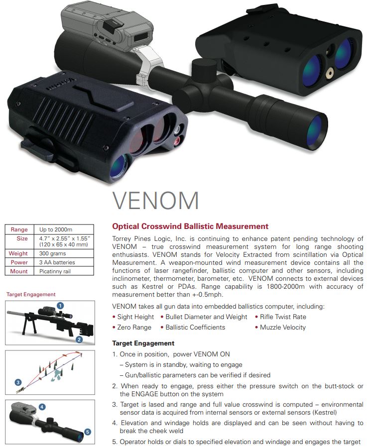

    I brought this up before in another forum. Torrey Pines Venom
    "Torrey Pines Venom does everything. It CALCULATES WIND AT MULTIPLE POINTS DOWNRANGE using Velocity Extracted from scintillation via Optical Measurement. I can't find any more info on this thing. Does anyone know anything about this?
    VENOM stands for Velocity Extracted from scintillation via Optical Measurement. A weapon-mounted wind measurement device contains all the functions of laser rangefinder, ballistic computer and other sensors, including inclinometer, thermometer, barometer, etc. VENOM connects to external devices such as Kestrel or PDAs. Range capability is 1800-2000m with accuracy of measurement better than +-0.5mph.
    venom-jpg.6906348
    Hi,
    @B4Maz
    I do not think anyone has even seen that unit in the wild......only on display at exhibitions.
    I do know that TPL gave us reason after reason of why they could not demo that unit at KASOTC or IDEX even though we had entities ready to make immediate wire transfers upon successful demonstrations.
    Sincerely,
    Theis
