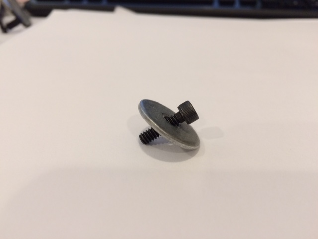

Update:
I went to the hardware and got a bolt and washer to disassemble the bolt and thoroughly cleaned it.
It didn’t appear to have grease on the spring but I cleaned it all anyhow and reassembled.
At Bohems request I loaded some brass with primers in my press instead of my hand tool. I also loaded some with my hand too just to be sure.
I did ten of each again and the primers went off every time. This was inside my house in my work room so not cold at all.
The primers fired with the press and the hand primed brass.
I imagine cleaning the bolt assembly was the key? Idk. I guess I’ll be priming on a press for a while to be sure though.

What size screw and washer did you use? I couldn't find the screw and washer in the box of my Hancock either.

6-32 x 1/2" allen head cap screw with a fender washer 3/4" OD.
It is in the small box where the paperwork and bolt were packaged, tucked in with all the spare parts that come for the KRG Bravo stock.
If you can't find it then send me a PM and we can send a replacement.
6-32 x 1/2" allen head cap screw with a fender washer 3/4" OD.View attachment 7032896
Thank you sir.
I will check again, possibly it fell on tge floor when I was going through the bags. No need for a replacement, I will pick one up at the hardware store. You have enough on your plate right now, without having to worry about a screw and washer.
