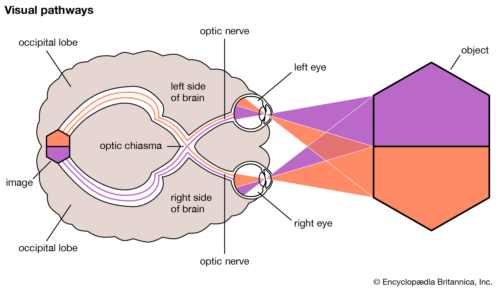

I wonder if each eye interacts with the half of the brain its in front of differently. in other words if we can process what we see better if both eyes/ both halves of our brain are involved.
Actually that's 100% how the brain works, which isn't something i've thought of applying to this. Read about this "split brain" stuff when you get the chance. Tl:dr, each human brain is two brains and each eye goes to one of the brains. If you see something with your left brain's eye but that info needs to feed a right brain activity, it has to travel through the middle connective thing. The experiment noted that if the middle connective thing was cut, each brain turned into it's own separate mini-brain. IE the right brain's eye could only feed info to right brain activities.
That being said, I think most of us have good middle connective thing and this shouldn't affect much. https://en.wikipedia.org/wiki/Split-brain

It's the corpus callosum (iirc), and yes each eye feeds each hemisphere. That being said, one eye can feed data to the other hemisphere, but it is fragmented/blurry and ends up being used for spatial awareness. At least that's how it felt when they shut off the blood to the right side of my brain (carotid occlusion test is what I think they called it). It hurts/throbs like hell, but if you're one of the 10-15% of the population that can live with only one carotid, you can sense the rerouting of your sight, as well as the tunnel vision in that eye, from the dilation of blood vessels as blood is routed to the hemisphere that is being deprived of blood. It's a screaming headache while they perform the test (1 1/2 minutes with the carotid blocked), and you have to answer a bunch of questions and math problems, but the brain definitely adjusts, even if it is at a reduced rate (IIRC, they said if the carotid was inadvertently cut on me, I'd likely only regain "86%" functionality of my brain. Not sure how, where or why they had such an exact percentage, but there you have it).
The brain is an amazingly adaptable thing when you think about it (no pun intended). Lol. Just happy they didn't damage mine during the surgeries (two of the four, which you had to be awake for, as the poked around).
Each brain hemisphere sees both eyes.
