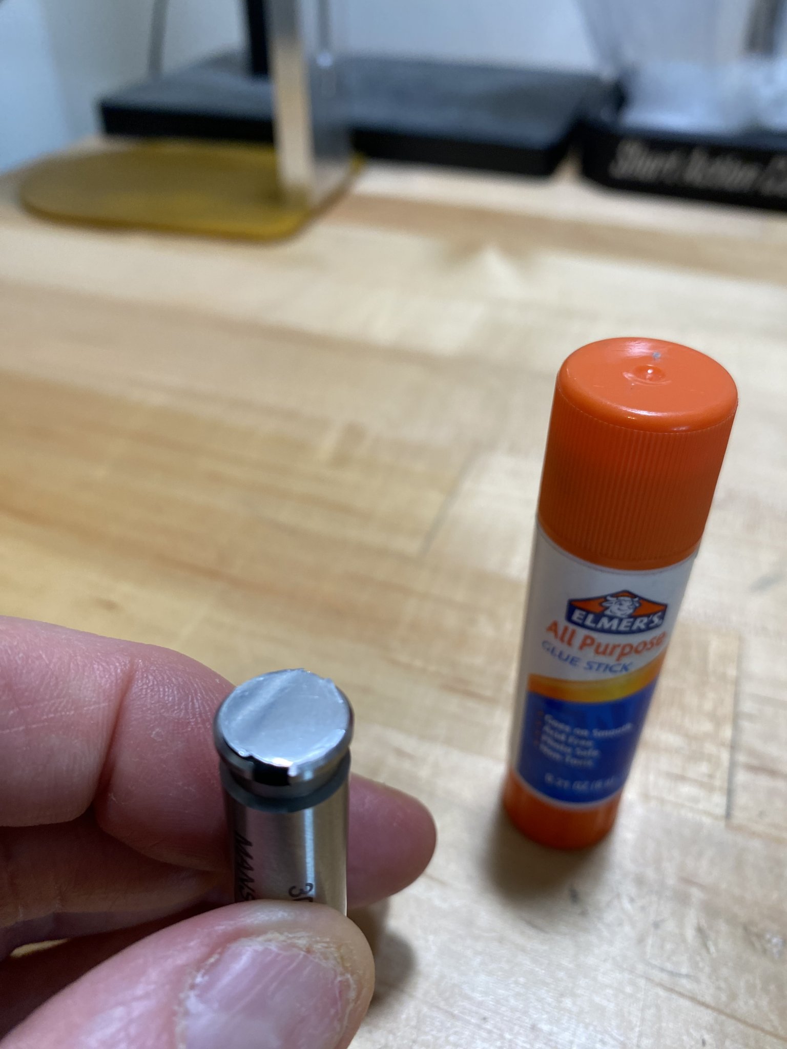

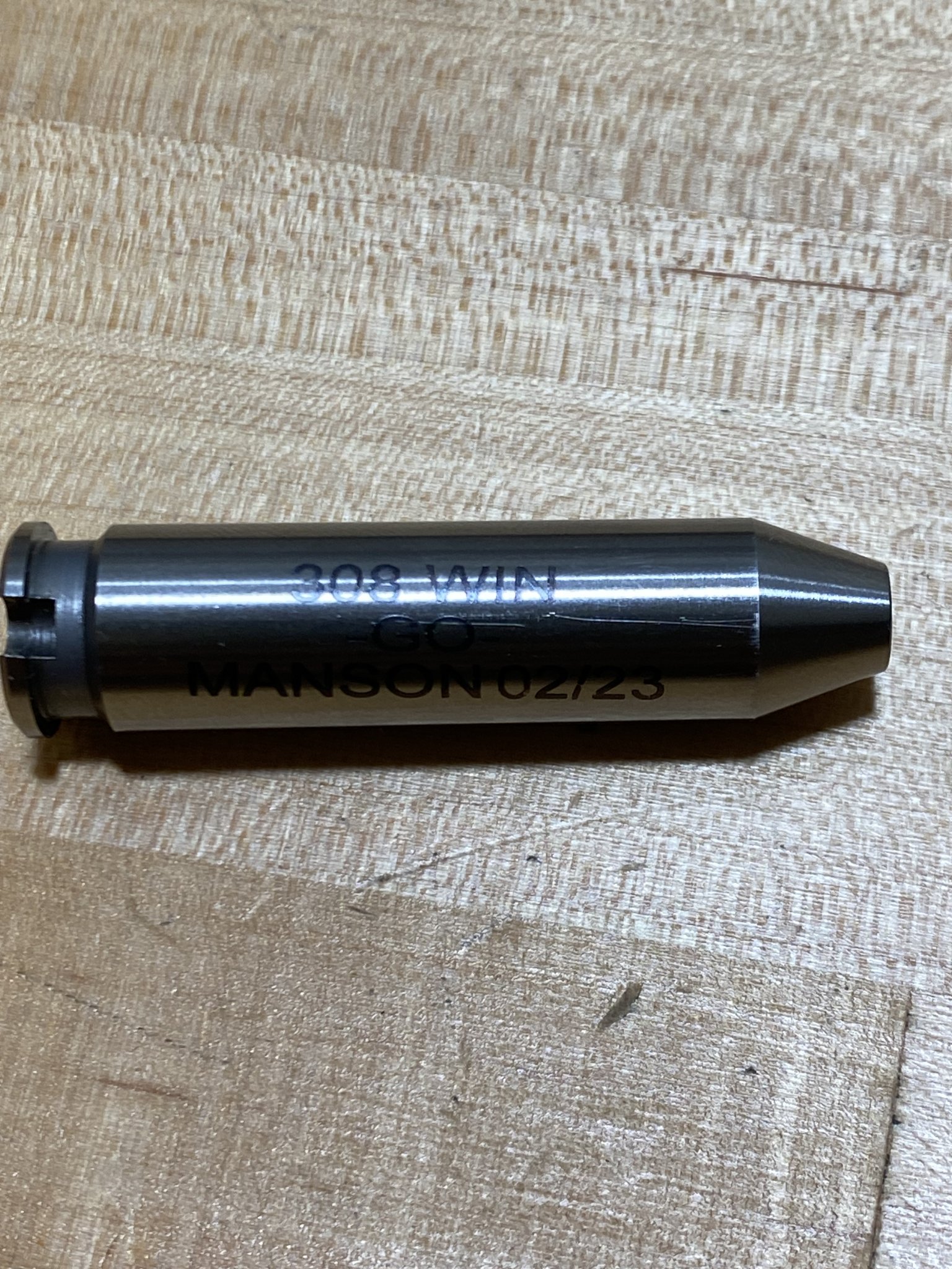

    Can you elaborate on the aluminum foil method? What did you mean by "aluminum foil on end"? Thx.
    Sorry my explanation was not very good. I have a Manson 308 go-gauge that is 1.630” base-to-shoulder datum. It chambers in one of my FTR rifles with easy bolt closure. I stick a piece of normal aluminum foil (measured at 0.00045”) on the base end of the gauge and it is difficult to close bolt (reg foil is about .0004 - .0006” and ” and heavy foil is right at .0008”). So I enter my rifle headspace at 1.6305 in my log book. Remember this is a comparative number. While I trust the Manson gauge accuracy, it may be off a bit but as long as I index my case-shoulder setback on this specific gauge I’m ok. When I’m sizing brass, I set my die to set the case-shoulder 1/2 thousand less than the go-gauge. That gives me a 0.001” case-shoulder clearance to the chamber on fire-formed brass.
