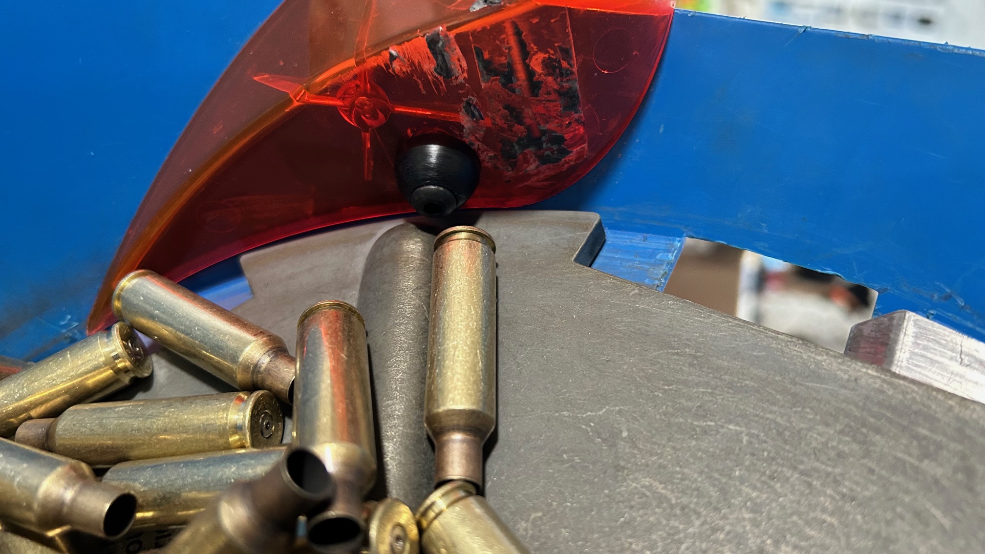

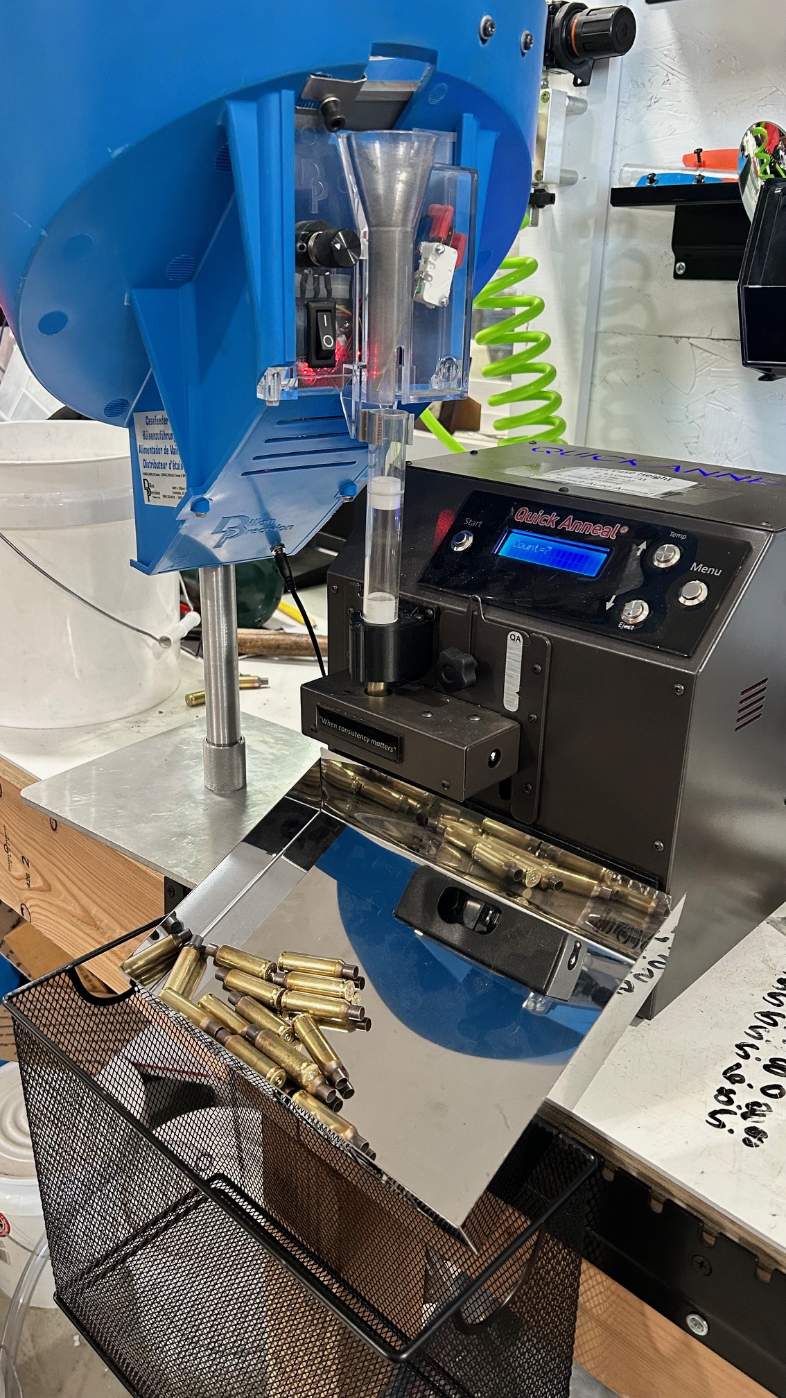

I've spent the last week working out some bugs in the feeding of the Quick Anneal.
First, the Dillon will drop two cases regularly at the slow speed required for the QA. If it drops a case before the first one is annealed the second will sit on top and both will drop from the annealer when the first case is annealed. It will also heat up the case head of the one on top.
This is like the 7th revision of what I did to keep it from dropping two cases.
Second, if the cases fall too hard on the platten you'll eventually get an error about a stuck case. So, you've got to slow down the cases falling from the feeder. If you use the flexible tubing QA shows in their video this isn't as much of a problem because the bends in the tube slow down the case. Their 3d printed insert has an ID too small for a PRC case I decided to use hard tubing and machined a couple baffles ~.005" ID larger than a fired Creed case. I added two baffles with a 'tilt' in the middle to stop completely the intermittent error. I also cut 1.5" off the length of my Dillon stand so that I could lower the feeder to further reduce the amount of drop.
I needed to move the annealer back on the bench so I could get the feeder in front of the unit since I removed 1.5" height from the Dillon stand. So, I bent the steel plate they provided and velcroed it to the unit to catch cases before they fall in the larger container hanging off the Inline Fab rail. This also gives you a better chance of finding a case that's outside the deviation of the others. Incidentally, I had a couple that were 4% more than the others. I let them cool and ran them again and they were right in line with the others. I need to do more testing to see how accurate that whole thing its.
None of the above would have been easy without a lathe and mill.

I'm not running the slowest speed. You'll need to set speed based on how many cases are in the feeder. The more in the feeder the higher the speed setting. As the volume of cases in the feeder dwindles the speed will increase. So, it's a balancing act. You'll also have to pay attention to how many cases drop at a time.

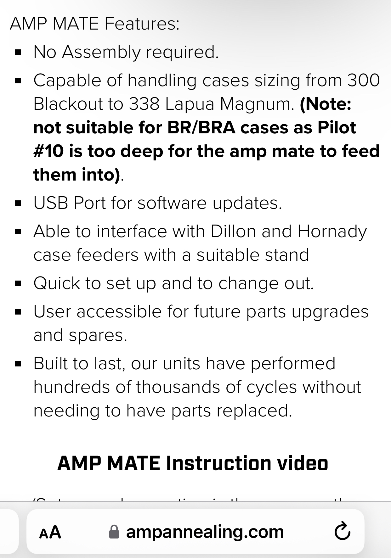

I have no experience with the amp mate. I just took the info off their website. I have a feeling AMP will be coming out with a new version soon.

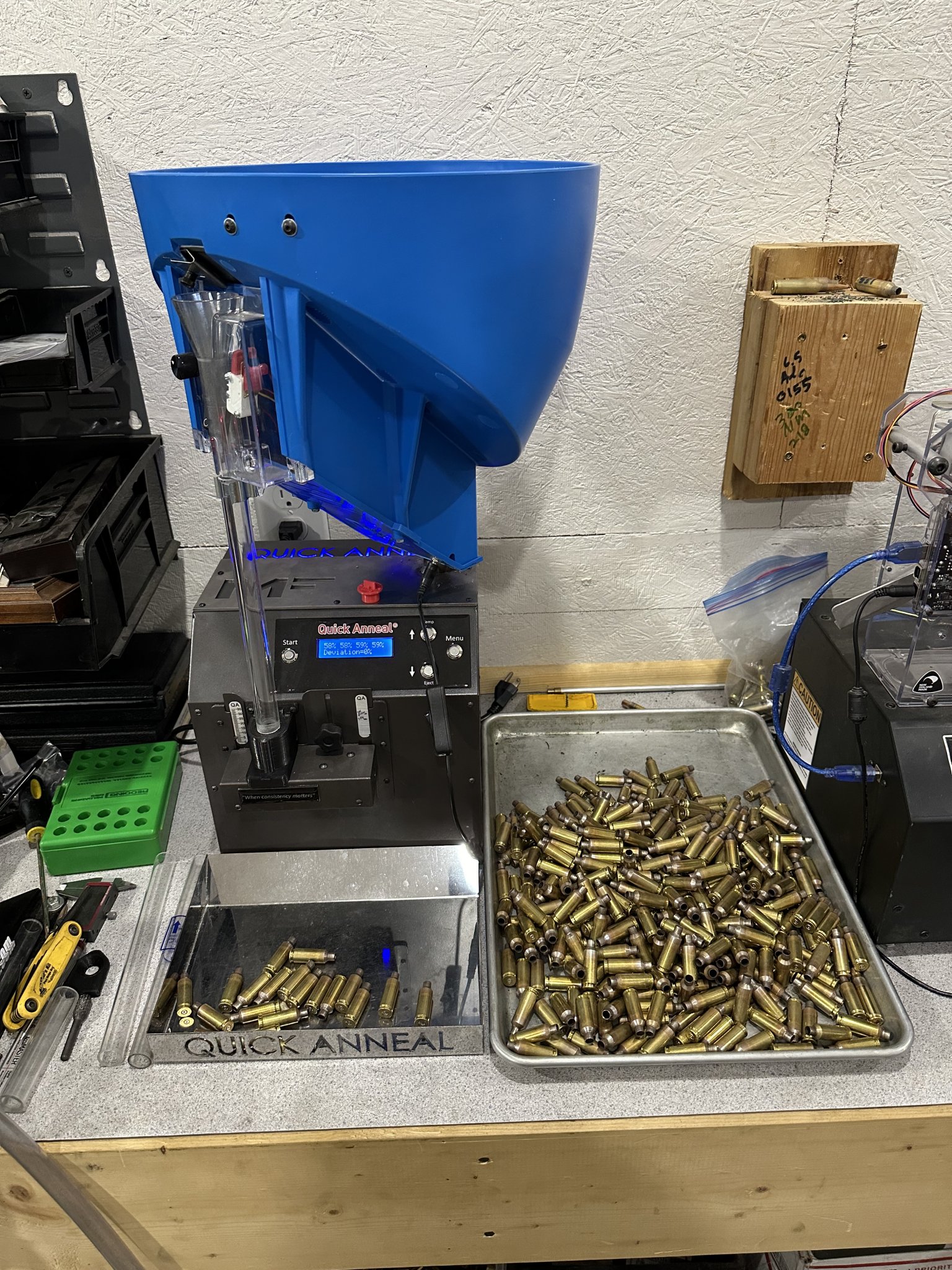

Got mine in and got the case feeder doing its thing. You’re definitely right though about the speed and it accidentally dropping two or the second case too quickly. I’m thinking a plate with half the “windows” or maybe even less might help.

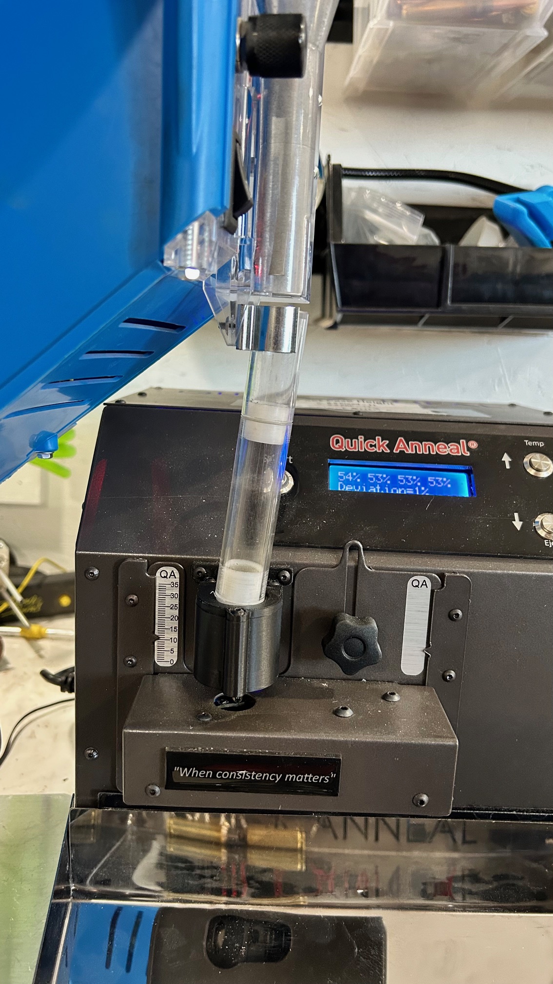

I’m happy with mine so far. Have annealed 500 cases since I received it. I noticed more consistency in sizing compared to the non annealed ones before.
