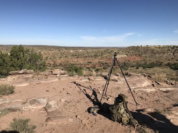

I used my 2400 in the Steel Safari Team Challenge this past weekend and had trouble stabilizing it in high winds (20-30 mph). So I mounted it to my tripod -problem solved.
The wind meter is silly and clunky for use in competition.... In my opinion. Learn how to call and sight wind through a spotter.
I've owned Zeiss, Bushnell and Sig rangefinder and used a Terrapin on occasion. The simplicity, size, speed and accuracy make the 2400 an easy choice.
And, I'm not sponsored.
