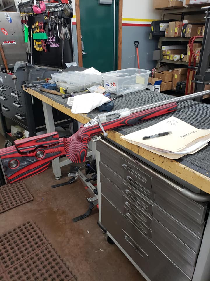

To be honest, your action isnt a typically inletted action so I couldnt say if it could or not but I know someone you can call and ask if its doable,etc, Brad at XRing Gunworks in Phelan,Ca. Its in san bernadino area. His number is (760)646- 5584 and tell him I sent you. Hope this helps.
-Reagan

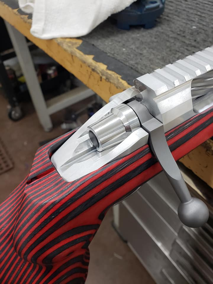

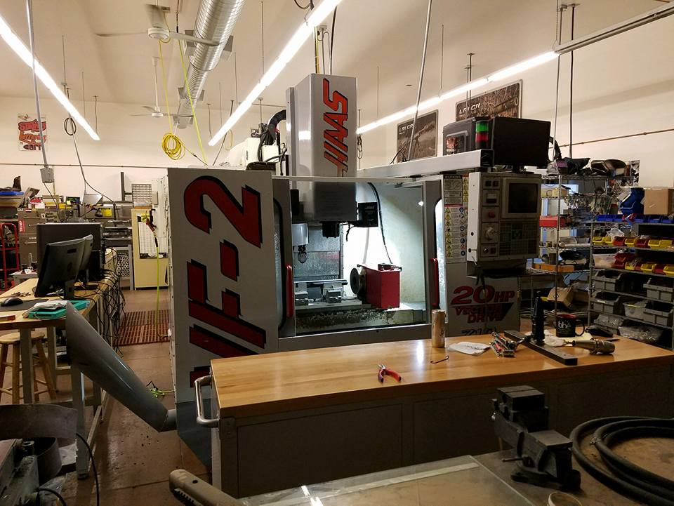

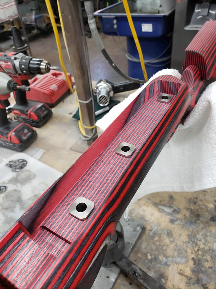

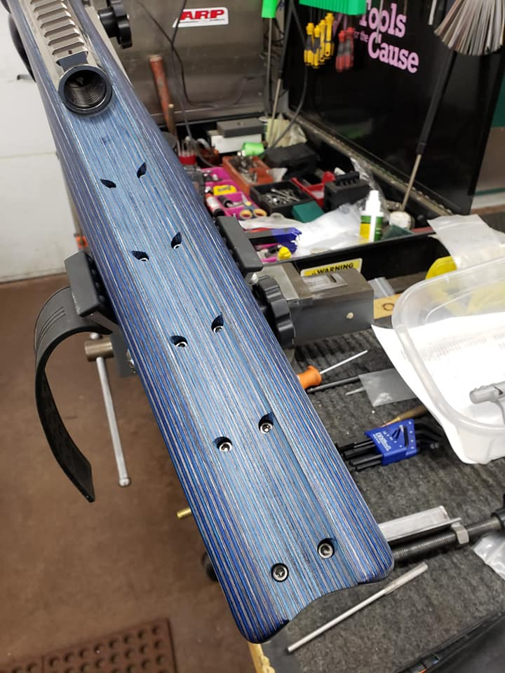

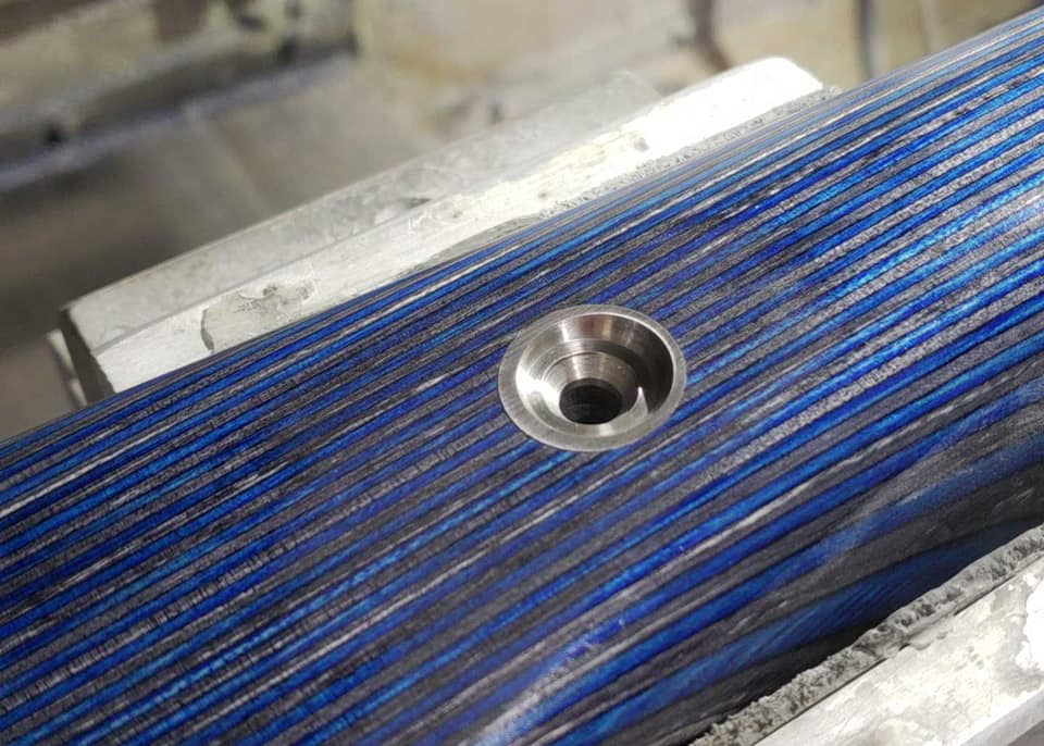

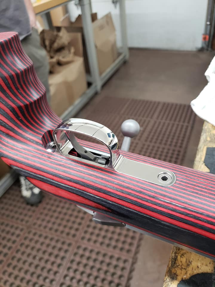

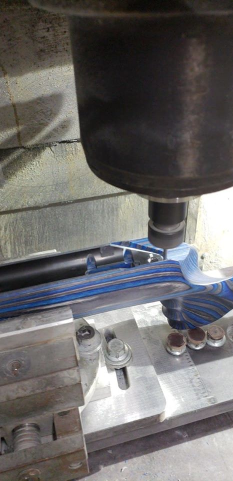

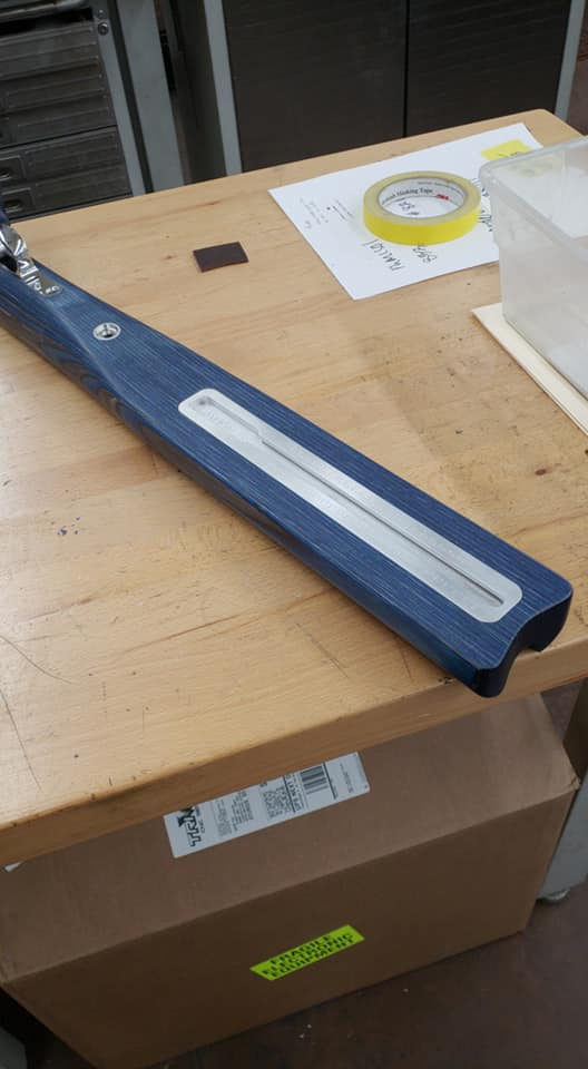

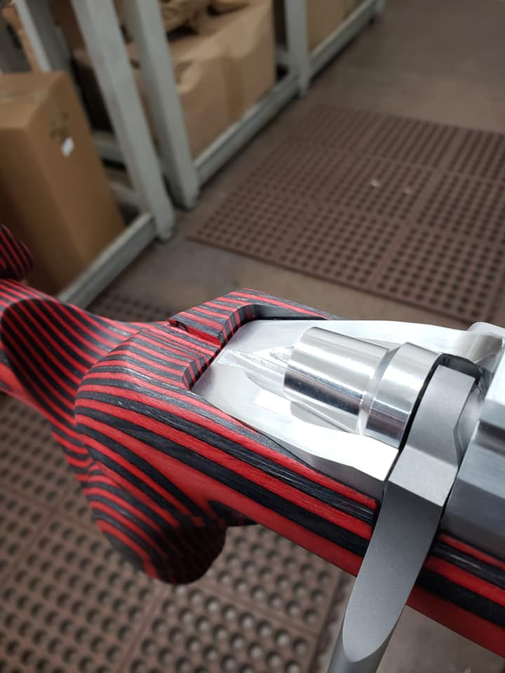

We/I (LRI) have the resources and bandwidth to exactly this kind of work. We do it every day because all of our full builds begin life as blank stocks. Wood, composite, alloy, ... it doesn't matter.
Modeled in software first, tested on a sample slug, then we run your piece. I've literally done thousands of these and we have a very, very large archive of receivers on file. The Sig is likely one we don't have, but its no issue at all.
Happy to help.

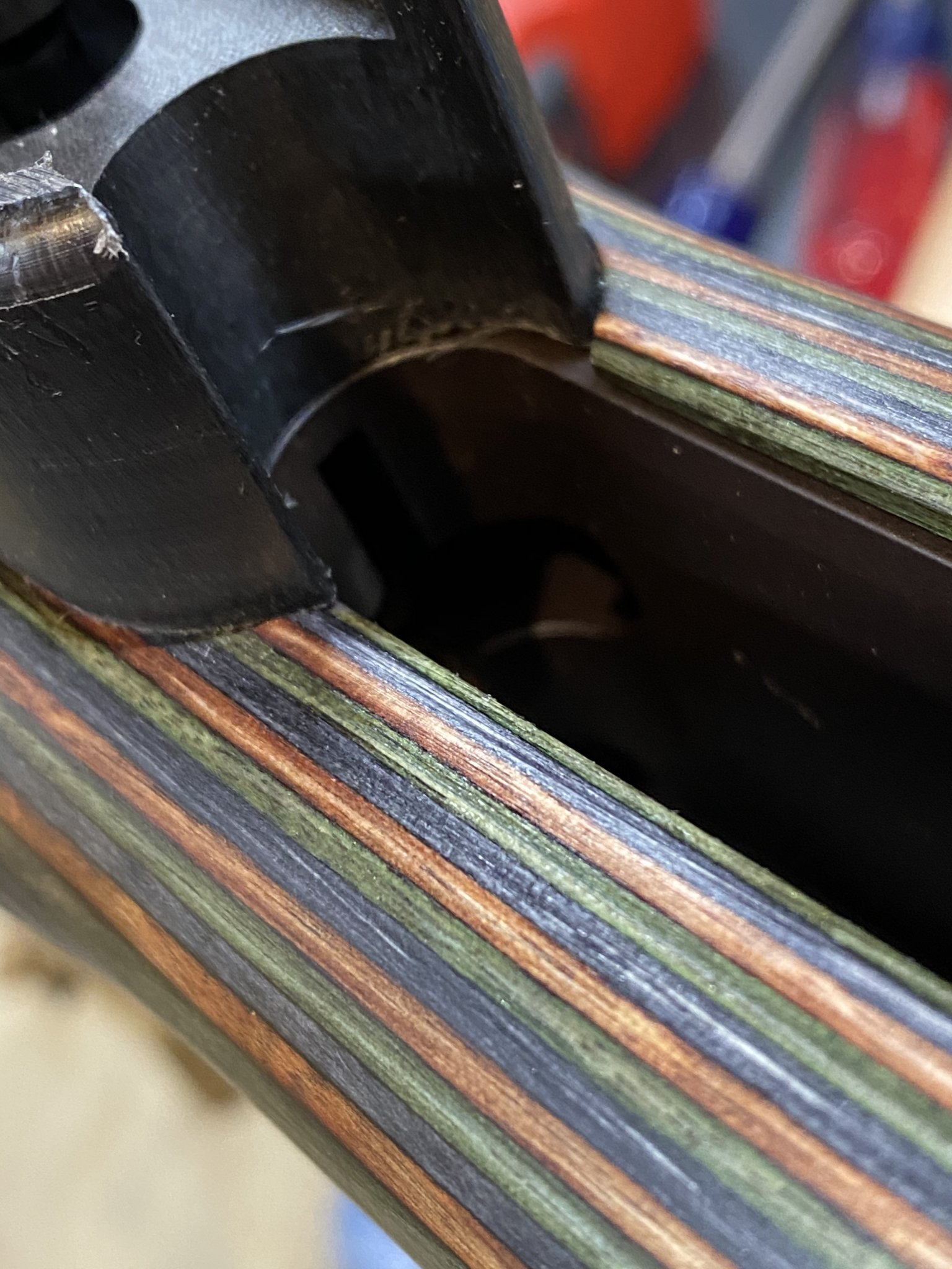

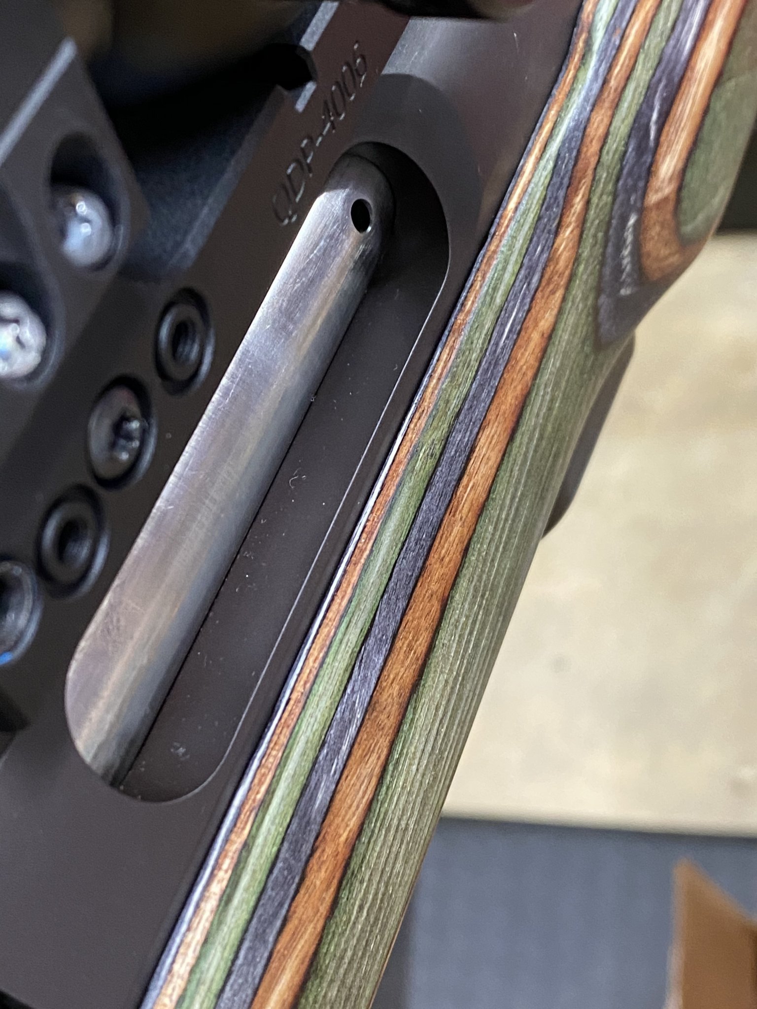

Here are but a few samples specific to the GRS pieces.
Panda action all ready to go from a month or two ago:
Recent build on a Nesika:
Front screw escutcheon we make:

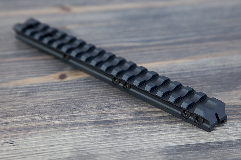

Anschutz type rail I make fitted:
Where this all gets done:

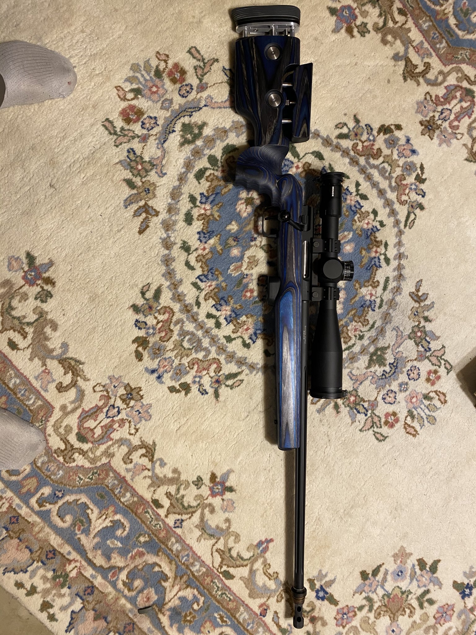

GBMaryland:

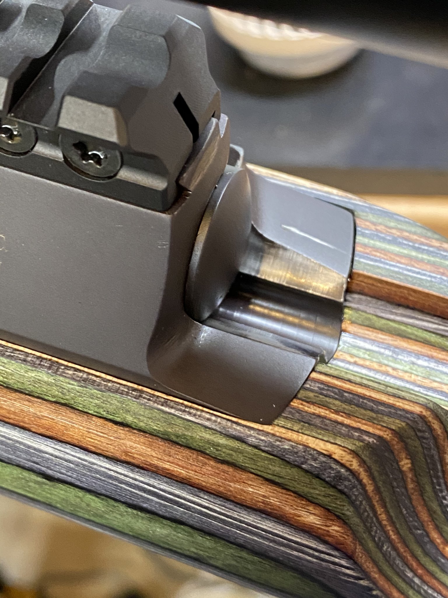

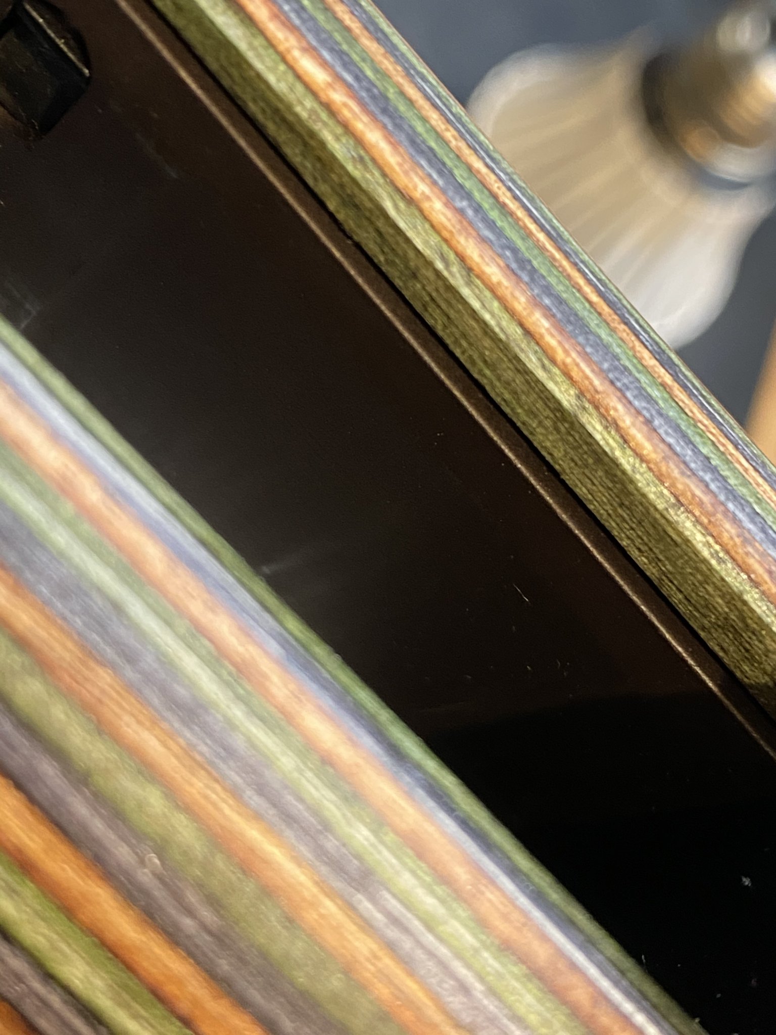

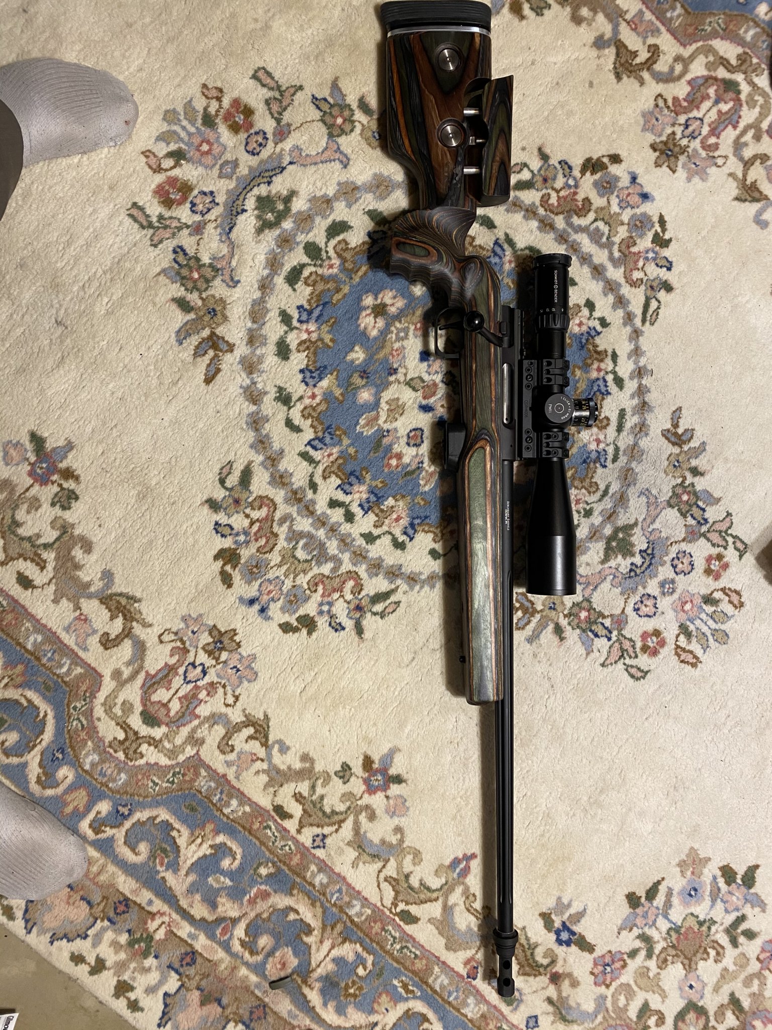

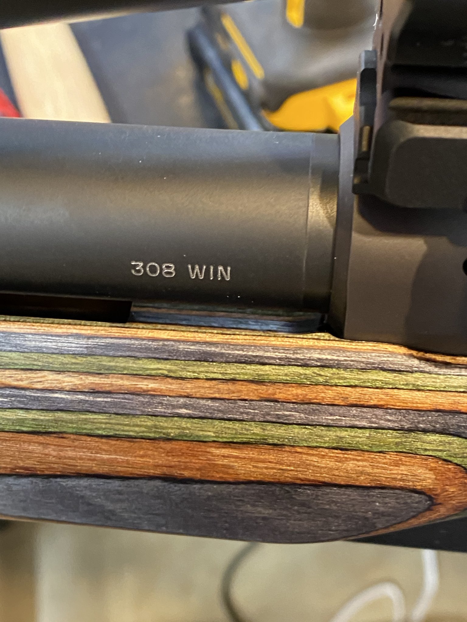

Nice..... I can't tell what actions you have- were you able to buy the stocks pre-inletted? Are those the Hybrid model stocks?

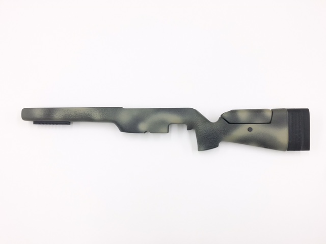

I just looked at the Benchmark website. They make many drop-in barrels for the Sig SSG- cool. One reason I decided to keep my SSG is because of barrel swapping feature. Intend to set up with some 6.5 round.
Those are the hybrid model stock. They are inletted by GRS, and uncharacteristically they require no bedding.
The benchmark barrels actually shoot pretty damn well and they make all sorts of barrels and magazine related stuff for the SSG 3000.
The actions are both Sig SSG 3000 actions. One of them is an older style without a Picatinny rail and the other is the version where the rail is a part of the receiver.
The SSG actions are different than other actions you would attach the stock to. Due to that unique way of mounting the action into the stock, and due to the components attached to the side of the receiver, you do not need to bed the action to the stock.
I can tell you that in both 308 and 6.5 all the bullets are one ragged hole at 100 yards.
I was planning on taking them out to Vegas and doing some distance shooting but I haven’t had time and everything shut down.

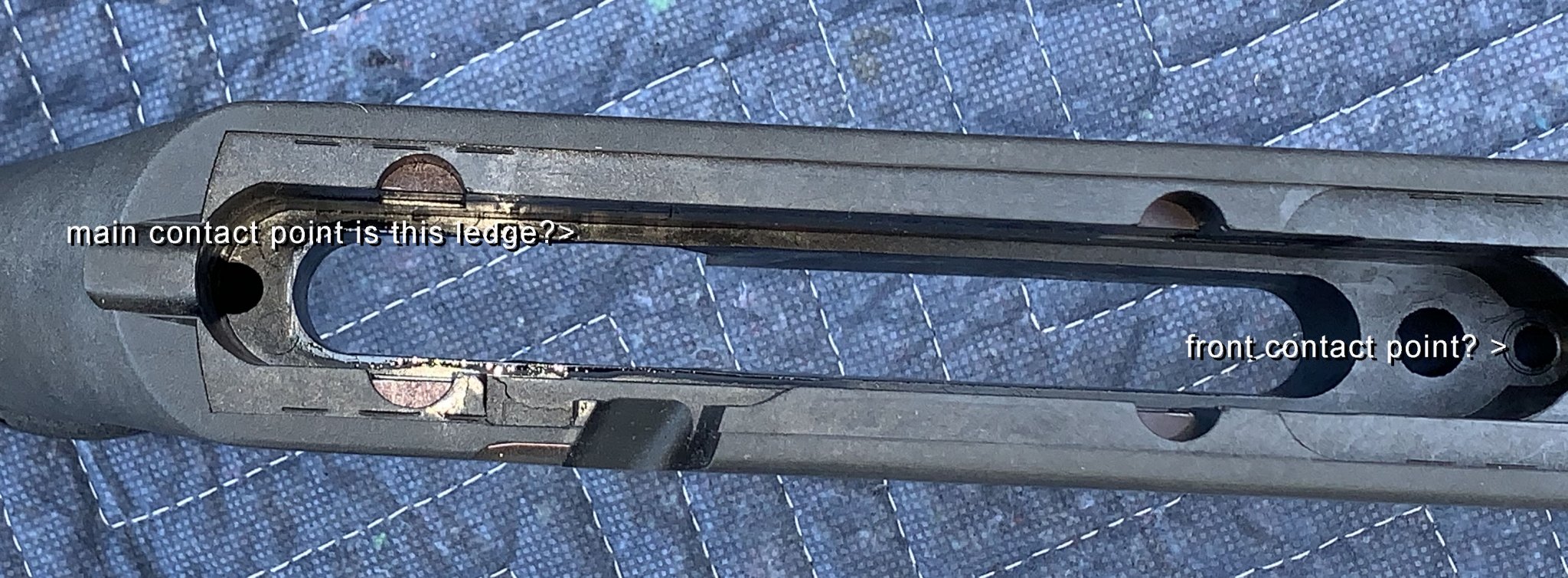

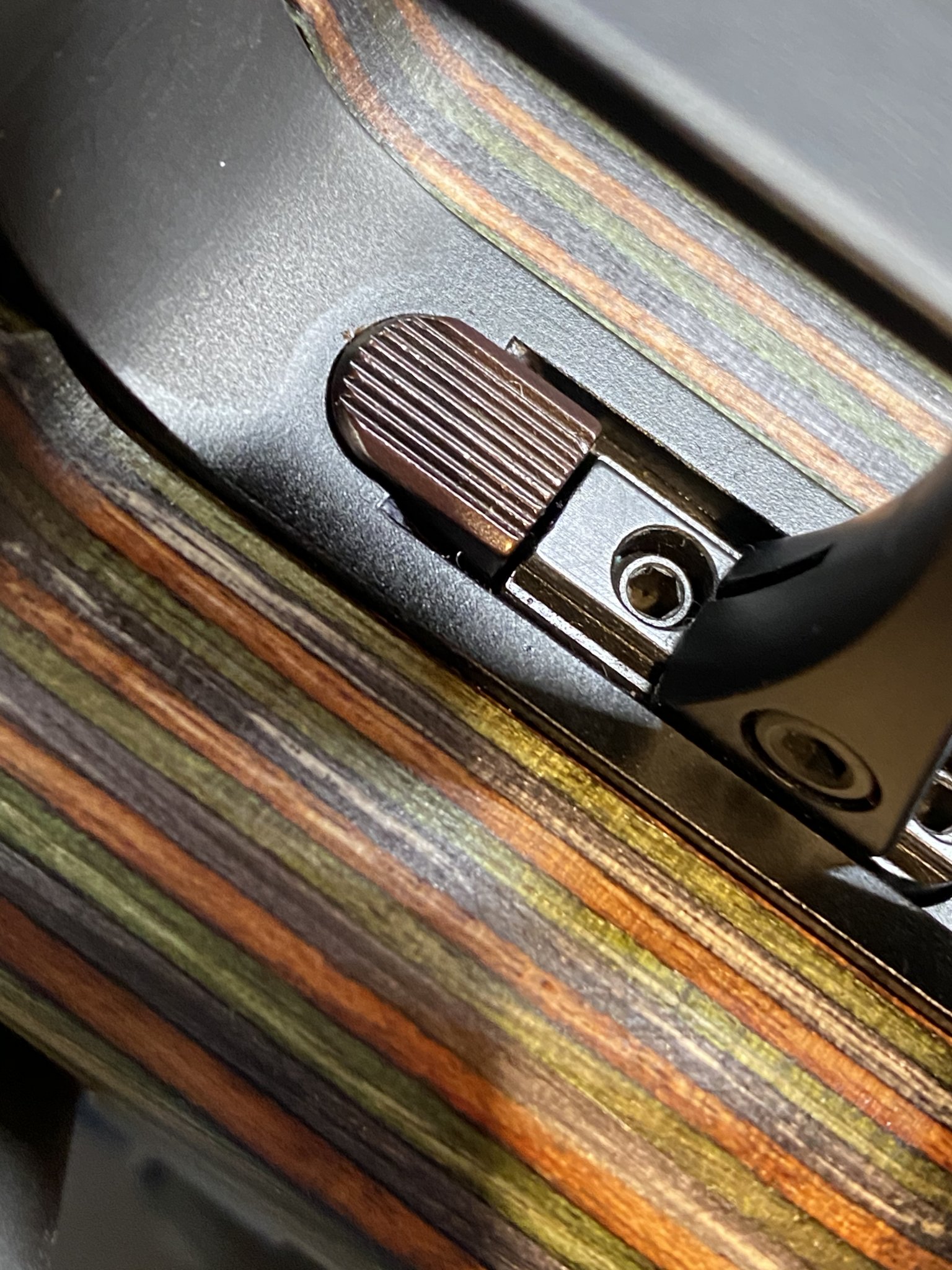

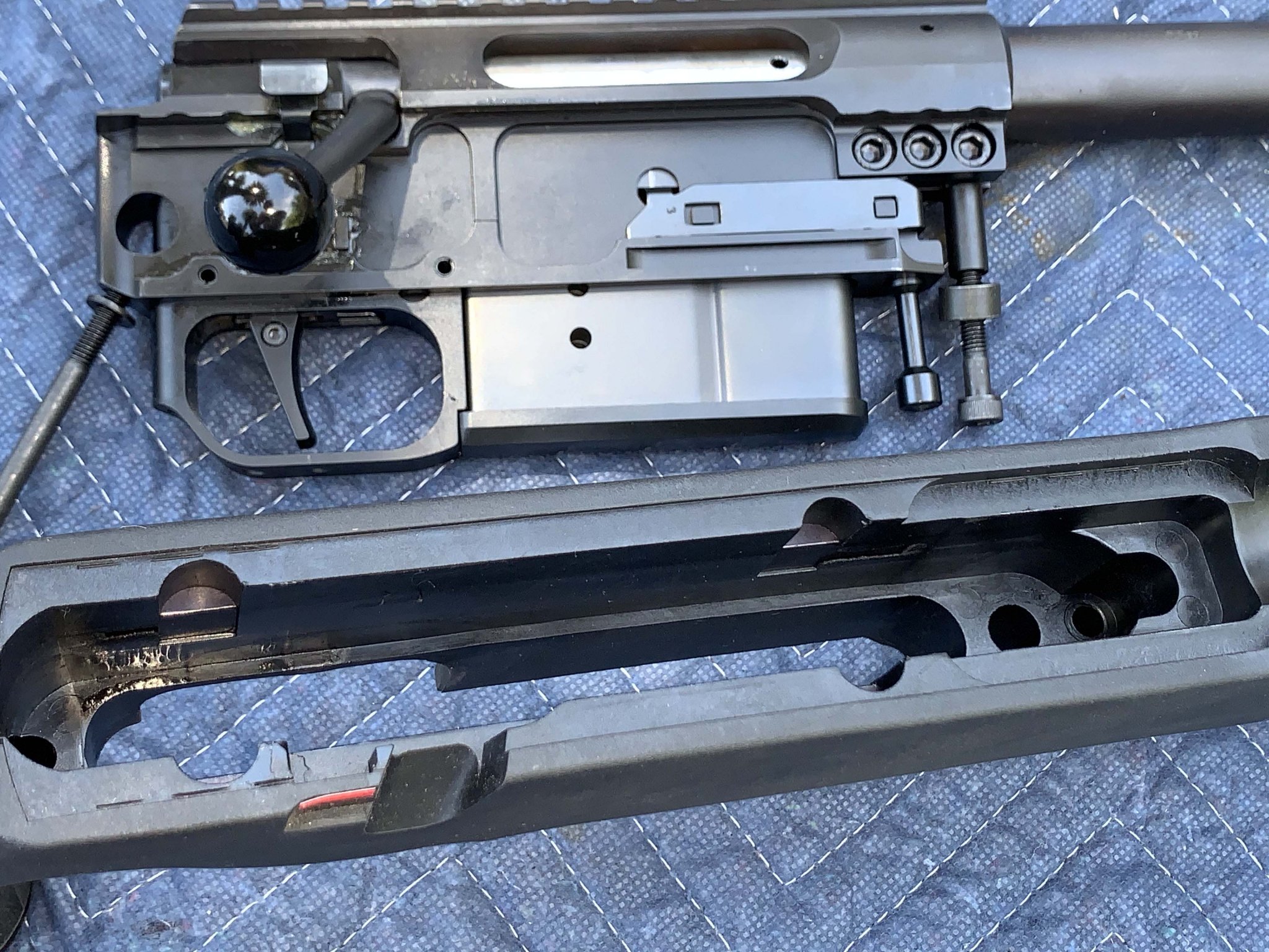

I have separated my SSG 3000 barrel and stock to see how it is mounted. Not a lot of contact area (see pics). How does the Hybrid mount to the action? Did they install metal pillar blocks for front and rear mounting screws? Aluminum or steel? Still use the long 6mm (?) Allen head screw thru the grip? Just curious....
SSG 3000 inlet pocket and action R:S.jpg
So the primary contact points are the back of the receiver and that ledge that you see on the stock.
Now someone who does this all the time could probably do a pretty good job putting some bedding compound in those key contact areas.
However they’re going to need to take the receiver completely apart, and they might even need to take the barrel out of the action... The instructions from GRS do indicate that this inlet is the only one they don’t tell you to bed.

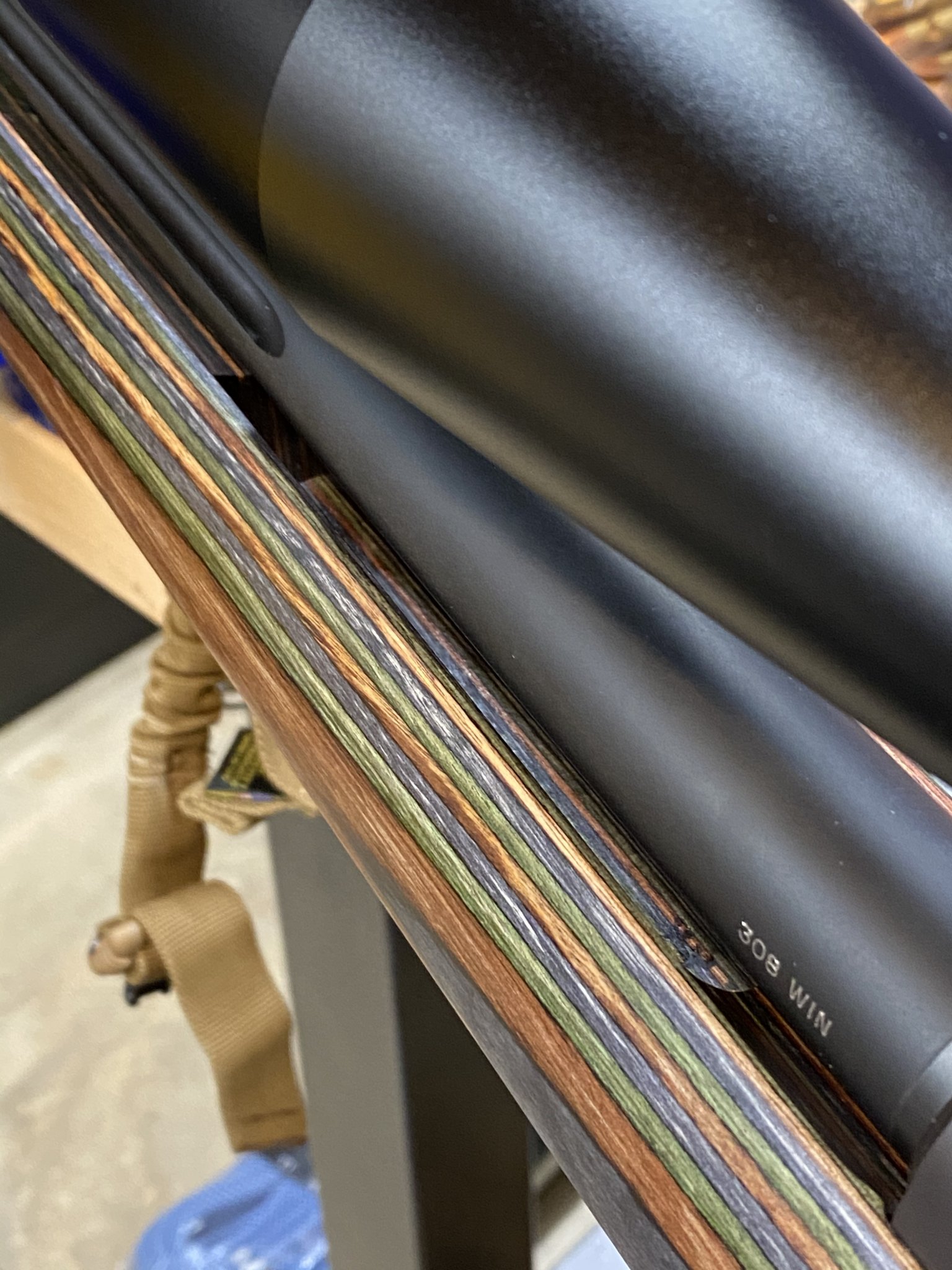

Thanks.... This would be similar to original set up- with improvement of receiver now resting (entirely?) on two metal pillars, which will mimic position of original mounting screw bores? When the two mounting screws are tightened down, would the receiver be mostly clamping to the pillars (pillars raised- not flush)- or would the contact force be distributed about the newly finished inlet as well?

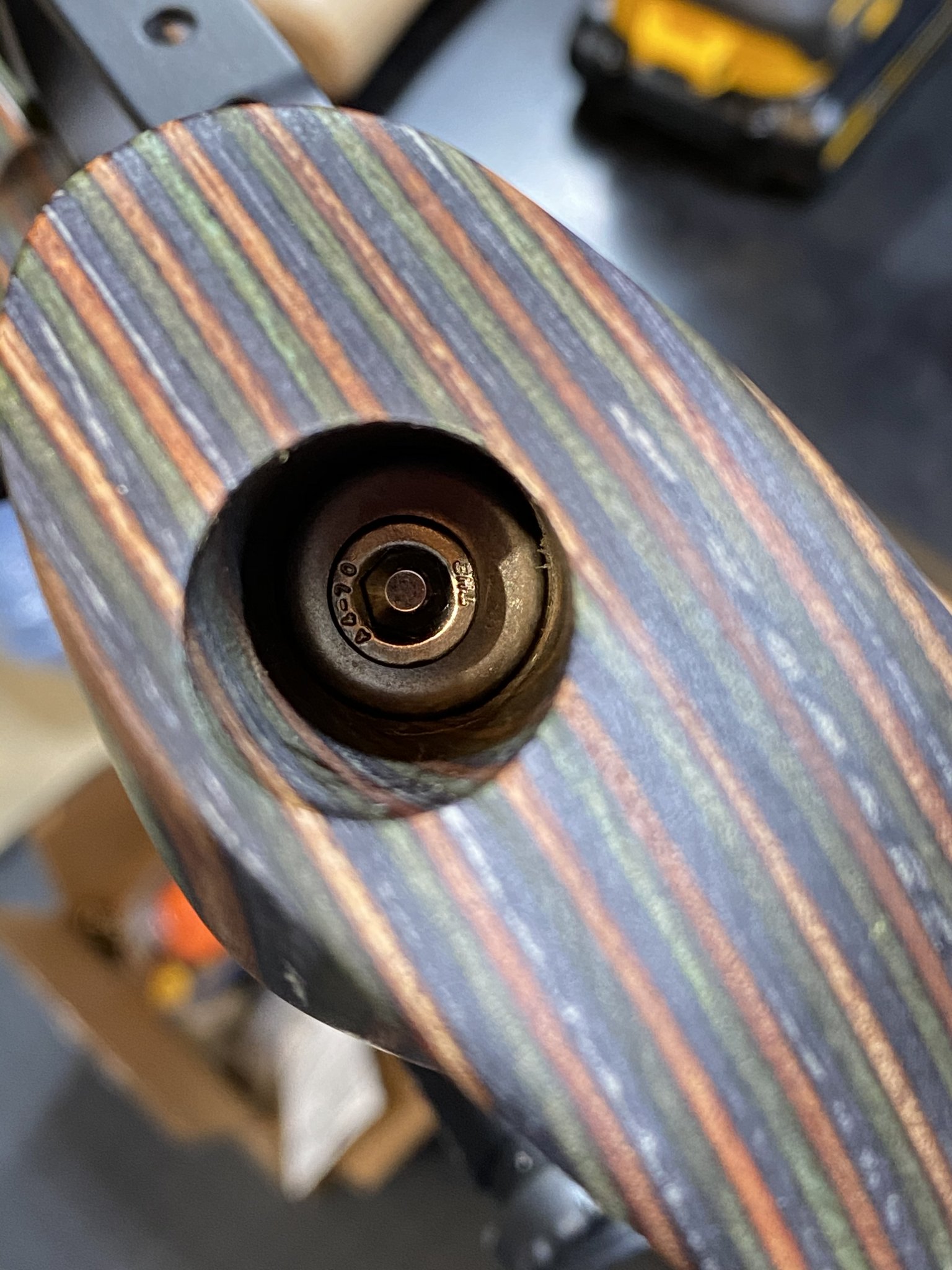

So the tolerances on the stock are very tight... Picture of the back of the receiver you can see exactly how close they are.
The plastic block in the front is used to hold front of the action, and the rear ~45 degree bolt ensures the stock is properly held into the rear of the action. They do provide specific torque specs for the bolts, as well as replacement bolts / offset nut for the rear.
The SSG 3000 receiver has a pronounced lip on to that literally provides a mating surface for the action... then entire length of the action.
I found that assembly with blue loctite seemed to be all that was needed... and a torque wrench.

i was looking through some posts. I found that Near Mfg, Spuhr and US Optics all made/make a 20MOA rail for the SIG SSG3000. you might want to call them. The posts were from a few years back.
i ended up using rings that had a 20moa slant of which there are several.
