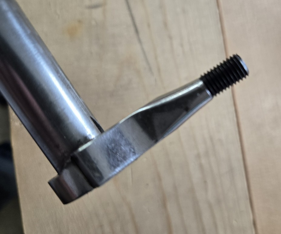

Don't remove it. The cam angle/timing is built into the portion of the handle that gets brazed to the bolt body.
Check out Long Rifles Inc (LRI) website and send it to them. There are other guys that do good jobs too, but LRI is who comes to mind immediately.

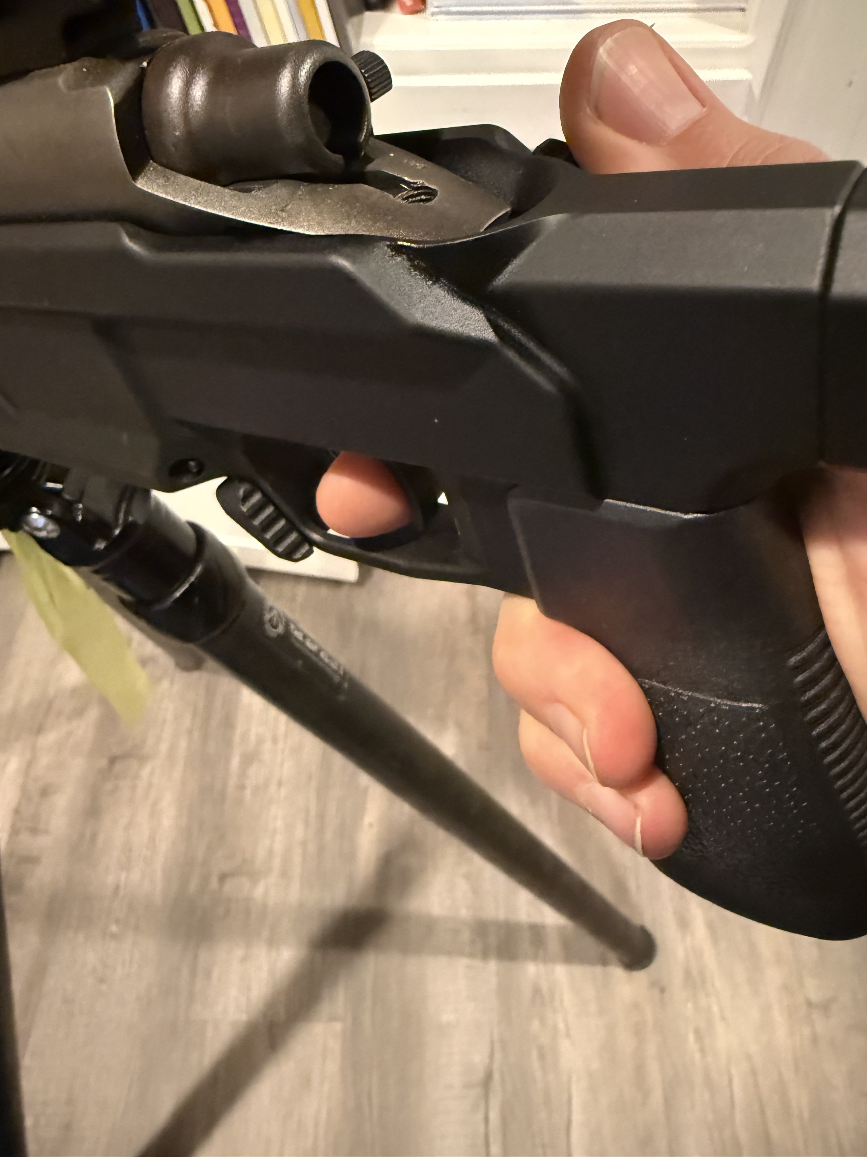

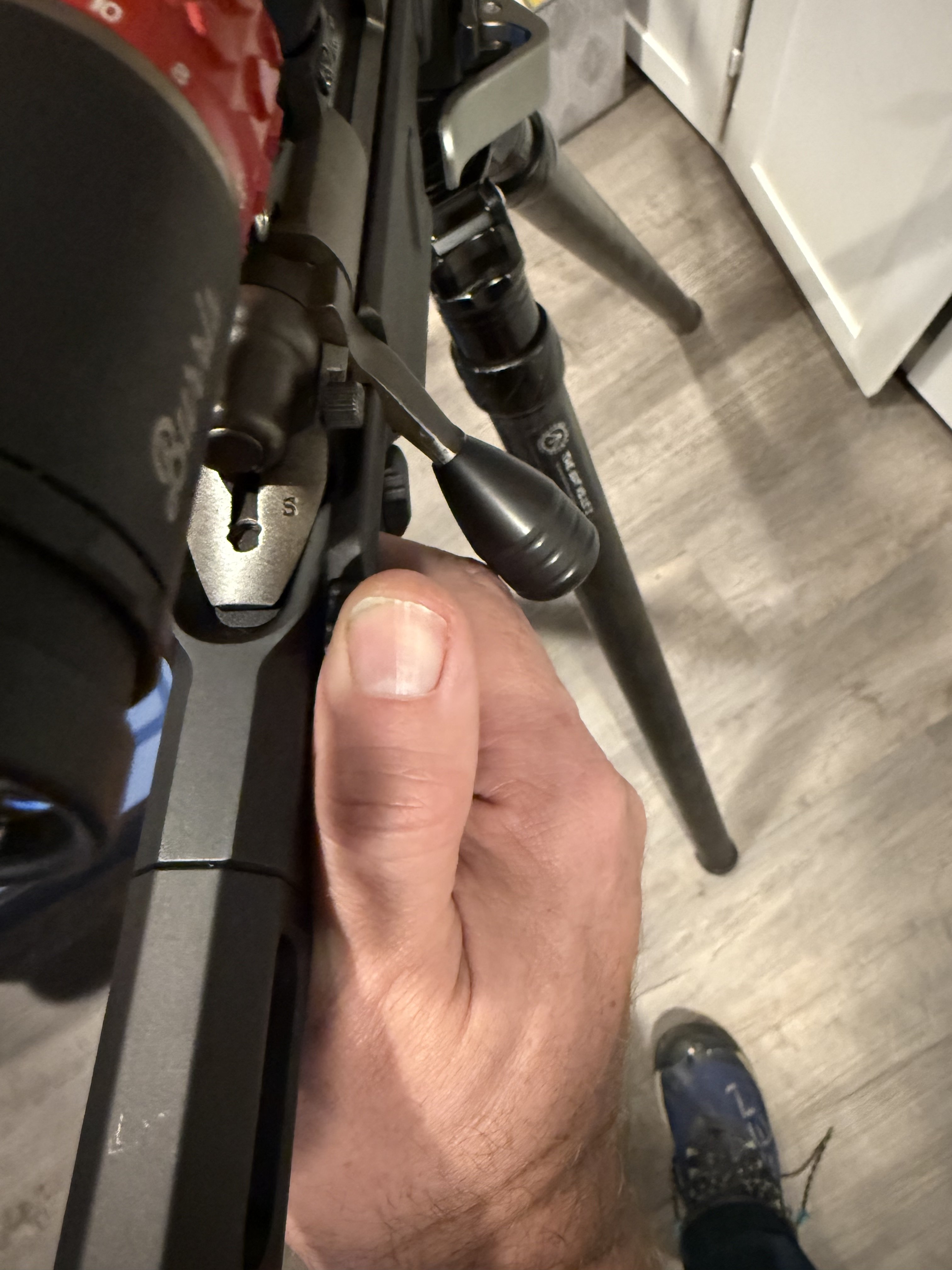

How about some clear images of how this bolt handle hits your knuckle.
Without knowing what stock or anything else, it could simply be you are holding the rifle incorrectly.
If you have grizzly bear sized hands, then I could see how the bolt touches your hand.
We need pics of you in the firing position
Reactions: spife7980 and lash

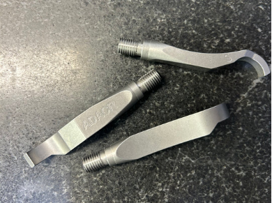

There are lots of diffrent bolt handles out their for sale. I am in the boat of needing pictures to understand also. Puttingona straight bolt handle moves it closer to the trigger.

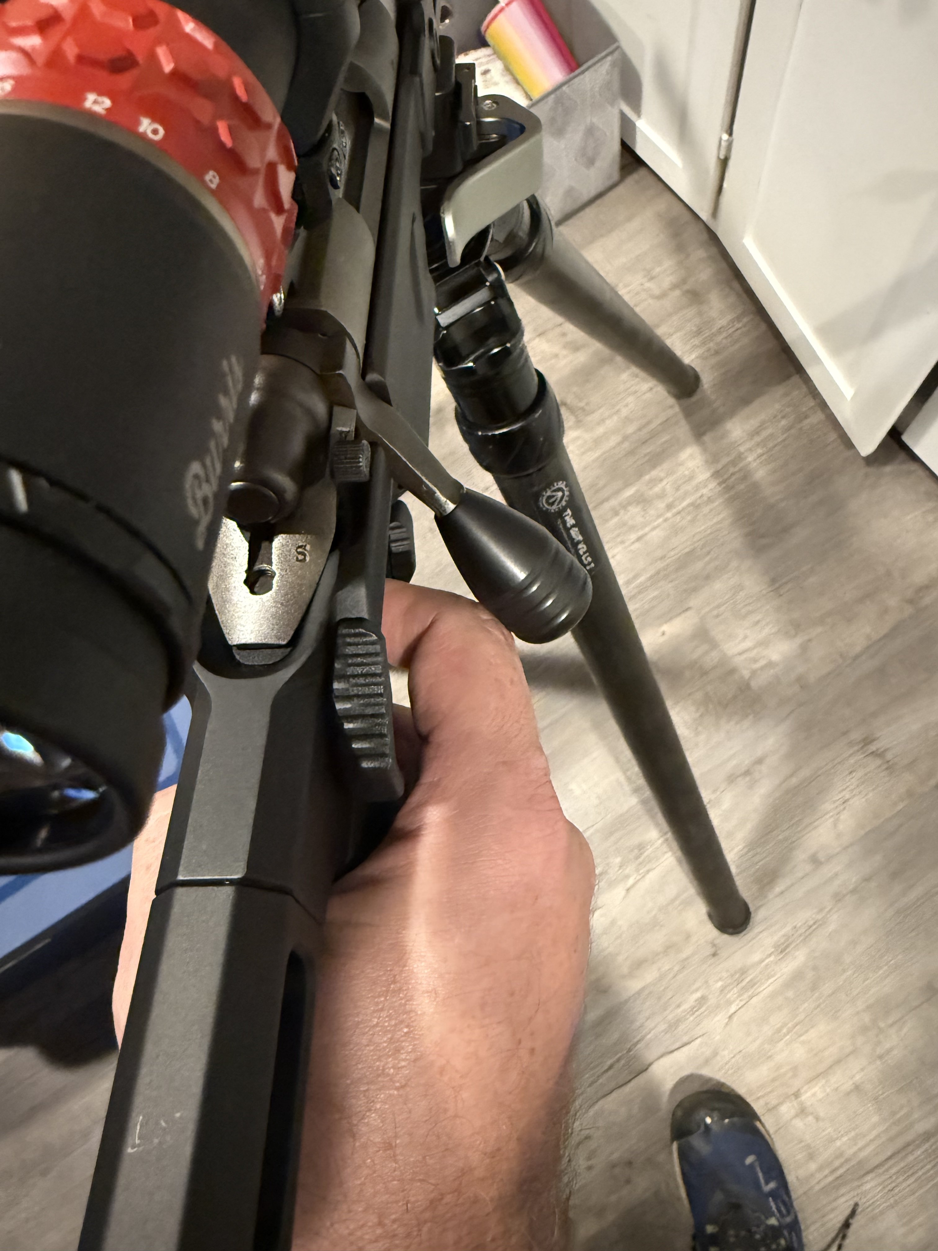

Gorilla Hands. Here are some photos both thumb wrapped and thumb up, with the trigger finger placement.

Is your hand too big to get your pinky on the grip? What chassis is that? I can't tell if the angle of the new bolt knob matches the angle of handle.i.E knob leaning toward the trigger. A straight bolt handle might push thr knob far enough forward to clear your finger. I can check later but I have a ptg straight bolt handle, as I recall it moves the knob farther away from the trigger also.

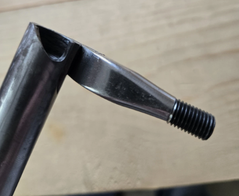

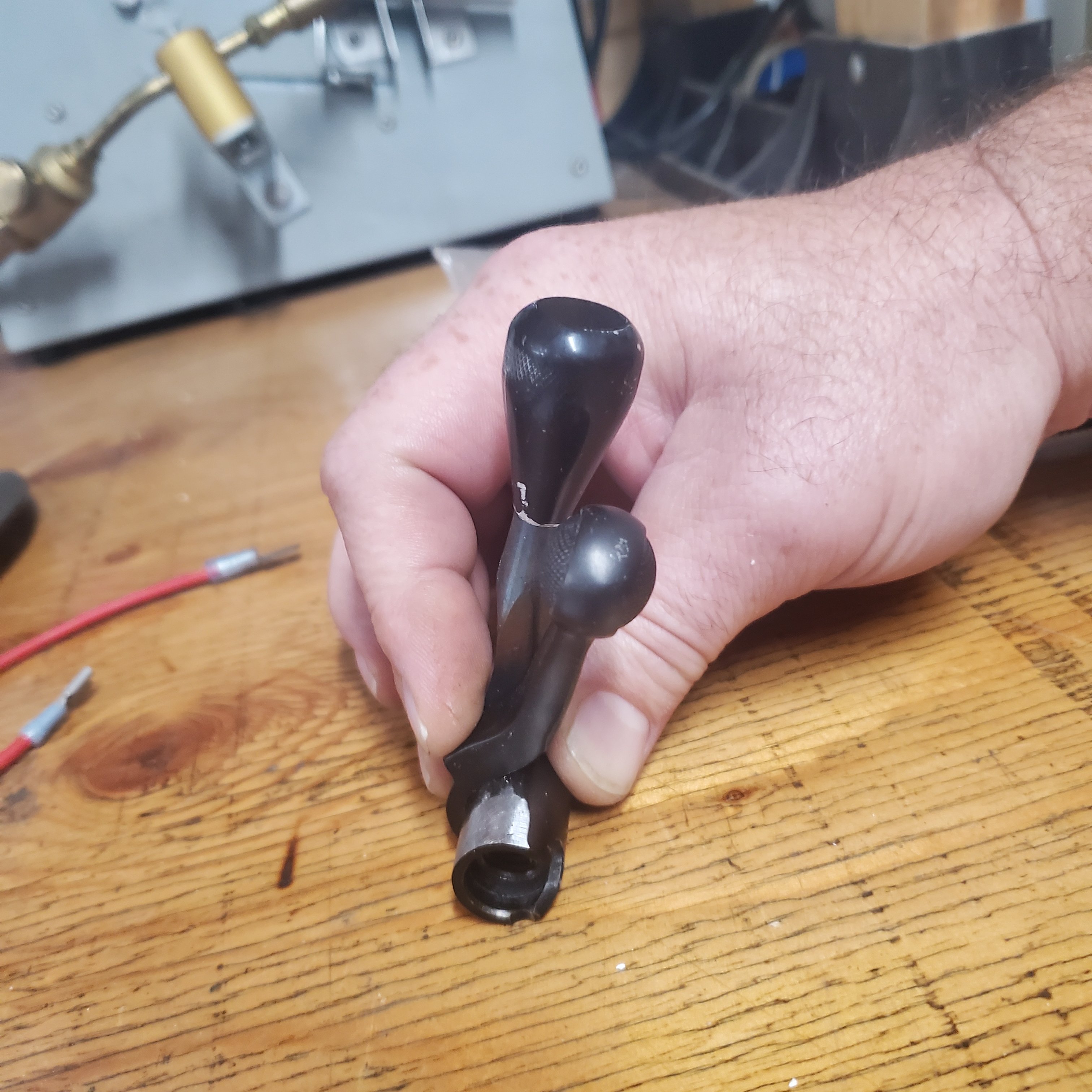

To do any heating or bending of your bolt handle, you would proabaly want to remove it from the bolt. It's proabaly easier to choose a diffrent replacement bolt handle, and have the handle changed.

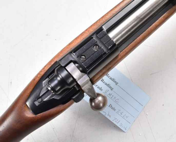

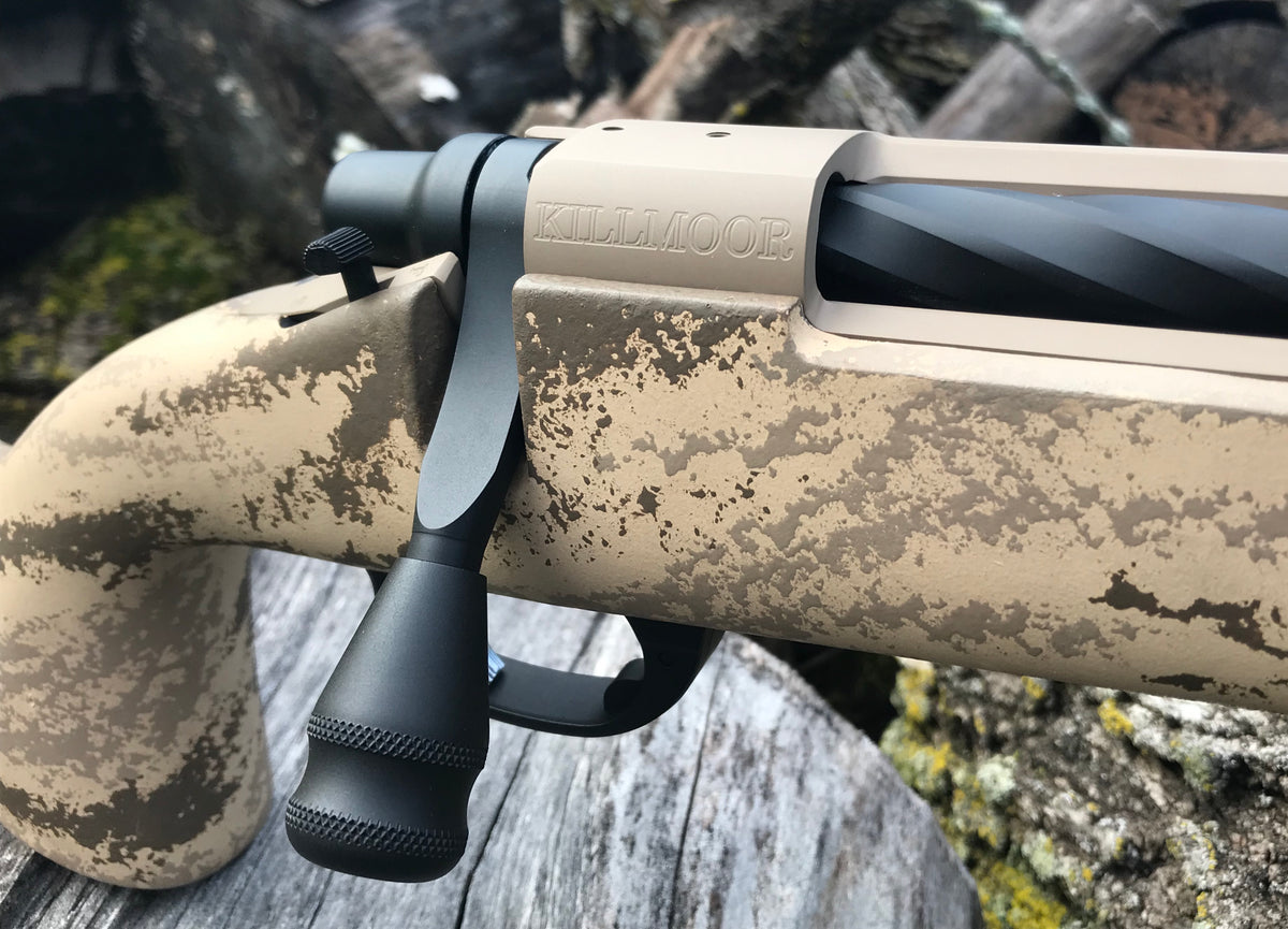

The 700 bolt handle is swept back slightly. The older 721's handle is perpendicular to the bolt body axis straight out to the right.
I agree knuckle bump is annoying.
721 bolt handle angle:
I sent my 700 bolt to Dan Armstrong in Fairbanks, Alaska to have him TIG weld my handle to the bolt vice brazing-soldering.
