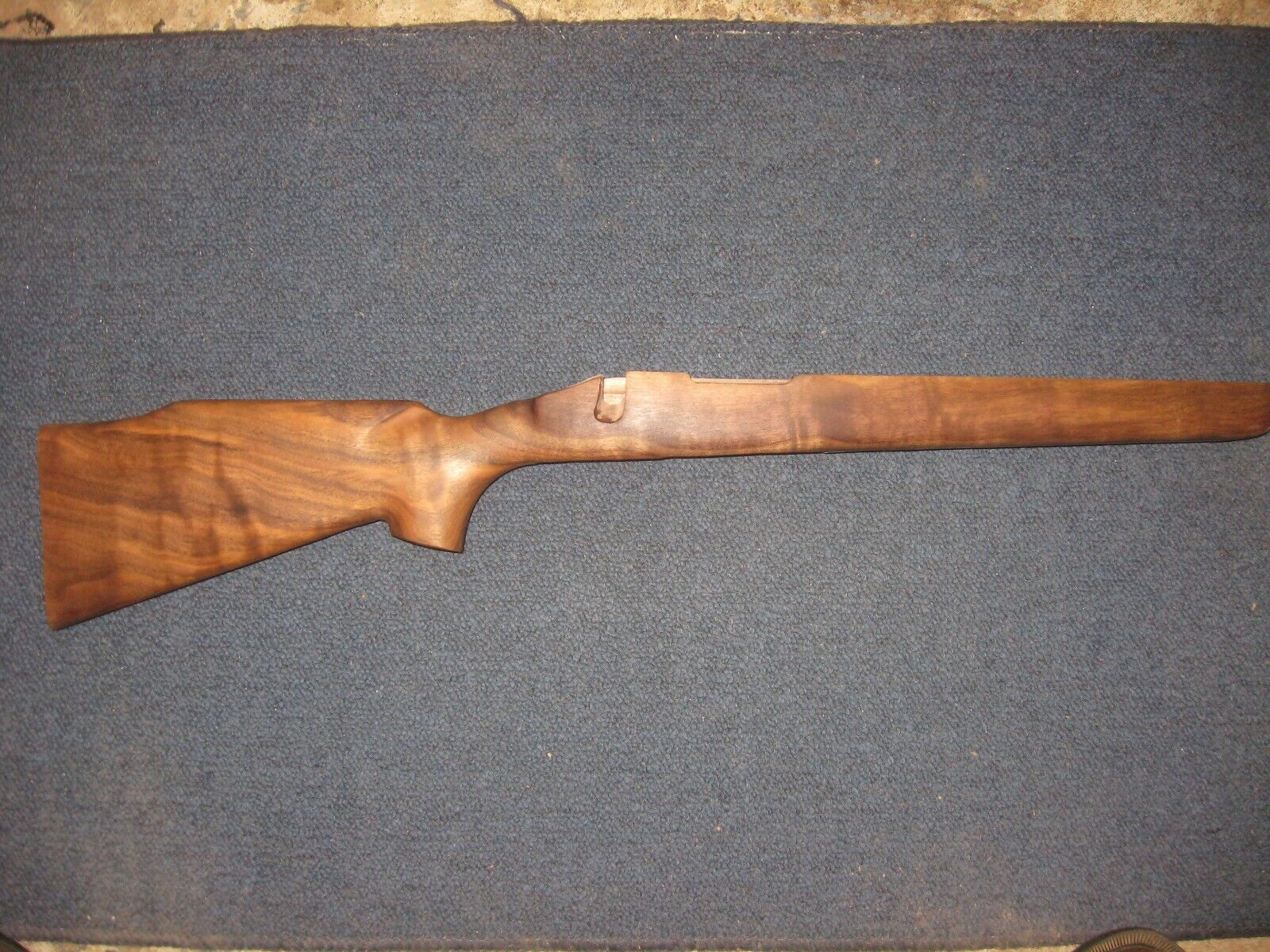

I also bought a Winchester 1902 stock from him and it dropped right in, inletting was good.

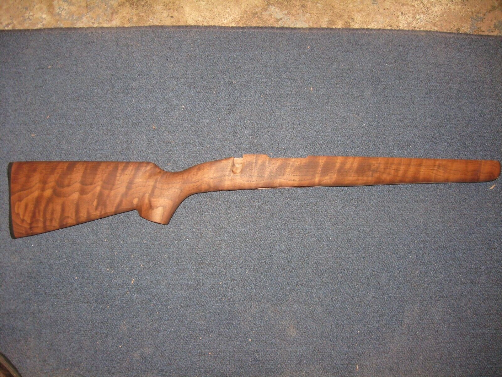

Insane Im building such an expensive rifle off such a cheap stock but the striping caught me.
These are not exact M40 profile, flat butt pad is wrong and the comb does not rise as high as it should.
Someone at M40 rifle said he will do correct M40 profile if we can provide him a pattern stock.

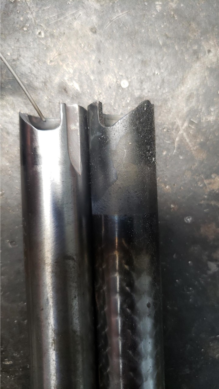

An M1 Garand extractor will work on a M14 bolt. I got a few extras made by Beretta when they were cheap. They are just as good as the GI ones too. If your bolt is a TRW it probably already has a USGI extractor and I wouldn't worry about it but always have a spare kit. I have both a Supermatch M1A and a Frankenstein Scout. The scout is a Fulton Armory receiver and an LRB bolt and other parts from various companies. Some folks on M14forum say the receiver and bolt won't work together but they're wrong.
Got a spare GI M1 Garand extractor for my parts bin when my friends Springfield stb. His gun was brand new first day firing and they wouldn't just send him an extractor that I could have installed for him, he had to send the whole rifle back.

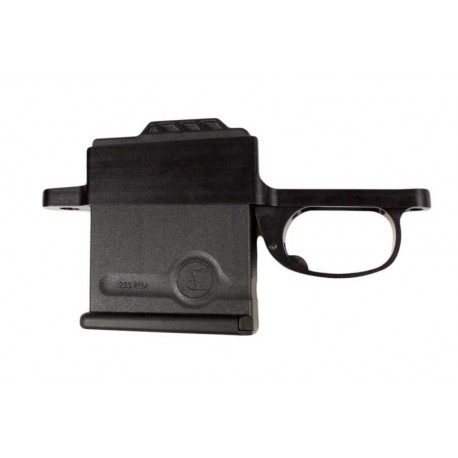

Figured Id ask here amongst the people that install them in hopes of finding out what is preferred as far as ease of fitting and just plain works for the customer.
My build is going to be a wood stocked R700 in .308.
Kind of an M40esque heavy barrel with a detachable box and tiger striped walnut.
Screwing up and impulse buying wood is leading me into an expensive project.
I dont have a lot of room like a McMillan stocked rifle might offer so Im thinking an option using the standard R700 BDL inlet may be the way to go.
I like the idea of the mag release being in the trigger guard.
Ive come to the opinion this PTG product might be my way to go.....
Im assuming this uses single column magazines.
I like the idea of staggered but that probably goes against my desire to remain inside the existing BDL inlet.
Any help with my decision making is appreciated - either installation issues or end user problems.

That is a beautiful piece of Walnut !!
If it makes the OP feel any better, I just bought the same stock (second hand, but same original source). The seller didn't work on it, to include leaving it unfinished. I love my Manners and KRG stocks, but there is just something about walnut that continues to call my name. I'm thinking Badger M5 for DBM. Badger will do the in-letting for $75 to include return shipping; might be the better option over my Dremel and file skills. I also plan on fitting in a RRS rail with T nuts. This could certainly turn into a disaster.

Thank you for the encouraging words.
Please let me know how things go with your project. That seller comes across some nicely figured wood. i see his short action R700s now incorporate a raised comb - good improvement there.
Im going with the LRI DBM and intend to have three mag options - flush, 5 round and 10 round.
The stocks look pretty well made. I will have a reinforcing pin installed just to strengthen that little section of wood between the trigger opening and the mag well - Im going with a brass pin reminiscent of the USMC M40.

I'd use a HS Precision bottom metal. It will be flush, and usually they are drop in for 700s.
Solid recommendation. I used the gen2 in a HS stock I had previously. I really liked the fit but while their proprietary mages are nice, I am not sure I want to have two sets of mags.
Take a look at the LRI option in Chads post on page 1.
It's beautiful. I will be able to use standard AI mags.
Im intending to get a flush mag and if possible have the plate engraved with a sweet EGA.

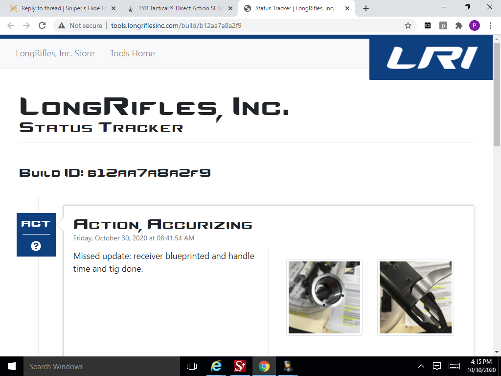

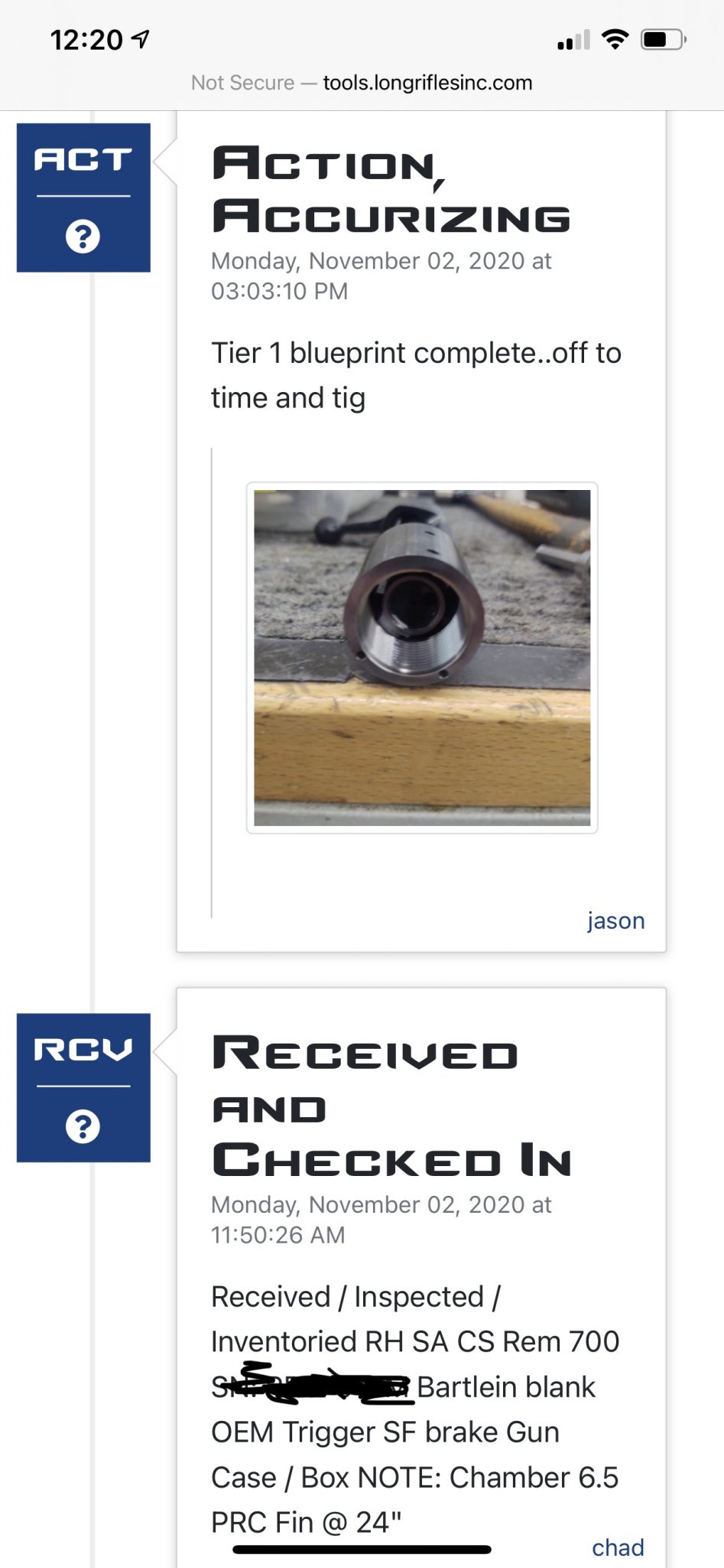

This was my view when @LongRifles Inc. called this morning.......

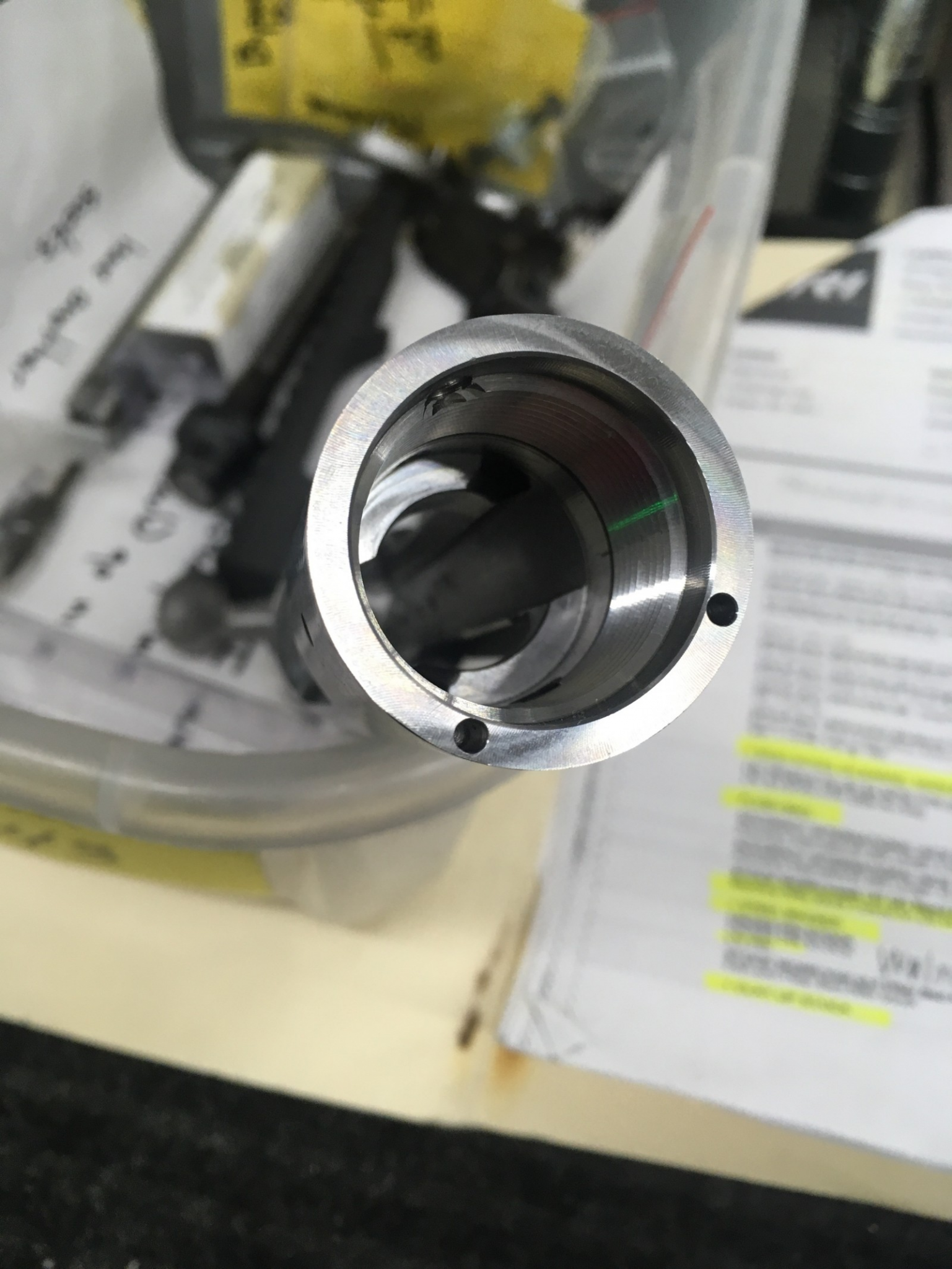

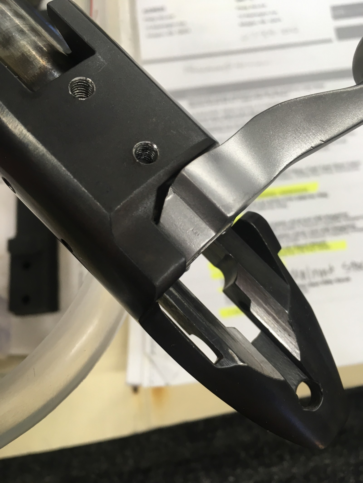

Seems someone did some Dremel work on the bolt body of my 5 digit R700.......New bolt body on the way to Sturgis tomorrow via the USPS.
Sounds like work is progressing.

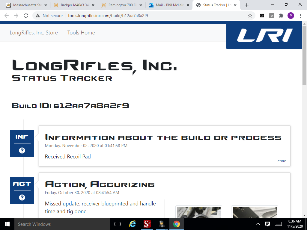

Ive given chad the Okay to post any and all pictures Ill have to check my build account with them there may be pics already available.
Chad sent me a picture of my bolt body......Who does this? Dremels should require a license. My bolt is on the left, a factory Remington striker cut is on the right....
Fortunately I have a couple of bolt bodies from the 5 and 6 digit era that have that sweet shaped bolt handle.
What I really like about the old bolts is that they have a high nickle content and when they are blued the actually turn purple or "plum" being the correct gunsmithing description.
Put a rack of R700s out with later bolts and one old school bolt it can easily be seen which is old just by the color of the bolt.

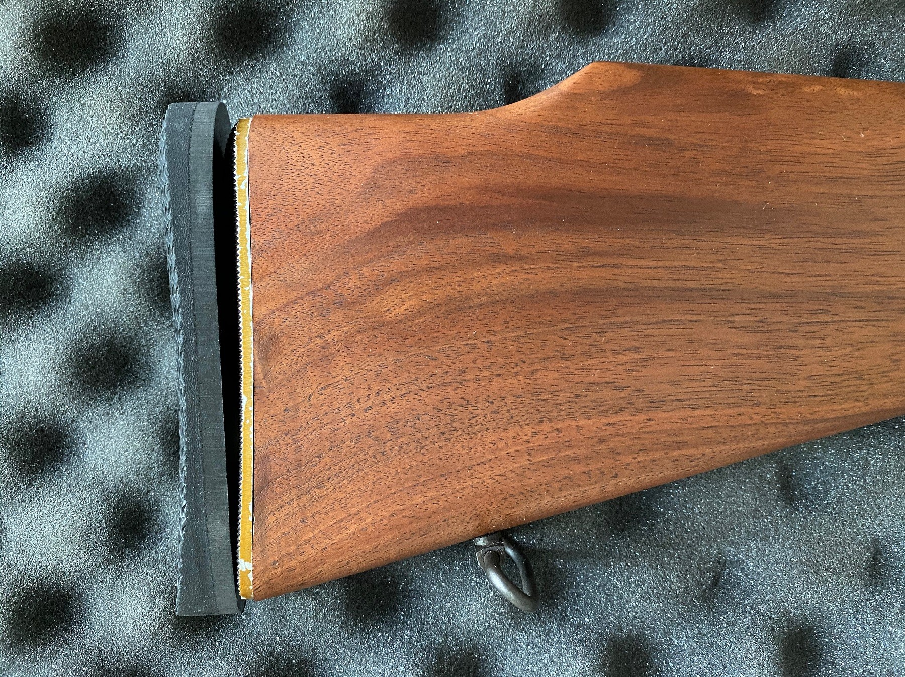

Saw this stock on Ebay. A much better match for my M40ish rifle.....
Beefier forend will have more wood to accept my fat barrel.

Going to have to get a new butt plate for this build.
I filed the other 16601 down so much that there is no way it will work with this stock.
I can try to find another 16601 on Ebay and hope it will fit the new wood with enough overhang to fit it properly.

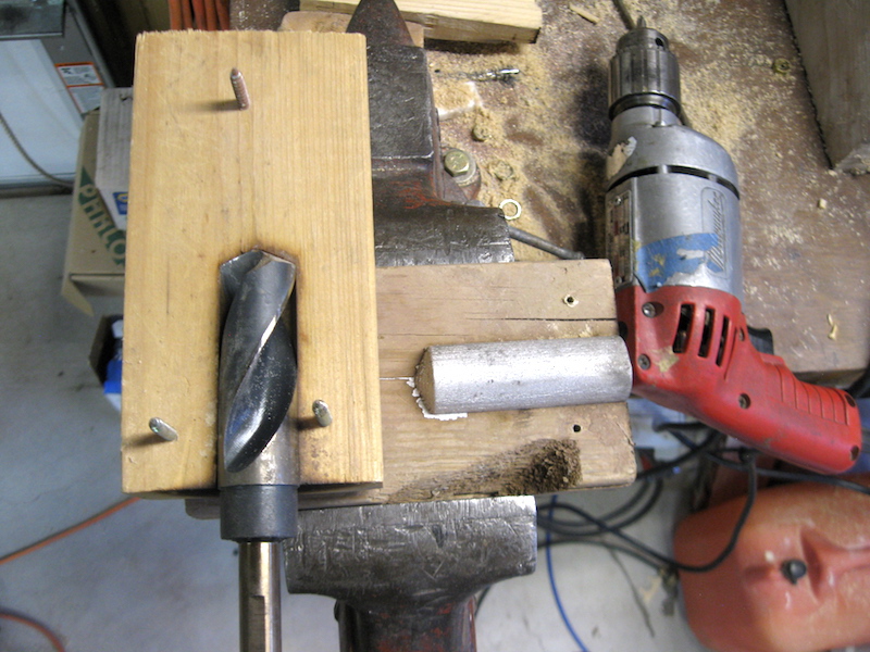

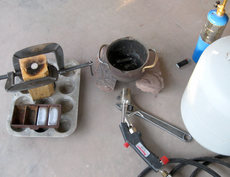

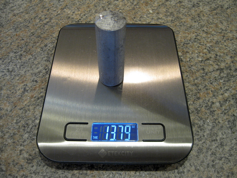

For temporary recoil mitigation add weight. Get a 1" drill and punch a couple holes deep in the butt under the plate. Cast some lead weights you can stuff in there (and remove when you don't want them), and then install the buttplate over it. 1"OD x 4" long weight will be a ~1.25lb each. Remove them when you're not expecting to burn out the barrel in an afternoon.
Here's what I mean. I just did this while dinner was warming in the oven:
Grab a couple short pieces of 2x4, clamp them tight, and screw them together. Drill them to depth on the joint. Melt some stick-on wheel weights (it's denser than any other lead alloy, and it'll shrink the most once cool) and pour them into the mould so that there's a meniscus. It'll shrink as it cools and suck flush to the mould. You can "fire polish" the end too, so it's the last part to solidify and will be mostly flat. Let it cool a while and then unscrew the mould halves and pull it out. A little filing, or maybe even just burnishing of the OD, and it should just slide into a 1" hole cut with the same drill.
I didn't set the drill depth, this plug is about 2.8" long. Hardwood or something with fine pores and finer grain might yield a better surface finish once cool than my shit pine.

There might be a slot in the fore-end under the barrel that could be weighted too, if you're concerned with balance point. I intend to fatten up a match rifle I have by filling the fore-end slot and the butt, while having the ability to remove it. For my local competitions, there seems to be nearly no penalty for having a boat anchor of a rifle.
Yep fore end has a lightening slot.

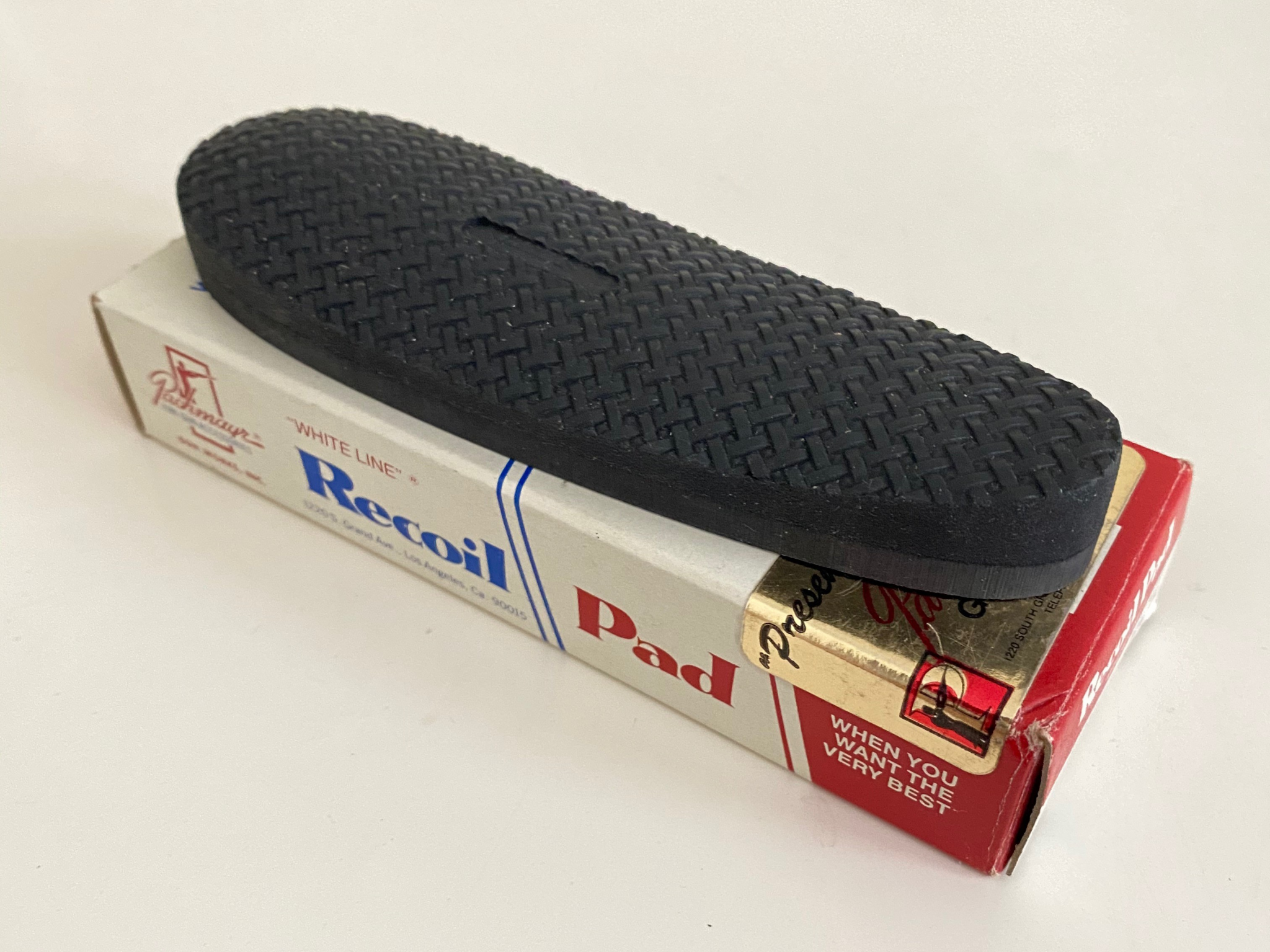

Think Ill order up a Pachmayer 500B Presentation pad to use instead of a 16601 butt plate.
The 500B will be from the M40A1 series of rifle. If I get it in black aesthetically it wont be far from the looks of a 16601.
The minimal recoil absorbtion will be appreciated.

Sweet NOS Pachmayer Presentation pad being sent to LRI...
The wood sanded with a curve for the 16601 plate will have to be planed flat but fitting the Pachmayer medium should be easier than trying to find a suitably large 16601....

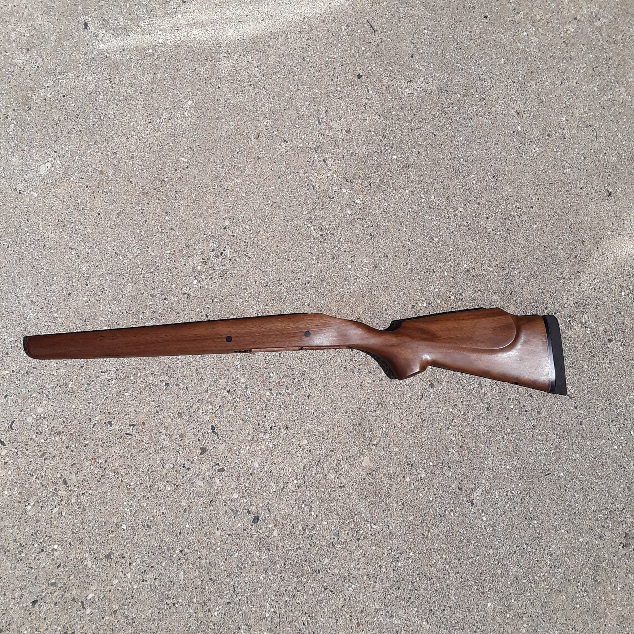

Bought a new stock thats shipping direct to @LongRifles Inc.
Its a closer USMC M40 profile.
Going to go with an M40A1ish Pachmayer butt pad (via @kft101 ) in lieu of the 16601 Remington BP.

If I get and updates in LRITracker I will certainly post them.

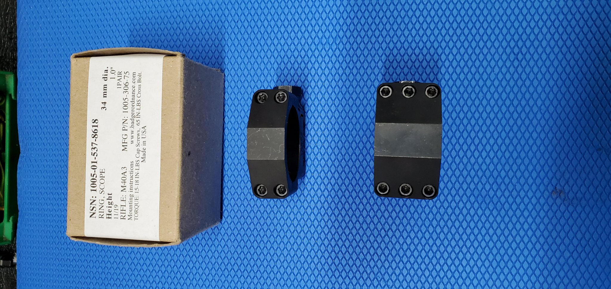

Not going to run the Spuhr on my build.

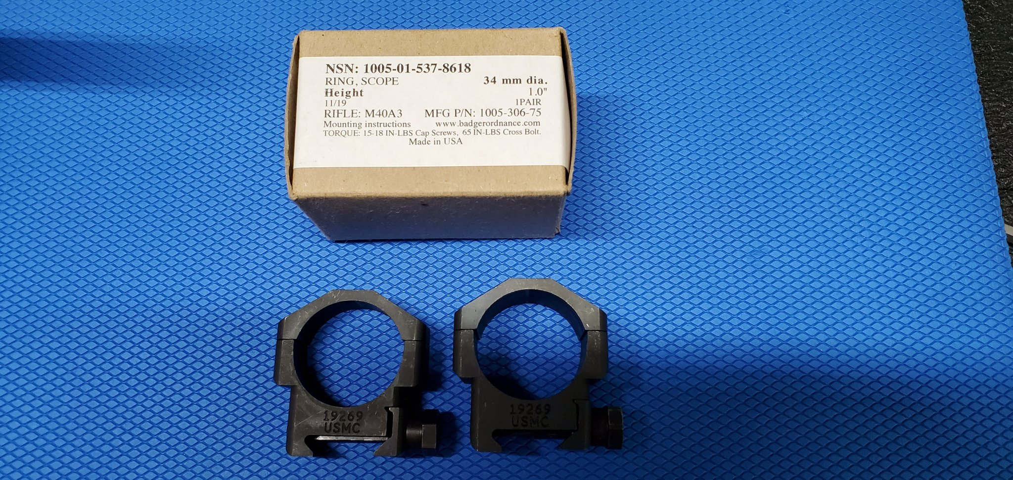

Going to give it a bit more USMC pedigree....picked these up in the PX.
Gambling that with the Badger lugged M40A3 style rail the 56mm S&B bell will still clear my barrel with the low M40A3 rings........I hope anyway.
Thank you @THE SENTINEL for making parts available for my build.
2.2 inch bell, 1 inch rings, whatever added clearance the rail will provide...

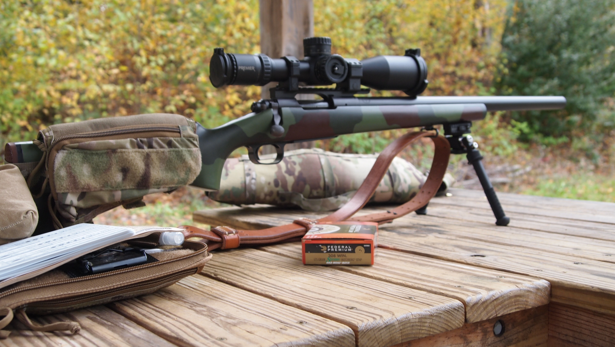

A 50MM (1.9" bell) Premier in A3 rings on a similar M40ish build of mine....That Tenebraex scope cap rotates 360 degrees without hitting the barrel.

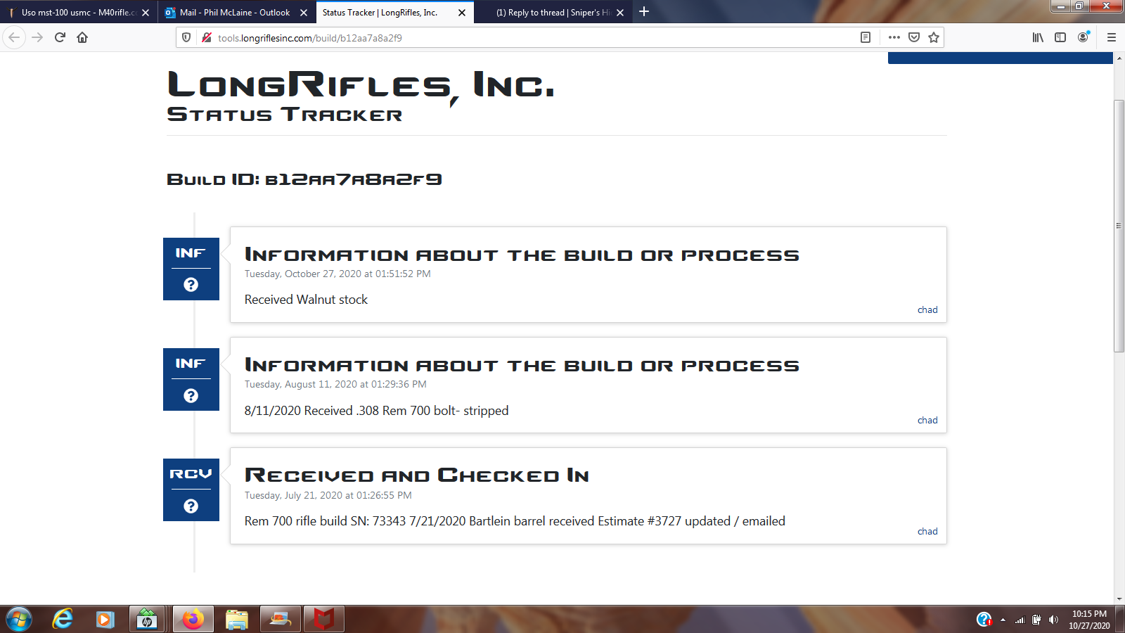

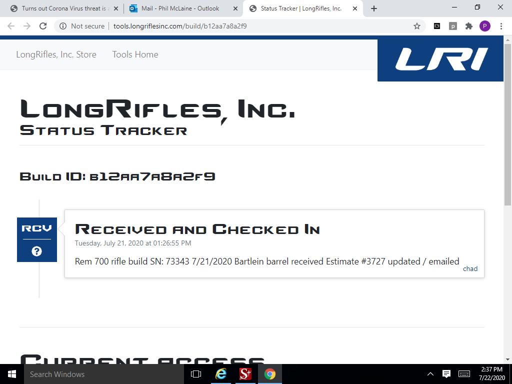

That's awesome. LRI does do a good job of keeping you informed with their tracker. I currently have an M40 style rifle being built there now as well. Any progress on yours?
I have a Rem700 6.5 PRC being built now as well. Currently in time and tig.
No more recent updates.

Here's the stock I chose. Basic Boyds walnut for like 200 bucks. Throwing the original M40 scope mount I had sitting in the basement all these years. Weaver T-10 I chose for the glass just got finished at Ironsight. Hoping to score a Triggertech trigger over the holidays at a good price.
