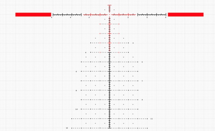

The reticle should be called the “Ilya-47”.
I get 5 mil wind holds out here all the time at 10 mil plus windage. Not sure if that’s a feature that can be requested.
I've thought about it, but I am a little concerned about making it a little too large. How about I extend the dots to 4.5 mrad at 10, 11 and 12 mrad of holdover and the number will sit at 5 mrad mark?
The reticle as it is drawn reflects how I shoot and if the wind is that significant I dial elevation and use the primary horizontal for wind. Different folks, different strokes.
ILya
ILya
Looks great to me. Now just push for a "H" version too with a donut of death around the center and all will be right with the world.
I love the reticle with the exception of the alternating numbers on either side going down. Would rather have then all on 1 side. Thank you helping get Meopta up to date.
Reactions: Gil P.
This is a fantastic reticle, Ilya, thanks for getting this going and making this a viable scope.
I've always liked Meopta scopes and with Optika 6, I saw a way to add a reticle I like into a sub-$1k scope, so I jumped on it. Meopta knows how to build high quality optomechanical designs.
With reticles, there is no way to please everyone, but I figured if I can design a modern 0.2 mrad based tree reticle and convince them to use it, it will get some traction.
ILya

Meopta's reticles in their product catalog, and in link posted are pretty lame. While I might buy one of the above scopes in their Mildot 2 I would be doing it for the scope and pretty much hating the reticle. My current thinking on reticle designs is below (Inner circle is high power field of view line this was based on ~5-25x scope) salient features are:
1) Center utilizes finer line width instead of floating dot. I know floating dots are the rage but I find them inferior because you end up having to make them too large to have them show up because they are a dot instead of a line. Paradoxically, they end up covering more, not less. They also force you to break up your normal pattern of hashes near the center which ends up saddling the shooter with more to think about which leads to mistakes.
2) Pattern of hashes is the same though the whole reticle except the fine .1mil section. WTF are scope makers thinking throwing me 3 different patterns of hashes in the same scope. I'm sure that will never cause a problem with a stopwatch ticking and all the variables swimming in my head. Hell, I don't really even do timed stuff and it still causes problems because it gives the wind read longer to change between shots.
3) The reticle uses and odds up, evens down, odds left, evens right single sided hash mark scheme that I find clearer, easier to use, and faster than the traditional scheme in which only the hash widths are varied.
4) Labels for what mill you are on are added every 2 mils. This really speeds things up when making your wind holds and prevents a lot of mistakes. Especially, on windy days where your holding out a long way. Reticles without labels suck.
5) The first mil above the center of the crosshair is left open because I have found that helpful and making the reticle feel more open and less cluttered. Yea, I know, some competitors are starting to use some hold unders and some are even asking for Christmas trees above the horizon line. Not me.
6) The reticle is floating instead of continuing all the way to the edges to allow it to be as open as possible at low power since low power is usually used for target acquisition and as open a view as possible is what is desired. I think a floating reticle is more aesthetically pleasing as well.
7) The Christmas tree section is very sparse. Only markings every full mil. I use these sections for compensation only when time is short, and for calculating corrections after seeing splash on a miss. I need to see the splash and the more buisy, the more splash you will either miss, or, more often, just misplace a little.
8) The reticle itself is removed from the fine, .1 mil, milling section. This helps you see exactly where your target comes too improving your measurement accuracy. It looks cool as well.
Since your designing this ILya, I have a feeling I will see a PSO-1 type stadia section in the scope. That would be a fine feature as well and certainly useful when you don't know the distance of the target, like in real life, when the target is something you might want to kill and eat. Funny how range finding is so important in the real world and so many "practical" competitions do so little of it.
Anyhow, make us a good one ILya.

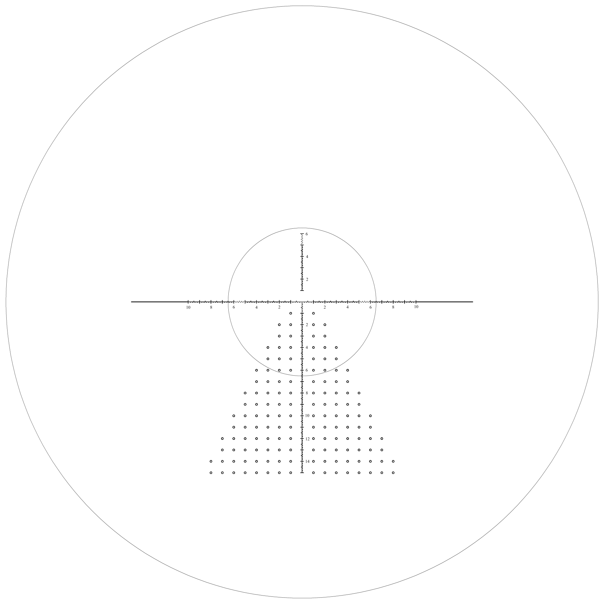

First, a disclaimer: I do not work for Meopta and do not have any decision power as far as which reticles they will use. However, they people I know at Meopta are willing to take market feedback into consideration, so here is a list of Optika 6 scopes from their website. Tell me which reticle would you want in which scope.
Here are the rules: you get to pick one reticle only for each scope. If this configuration is not of interest to you personally, skip it.
Basically, here is what I am curious about: if a particular configuration is appealing to you, what reticle would make you want to buy it?

1-6x24...low power and small diameter. Needs a CQB reticle. Meaning a POA/POI or "point blank" reticle. A circle the size of your intended target out the max distance you expect to shoot at 1X works well. If the circle is inside the target, pull the trigger, if outside, then adjust for drop. The drop is stadia spaced in mil or moa out to as far as 1k. meaning if you need ten mil (a standard 7.62) to get to 1k, then that's what you have from the crosshair down. The circle can also be a guide for wind.
Everything else can go with a standard moa or mil tactical style of reticle. They already have the McWhorter reticle, so that should be an option as well. One difference though, is the 2.5-15 could use a CQB circle on it.
