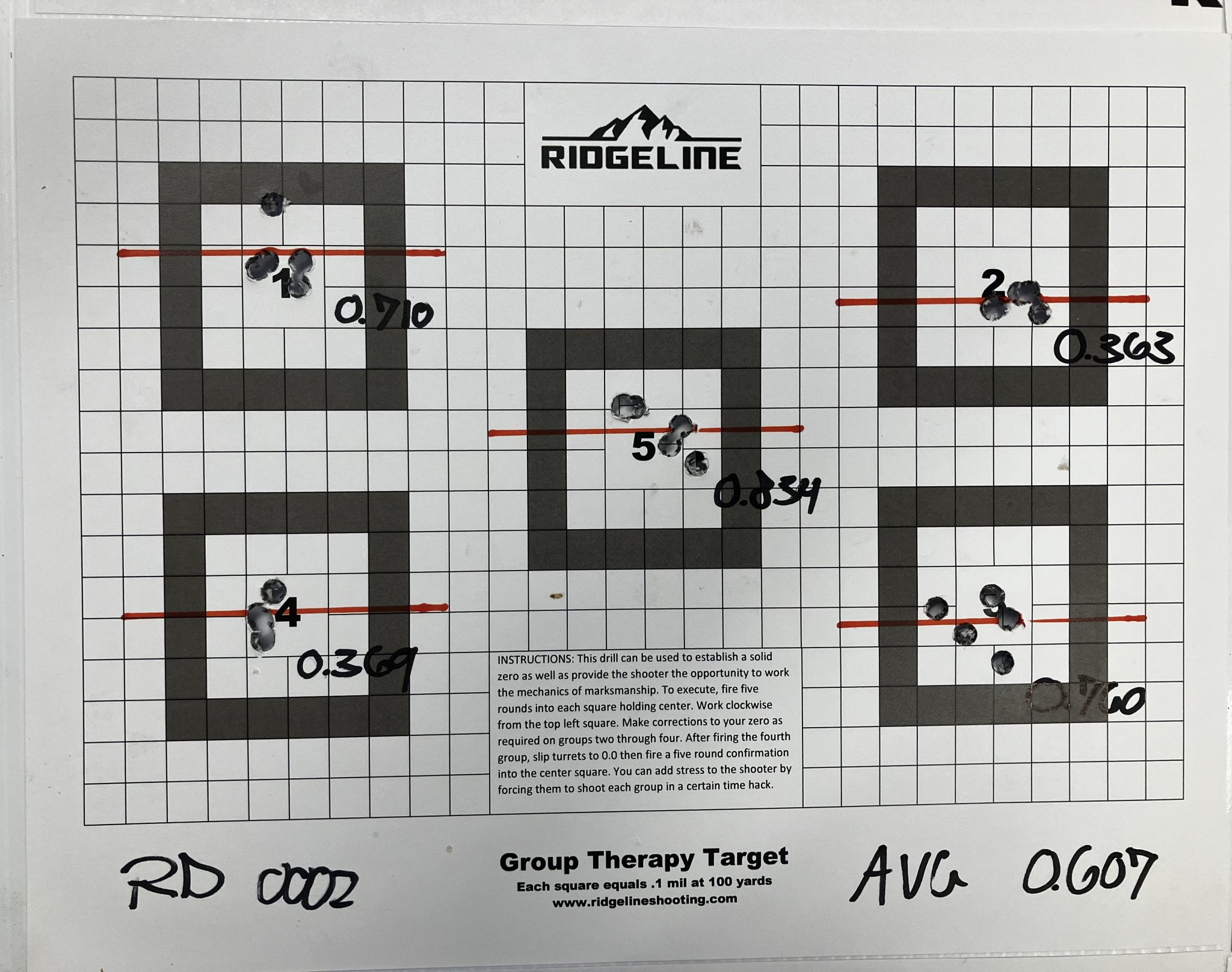

Is there a price on this yet? Any accuracy guarantees?
Price point was put out somewhere around $3k-ish. I am not in sales (should be obvious) so don’t quote me, I am just the dude out back at loading dock blasting Creed during my lunch break. 😉
As accuracy goes it is not guaranteed it’s required.
Each rifle leaves the factory with a 5 round proof target. That proof target requires 5 rounds (FGMM) sub MOA, shot prone off a bipod and rear bag, at roughly the sustained rate of fire. If it doesn’t shoot it doesn’t ship.
Edit: we decided to switch to 5 rounds group vs. 10 after the first 50 or so rifles due to the notable amount of fatigue it places on testers, shooting 20 consecutive sub-MOA 10 round groups is taxing.
The rifles are certainly capable but if you are real about it as a shooter, a cold windy (25-35pmh) day is going to periodically net you groups like you see on the left:
The right side was the retest shot with all the same parameters other than me trying to chase the wind.

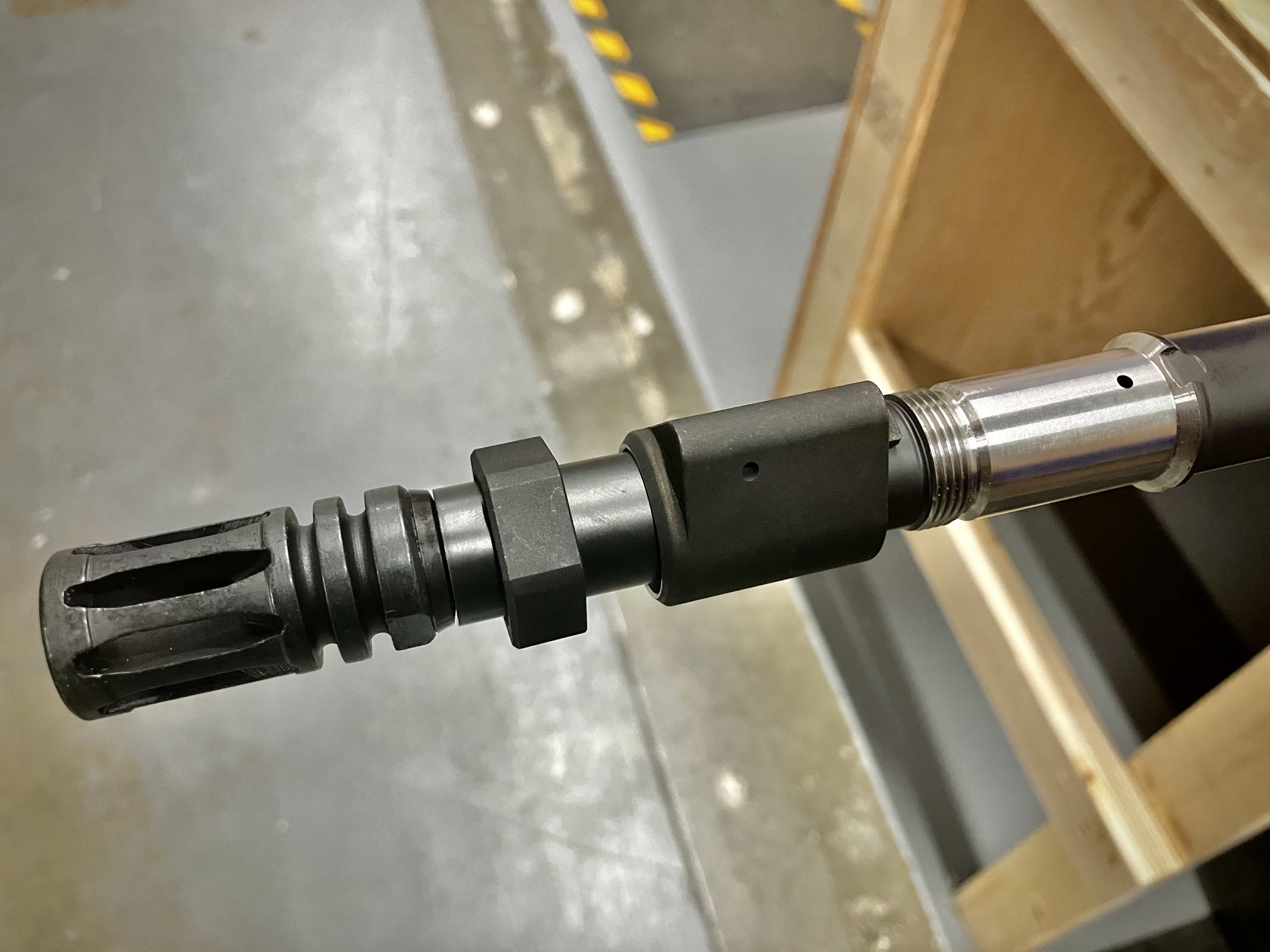

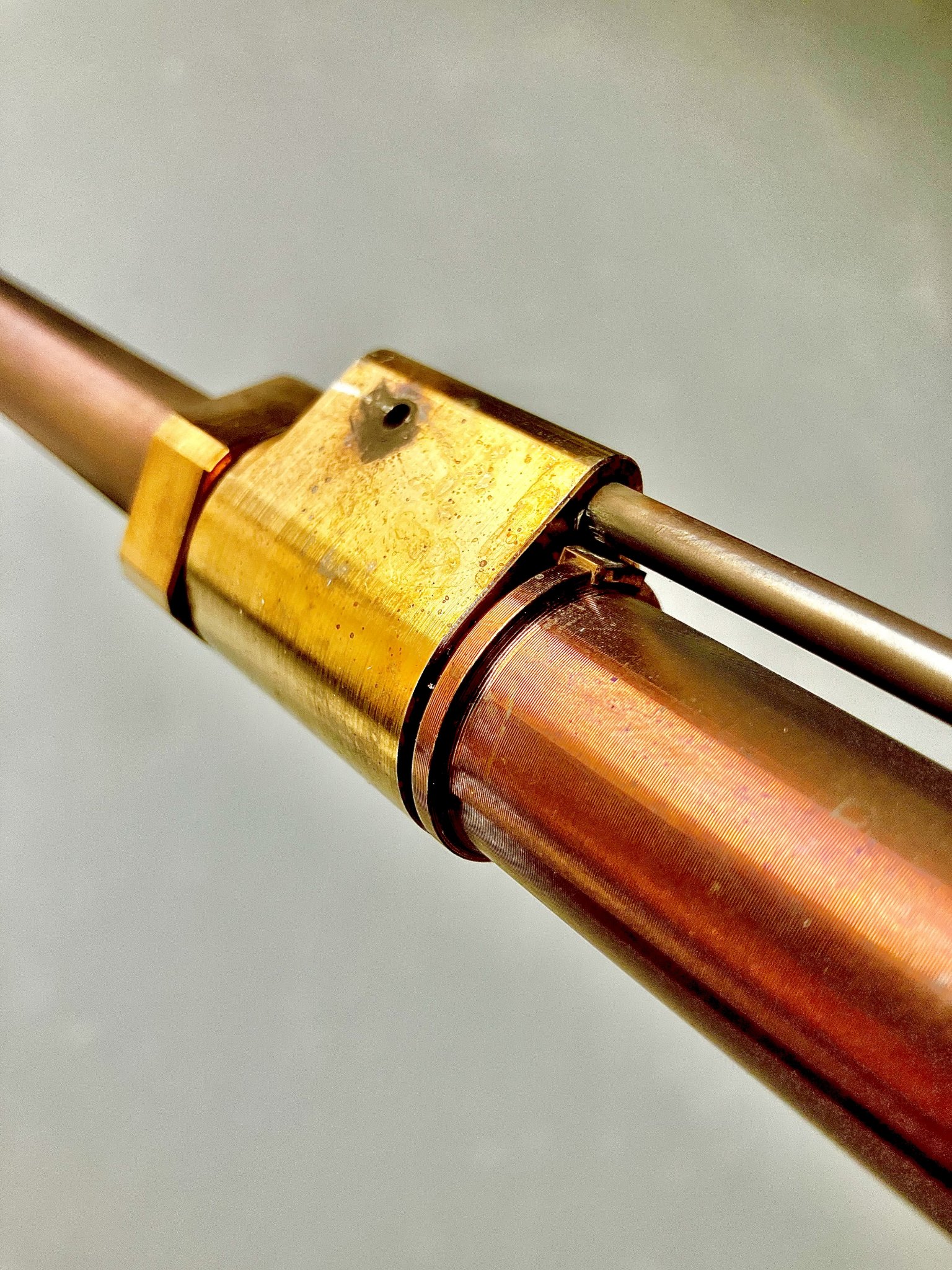

Additionally our dual tapered gas block which indexes off of the barrel and which is held in position with a jam nut.
(An actual production set up)
Again we didn’t come up with this idea, we just made it better. The whole point of this is three fold. A) jamming set screws and pins into the barrel isn’t exactly guaranteed to screw things up but it doesn’t help accuracy and makes for leaky inefficient gas system. B) this system allows us to have a thicker gas block journal, which in combination with the intermediate gas length, has seemed to help reduce gas port erosion by a degree. C) lastly a locked and torqued gas block doesn’t go anywhere or become misaligned.

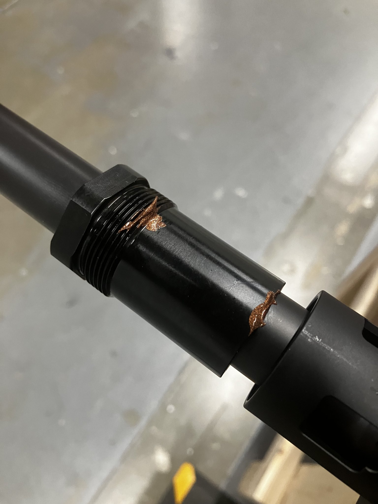

2.) The Barrel Nut - Our barrel nut does one thing, it holds the barrel in place. This was a major point of design intention as a traditional barrel nut design typically holds the barrel in the receiver as well as serving as mounting point for the handguard.
This traditional design is problematic as any shift in pressure to the handguard (bipod/tripod/barricade) will transmit to the barrel nut and the barrel causing vertical shift in the POI. 0.3-0.5 MRAD is common and we’ve seen it as bad as 1 MRAD of vertical shift on some rifles. Our “semi-monolithic” design separates the two aspects.
(Here’s a barrel nut being installed)
(Here’s an example of 5x2 with “P” being a group fired prone and “T” being a group fired of a tripod)
Lastly regarding the barrel nut I actually lied about it only doing one thing as it also incidentally seems to act as a heat sink of sorts, pulling a fair amount of heat out of the barrel (chamber/throat area) reducing heat wear significantly. We had a prototype barrel (stainless steel) conduct 20x SOCOM SURG cycles (4,800 rounds at near cyclic rates) with zero malfunction or stoppages and no perceivable loss in accuracy/precision when compared to the initial accuracy/precision test done prior to the SURG test.
I’ll snap a picture of it next time I’m in the shop, a few photos shows the results much more easily.

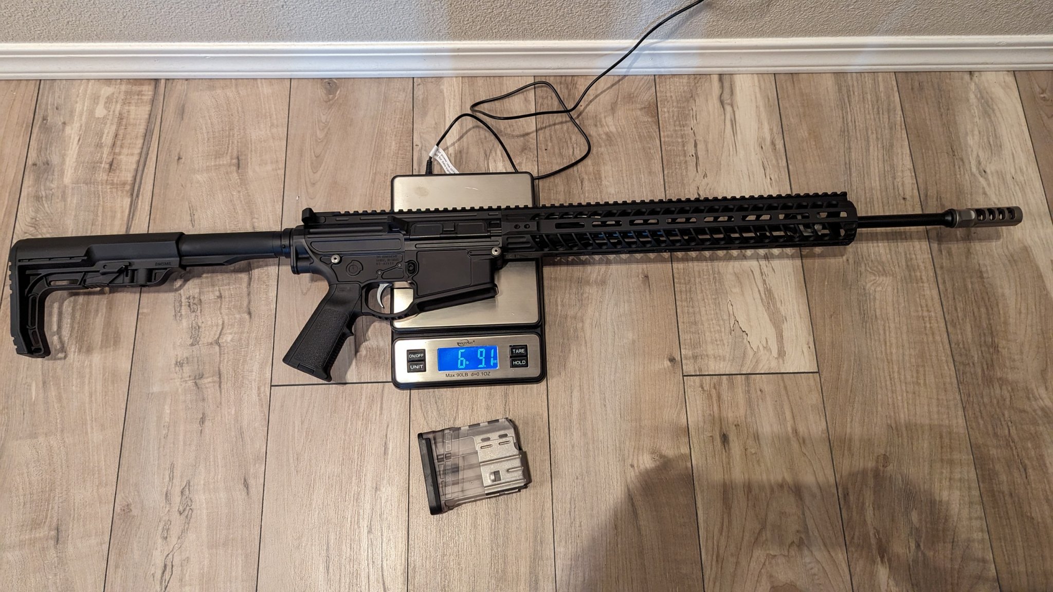

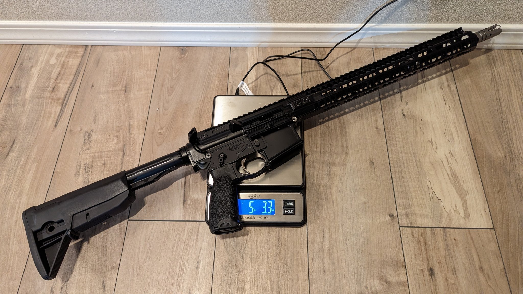

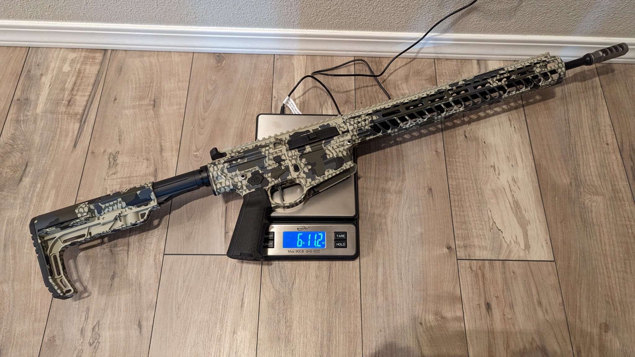

Happy to see more choices on the market. What does it weigh? Can it compete with the 2A Armament (sadly, now gone) offerings? Niche weapons...in the NEMO arms pricing range?
It’s not exactly in the same category (nor was it meant to be) as 2A Armament offerings…or NEMO for that matter.
7.65lbs as previously stated earlier in the thread. This is precision rifle, in a small frame, which is inherently lightweight relative to say a large frame. 😉
The 2A rifles I have, these are backups, are doing VERY well for me. I'm not in any way shape or form dogging a new product. We need them, customers are looking for them, but many of the advantages they offer are...not new. If precision is the ultimate goal the barrel is almost always the difference. I can't shoot these 2A rifles in a combat environment and expect consistent accuracy (barrel heats up...we string those shots). What they do provide is a very lightweight platform for hunting/initial engagement that has been very difficult to find over the years. The Ruger SFAR is a recent add to the stable that is performing very well for it's pedigree. It doesn't shoot as well as it's slightly heavier SCAR 17S but it's also a 3rd of the cost.
We very much look forward to what you guys have to offer!!!
2A Armament 16" 5.56 Balios Lite build - 5lbs 3.3oz
2A Armament 18" .308 Win Xanthos build w/cerakote - 6lbs 11.2oz
2A Armament 20" 6.5 Creedmoor Xanthos build - 6lbs 9.1oz

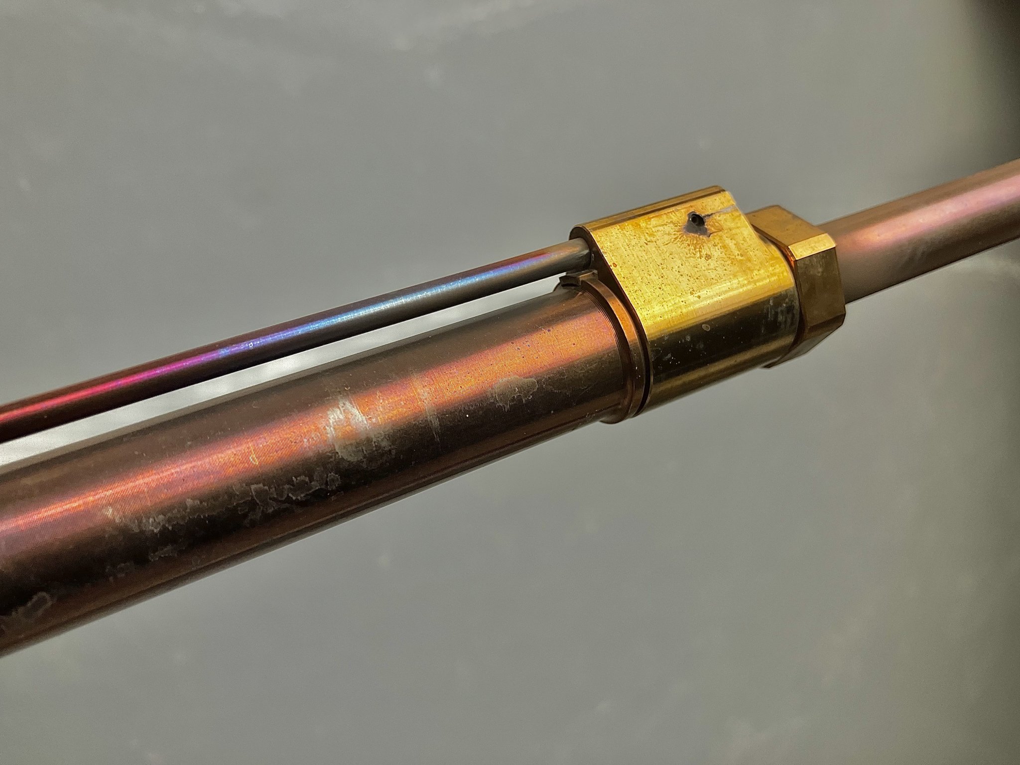

The gas block and journal confuses me. Why go to the trouble to cut a bunch of separate tapers and threads only to notch the rear sealing taper and roll pin the tube? Why not key the block on the sides outside of the rear tape and use a ferule on the tube? Seems incomplete from a design standpoint and you can see the where the prototype is leaking.
Well could it be improved on? Yes, I mean that’s how we got to this point of development, we took ideas already in play and made some improvements. Improvements are always a balance between performance gains and efficiency in effort, especially in regards to actually bring something to production.
Important things to note is what you see on the prototype in terms of fouling is 5000+ rounds of SURG and accuracy testing. The roll pin hole obviously leaks a little initially as the system fouls but seals up as carbon fouling builds. Additionally when you take into account how much easier a traditional gas tube and roll pin is in regards to manufacturing, it’s a compromise that makes sense. You gain a better gas system with marginal effort rather than building the “perfect” one at a cost that is 3-5x the price.
Here’s a closer look at the gas leakage. As you can see the tapered gas block does a great job and does the lion’s share of sealing it up. Again the roll pin and gas tube exhibit an expected amount of leakage but remember that’s a entire day of like 150+ magazines.
