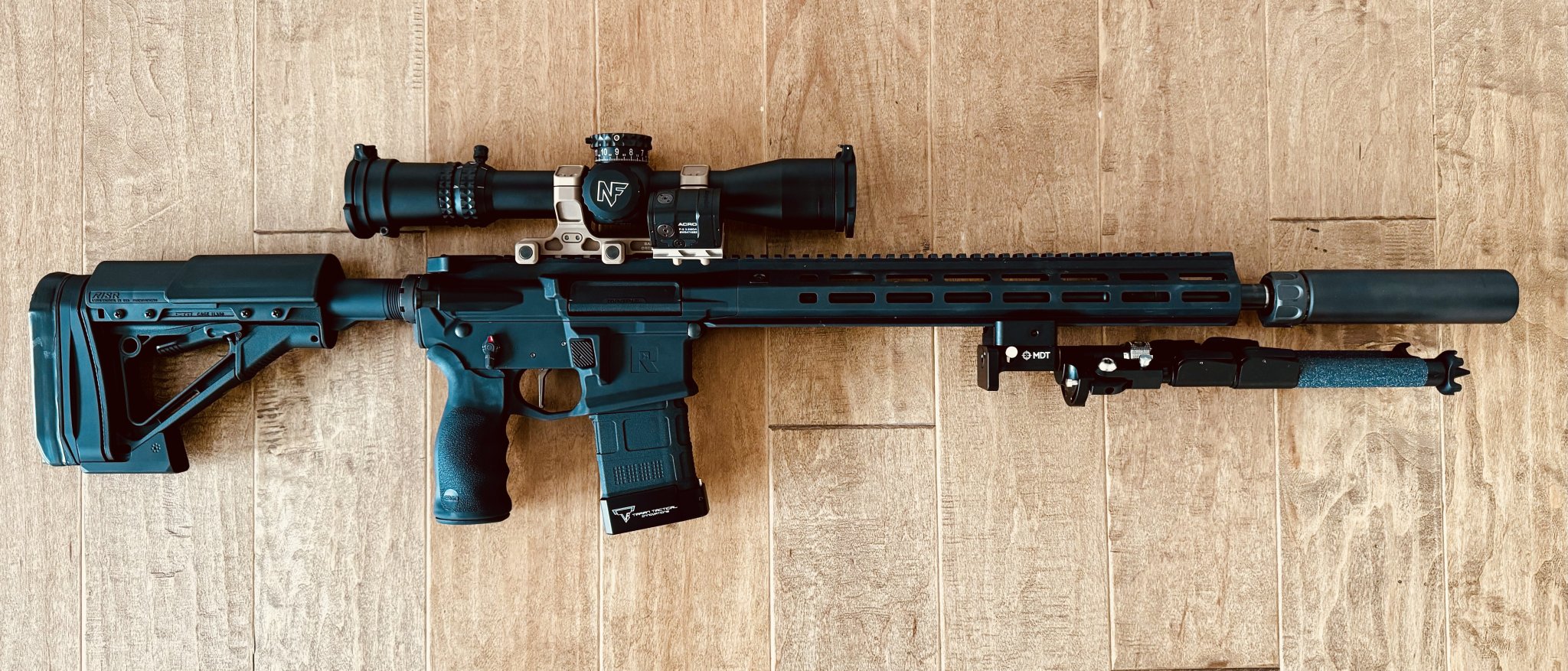

Just ordered one, now working out the optic situation. Will be running an ATACR 4-16x42 in an C1 and probably a closed emitter offset RDS. It appears that’s what you are running on yours. Which J-Arm height 1.54/1.7 and cant are you using, 35/45, and what height C1 mount 1.54/1.7? I was planning on a 1.54 C1 with a 35 1.7 J-Arm hoping an ACRO would clear the ATACR turret.
EDIT: Changed my mind going to run an RCR on a 12 o’clock piggyback on a C1, so please disregard…

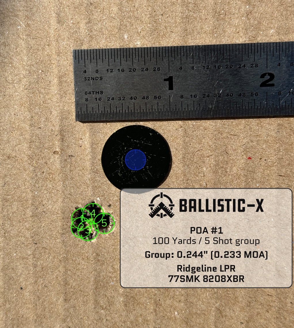

Had my LPR for about 3 weeks now, with 400 rounds down the barrel. Took Ridgeline's 5-day SPR class about a month ago, and got to shoot the instructors' rifles a couple times throughout the course. Was pretty much sold on the rifle after I disappointingly found out that my 16" SR-15 had 0.4-0.5 mils of positional shift going from prone/bipod to standing/bag and had some gnarly thermal shift after 30-40 round COFs (unsurprising given KAC's light barrel profile). For what it's worth, the RD-15 LPR is my first "precision" rifle with a stainless 416R barrel. I've only ever shot CHF chrome-lined barrels (mostly 5.56), and was generally satisfied with 1.5-2 MOA groups and being able to hit 66% IPSCs out to 400 yards. Some thoughts/observations:
1) Extremely tight fit between lower/upper receivers. The rifle breaks apart much more easily after generously lubing the receivers and pivot pins.
2) Muzzle device comes off extremely easily; not rocksetted at all. Surefire 3P went on easily.
3) After initial disassembly/lube, I went through Proof's recommended barrel break-in procedure (3+clean/3+clean/5+clean) with .223 55gr. Didn't bother using any bronze/nylon brushes, or a bore guide/rod. Just used an Otis cleaning cable, a couple of cleaning patches, and Boretech eliminator until patches came out clean.
4) With Black Hills 77gr OTM, I got a 10 round average of 2688 FPS (SD 14) after initial break-in. Probably about 15 rounds down the pipe at this point. Chrono'd again at 100 rounds, and got a 10 round average of 2673 (SD 9.6). Chrono'd once more at 200 rounds, and got a 20 round average of 2674 (SD 8). IMI 77gr (lot 292/C) performs similarly. Haven't tried feeding it with any other ammo other than 77gr SMKs. Barrel's probably still settling in since all of my other rifles are getting SD's of 4-5 with Black Hills. I plan to chrono again this weekend at the 500 round mark.
5) Group sizes vary between 0.6-1.2 MOA, average being about a minute (measured using the Ballistic-X app). Absolutely no issues shooting 6" steel at 400 yards. Every 1/5 groups on paper, I'll print a 1.5 MOA group. I shot the rifle yesterday, and had some disappointing 1-1.5 MOA groups when I went to check my zero -- could just be me generally being impatient with natural point of aim, or the barrel's still breaking in. The proof target that it came with had a 0.888 group (FGMM shot by Rudy), so I might have missed out on their latest batch of 0.3-0.4 minute rifles. Or I just suck at shooting.
6) Recoil/gassing-wise, it's similar to how a 16" SR-15 is gassed. I ran the KAC with an HH buffer and sprinco hot white spring with an RC3, and I would say that's the smoothest feeling set-up I've ever shot, but the RD-15 LPR is similar. The A5 system on the RD-15 is a solid choice, but the springco green spring it came with produced a pretty annoying twang sound. I got rid of the twang by generously greasing the buffer and spring w/ Slip 2000 EWG
7) Getting consistent 4-5 o'clock ejection with an RC3; the RC2 brings ejection to 3 o'clock. The rifle pairs really well with a flow-through, but it performs well with traditional high backpressure cans as well.

Had my RDR for about a month now I guess and here are my findings running a 4-16 ATACR and a YHM Turbo K RB on a Q plan B mount. The gun has only been fired suppressed and has about 500 rounds on it. All groups shot prone off a bipod and rear bag.
Test target it came with was .73 MOA. I've only shot 77gr IMI through it. I zero every gun I own with it because I keep a ton of it on hand. First outing groups hovering in the .75 MOA range with best being .67
I don't follow Proofs process. I do all the same love it or hate it. I shoot rounds through it typically 40 -100 the first outing. I then run a boresnake through it a few times. Done.
2nd outing groups tightened up delivering a best of .55 MOA and hovering in the .6 range. Got data every 100 yds out to 1000 and micro dope. No issues.
3rd outing groups consistently in the .5 MOA range and I have not grouped it again since but will after a few more sessions.
Velocity avg with 77gr IMI has been 2690 FPS
Cold bore shot measured shooting a 3/4 inch paster at 100yds first round of the day has been consistently center and 0.1 mil high.
No noticeable POI shift from various positions but i have not shot a ton of groupings but rather I've done positional work out to 1030 yds on various types and sizes of steel. Some of the fun highlights were 2nd round impact on mini IPSC at 1030 off a barricade and Shooting a know your limits target down to half MOA size at 650 yds. I have shot grouping at 100yds off a barricade with a game changer and no shift in POI.
Great rifle that addressed a lot of my complaints with other gas guns and so far I'm really enjoying it. Super fun to be able to get consistent impacts out to 1k with a lil 16inch 5.56.
