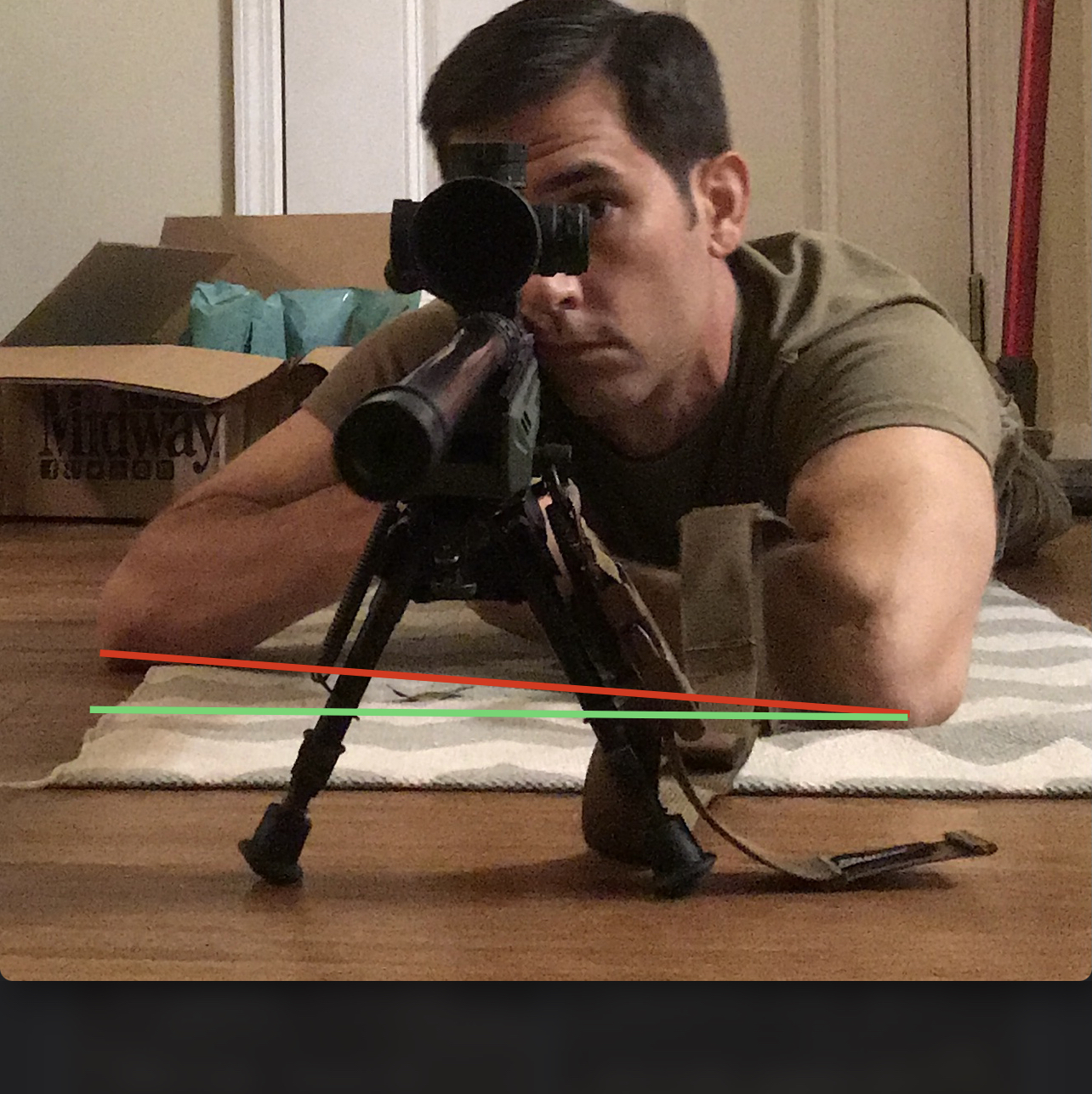

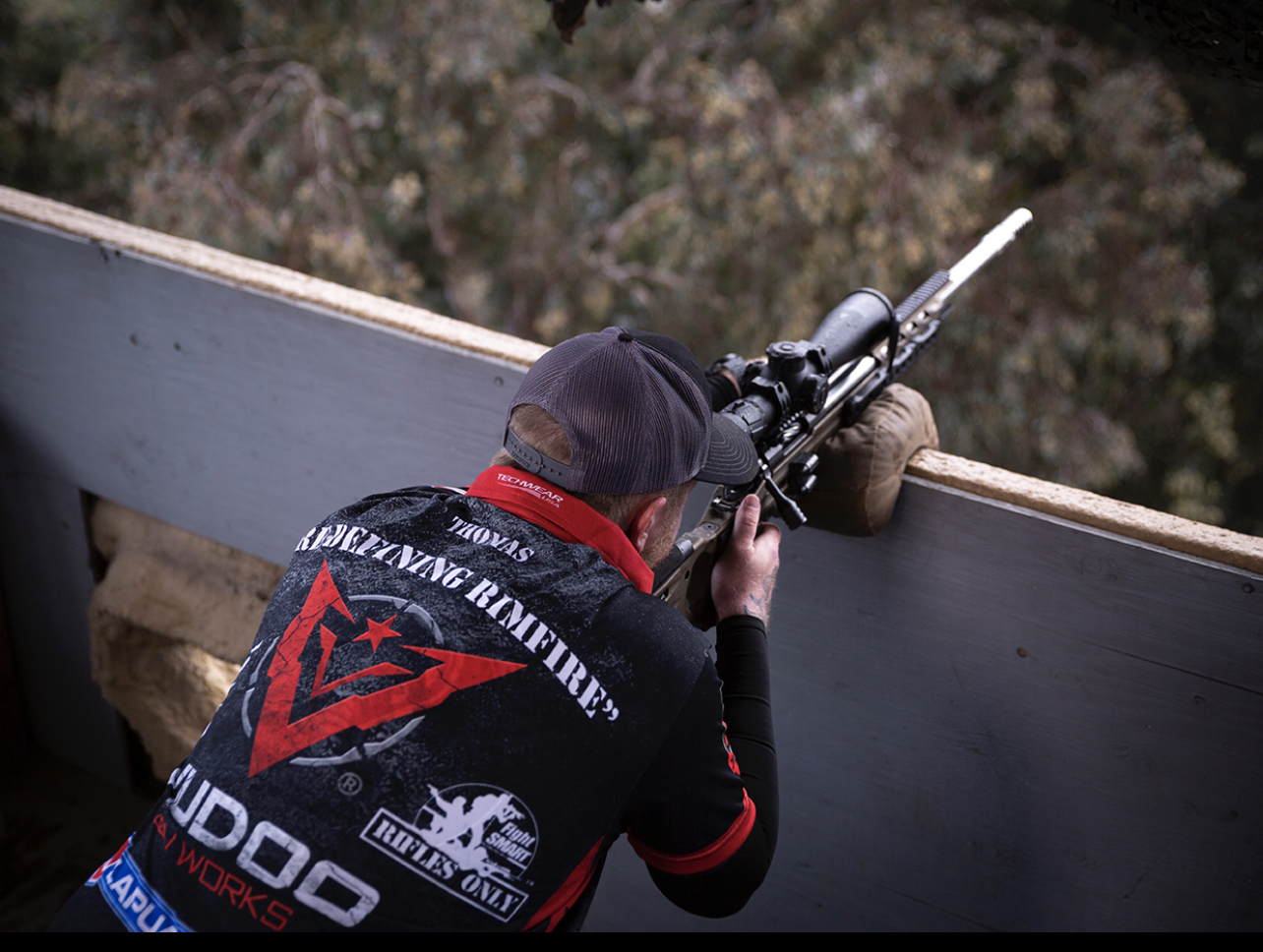

So I have been wanting to ask about this for a while since i haven't been able to get out and test it with live ammo.
So I been dry firing on my 60 yard target out back painted a quarter size on the plate in red.
I have noticed that on barricade if the butt pad is about 3 inches lower than sitting flush. Is alot better stability wise.
And in the prone about a half butt pad high is equally comfortable.
So my question is, it is beneficial to have it in that position. If feel like I can get more pad area in the pocket.
Picture attach on barricade for reference.

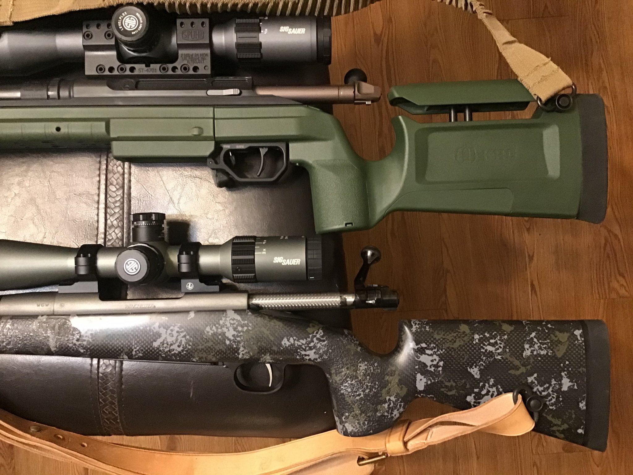

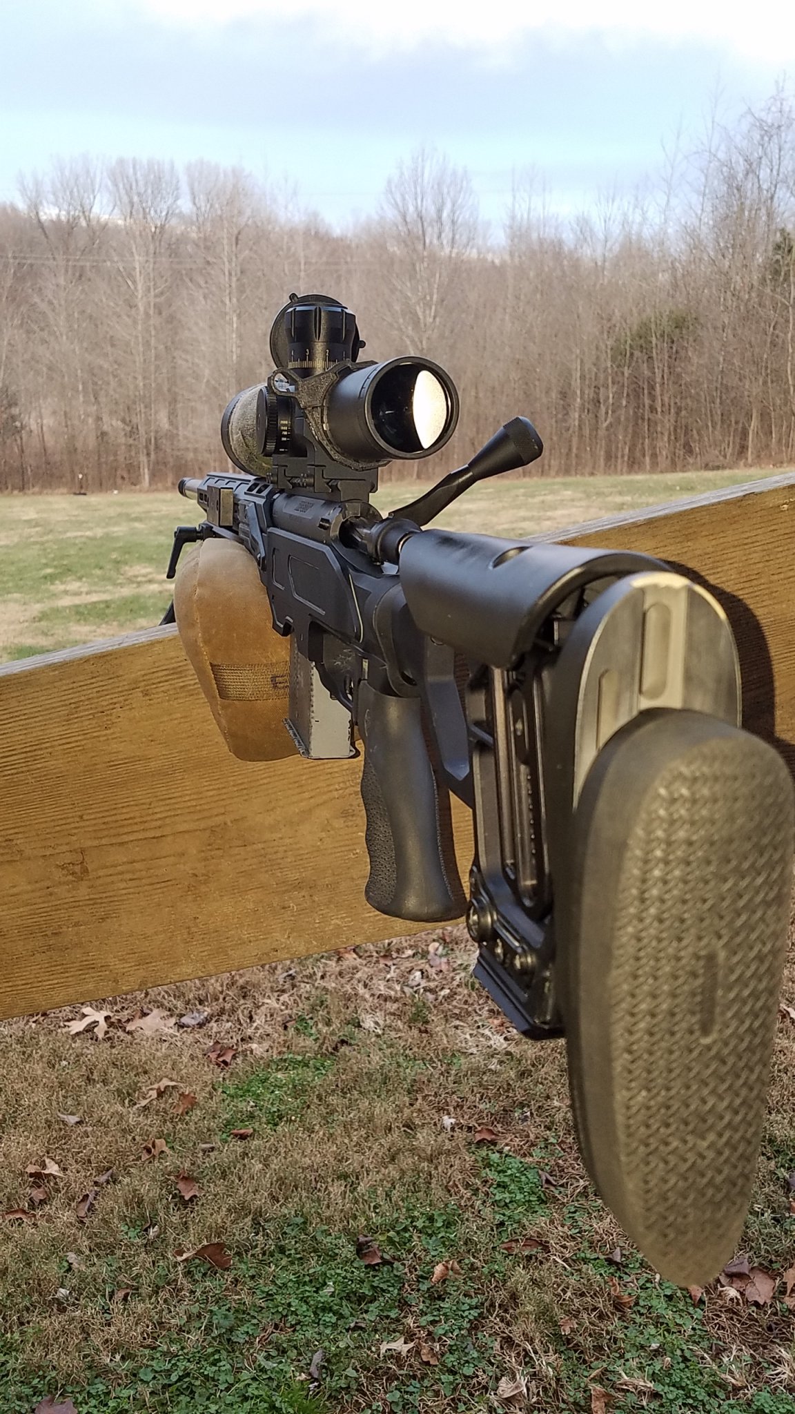

The lowered buttpad definitely helps with fit and control when you are more upright such as standing, kneeling, or crouched behind a barricade. The high buttpad is more for extended prone shooting such as an F-class or strictly prone. Since it may not be convenient to constantly re-adjust the buttpad for every event, you'll have to decide if you want to leave it neutral or slightly lowered for an "all-around" position.
Unless it’s a quick adjust butt pad, leave it for the position/s you shoot the most.
If you’re mainly shooting off things, leave it low. If not, adjust it to fit you better in the position you are mostly in. This is the same for setting eye relief for your optic.
I personally set my prs rifles up for barricade/prop shooting. You’re more erect (giggity) in these positions, so my optic is either back and my butt pad is lower. It’s not ideal for prone, but I shoot so little prone with those rifles, I can make it work.

So I ran a experiment today with the settings on the pad to help with muzzle rise as I was shooting.
The rifle is a hammer, the ammo was a friend old load development pack from copper creek. I zeroed with it and gained some expectations of the rifle and it shoots very well with the green band ammo. I was able to get a true 1 hold 5 rd group.
So I then moved to factory SRP Federal 107smk ammo @3080 fps.
I tried different pad heights to test this out. Low is below the bore moving to high above the bore.
All of this done on a barricade, fortune cookie. The rifle was pinched when my hand onto the bag and the fore end of the rifle it's a cadex chassis.
My wobble was about .2 mils on a 500 yard IPSC with a reference waterline.
Lowest pad position = alot of muzzle rise almost 3 IPSC targets above
Neutral position= about 1 target high
Higher buttpad = resulted in on target and able to see splash.
Still have more testing to accomplish but I also think that the lowest pad resulted in a heavy head pressure and that influenced the stock under recoil. As I moved the pad higher that gave less pressure on the pad.
I need to do some more testing I am gonna take take 10 rounds per pad positions.
But I will be testing again this weekend I'll report back with better test.
I wonder if I am getting my weight more inline with the higher buttpad and I am not doing the same with the lower pad.
But this is why we need to test everything.

ill be loading up some load development ammo and then some practice ammo, @Dthomas3523 taking your practice/load development post to heart.
But ill be loading some starter 6 creed loads at around 38gr of H4350 with 105gr RDFs. ill start testing from the lowest up to the highest pad positions with 6 rds each to get a idea of where i need to be all test will be done at 100 yards with 3 shots and then IPSC at 500ish and change for sight picture test. ill try to keep the shoulder pressure the same for every shot and see how it ends up.
I decided not to shoot my load development today since I wasn't 100% sure I was getting enough tension on my brass which I wasn't and the ES showed that today. I found the problem swapped the Wilson .268 bushing for a Redding .268 and it has measure more consistent than what I had
On to the test I shot the lowest pad position I felt comfortable still some pretty good muzzle rise but not bad. Then it dawned on me I am putting a lot of pressure on the cheek piece? maybe,
So I set it to the lowest position still comfortable and remained on target thru recoil at 20X from the Razor HD. spotting my shots on target
Then moved on to the next pad height about .75 inch or so up and repeated, a little bit better maybe not.
Then 1.5 inch above and it got a little bit better but nothing crazy.
and then I moved to the upside extreme and it was able to make out on the plate where it impacted.
So all in all it was basically attribute to having too much cheek pressure that was giving me the stupid muzzle flip. So it up to be about 1inch of pad above the normal flush setting. To work with Prone and barricade position so I don't have to adjust between stages. The less i have to mess with the better.
So what starts as a butt pad position ended up at a cheek pressure problem.

I just took a bunch of photos with my T3x, M70 and SOTIC...my head tilts between 5 and 15 degrees depending on rifle and position (standing, kneeling, prone, prone w/bipod). Oddly, my ”straightness” or squareness behind the rifle didn’t seem to have any effect at all.
I feel like some of this would be easier to grasp if I could actually do the setup as described. I suppose I need to up my stock/chassis game a bit.
Rings are probably too low. Here’s a couple pics. I run 1.42” ARC rings. Very little roll or titled head.
Don’t have the experience, perspective to know. This is apples and oranges because only one is off a bipod. Ironically, that’s rifle/position with the most roll over...or maybe I just suck at photo-ing myself on the floor of my house at night. Jaw/chin weld only for the other two...but sketchy at that.
You’re not close to being square behind the rifle with the bipod.
Being kicked off to the side is only acceptable when sling shooting and such. With a bipod, you will want to get completely square behind rifle.
Reactions: Forward543 and DJL2
The red line shows the angle you are at currently.
The green shows where you should be. Use your elbows to help reference. We need to fix that before scope location. As always, professional instruction is the easiest way to work on this.
Also, another reason it’s more rolled over is you’re up higher on your elbows in the other pics.
Raise your bipod for prone. The “get as low as possible” is outdated. Being low like that has you basically laying on top of your rifle and you have to roll your head.
Raise the bipod and get square behind the rifle. Your head position will instantly improve.
