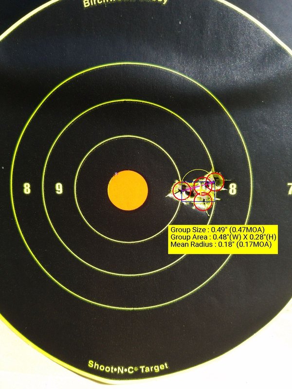

Got a chance to load some handloads on a buddy's press and shoot them and I am more excited about the potential of me and the RPR. I loaded a once fired winchester case with 40gr of IMR 4350 and used a 140 grain A-Max boolit set .30 off of the lands and I shot 2 groups under a 1/2 moa at 100yards.
Here is one of the groups before I got fully re-zeroed.

Nice job Big! I love the accuracy of this rifle. I've actually started to shoot a lot more ten round groups than five round just because between this rifle and decent handloads accuracy is just stupid good

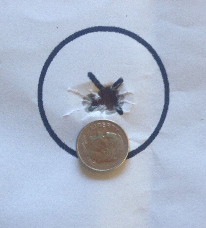

This is the best I ever shot with mine. 5 rounds bench, Harris bipod, rear bag. I think the spread was .177". Mostly it shoots .4 - .6 MOA

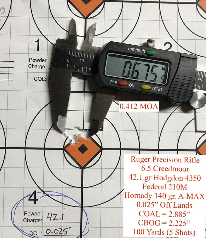

Found my OCW for my RPR in 6.5 Creedmoor. 42.1 gn H4350, Hornady brass, FED210M, 140 gn A-MAX seated 0.025" off lands. Best group I've ever shot in any rifle.
