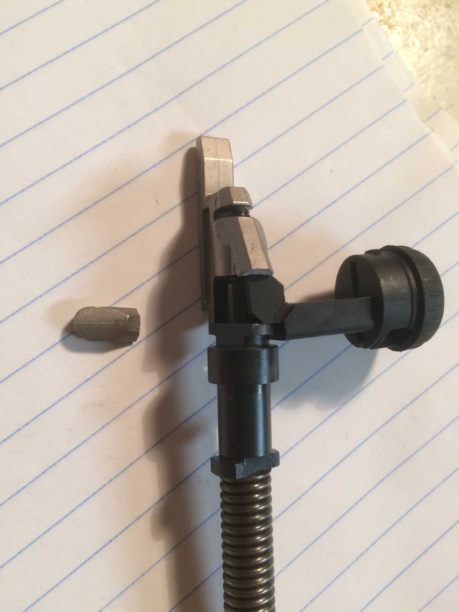

I was dry firing and noticed the sound of my firing all of a sudden changed. Took the bolt out, shroud off and I noticed the little piece of the ‘#3 - Firing Pin Back’ was broke off.
I wish they would just send a replacement but I’m assuming they’re gonna make me send the whole thing back. I sent them an email since it’s Sunday, otherwise I’d call.
Anyone with similar experience please chime in.
Your bolt handle was probably not down all the way when dry firing. As a result, the firing pin back hit the cocking ramp on an angle and broke it. The firing pin back is made to accept force in line with the firing pin, not at an angle. This is my guess.
Bang
Reactions: CV_Ag
Bang
I’ll remember that next time. I was starting to think I should load some dummy rounds to dry fire with but that makes sense.
And update to others. Ruger wouldn’t send that part out, had to be factory installed. Just had to send them the bolt though, not the entire rifle thankfully. Should have it back next week.
