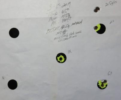

I noticed a dramatic difference after installing a Proof pre-fit. With the factory barrel, I was getting just under 1moa groups with handloads. Once I dropped in the Proof barrel, I started seeing sub-half moa. These barrels rock.

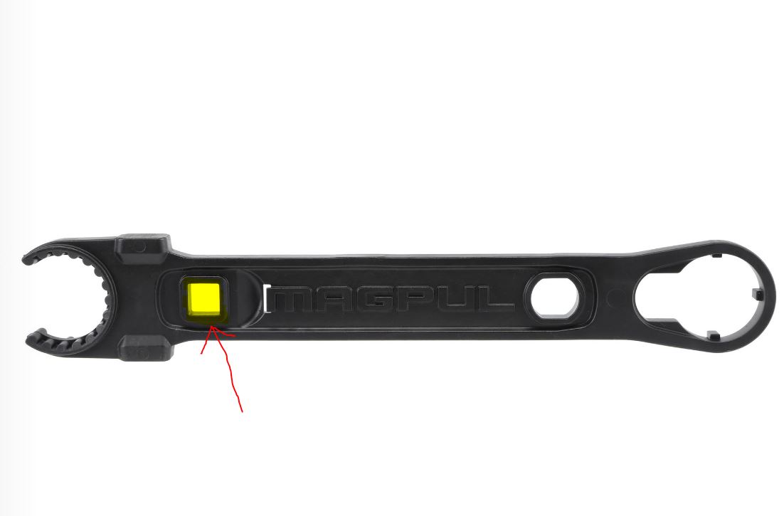

Pro tip: when removing the barrel nut, everyone tends to use a breaker bar with an armorer's wrench. In my case, I couldn't get the proper support/angle when applying pressure and it would slip off. I ended up using an impact wrench in the socket port of the armorer's wrench and the nut came off in literally two seconds.

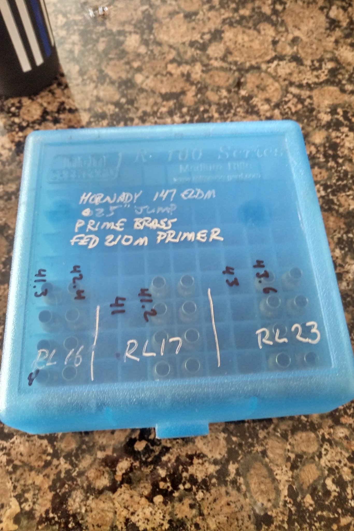

I'm gonna be doing additional load development shooting on Friday. Finalizing my loads for the 147 ELDm and Nosler 130 RDF. I'll post on here what the results are. I never like running near-max loads because I like my 6.5 barrels to last 3500+ rounds.
I've only had this particular barrel mounted for just over 2 months and already have over 400 rounds down the pipe. #pewpew
7038212
Powder charged and ready to seat my ELDm's.... But first.... Graveyard shift LOL.

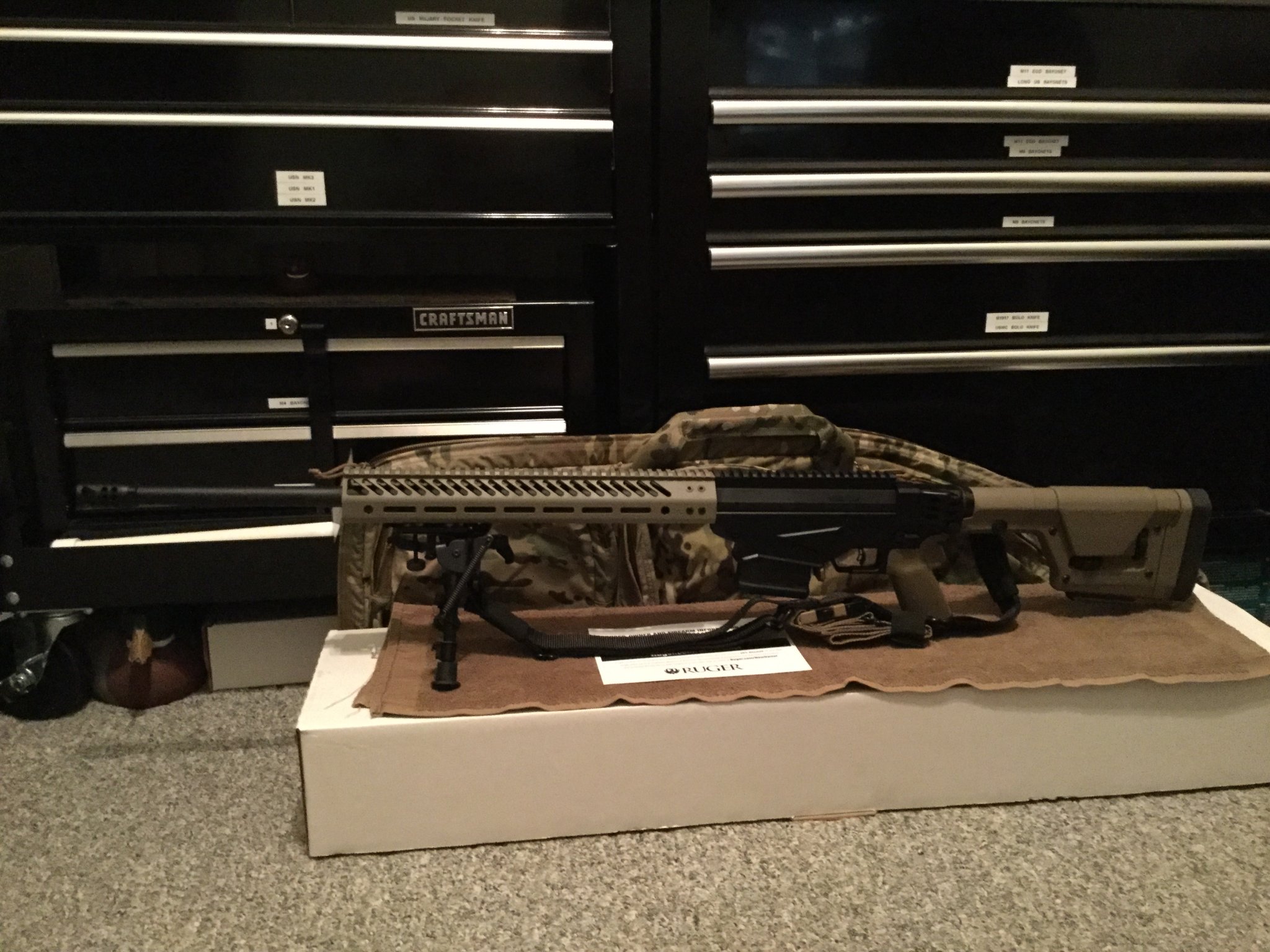

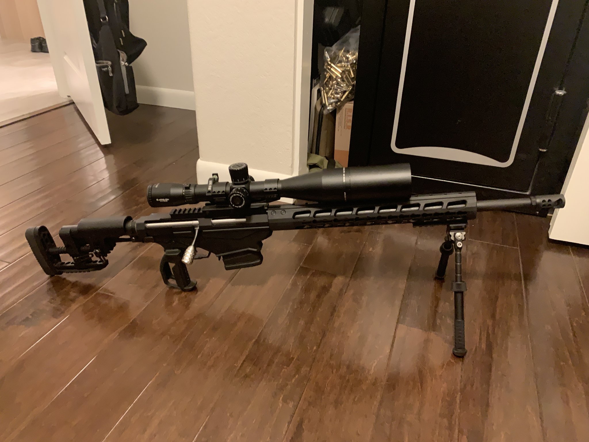

Just purchased a Ruger Precision 6.5 Creedmoor Gen 3.
Have made a few up grades with Magpul PRS Gen3 FDE stock, Magpul MOE + FDE grip, Catalyst Arms RPR Mag Release Extension in FDE .
In addition I added Anarchy Outdoors Titanium Bolt Knob and one of their Titanium Ruger Precision Bolt Shroud w/tool.
The problem I’m having so far is getting the original Ruger handguard nut off to install a Seekins Precision SP3R handguard.
I painted the Seekins Precision in Brownells Aluma Hyde Magpul FDE.
Is an adjustment wrench ? in say 18” going to get that nut off.
I’ve already tried with a 10” wrench and did not have enough torx to get it off.
Does Ruger use any Loctite on that nut?
The original screws holding down the original hand guard were really lose and very easy to remove to get the original hand guard off! No Loctite on those at all.
Any suggestions would be appreciated.

^ Nice rifle! I went with FDE accessories as well. I just like it. Ruger doesn’t use any thread lock as far as I know. I actually put my receiver in the vice instead of the barrel. I used my smaller 24” breaker bar and it came right off no problem. Super easy. Set it back to 70 ft/lbs. But mine is a gen one when things were a little easier. It seems they torqued the living shit out of things ever since
I received a reply from Ruger Customer Service today, they said "The handguard nuts on both the short action and the magnum are torqued to 50 ft. lbs and they do not have loctite on them. If you cannot remove it please contact us at 336-949-5200 to have an RMA number issued for return and we will be happy to assit you"
What I'm currently trying to do to remove the handguard nut is heating it up and putting Kroil on it for a period of time-10 hrs-will repeat the process tonight one more time and tomorrow will use a 1 3/8" crowfoot wrench and breaker bar 18" to remove it. If that doesn't work then I call Ruger for the RMA number and go that route.

Just a quick up date to my problem getting my Ruger Precision hand guard nut off.
A retired Marine and retired police armorer from my department suggested heating up the nut and then applying Kroil and then letting it sit over night.
Just for good measures, I completed the task three times about every eight hours.
A ordered and was awaiting delivery from Home Depot internet two Crowfoot wrench heads in 1 3/8” for the Ruger Headguard nut and 1 1/8” for the Seekins Precision nut.
With both in hand, a 5 pound vise with jell pads, 24” breaker bar and the nut came smoothly off with no effort.
Mission accomplished and new Seekins Precision SP3R installed picture below.
Only item left to add will be a Vortex Viper HS LR 6-24x50 with Vortex(Seekins) rings in 1.45”.
