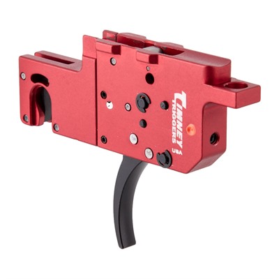

I’m looking for a high quality single stage aftermarket trigger for my 6.5 RPR. Any recommendations?
Have you considered the RPR trigger mod? I did this to mine and the pull weight is just under 1lb, which seems to be the most popular pull weight at the moment (according to the article mentioned above). With this mod, the factory trigger is not a bad option:
The weight is not so much my dislike as it is the creep. I feel like I’m pulling forever. Maybe it’s just the blade trigger that makes it feel like that but definitely not impressed.
Hmm perhaps try removing the blade? Give the trigger mod a shot, I was pleasantly surprised how much it improved the feel.
I've also done the mod (removing the trigger adjustment spring) and have fired over 4000 rounds with it that way . . . and I really like it. Though at 12-14 oz, there is just a slight bit of creep. But I wouldn't recommend having this trigger without the blade . . . because, if you do a slam test, you'll find the striker will let loose easily and that makes it rather dangerous if one happens to be carrying it loaded.

I felt like the RPRs I have bought (5.56 and 6.5) really needed a trigger upgrade. When firing a round, the blade in the trigger felt like there was sand in the mechanism. The feel made me believe the trigger pull was harder than it probably was. Replaced them both with Timney's and couldn't be happier.

I took my RPR trigger out as soon as I could. Mine had horrible creep. Went with the timney 2 stage and never looked back. I cleaned the crap out of it and it still had creep. I figured I just got a Monday/Friday made one. Practice will make perfect. Orrery soon with more trigger time behind the rifle and learning solid fundamentals you’ll be hitting a 10 inch plate at 800 5 out of 5. I wish there was somewhere around me to shoot a mile. The 6.5 is more than capable.
I have the flat bow Timney in my RPR and love it. I havent adjusted the weight from what it was set at out of the box but just the lack of creep, super clean break and lack of overtravel make it a huge upgrade from factory. I could not stand the feel of the blade on the factory trigger. I prefer 2 stage triggers so it was exactly what I wanted to begin with. I think I paid $170-ish and it was worth every penny.
Hmmm??? I wonder if there tends to be more creep in the RPR trigger at the higher pull weight than at the very low one's??? Since mine is set very low, I don't notice much. The same for my RPRR as I didn't notice much difference between the factory trigger set real low (e.g. with no adjustment spring) than the Timney trigger I am beta testing (which is a very nice trigger and I rate as certainly better than the factory one, but not a great deal more).
