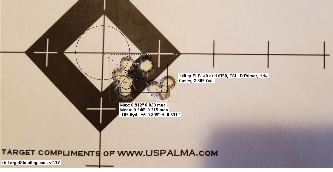

Well, I feel those NCC bullets seated in Federal brass with CCI200 primers and 42.5 gr of IMR 4064 worked out quite well. First shot with cold barrel was a flyer and next shots were on the POA dots . . . all less that .5 MOA. I think they'll probably do better if I tweek the seating depth. It's gratifying to me to be able to get results like that with really old eyes having a bit of glaucoma that makes it a challenge to see things really clear.

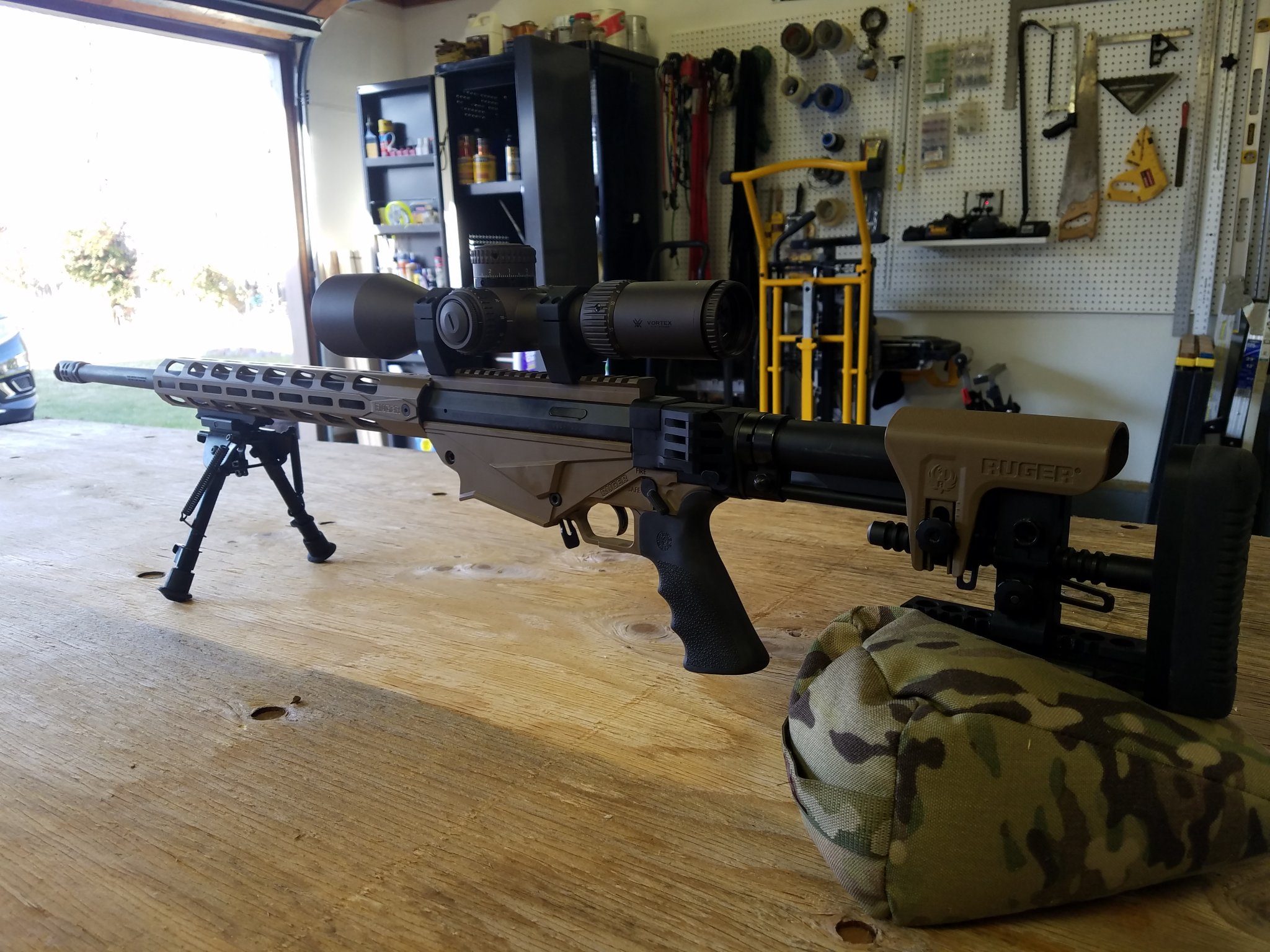

Thought I would throw a pic up of my RPR. It started as a Gen ii .308 from CDNN pretty cheap. The .308 shot fine but I really wanted a 6.5 Creedmoor. I found a new take-off barrel on ebay and swapped the barrel then added the Magpul furniture. I've found the PRS stock to be much more comfortable to get behind. I have a better scope on the way and may add a Timney trigger in the future. I've only got 59 rds through it but it seems to be a shooter. The target I shot today, 10 rounds. I'm an old guy with cataracts so I'll take it.
