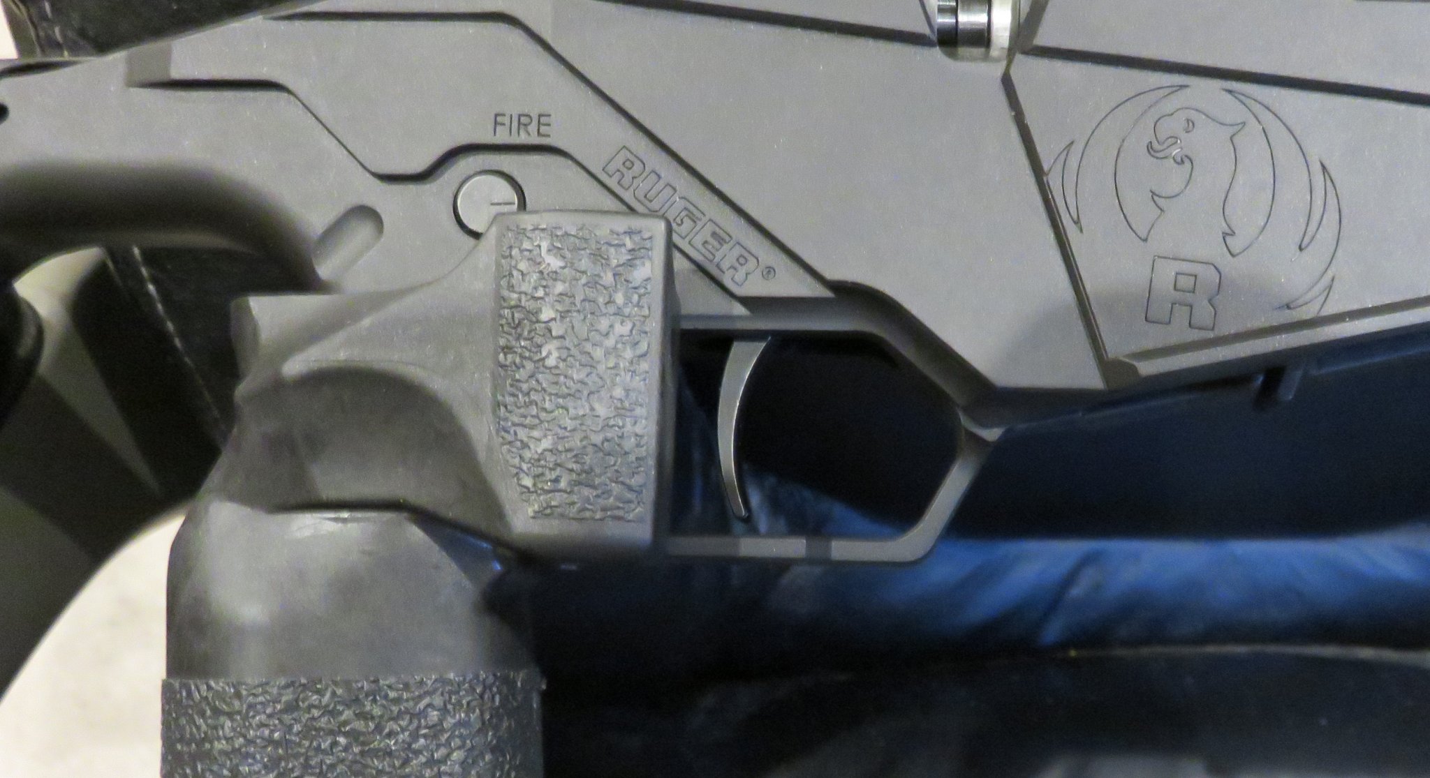

I went to Anarchy Outdoors and got the MPA EVG. I wasn't sure I was going to like it giving the design on how the trigger finger rests on a support. As it turns out, I love this aspect of it. It has made a significant improvement in shrinking my groups. Seemed like I was always fighting with the factory grip as I would often get a POI pulled off, even when concentrating on a good trigger pull. Now, the way it fits the RPR I seems I get a good trigger pull every time. I guess because it has eliminated some finger movement in the lower part of the trigger. My finger feels much more relaxed on the trigger than before.
This a pic from my RPRR and I have the same on my RPR (only with a factory trigger).
Every since I tried a McMillan stock I knew I liked that interface with the palm/grip. Was already thinking I may try one of these when I get my 6.5. Glad to read you saw tangible reproducible results

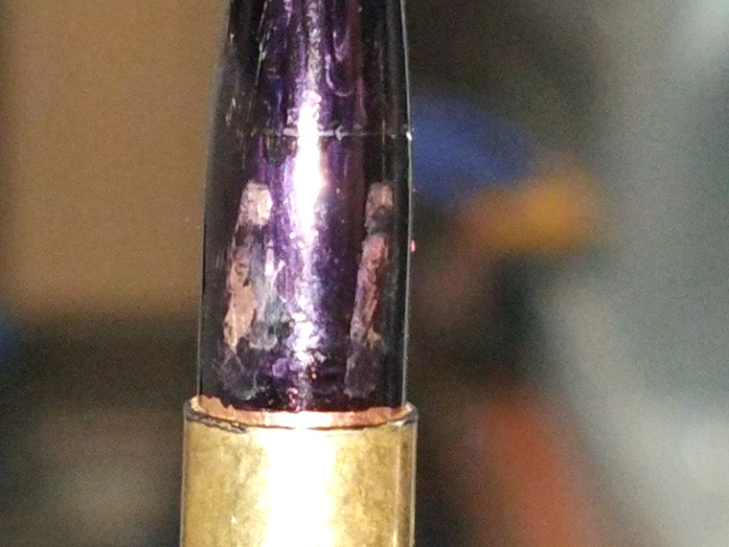

Thank you for all the comments. Howland I reloaded using 90 Gr of H1000

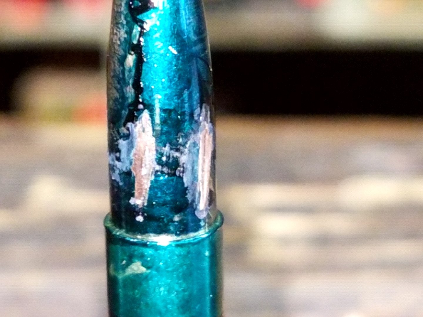

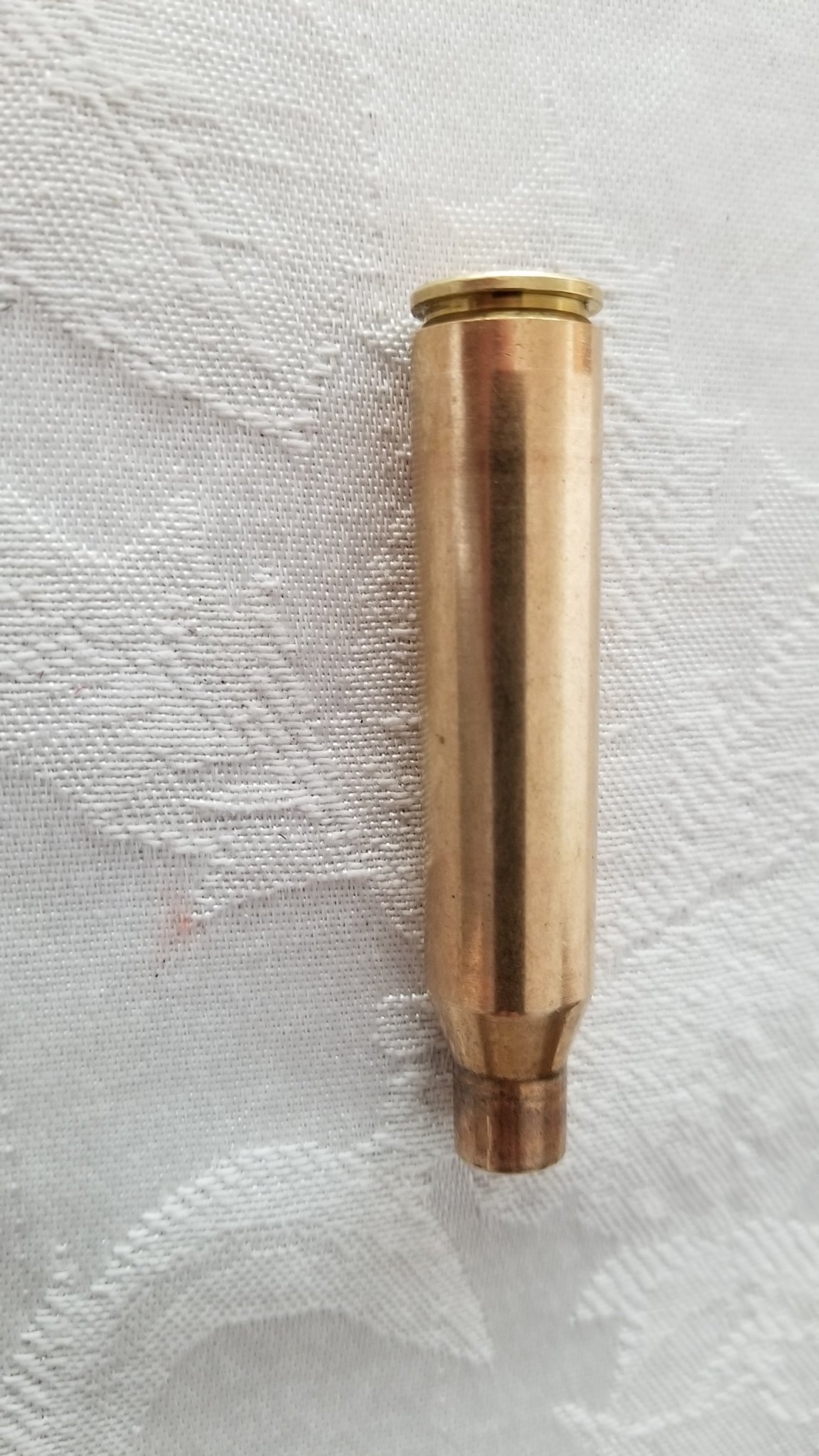

Today's research:
1. I loaded (5) dummy loads using virgin Peterson brass ((beautiful brass)
2. Cycled them thru the action at different speeds, no issues (dragging sensation, hangups) repeated 3-4 times. no issues (other than my wife scolding me for doing this at the dinner table LOL). Some longitudinal scratches from the magazine. no gouges. Bullet tips show some scratches indicative of a rough/sharp feed ramp
Notes:
Sharp edges on the feed ramp, ejection port and barrel extension. Ejection port and feed ramp also show brass smear marks
Following Ruger's instructions the lower (receiver?) was removed
Rework:
Using a Swiss round file I proceeded to break all accessible sharp edges. Sorry forgot to photograph the feed ramp and I am too lazy to retrieve the rifle from the safe. Metal removal was minimum.
Conclusion:
Close inspection of the initial cases showed different degrees of "gouging" from severe (shown) to minimum to none. Perhaps the culprit "burr" was removed during cycling/firing.
Unable to replicate root cause one solution was to address all suspect contributors: remove/limit sharp edges that contact the case.
Will find out more next range trip. Thanks
ACK
Update:
Shot the RPR yesterday after deburring all internal sharp edges. Hornady 285 HPBT, 89 Gr H1000, Norma brass, (2750 fps) max magazine length.
No issues. Brass shows some longitunal scratches (magazine?) but no gouging. Problem solved,.

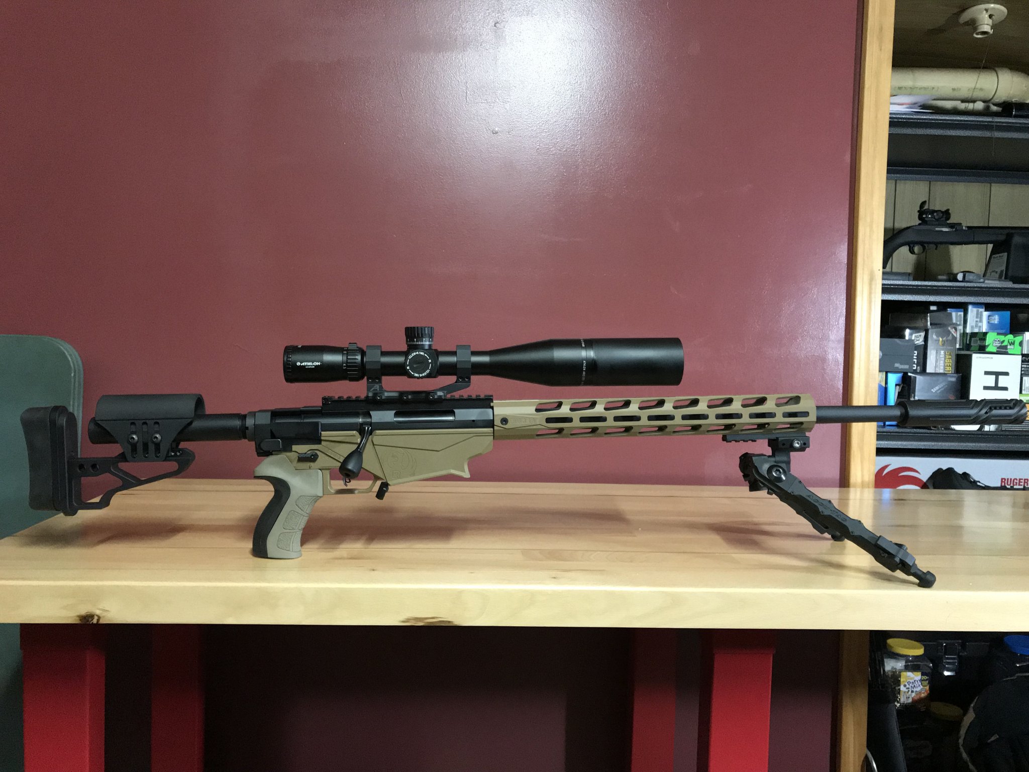

I'm a little torn on buying a new 6.5 Gen III or used I or II. Some really good looking deals locally, but I'm just unsure of every single mod made and if I may regret going backwards in generation. Would be grateful to hear your thoughts on that please.
GenII's strike a good balance between the Gen's in my opinion. On my GenII I have only changed out the pistol grip for a more ergonomic grip, otherwise I have been completely satisfied with the stock configuration.

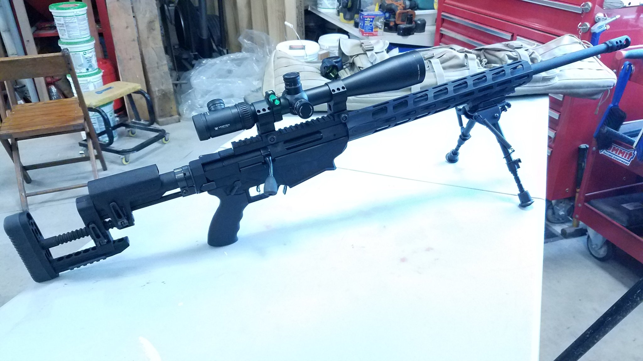

Well I have a Gen 3 I believe, I love my RPR. Think most things to change are matter of the user. I have change the pistol grip, Ambi safety, buttstock, added a mag release extension and have muzzle break ordered but found out I have to replace my scope mount so I have to order a new one at end of the week. Buttstock is nice but I thought it was difficult to adjust why I changed it
What stock is that?
Trigger, hand guard, and barrel I haven’t changed I believe. Trigger is planned, hand guard maybe, and barrel I don’t think I have to yet, my barrel seems like little lighter bullets.

Barrel will be my last part. I changed my handguard because I got the one I liked for a great price and it looks great. I have the flat Timney trigger and it works amazingly. Just got it back from a Cerakote job and will be going to the range on Monday to finalize the sight in at 100 yards. Currently, I'm only shooting 147g ELD.
