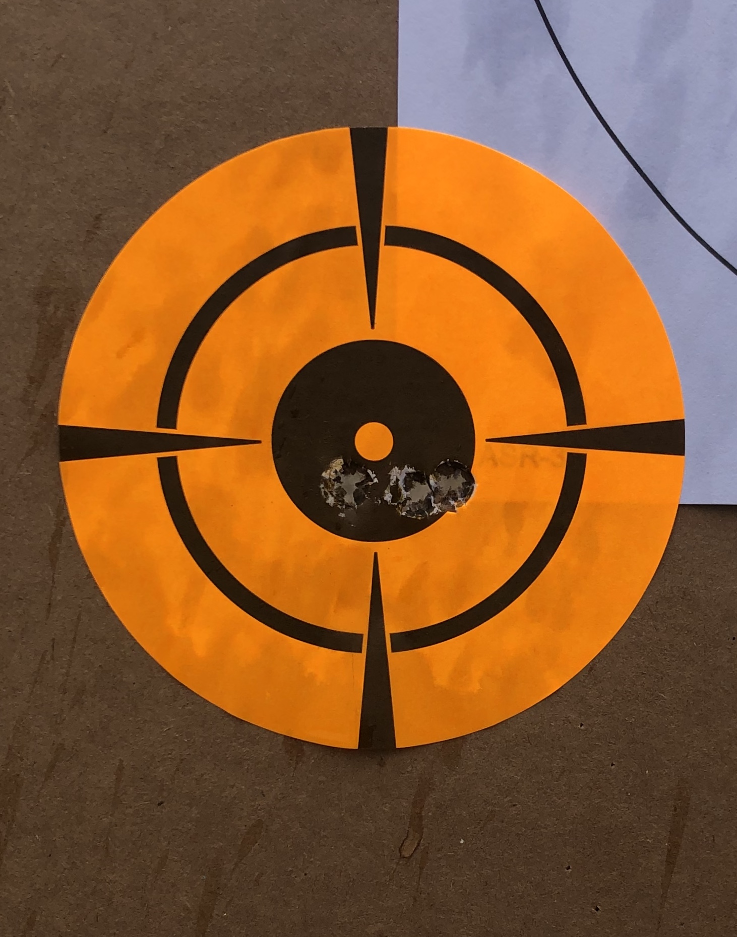

After a lot of load development, I finally have a satisfactory .308 load at 100 yards for my Gen1 RPR. 168gr Midsouth Match Monsters (performs exactly the same as 168 SMK) with 42.0 gr of Shooter's World Precision Rifle (Varget clone, supposedly). I'm getting 0.4-0.5 MOA 5-rd groups at 100 yards with a SWFA 4x scope, bone stock RPR.

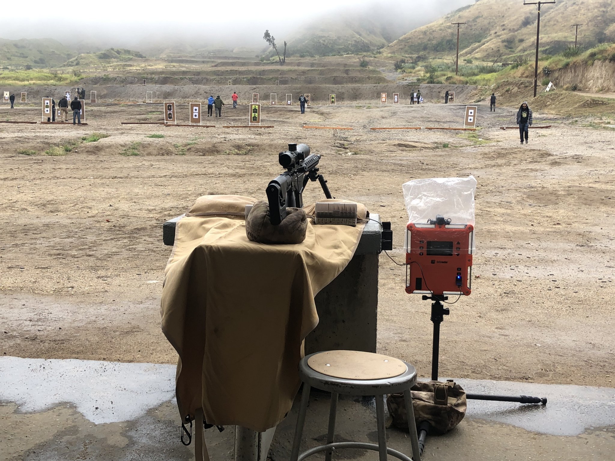

I am new to the forum. Thank you all for such great info. I shoot the 6mm creedmoor RPR. Last weekend I went to a local 200 yard match. To my surprise I was told I had to remove my muzzle break or put up deflector shields on the firing line. I decided to remove my break and shoot. I could tell recoil was increased alot. Anyone else have this issue at a shoot. This is a monthy shoot. I am trying to decide, do I keep my break removed or put up shields and reinstall.
I also recently shot a local match and although my "neighbors" mentioned they had some issues with the brake, no one really complained and it will remain intact. I do plan to make a couple deflectors before the next match. The league official basically said "hey, they can run a brake too if they like, same as you". I'm just trying to be neighborly. Guess it depends on the rules and how you want to handle it.

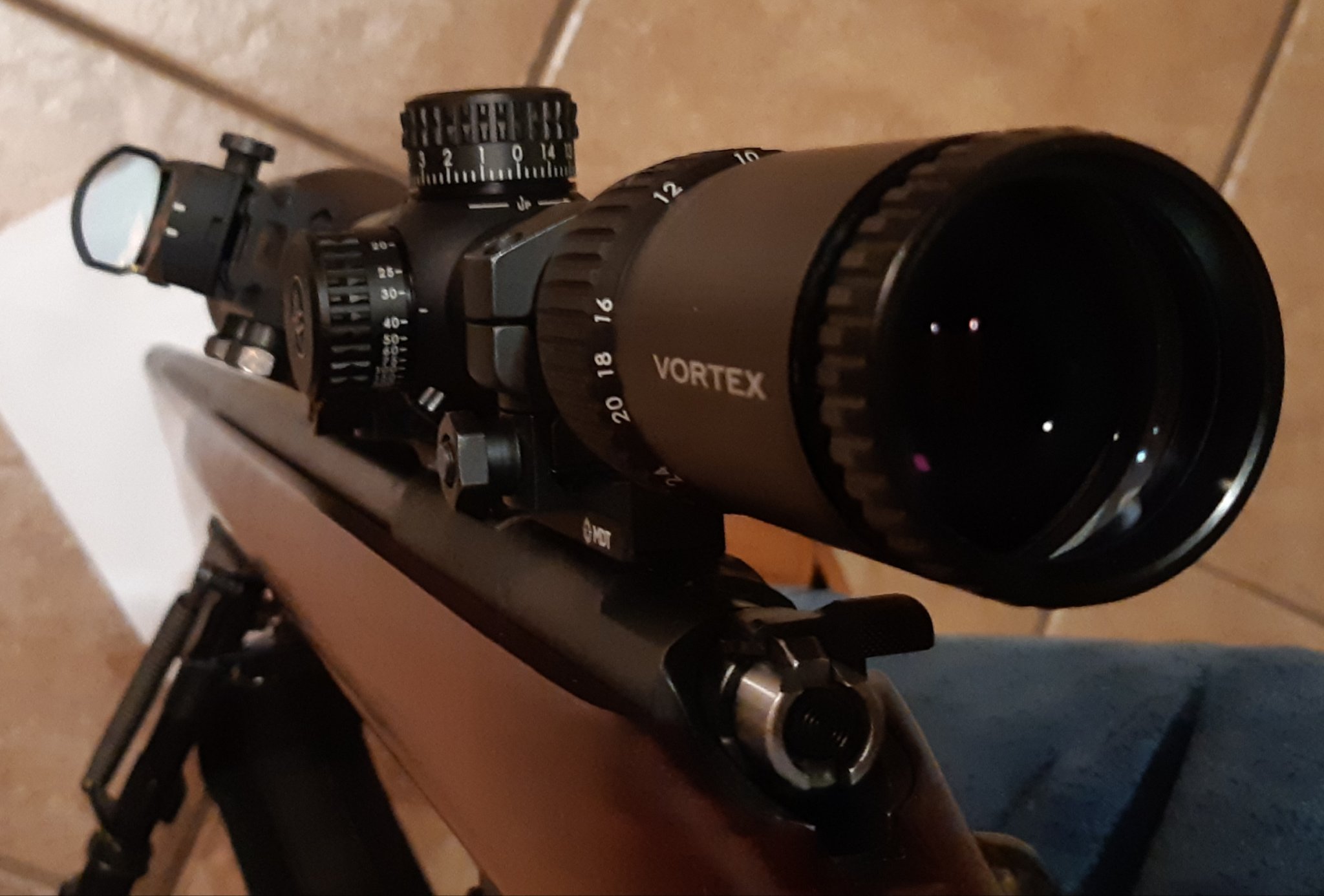

I have a trick for this that I've never seen anyone use besides myself....
I have no problem at all running at 24X because I do this...
Most PRS shooters get used to running at reduced magnification to widen the field of view so they can find the target faster.
The reduced magnification however costs them in precise target acquisition.
Some guys will run a red dot on a pic rail on the top scope ring, but then they have to head bob up and down between the scope and red dot to find the target. It also increases the vertical height of the rifle making it harder in confined spaces.
So my solution requires the addition of a scope ring picatinny rail that only mounts to the scope and I rotate to about 9:00 or 9:30
To that I mount a short riser block and to that I mount a Vortex red dot.
The riser block increases the distance from the scope far enough that I can see the red dot with my left eye while looking through the magnified optic with my right eye.
I don't need to head bob to find the target, I just focus on left eye to acquire, then concentrate on my right to shoot.
It would be nice if someone produced a proper setup for this where we could shim the height of the red dot to precisely align with the individual shooters space between the eyes. But this system seems to work pretty good even if it's not the exact right spacing.
Here's a pic from my CZ452 set up as described.

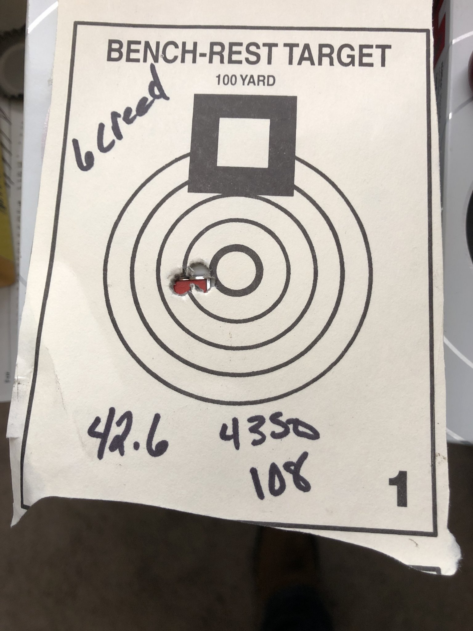

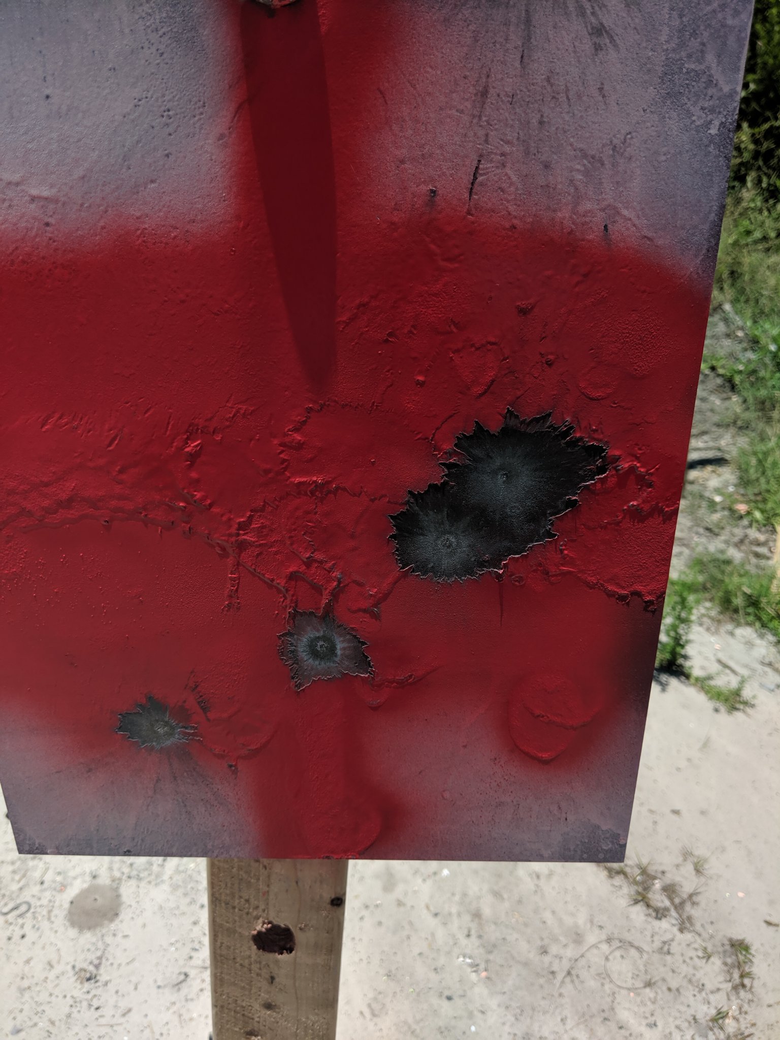

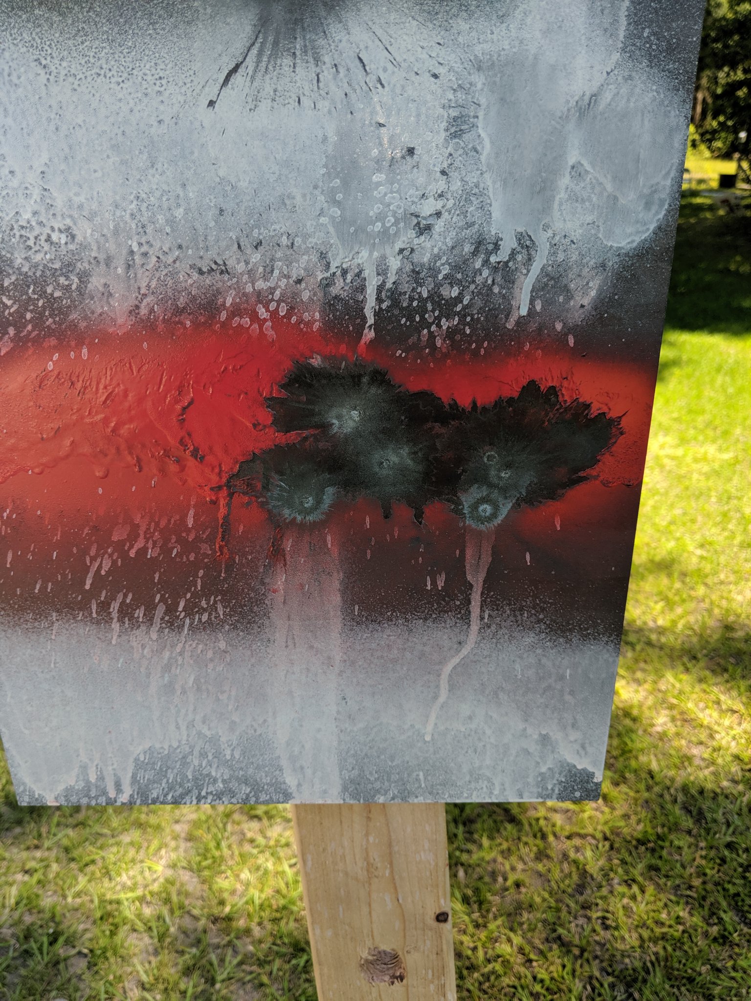

My 308 RPR seems to just hate ELD’s with a passion. But it sure is liking old school BTHP’s. I’ve had a good load with 168’s and this past weekend I worked up some 175 CC’s. The 44gr load shot great. SD of just over 7. And workable average velocity of 2555
7086396
7086397
Nice, I started reloading last year. I've only done two cartridges, 243 and 6mm CM. Both times I used the 107 SMK which is a bthp I believe. It's given me great results. I chose it because supposedly they're not seating depth sensitive and I didn't feel like messing with that.
I burned through about 40 eld’s Trying to find a decent charge, and found nothing with velocity consistency. Then tried a smaller range with 3 different seating depths, much closer to the lands, and still couldn’t get either consistent velocity or accuracy. I kept trying at different weights since so many people had success.
I don’t know what it is. Even with the 6.5 factory eld ammo in my tikka. Match eld factory ammo shoots horribly compared to factory American gunner.
Same here with my 6.5 RPR. The best load (and I use the term best very loosely) was 41.6 gn of H4350 with 140 eldm jumping .030 thou. It was absolutely terrible.
Best pill ended up being the Berger vld target 140 gn. with 39.3 gn of h4350. Shooting .3 MOA 5 shot groups consistently out to 700 yards. Not the velocity I was really looking for but anxious to see how it groups at and above 1k yards.
