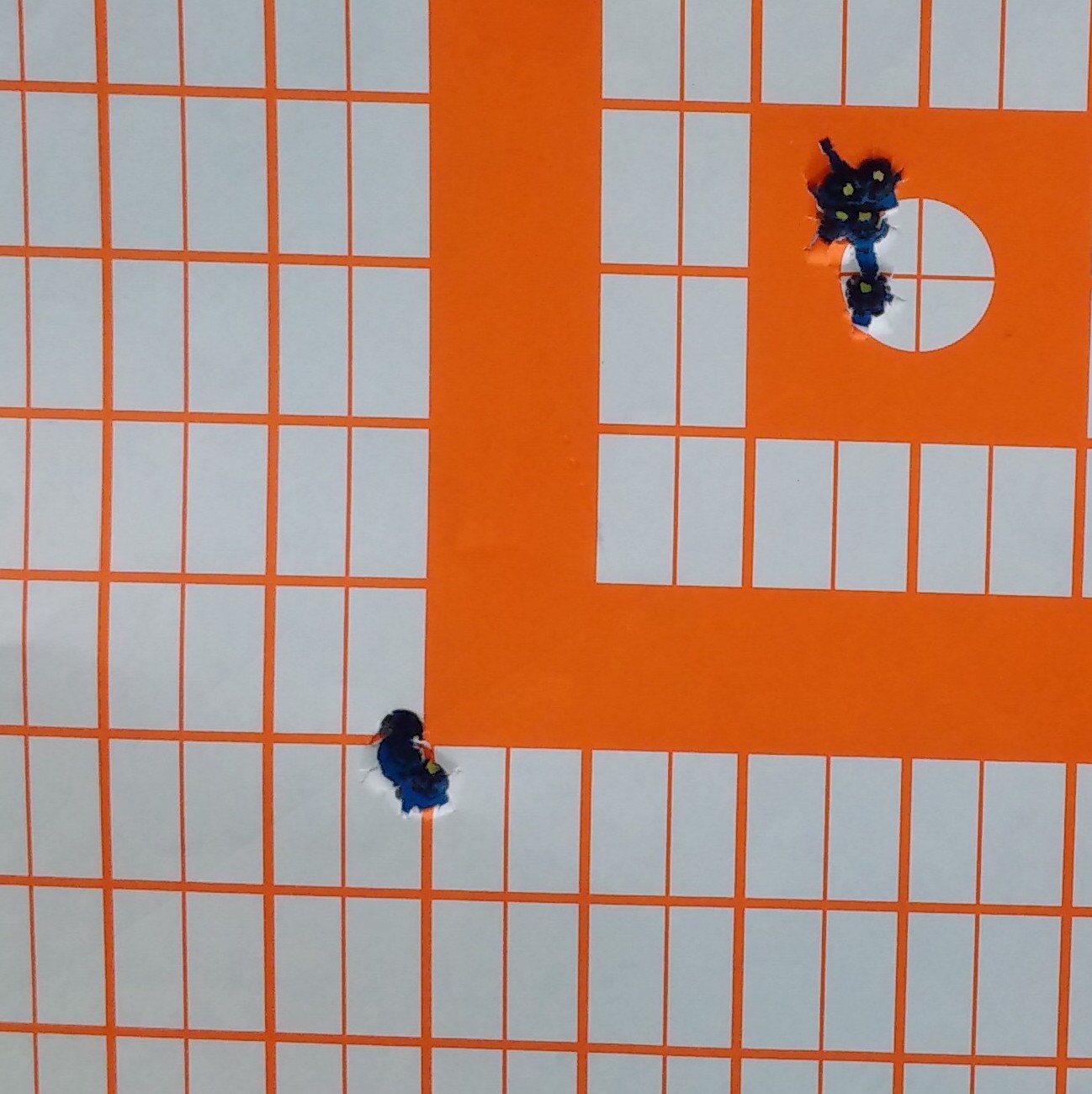

Just shot this 100yd 5-shot group (lower left) with my 308 RPR during load development. I love this rifle!

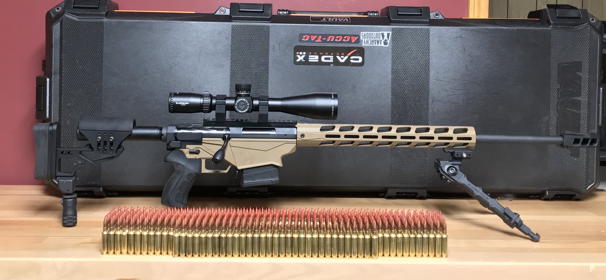

Well got around reloading some ammo, sadly my RPR doesn’t really like 100 gr bullets, but I got them on sale so have 455 rounds of plinking/practice rounds.
Also few new items, titanium fluted bolt shroud, accu-shot mono pod.
Looks great. What rear support is that?
Surprised you reloaded so many without actually testing them. Perhaps different powders. Try a ladder test.
^ The Accu Shot mono pods are really nice. I’ve owned a couple. I find they work better on the bench or harder surfaces though. Prone on grass or a field I need something heavier like a decent squeeze bag. XLR stocks are the bomb
I did do load test, 5 different powder loads with 5 rounds each. Hottest load group the best out them. I had some 120gr eld match and 129 SST. Shot two groups of 5 with each ammo then grouped with in a penny, where even hottest load it About a quarter sized.
Also I got the bullets, and powder on sale. LGS owner was retiring, got bullets at $17 a box of 100 and powder at $24 per 1lb so sure it sucks they not super awesome but at price I can’t complain to much for 455 rounds of ammo
Leaves to believe my RPR likes 120-130gr area, so I’m going to buy some 120, 140 ELD match, and some 129 SST do more testing. So like I said I have 455 rounds of plinking/practice ammo

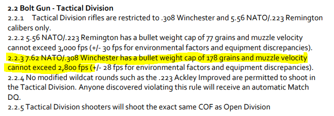

If you're a PRS shooter, 190s are over the weight limit for Tactical division... or it was last time I checked.

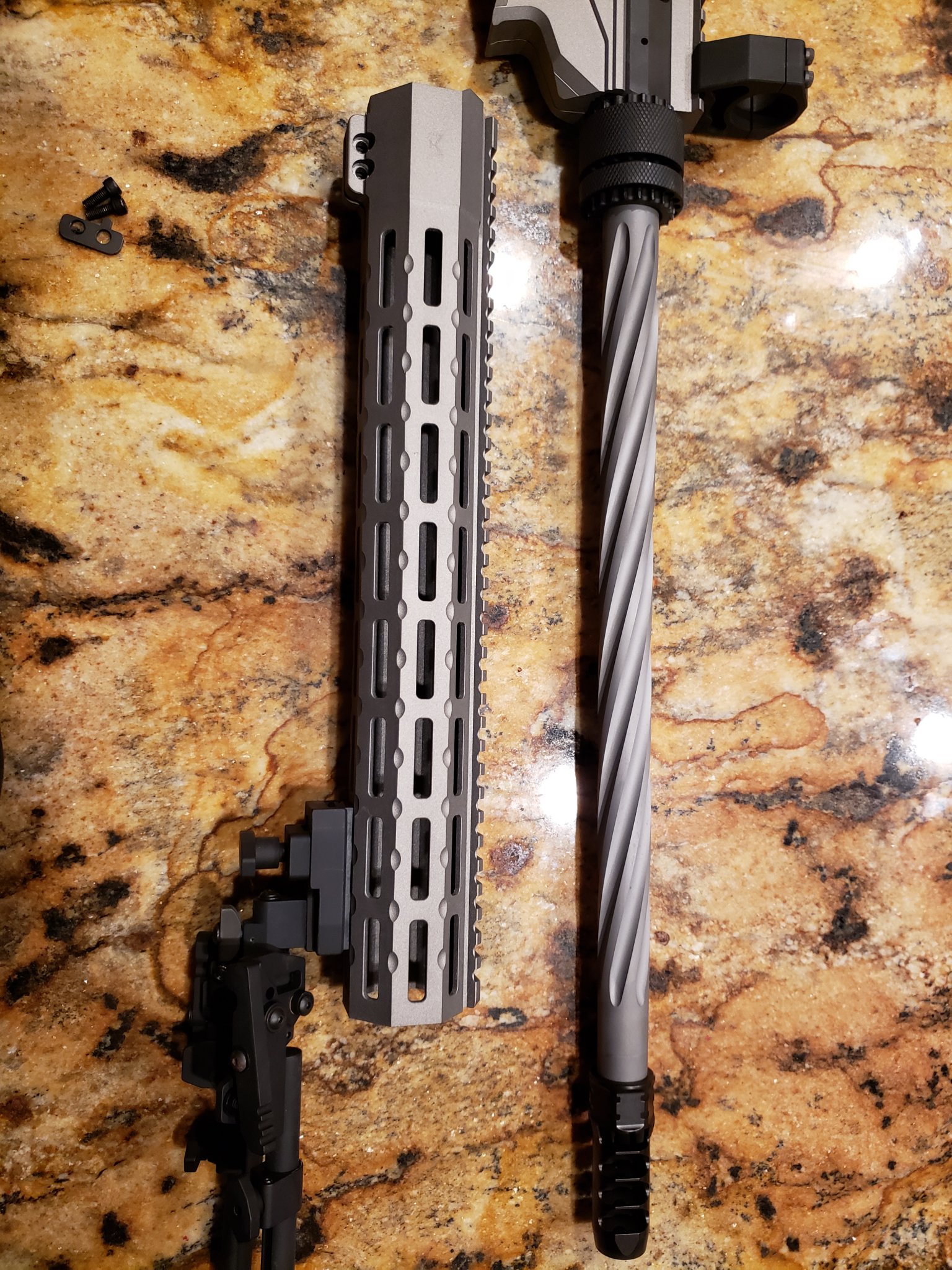

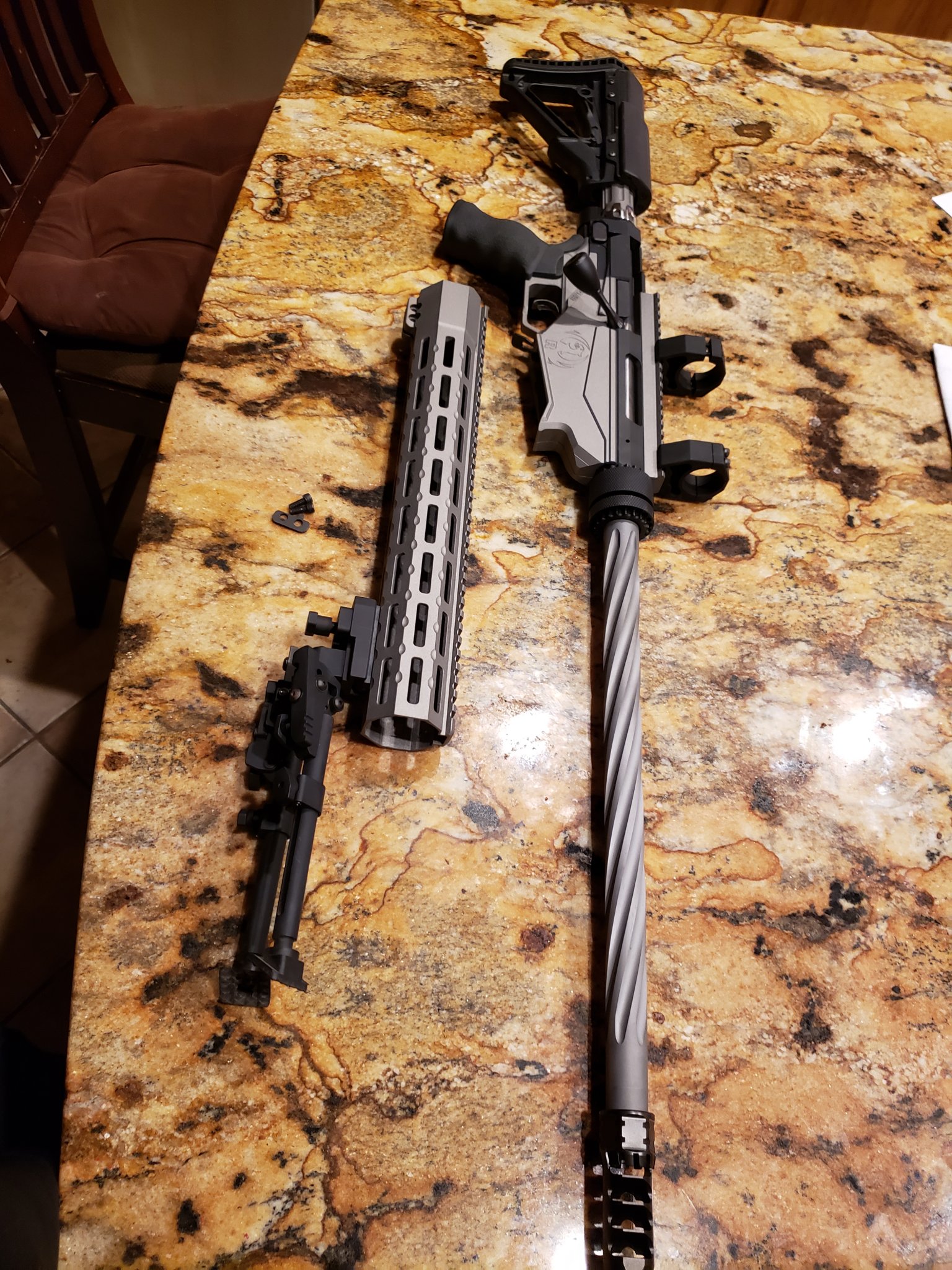

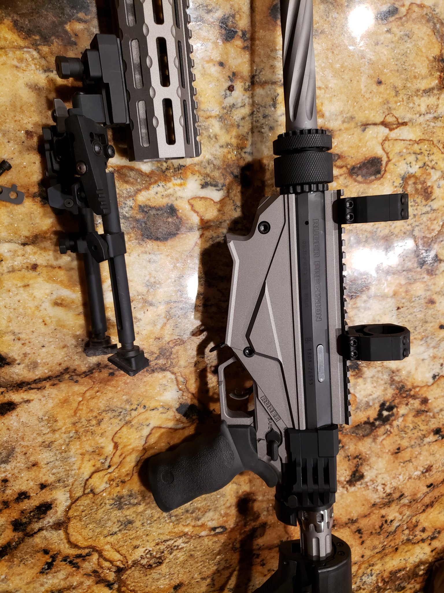

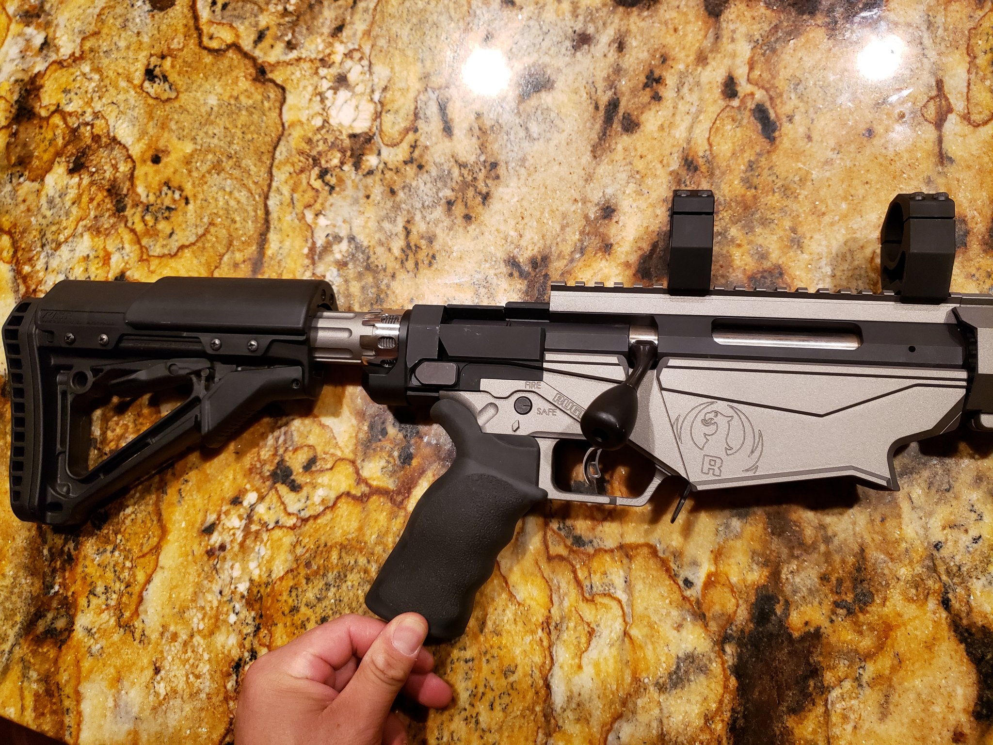

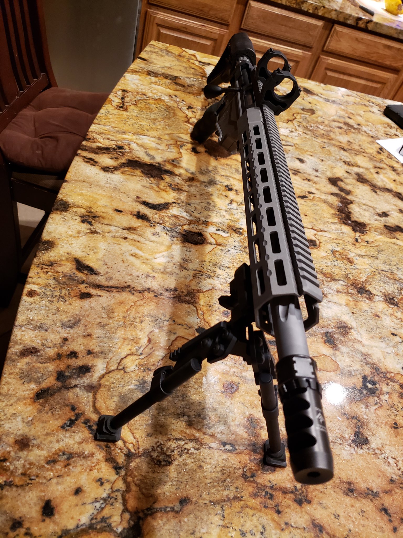

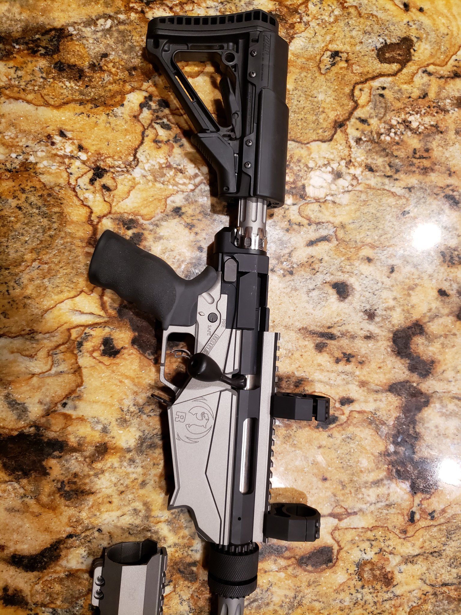

Well I just got mine back from RWS, WOA 6.5 barrel cut to 18" spiral fluted and had a MI handguard put in thats rock solid and cerakoted tungsten, CTR and riser with fluted extension matched cerakote, shaved it down from 10.7 factory to 8.9 pounds, qaiting on the vortex scope, fluted shroud and titanium fluted bolt knob, its not Q FIX weight but im more than happy
Looking forward to a range review
