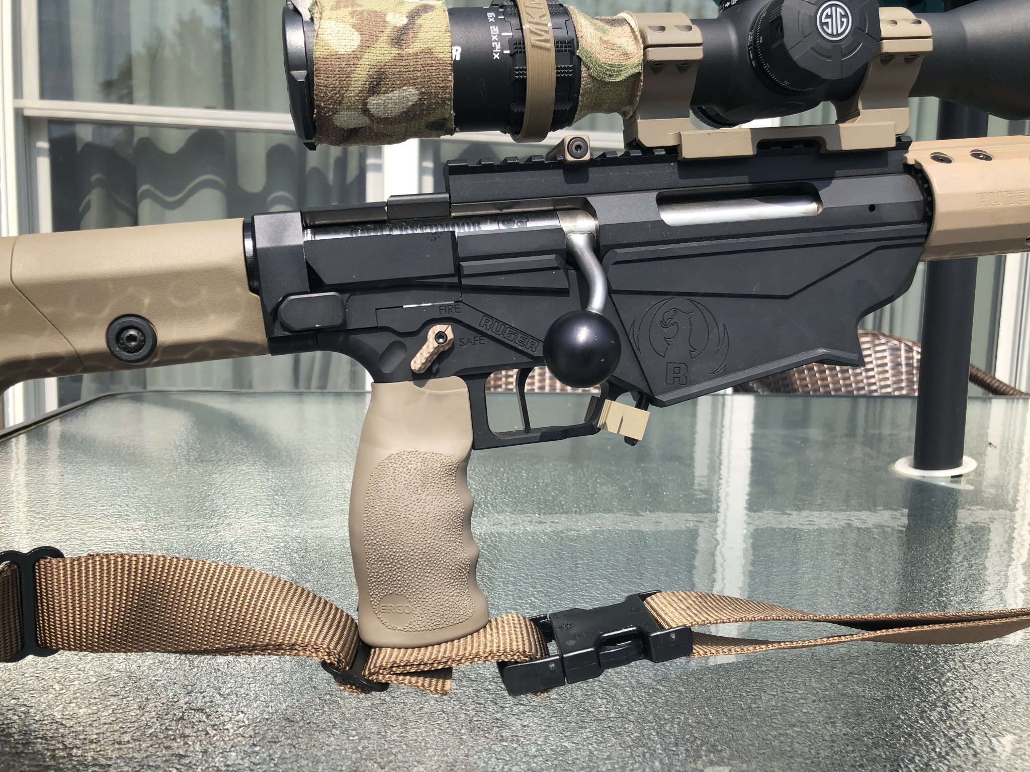

I tried out the new Ergo on the RPR. So far I like it.
Reactions: ChrisH56

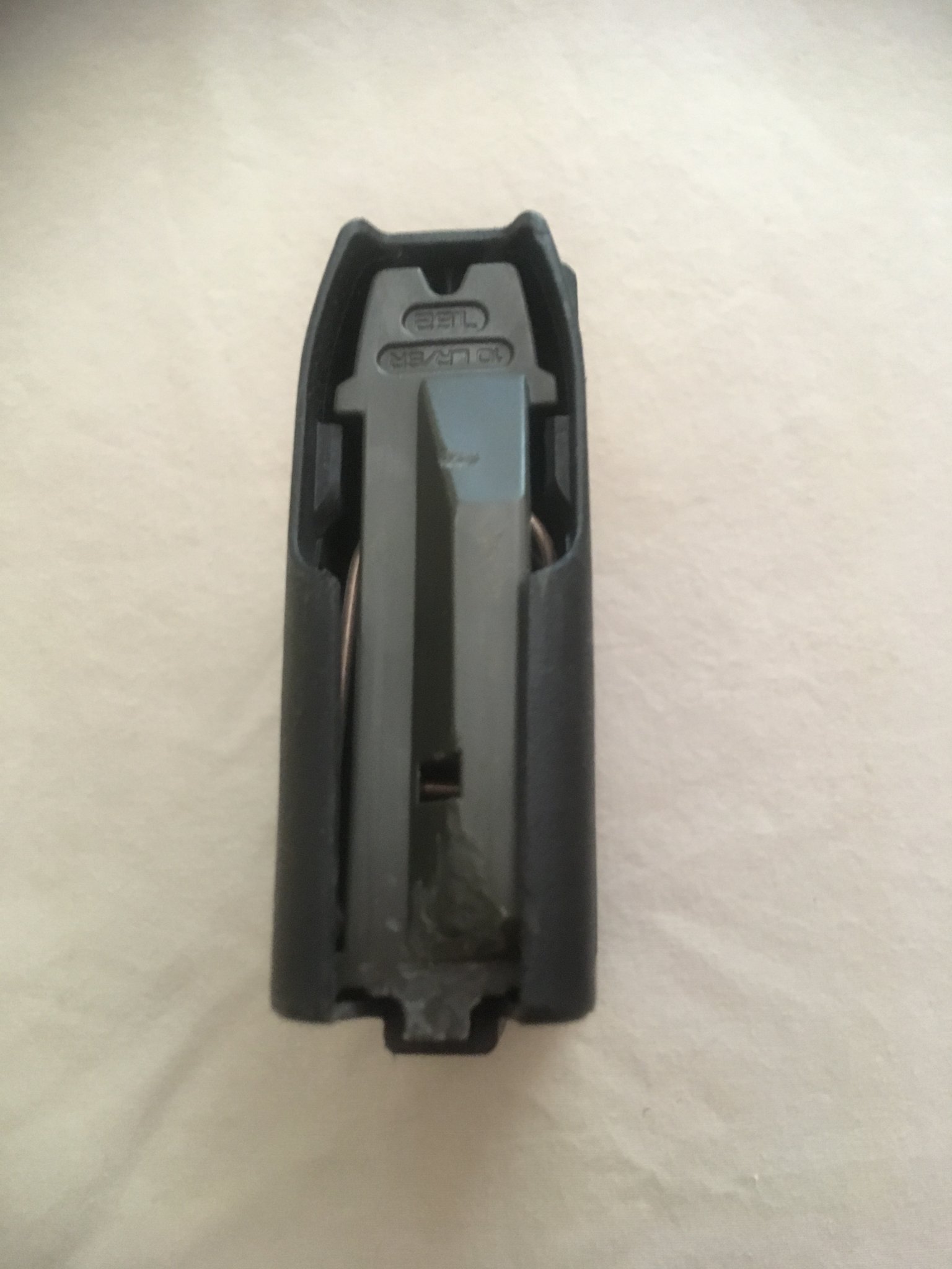

Does anyone make a magazine for the RPR that you can close the bolt when the mag is empty? I single feed bullets a lot of the time at the range and it's a pain with the factory mag.
You can use a dremel to buzz the bolt stop off of the mag (which I have done to all of mine). There are a couple of mags that fit the RPR that don’t have a bolt stop but I don’t own or have used any.
You can see here where the corner of the bolt stop has been ground down
