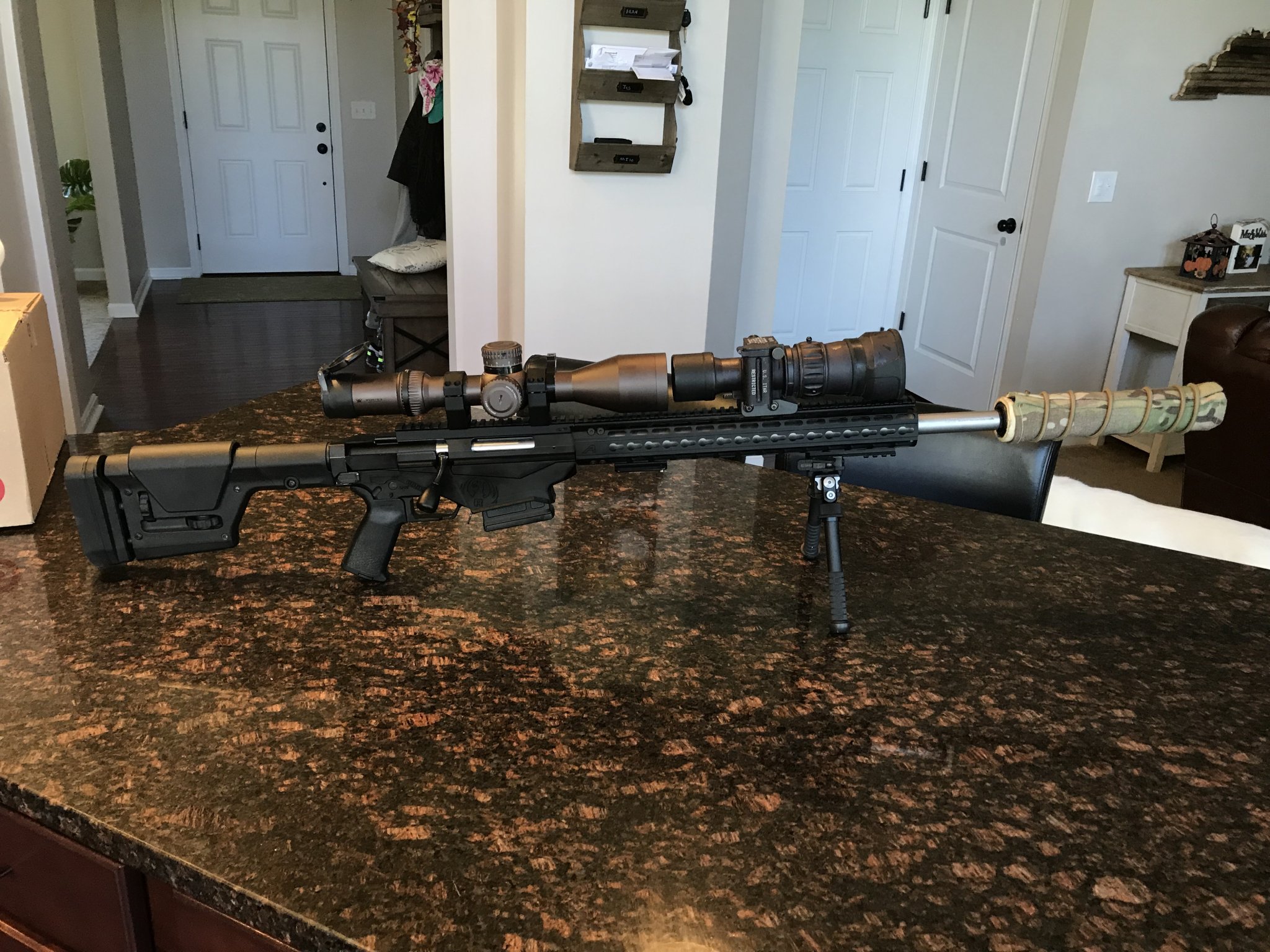

What height rings are you guys running with a 50mm obj? I'm looking at the 1.2 or 1.4, on my AT, I have to move the cheekpiece to the right a tad and was thinking on the 1.4 for a better head pos?
I used Nightforce ultralight rings in the 1.375 height and they are gtg on cheek weld and scope cap clearance on my ATACR 4-16x50.

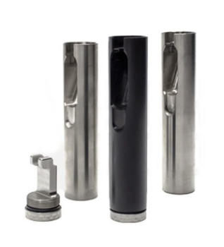

I have one of these in titanium and they will engrave whatever you want on them.
What I like about this model is the titanium (or aluminum) bolt disassembly tool which is so much more durable than the plastic one from Ruger.

I have the titanium one without the built in tool on mine. I have all of my necessary tools in the box my scope rings came in.
I've seen plenty of guys in trouble on the range over the years trying to get their bolts apart to clean out the pierced primer junk from the firing pin that I appreciate the tool ready at hand. It would be nice if more rifles came with some sort of tools integrated into the system somewhere.
Not likely something that plinkers with factory ammo would appreciate, but competitive types running hot loads on a hot day or in the rain tend to find themselves in trouble now and then.

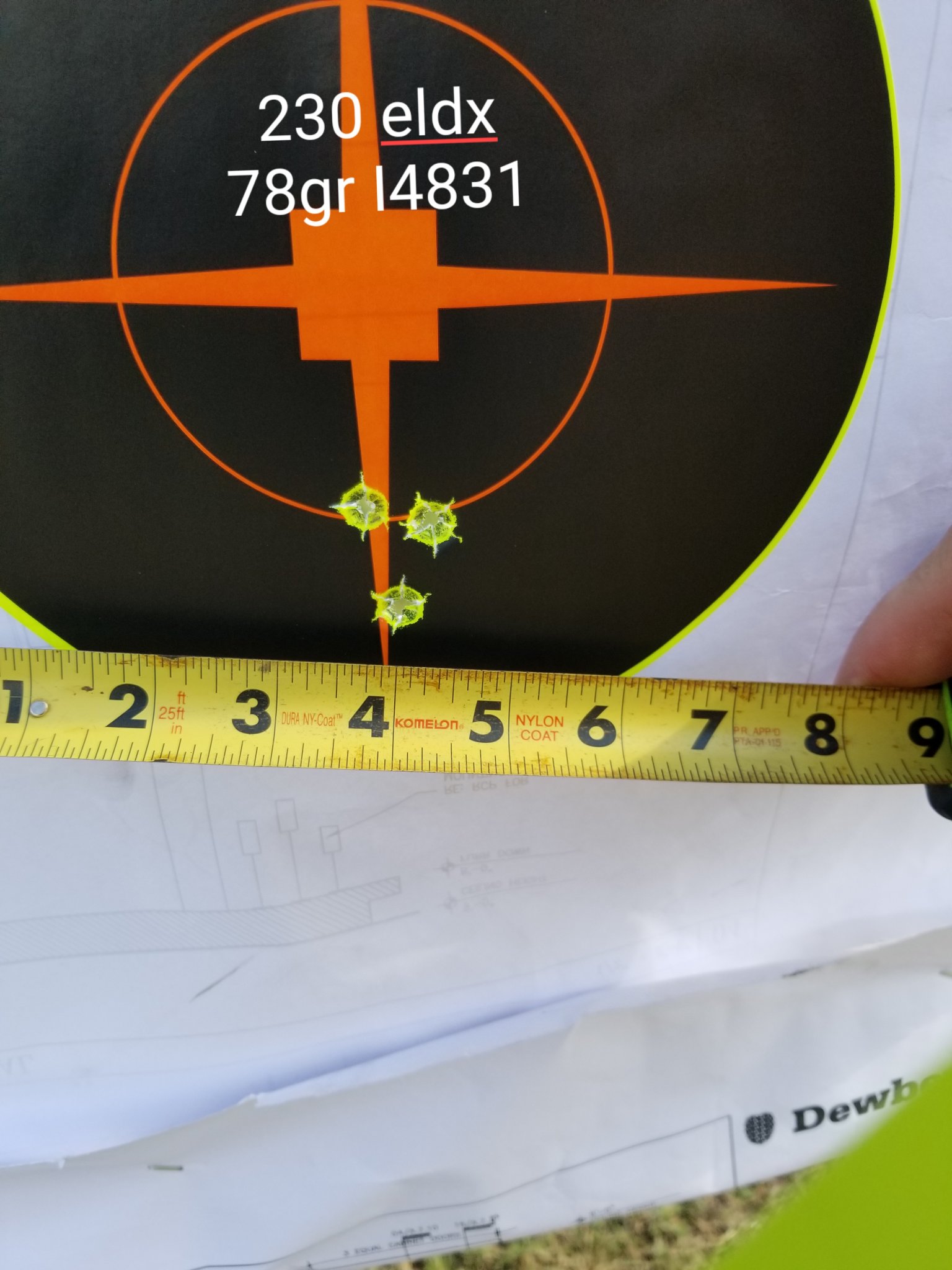

Went out with the rpr xl yesterday. Factory ammo (cheapest s&b I can find local) runs right at .7 moa. I shot ladders and most everything was sub moa. I had several in the .6-.7 range, and 2 sets under .5. I know it can do better because I usually stack 2 rounds and have one open the group. I guess it's time to buy some lapua brass and see what all the hubbub is about.
and just to through it out there.... Houston in the middle of august is brutal at the range
View attachment 7131957View attachment 7131960View attachment 7131961
I wouldnt be so sure itll do much better. On 1 hand I would be thrilled with anything sub MOA with the "Cheapest S&B" you could find. But on the other hand, its a 3 shot group. I would bet those groups to be bigger with 5 shots and cheap ammo. If it shoots consistently . 5-.6" 5 shot groups with quality handloads than I think you would be getting about the most you should expect for a production rifle with all factory parts. Ive upgraded everthing on my RPR except the barrel and while I am occasionally rewarded with a .3-.4" group, its really a .5-.7" rifle when I do my part. A new Proof tube would probably narrow that but Im not that disciplined and a Proof barrel costs as much as the rifle did new.

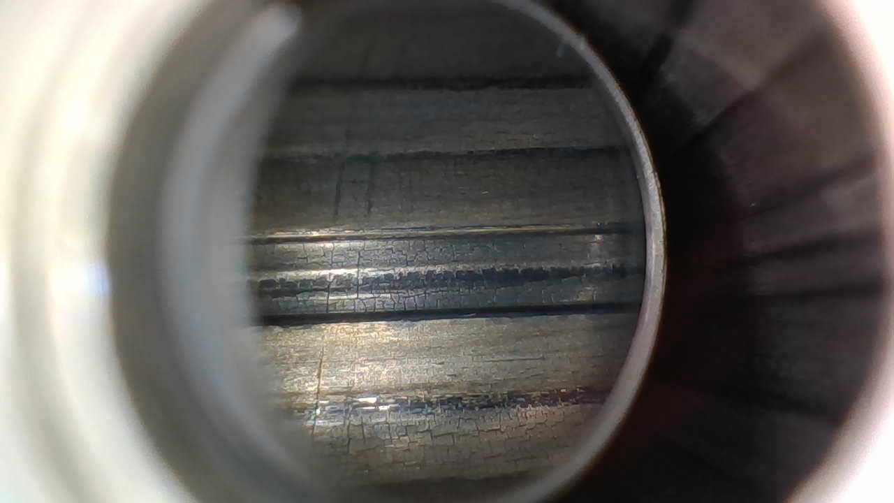

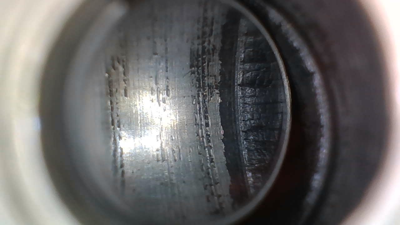

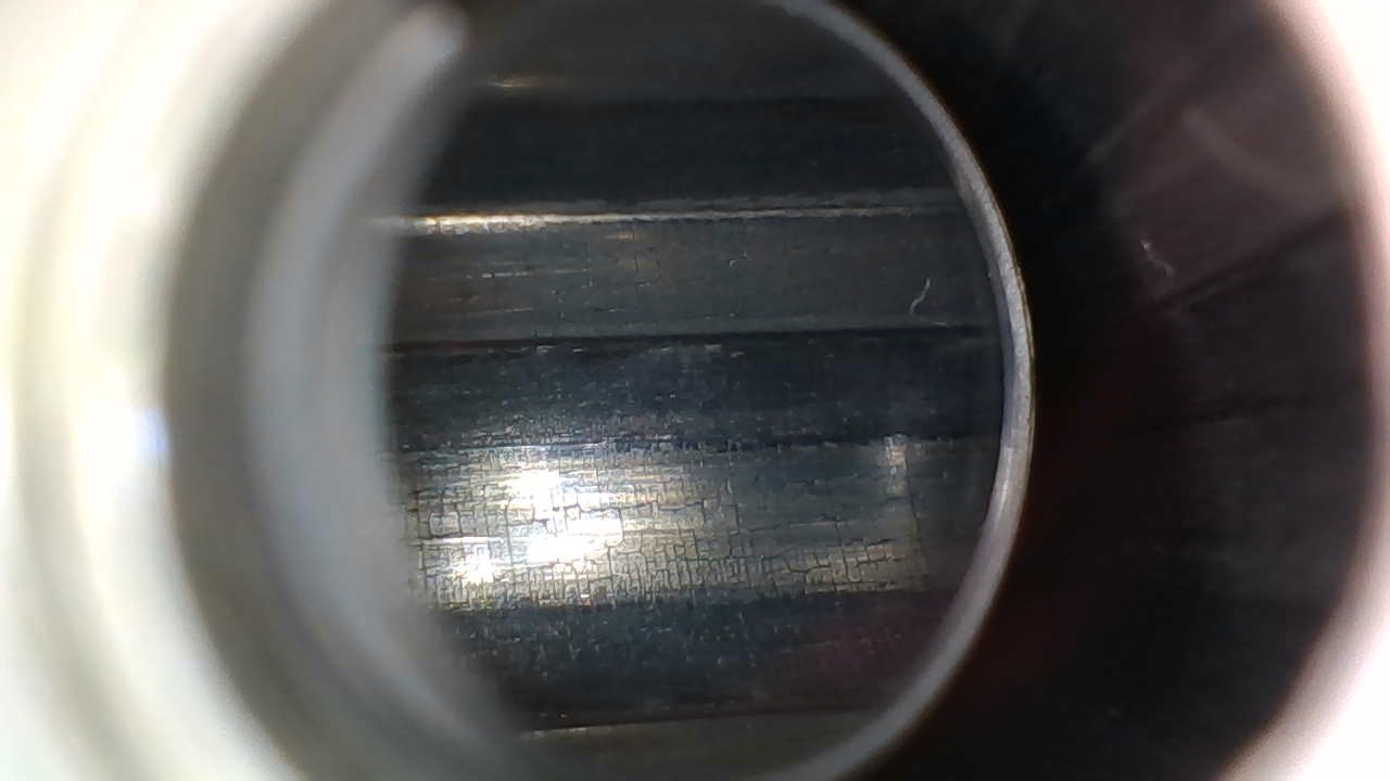

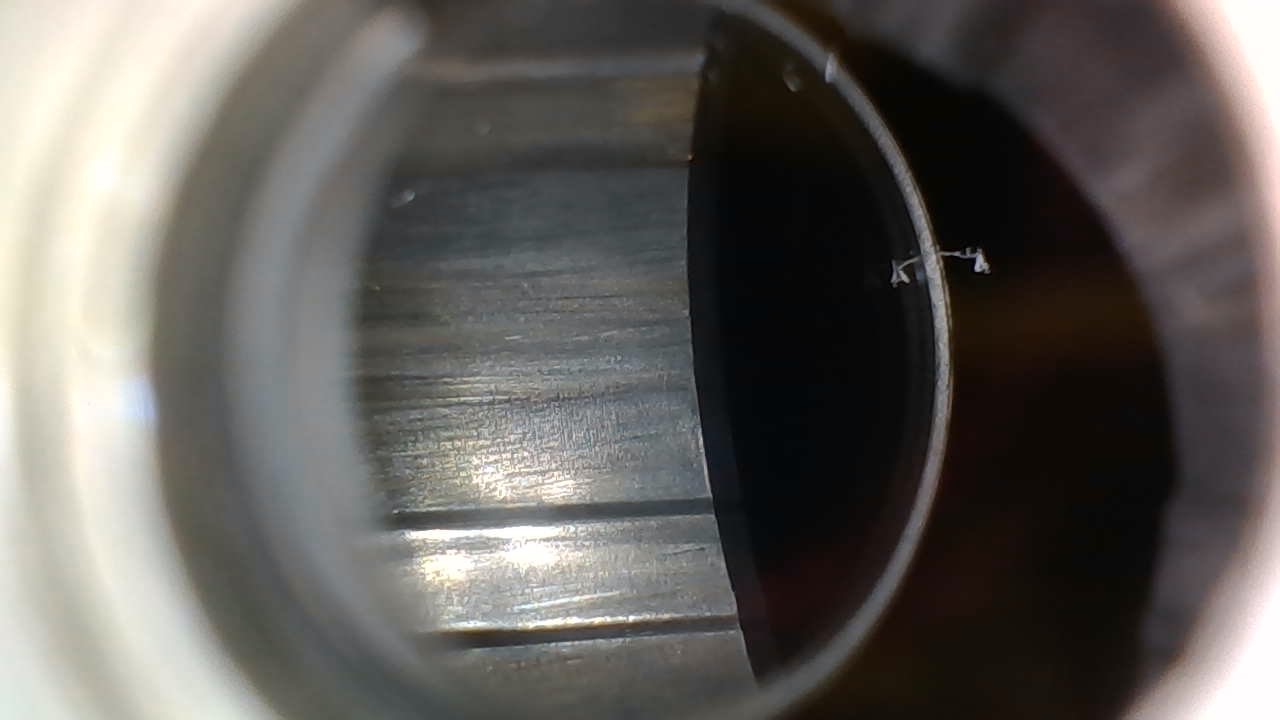

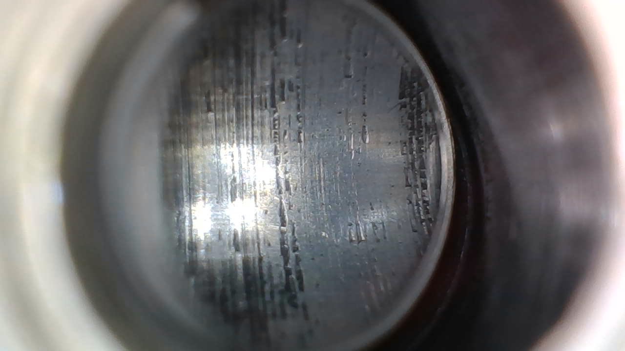

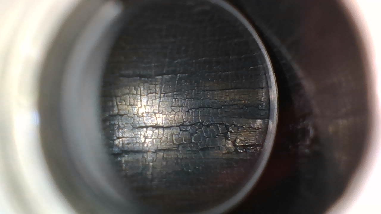

Mine was shooting half moa till about 2700 rounds.
I'm now at 3018 rounds and it's struggling to hold an inch group @ 100 yards.
I just got a borescope I'll post some pics tonight of how burnt out my throat is ?
Yup . . . sounds like it's time for a new barrel there. Getting 2700 rounds down a 6.5CM and holding 1/2 MOA is pretty good.
Of course, just how long the barrel is going to last has a lot to do with how hot the loads are. If one is running hot loads, one should expect a lot less than 2700.
My .308 factory barrel has 3700 rounds and still getting sub 1/2 MOA. . . . though I haven't run very many "hot" loads through it and my loads are typically medium/mild. The lands has moved .023 and I'm loading long.

My ruger barrel is Def shot out I'll. Post some pics of the bore shortly.

I'm actually cleaning the ruger barrel right now before I scope it.
I'm. Using bore tech on this barrel for the first time and Holy shit is a bunch of copper coming out. Maybe it's partly to blame for my slow speeds lol ?‍♂️

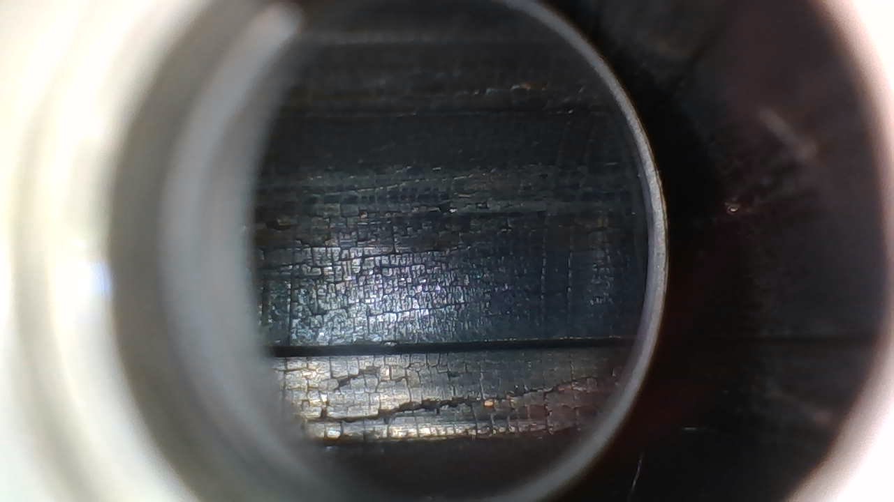

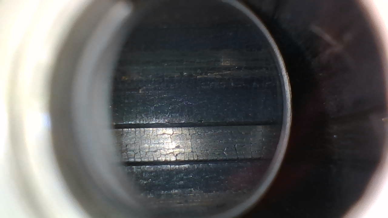

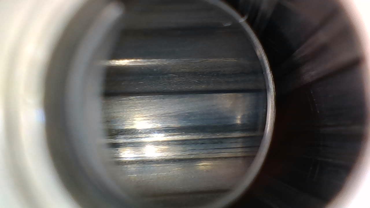

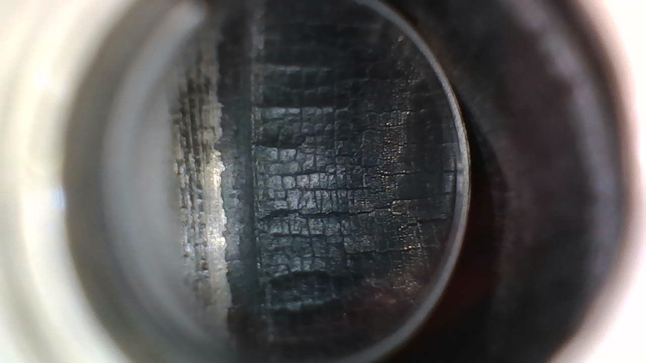

Just got done scrubbin the shit outta my barrel. Here are some pics of what the stock 6.5 creedmoor barrel looks like after 3k+ rounds.
Still shoots an inch @ 100 despite the throat being totally burnt out LOL :poop:
Yeah (lol), that throat is pretty charred. Though firecracking is normal to see . . . it depends on how far into the barrel it goes that can tell you something.
A little while back an "old timer" (like me) mentioned how he had a rifle barrel with only 4" of rifling left at the muzzle end and it still shot somewhat accurately; the point being that one can still, to some extent, hit a target with such a barrel, just not with much precision.
It seems to me that you did good getting 2700 rounds out of a 6.5 with such hot loads (even if it's a little less, whenever you actually started loosing precision).
