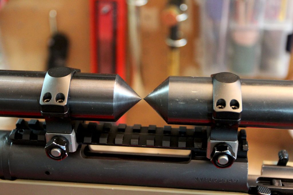

These are a set of NF rings just torqued onto a factory Mossberg scope base, I think it's EGW with a set of alignment bars mounted up, no lapping needed.
Using-a-good-quality-base-and-rings-keeps-everything-aligned-and-working-smoothly.-These-Wheeler-alignment-bars-indicate-that-everything-is-good-to-go.-1024x683.jpg
Lapping rings = destroying rings. Modern mounts are machined to tighter tolerances than what lapping bars are able to provide.
How do you know any of this? Do you have any inspection numbers to validate your claim? Or are you just repeating what you've read on the internet?
Have you ever seen a dimensional blueprint for MIL-STD-1913 rails? I have. And I know how to interpret it. There is no way, even if a machinist used half the linear and geometric tolerances given to him, that the alignment between the front and rear ring would be perfect.
Just because something is good enough doesn't mean it can't be improved. You just have to know how.
Reactions: Dthomas3523
Is your setup good enough? Most likely it is.
Can that alignment be better? I'll put money on it. That alignment tool is a rough visual gage. You have no idea if the tips are .0001" off or .001" off.
2 years in the making eh?
That’s fair though, point taken. Most things could probably be improved with the right knowledge and equipment.
But the fact of the matter is that the VAST majority of people reading this need to stay the fuck away from a lapping bar.
If you believe the benefits of lapping rings outweigh the disadvantages, you have the wherewithal to properly lap rings, and you can shoot the difference on top of it... knock yourself out. The other 99% of people are still better off destroying them.
