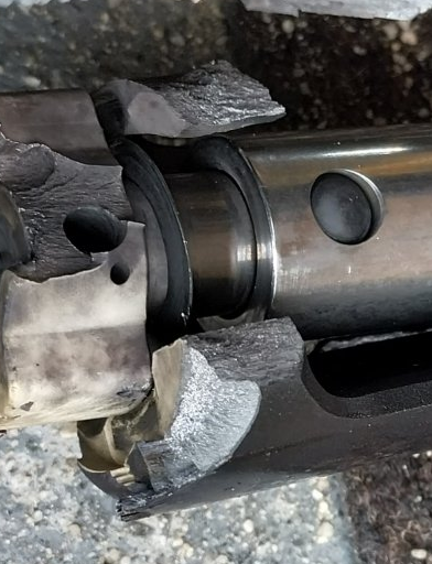

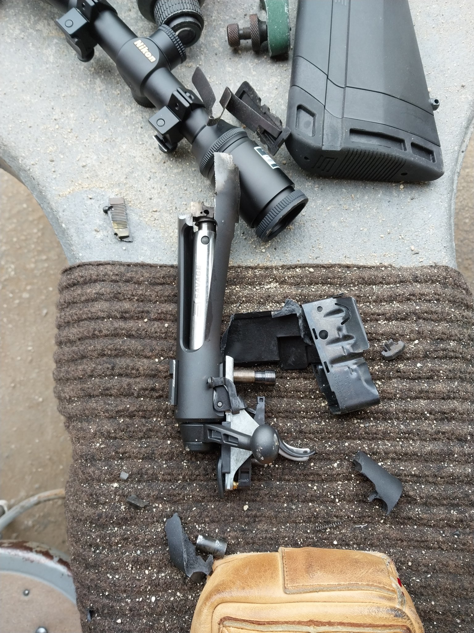

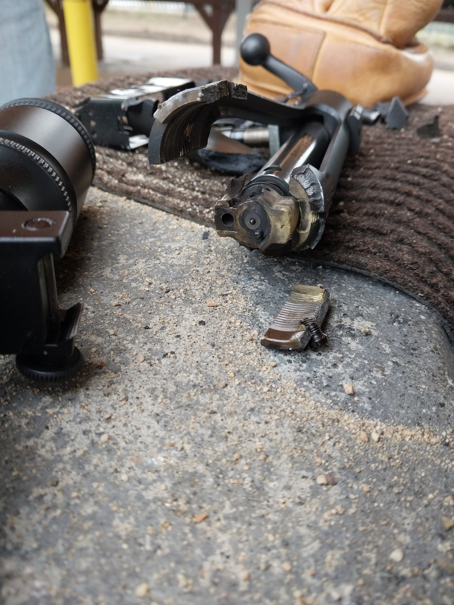

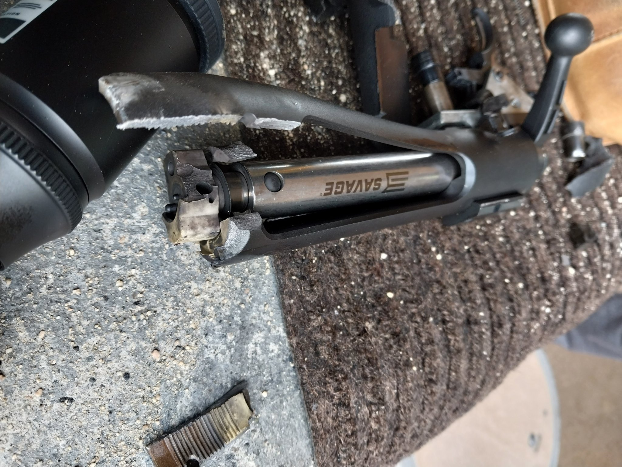

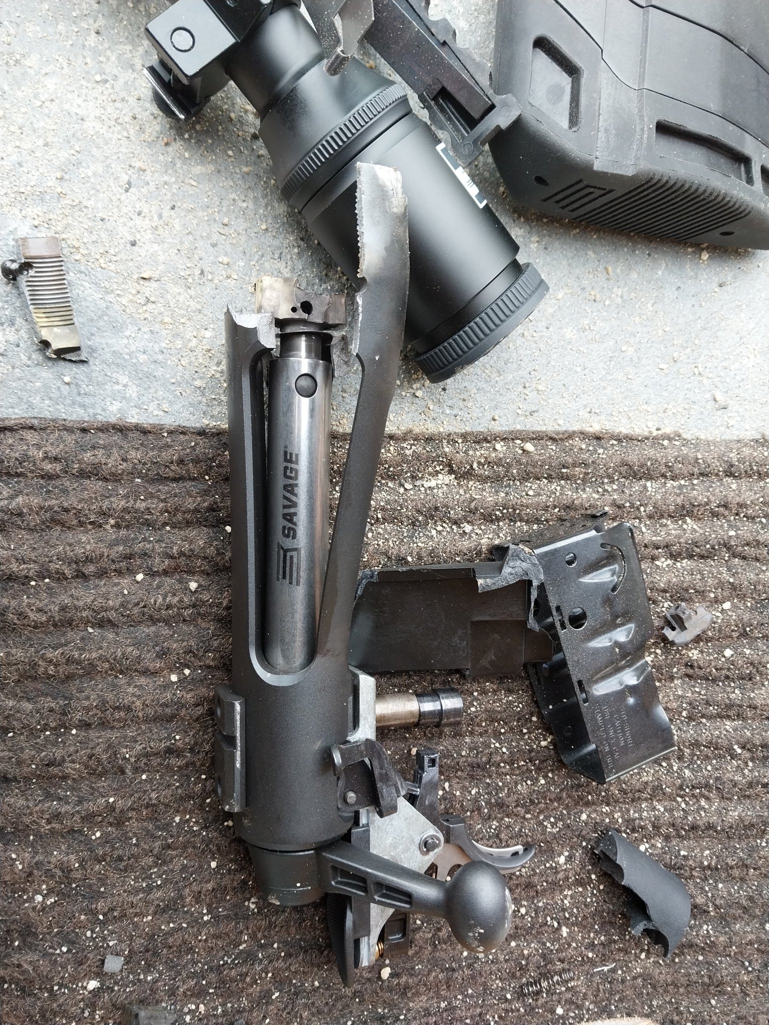

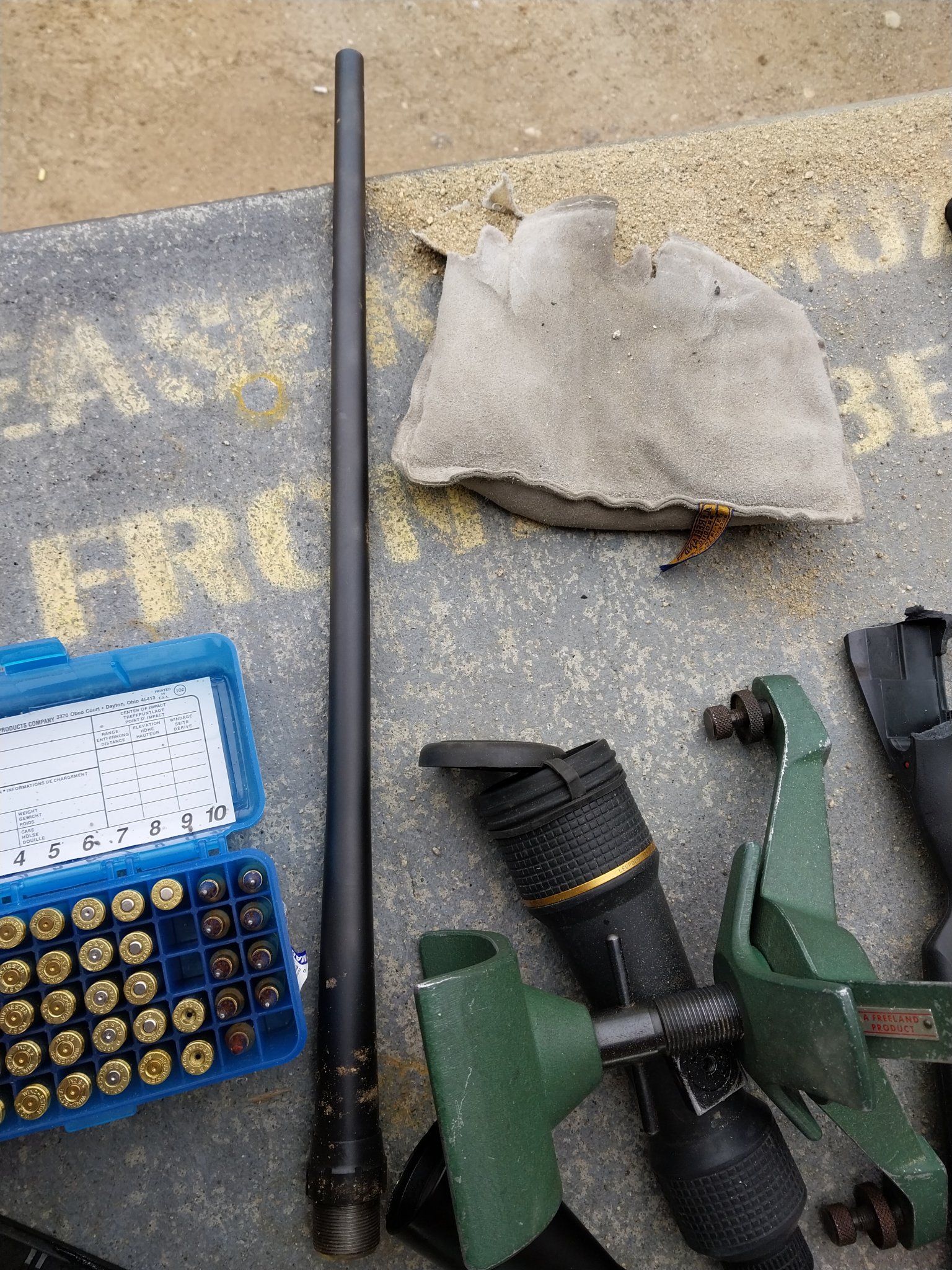

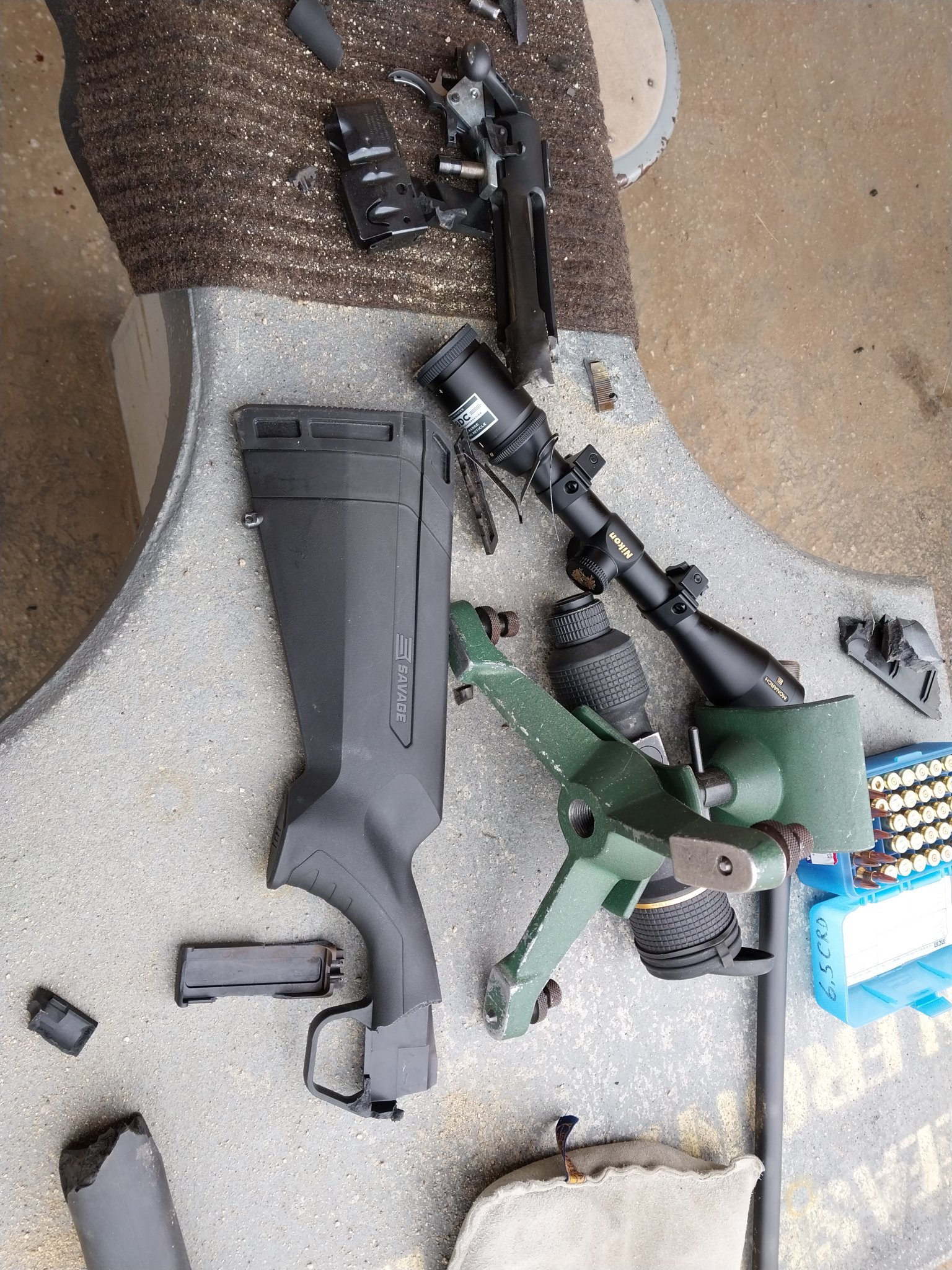

Hey Hide,
I was at the rifle range this morning with my shooting partner. The line had been open for all of ten minutes when a shooter about 30 feet away from us suffered a catastrophic detonation of his rifle, a Savage in 6.5 Creedmoor. I do not know the model. Fortunately for the shooter, he suffered a relatively minor cut to his hand and some cuts to his face, but he was wearing eye pro and was not more seriously injured. Several people were struck with debris from his rifle but none were injured. Some of the debris landed next to my buddy and me. The shooter was using handloads, but could not recall his load - he didn't have it written down and was pretty shaken up by the whole affair.
Pics below. I have been trying to figure out what would cause the rifle to fail in this way. The bore was completely clear, but the barrel was launched about ten feet ahead of his bench. The cartridge case was welded into the chamber but the case head was nowhere to be found. All I can think of is that he used the wrong kind of powder in his handloads (i.e. pistol powder in a rifle case), but that is pure speculation.
Scary moment for sure.

Fuckin’ new guy at reloading didn’t know what the fuck he was doing. Looks like pistol powder for sure. If you’re using a known 6.5 powder, you can’t load enough in there to cause that. Dumb fuck central.
My initial thought was pistol powder as well - as you said, it would be impossible to load enough 4350, RL16, Staball, etc. into a 6.5 Creed case to make that big of a boom.

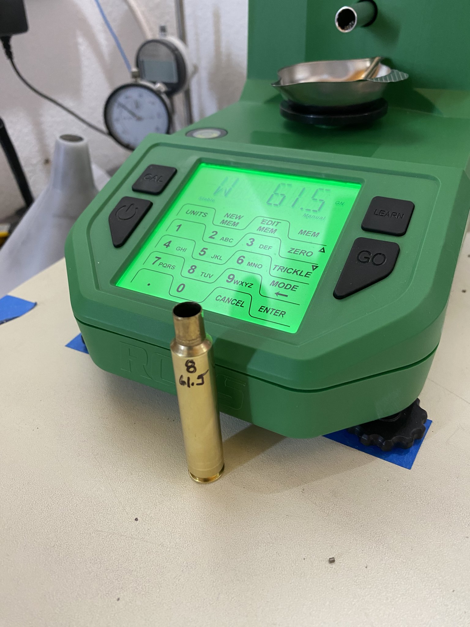

Holy Crap !!! Glad everyone was OK. I can't help thinking that anyone shooting a hand-load that doesn't know immediately what is "supposed" to be the load ... should probably be shooting factory cartridges..
I’ll only disagree to the extent of saying that those of us who reload a LOT and a lot of calibers cannot use Memory. Which is why we have very good notes and notebooks. And in every “can” of ammo I load, also put a recipe card and date info.
But if I take out a few to go to the range… I may not know what is in a specific load.
Write everything down! Multiple copies. Mine is in pen notes hanging on reloading room wall on a clipboard. On computer. And on printout. And on cards in ammo cans.
Memory is not to be trusted with reloading.
The good news is that everyone is ok.
And new reloader? We can’t assume. Pistol powder? Maybe. Squib followed by hot load? Maybe. I’m not going to bust on the guy based on the OP’s description. Too many questions remain.
The real lesson is check, double check and triple check. Write stuff down. Save it. If you get a load from the Internet… cross check it in a book. I have 4 loading manuals from the 70’s
To 2 years ago. If I am trying something new, I can cross reference what “other” books say.
Some powders have similar numbers… make sure that the initials and the numbers are exact!
And if a load feels “wrong” stop! Aka squib. Or “hot” or pressure signs.
Glad it’s Only a gun!

Hey Hide,
Scary moment for sure. View attachment 8122402
Sir:
Any chance of getting more info or is the owner long gone and out-of-touch?
There are probably some good lessons going to come out of this if more info was available.
Just wondering. Thanks for posting this.
Sirhr

Detonation. Low charge of slow powder. Flashes across the surface, moves bullet into rifling. Powder detonates, Kaboom!😳
Marginal design for cheap manufacture. Low quality metal = exactly what we see here.

I log everything and take pictures of the powder used, etc with my iphone (airplane mode). I snap pics of the load I punch in, too. When I do ladders I mark each round, punch in the weight, snap a pic, hit dispense and fill. When I do 3 or more shots per charge I use the auto feature and just take one shot of the first round, per load.
I double and triple check everything. Powder gets drained and back to the storage bin after use. If anything ever does go wrong, I have more than enough info to figure out what the cause was. I even snap a pic of the competition shell holder I use when sizing.
So far I have not blown anything up…. 🙏 🤞

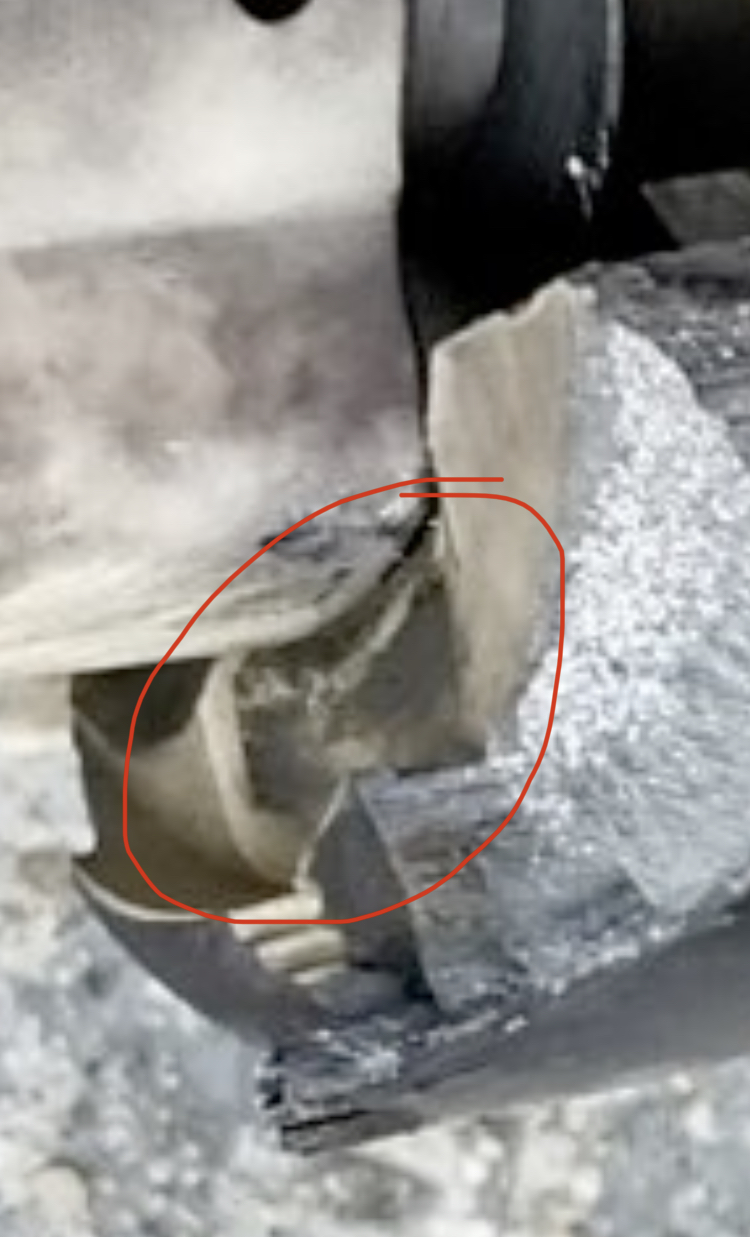

Can we talk about the metalurgy of this action? WTF over.
So... long ago and far away, I was able to tour the factory a few times. At their test range there was a rack of fully assembled guns from across the entire product line, all slated for destructive testing - aka 'Death Row'. Including (at the time) a row of 110BAs in .338LM. Those actions were supposedly rated for 130k psi... I asked "how the hell do you plan to blow one of *those* up?!?" The answer... "Probably fill the case with Blue Dot and sit a bullet on top." ;)
FWIW the failure mode was supposed to look a lot like what happened here.

Unfortunately, after the incident the shooter threw the shards of the rifle (except for the receiver) in the garbage, packed his gear up and left. I had never seen him before at the range and don't know him at all.
