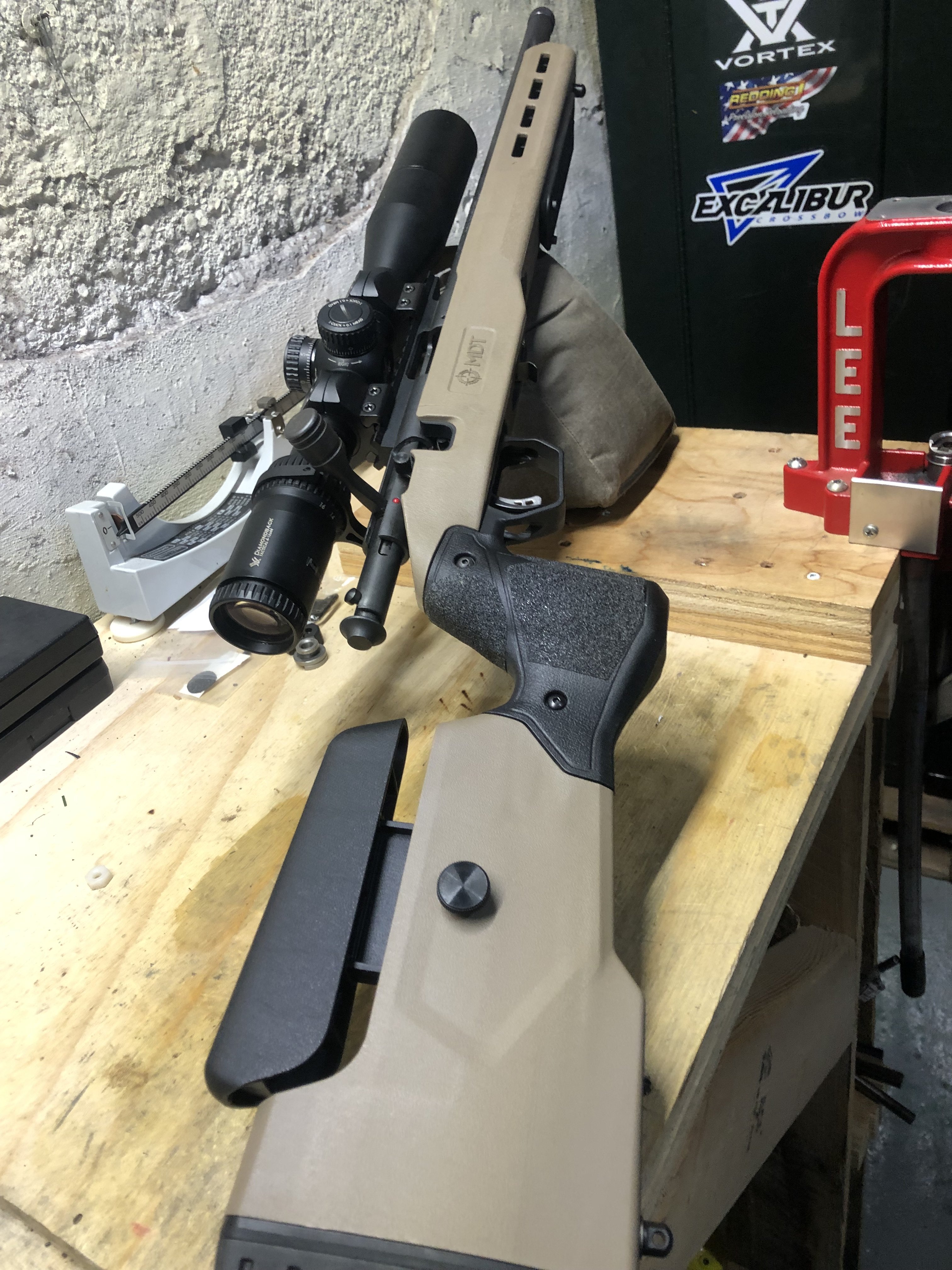

Hey guys,
I've got a savage mk 2 that I've decided to turn into a rimfire precision competition gun - I can shoot 1" groups at 100yd with CCI standard velocity out of it.
Currently it sits in an oryx chassis with a Diamondback tactical 6-24, riding an Oryx mlok bipod.
Here's what I DON'T currently like about this setup:
-Balance is terrible
-Scope won't focus at max zoom beyond 100yd (100y is even a bit borderline)
-Bipod is terrible
Here is what I am planning to change in the next month or so:
-Full length ARCA rail
-CKYE Pod
-Stick on Wheel weights jammed into forend
-40MOA Rail
-Mlok side panels+Weights (if required)
I'm not sure exactly what to do about the scope - I may just leave it for now and see what happens later.
What do you guys think? I'll post a photo when I get home from work.
Thanks,
CHOMPS

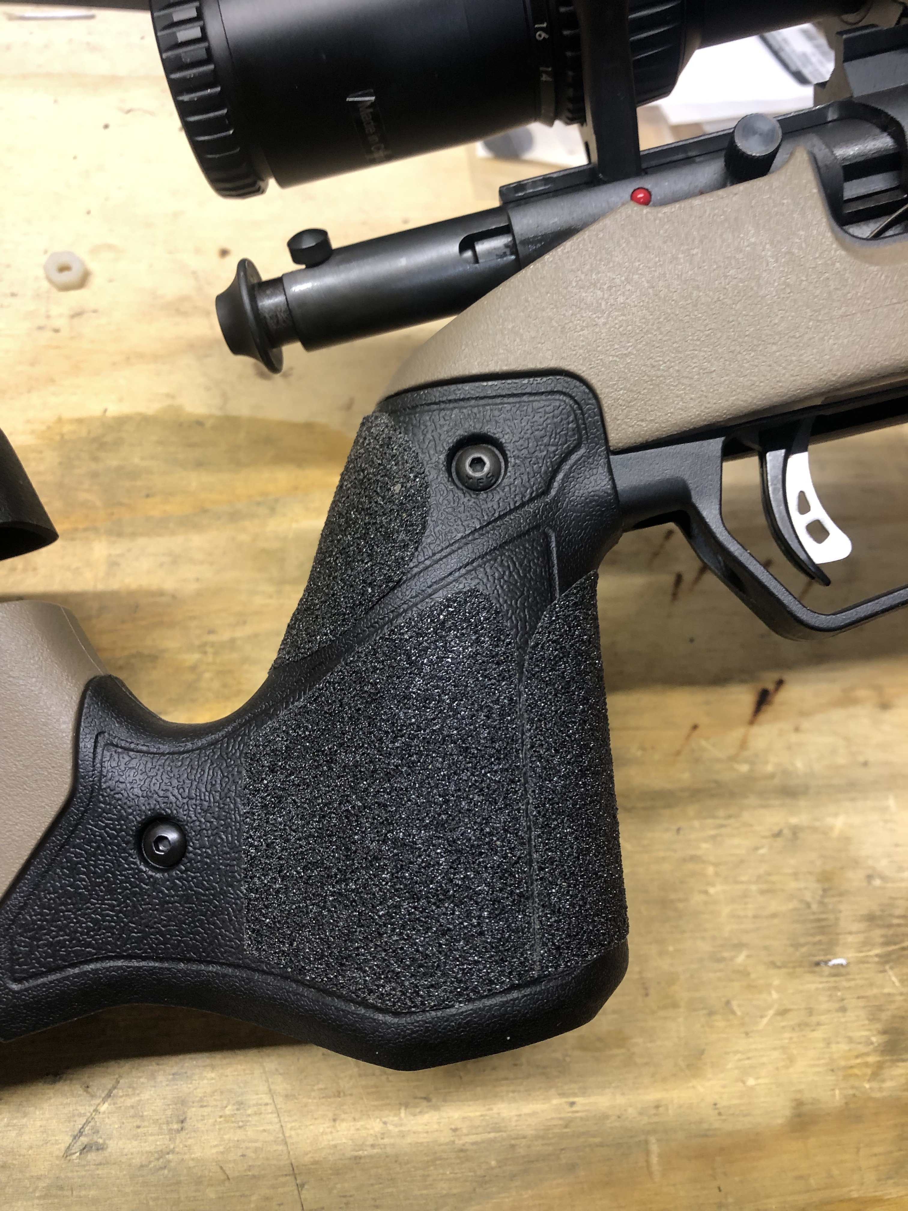

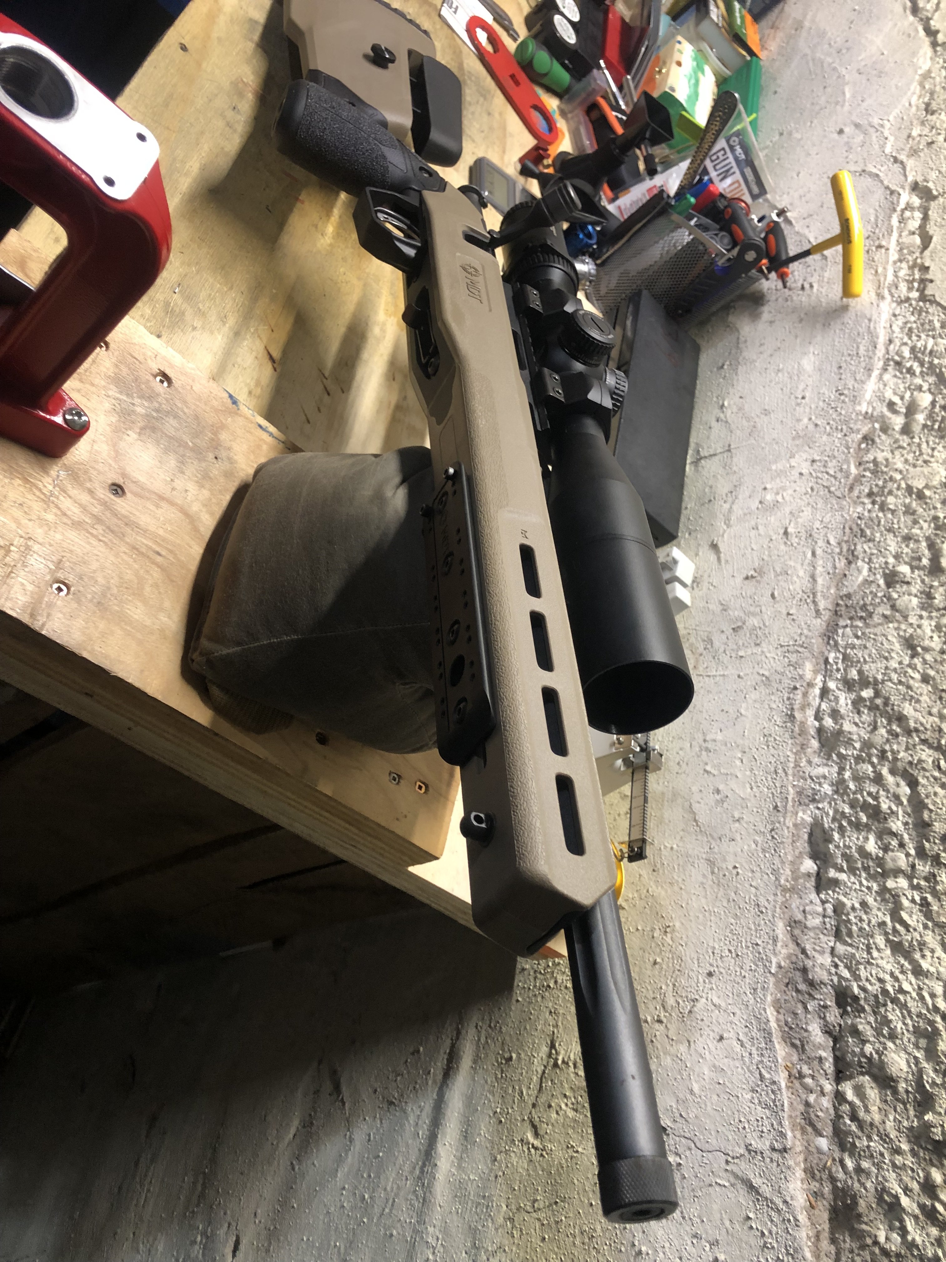

Mine. It kicks ass for being incredibly cheap.
