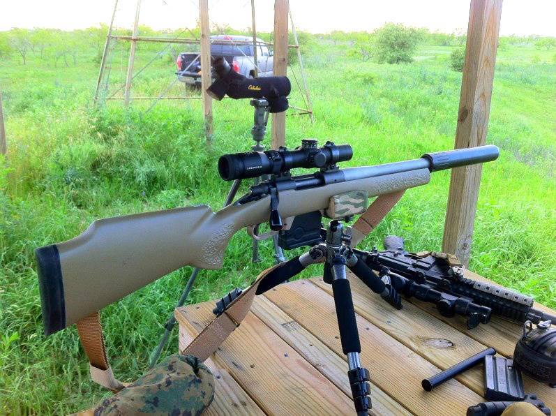

SBR Thread
Not mine, but super bad ass. Fast twist .223.

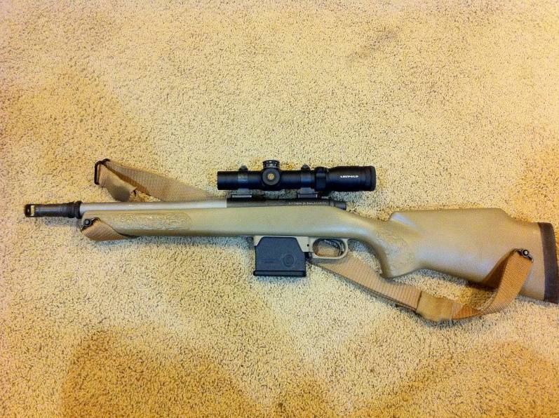

What stock?View attachment 6942209
SBR Thread
