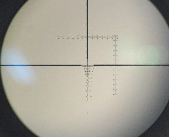

For an AR scope:
The USO 1-4x was what I'd been looking at. I like the dual-plane reticle with Aimpoint-like dot and good battery life, but not sure adding 20 oz to the top of my gun is worth it for only 4x on the top end. I've also been looking at the Leupold Mark 6 1-6x, but that doesn't quite seem perfect with their sub-par illumination.
One thing that is important to me is either a good BDC reticle (kind of like the crosshair ACOG reticle) OR a good mil-based reticle that illuminates so that it works like a dot on a sunny day, light weight, and durable. Optics don't have to be perfect, but the better they are, the better the scope is. I'd like to see something in the 15 oz range that isn't fragile---once it goes over 20 oz, I mark it off my list. Hell, the Trijicon Accupoint would be a great scope, even if it is 1-4x, if it had a good reticle. To be honest, 1x on the low-end isn't THAT important. I don't really see a speed penalty with a 1.25x or 1.5x on the bottom end, so long as the illumination works to help me draw my eye to the aiming point. I'd also like to see a zero-stop, but if the turrets are capped, it isn't as big of a deal. Also a big fat eye-box that is easy to grab is important to me. With my Trijicon Accupoint, I always end up grabbing the fiber-optic shade instead of magnification when I'm on the move and the dang mag ring is so small. Another consideration is to design a QD-mount that returns to zero, made to space just right with the scope and work on an M4/A4 type upper receiver that doesn't weigh a ton--keep it under 5 oz. and you'd have a winner. The Nightforce would be awesome, but I don't want to have to carry a tool to take it on and off, same with Aero. For now, I have the pig of a GDI that is awesome but heavy, and a lighter, but still heavy ADM (compared to NF and Aero).
On a precision scope:
The Leupold Mark 6 3-18x44 is a genius scope, IMO and right now leading the pack for a light precision scope for my purposes. While I'm not a super big fan of the pinch-and-turn elevation knob and lack of illumination, its probably one of the best sub-$2k scopes out there. What I like is the weight and TMR. I'd like to see 4-24x50 and 3-18x44 scopes that have simple two-turn lock/unlock elevation knobs with a zero stop set for 1 mil below zero (for suppressor flexibility), side focus with numbers marked on it, knobs that feel like Mark 4 knobs or Nightforce knobs, clicks that aren't as close together as S&B, capped windage, and an H2CMR style reticle, in a package with good glass quality (doesn't have to be S&B quality but at least as good as say a Nightforce ATACR or even Zeiss Conquest), make it come in tan and black, and keep it under 23 oz for the 3-18x and under 25 oz for the 4-24x. Big huge scopes are awesome, but rifles need to be coming in a bit lighter for positional shooting and for carrying. Don't say "go to the gym" because I do. The extra weight you save on a scope means you can have a longer barrel or add a can that gives more benefit than the marginal increase in scope quality. Add illumination if you can. Make the illumination adjustable externally and have an "off" position between every intensity setting.
One thing I think is over-looked is the possibility of adding dual-focal plane to a precision rifle scope. Once you turn the magnification down below about 8x on my S&B H2CMR, the reticle is hard to see. Perhaps a .125 MOA (or even larger) dot at 10x in the center of the reticle in the second focal plane would do it. That way it would wash out in FFP reticle as you crank up the magnification. That would greatly help the low end of the magnification range for hunting or closer-range shooting, which would make the AR10s and SPR type AR15s far more effective as dual-use guns. What use is 3x on FFP reticle anyway? The aiming point is so tiny and the hashes and dots are not useful for ranging or holds anymore. It washes completely out in brush, shadows, and as the sun goes down. I understand this would add expense to a scope, but it may be cheaper than illumination, and keep the weight down. It would definitely be worth a couple hundred bucks extra IMO. My S&B is for practical purposes a 10-25x for shooting, with sub 10x being only used for finding targets. The same is true of the 3-18x Mark 6 TMR scopes I've seen.
Anyway, there's my $0.02 on things the scope market could improve on.

All of our scopes will incorporate dual focal plane Reticles. They are all differently designed for their individual purposes, but, generally, the center reference point and main outer stadia are sfp while the ranging tools and milling/bdc portions are in the ffp reticle.
Really?? I hope so!! my first hunting scope was a Shephards scope with a FFP AND a SFP. ya, it was before I got into long range properly. but I allways thought that would be PERFECT reticle in a tactical style with a modified mil dot on FFP and the windage and elevation on the SFP. so you can VISUALLY see the return to zero as well as have zero stops and what not. Shephards has been making ffp/sfp for 25+years. maybe they hold the patent and would not let it happen? I have no idea, that is just conjecture on my behalf. If any good company made such a product, I would stand in line for it. Here is a Shephards reticle for some who may not know. The Circles and numbers are FFP and the thick crosshairs are SFP, so when you adjust for range the FFP will move and the SFP stay put I understand the circles suck for tactical but put a SWFA style Mil-Quad in there and it would be pretty sweet. but heavy I am sure. what say you all? am I on crack? too complex?
