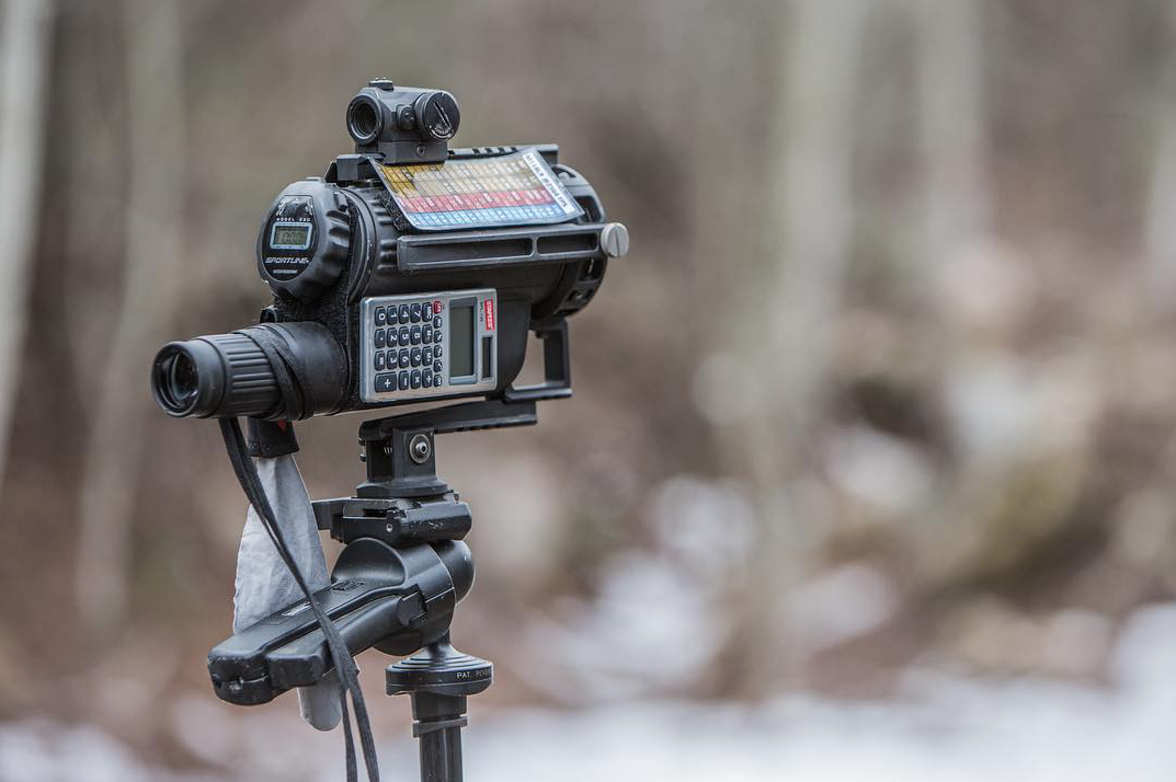

A sun shade can help but some times its not enough, so I usually keep a micro cloth lenses wipe attached to the optic just in case.
In the attached pic you can see the wipe hanging off the optic (spotter in this case).
