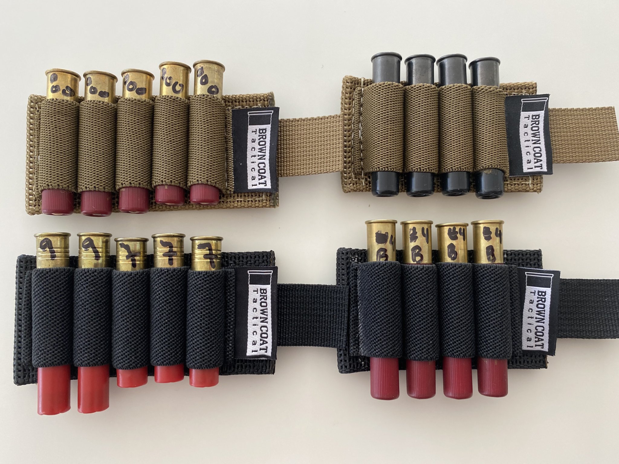

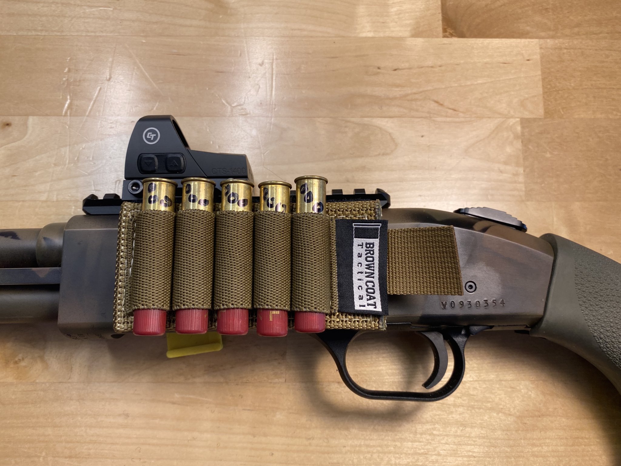

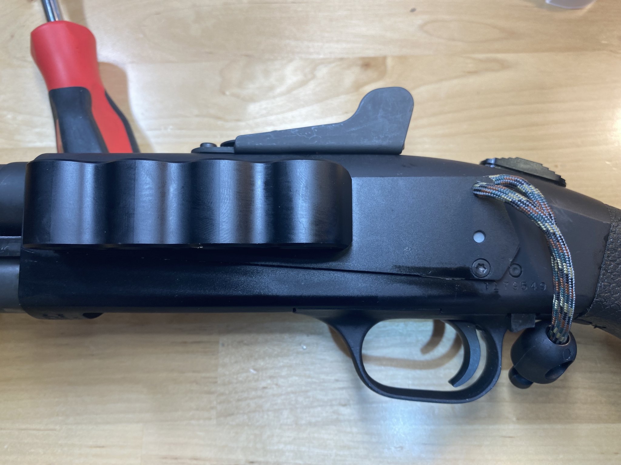

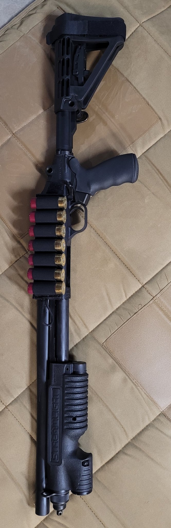

The Hide steered me to the Esstac cards, absolutely the way to go IMO. The Esstac also comes in various sizes as to the amount of rounds, the largest holds 1 or 2 more than a side saddle in the same space.
They fit in a standard mag carrier if you have a belt or chest rig. No modification of the receiver or pinching the action with a side saddle.

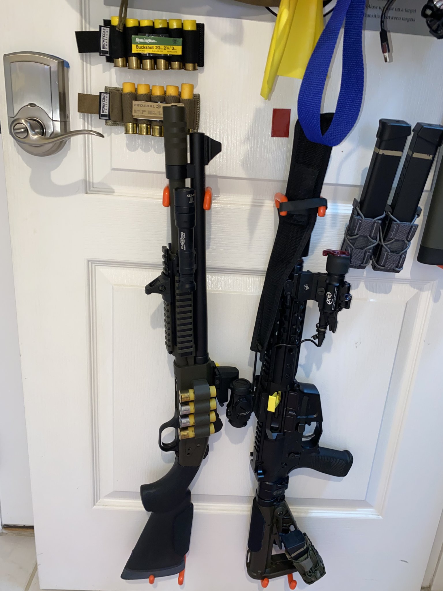

I stick with 00 because #1 & #4 has been difficult for me to find. Federal w flight control out of the shockwave i pictured above held tight enough that I was unable to count individual pellets at 10 yards.
Good info shared to me and some of my results.

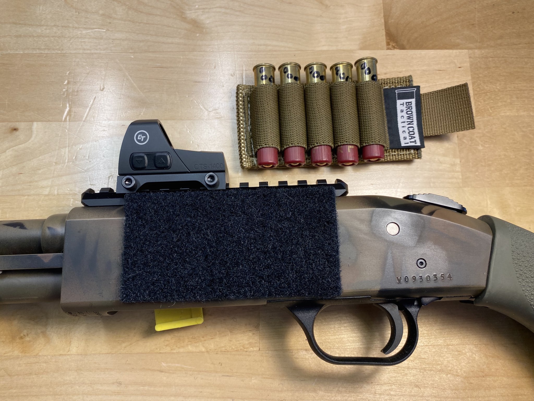

Took my side saddle off and put it in a drawer.View attachment 7914502

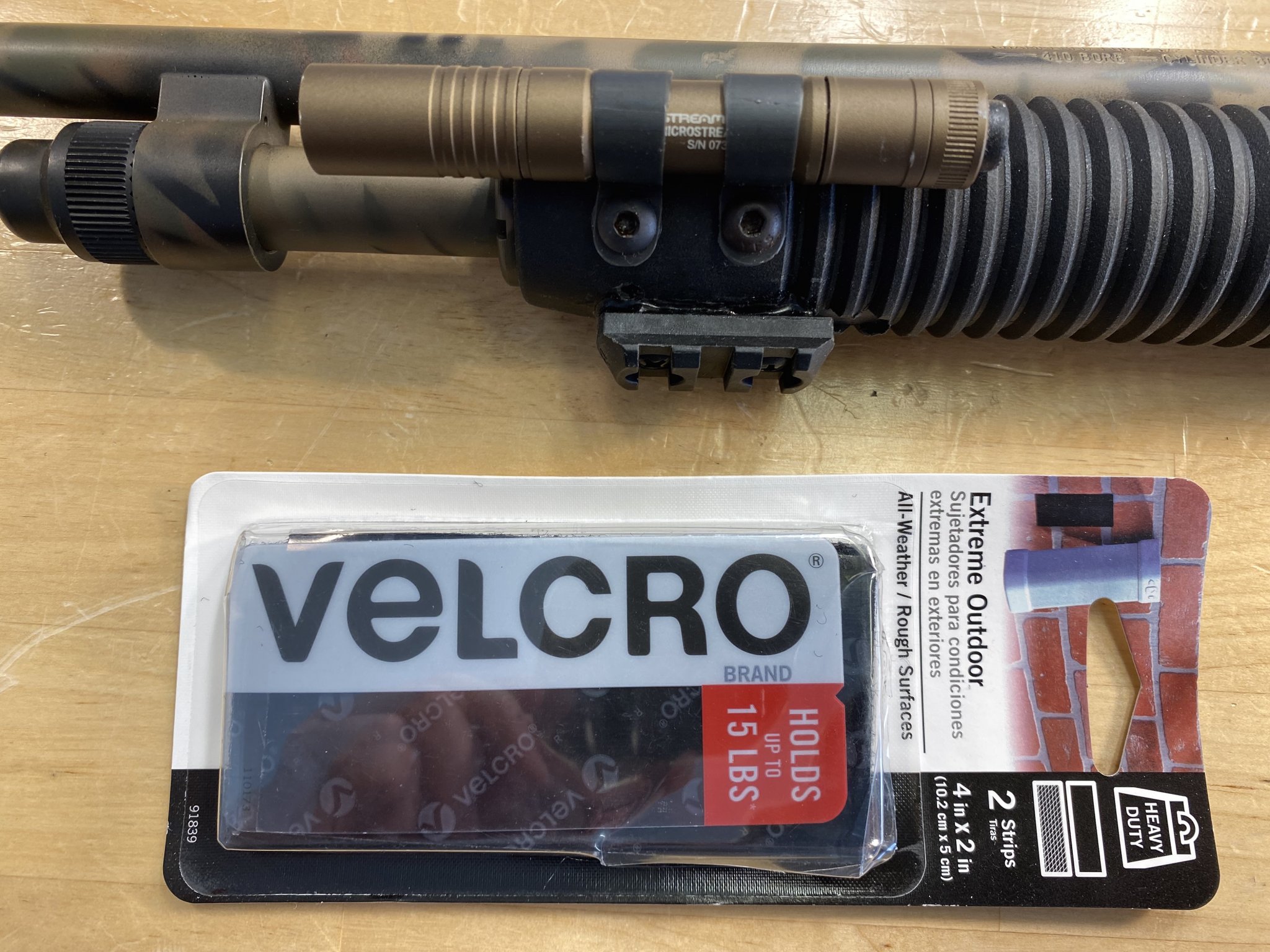

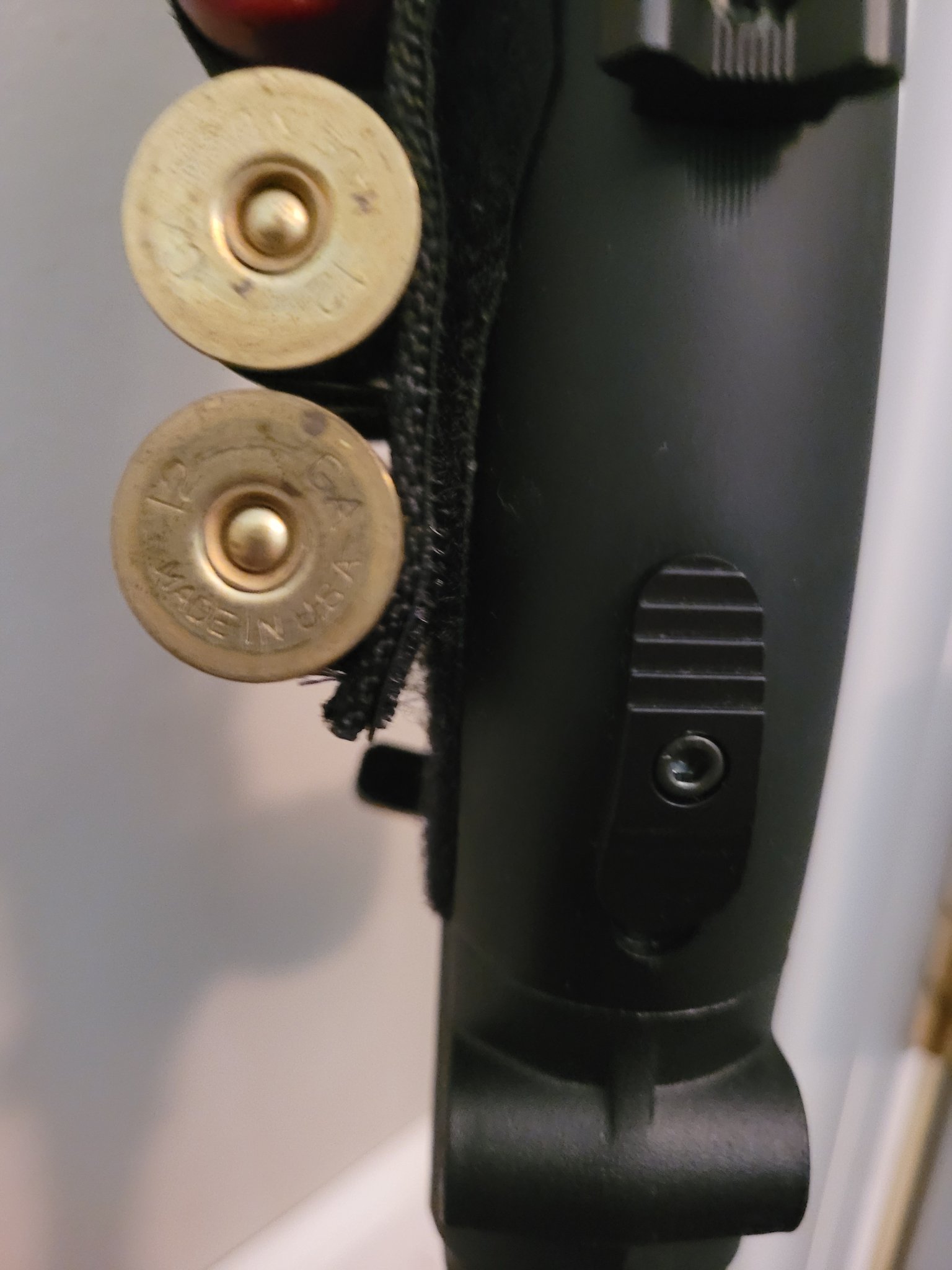

How are you getting your velcro to stick flat? Mine bows up from the side of the receiver like this [](
Can't really say. I am using the velcro from Esstac. The elastic loops are pretty tight so I loaded my cards up to stretch them a bit.
So from top to bottom the shells are keeping it straight. From front to back the velcro is doing its thing.
It does have a little on the ends but not terrible.
If you store them flat and loaded shells down under compression it may straighten them out more.
Esstac shipped mine with the sticky back velcro to put on the reciever but it is not worded like that on thier website. I ordered it extra and ended up with several pieces.

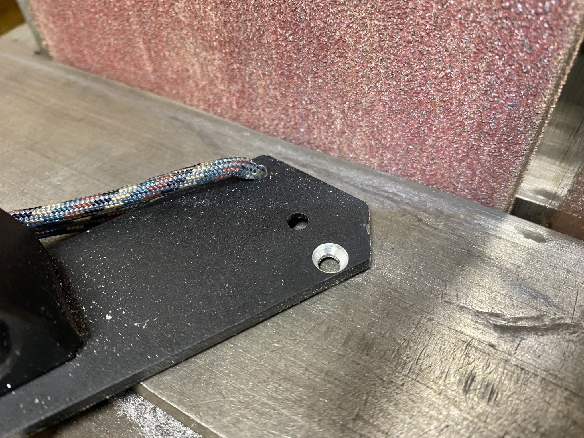

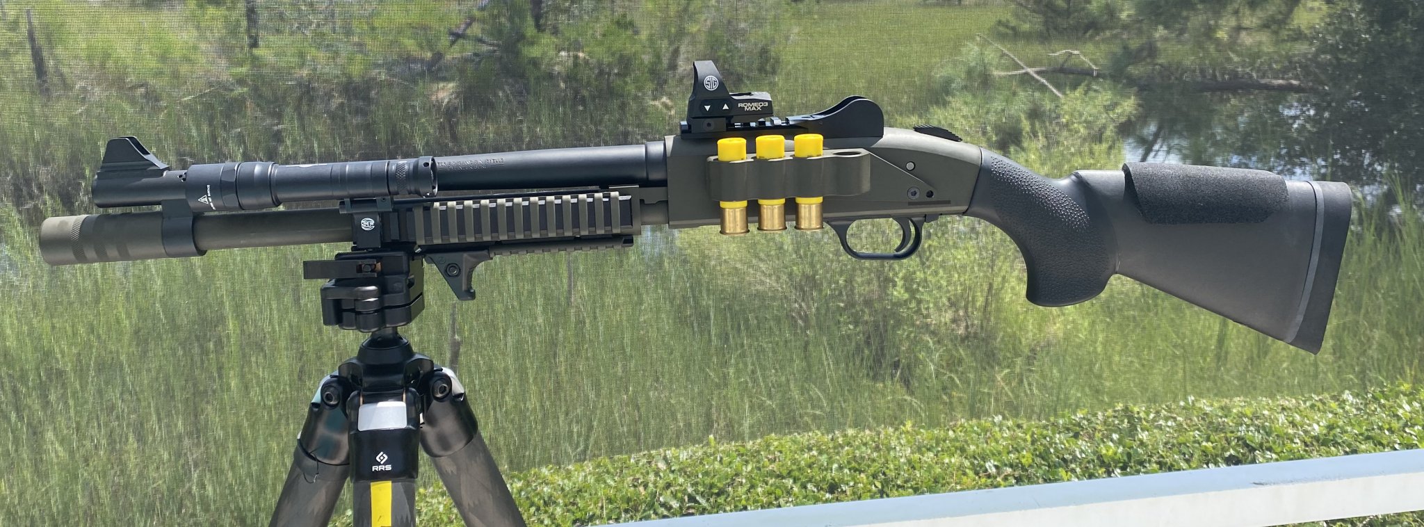

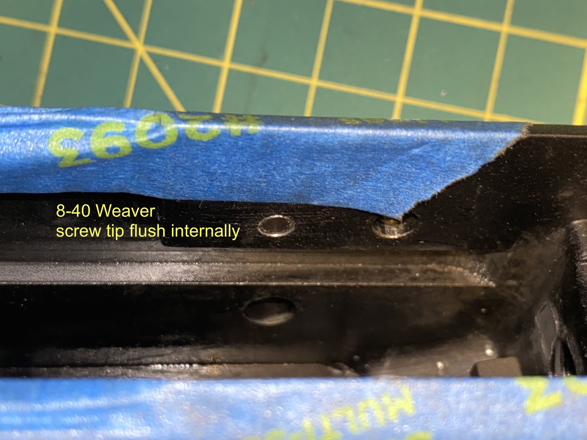

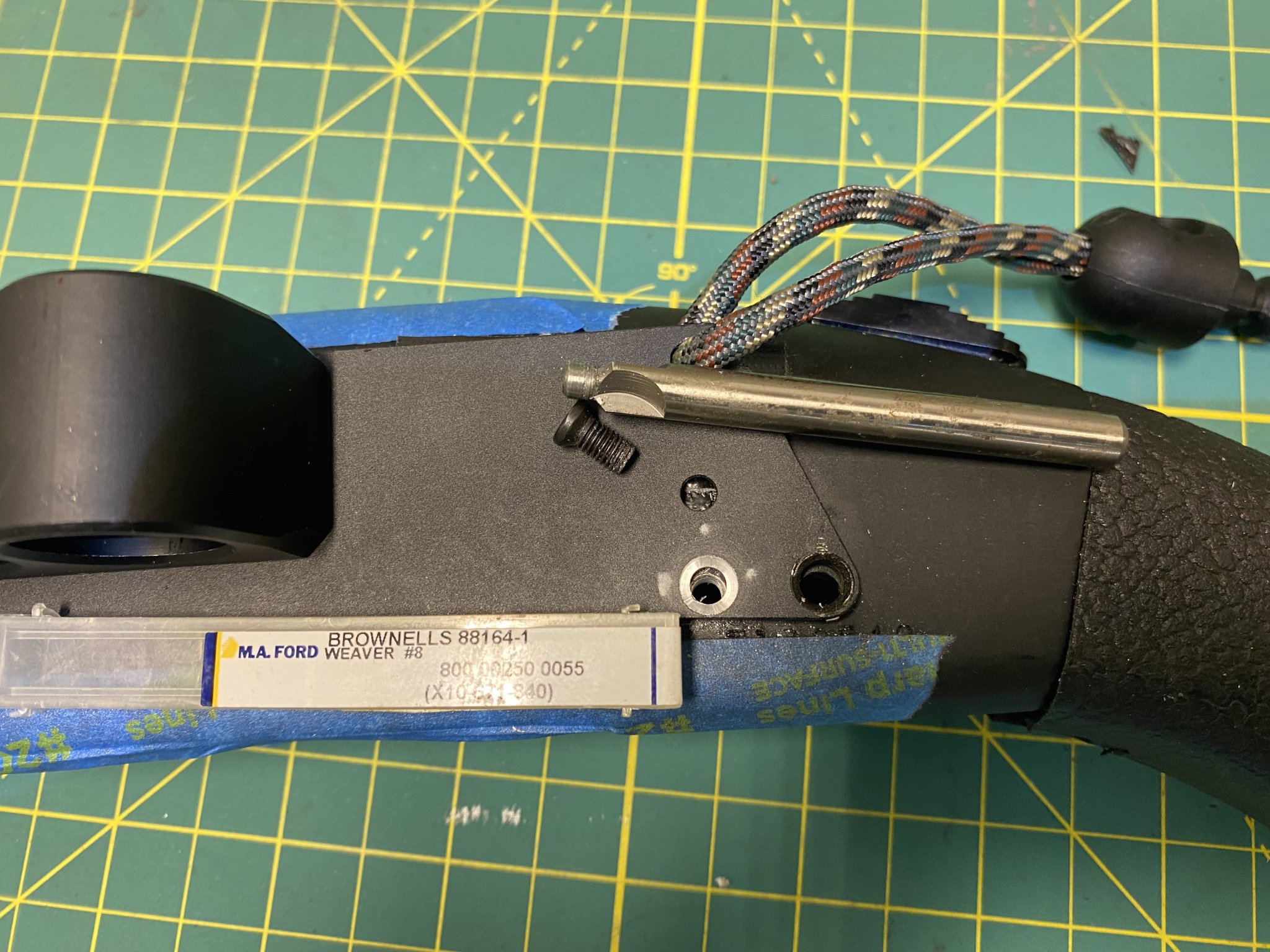

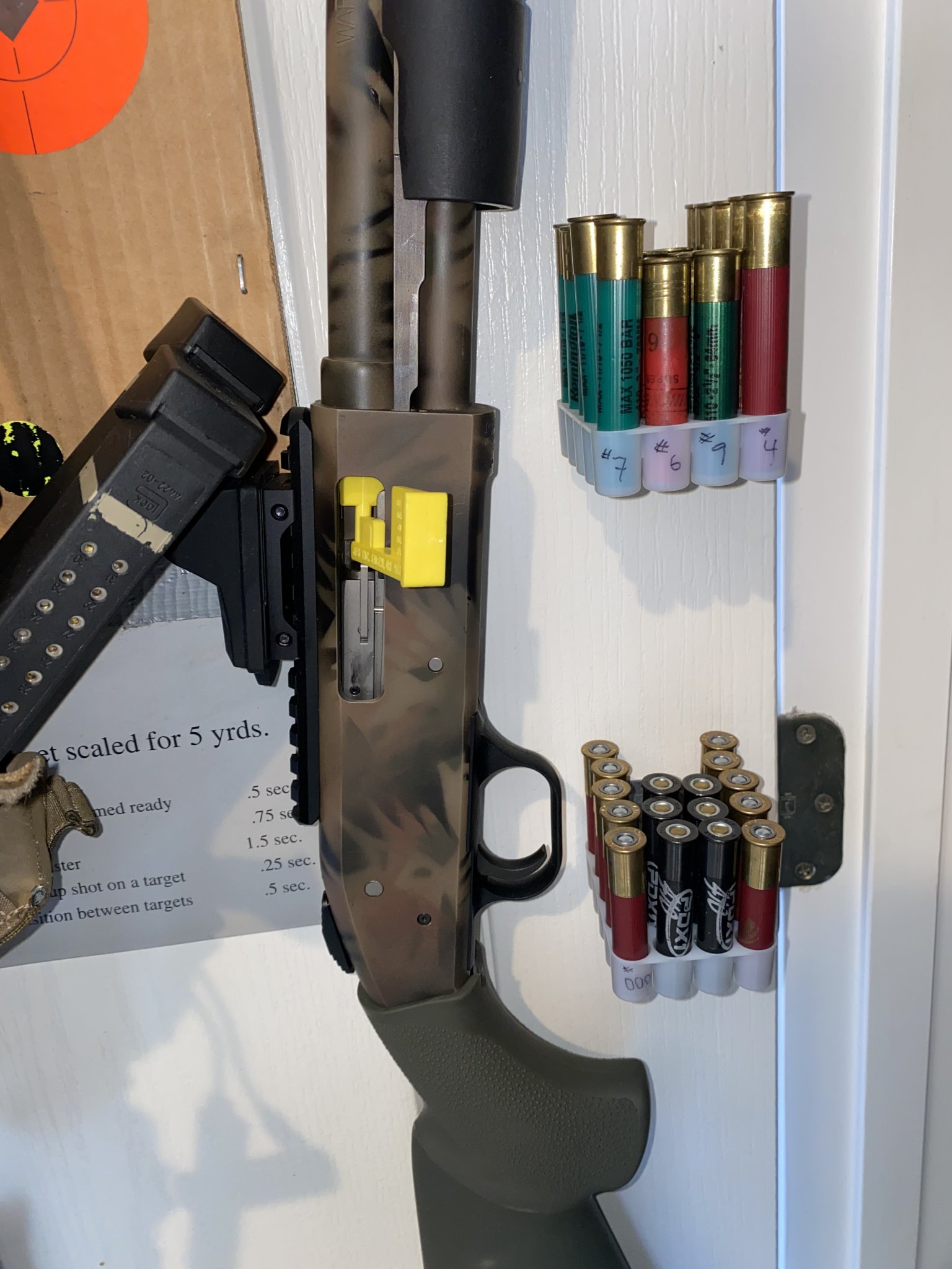

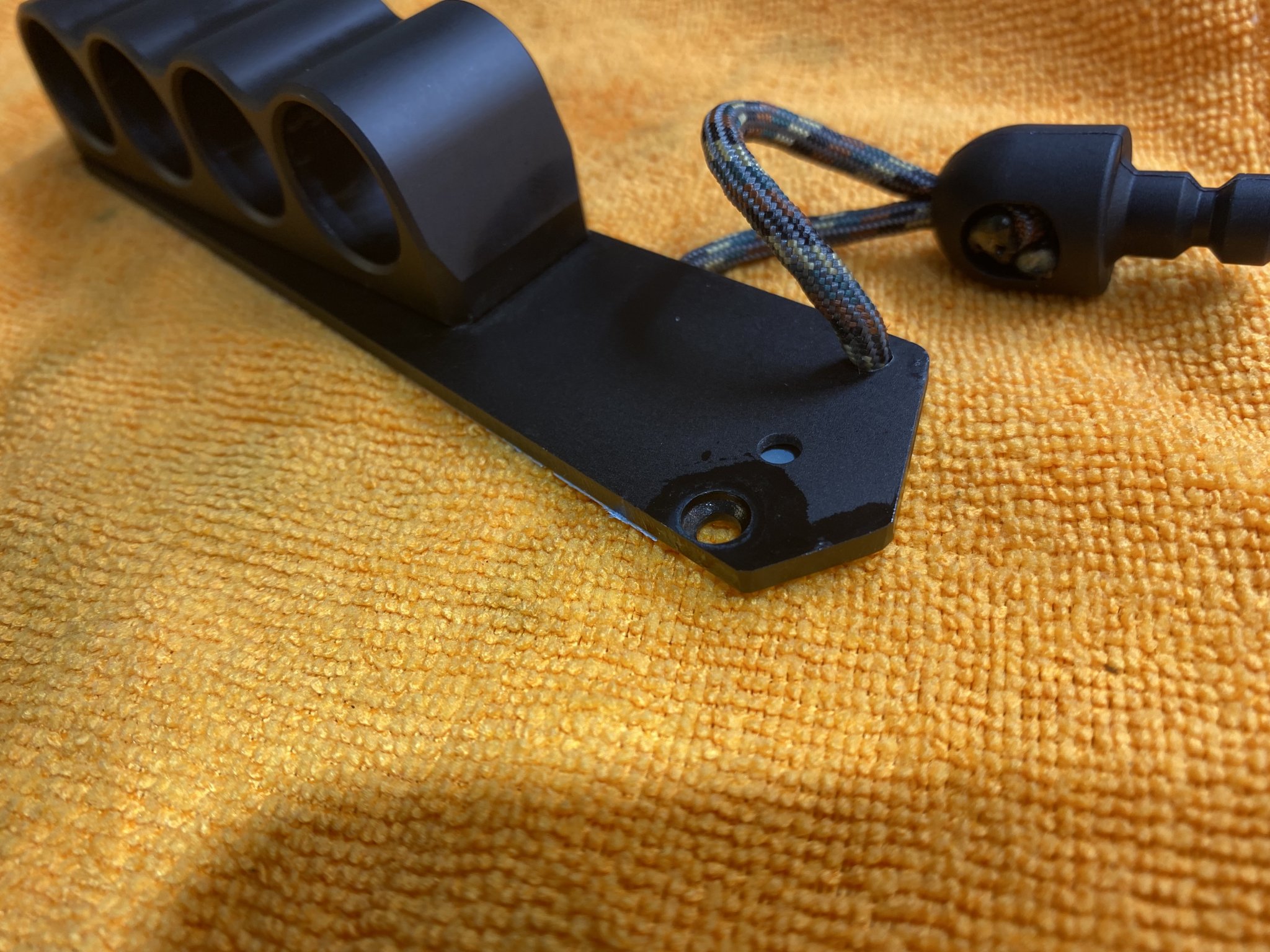

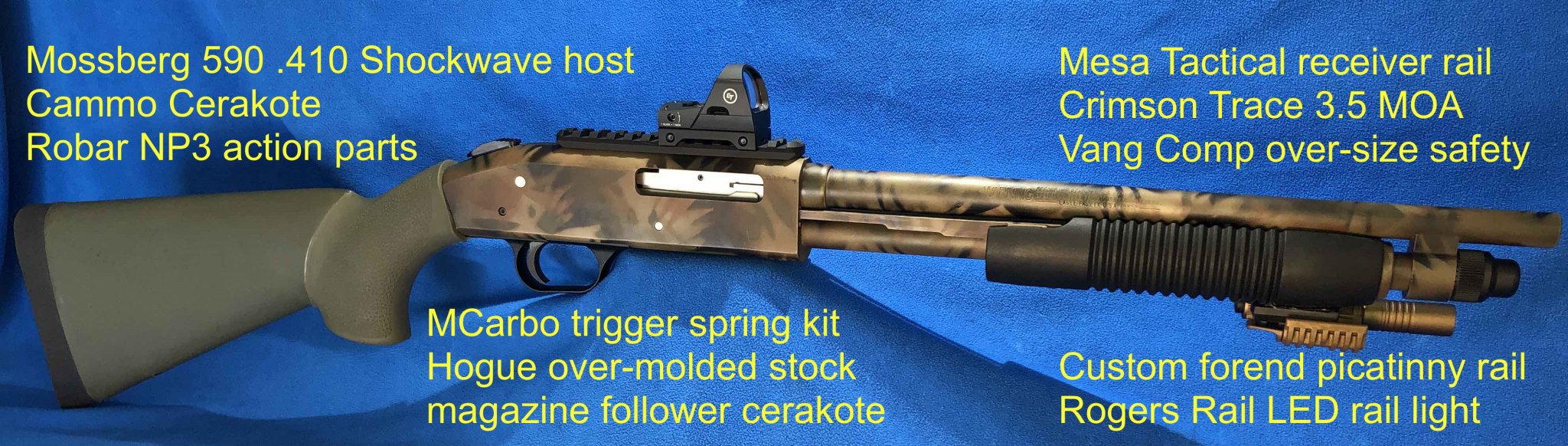

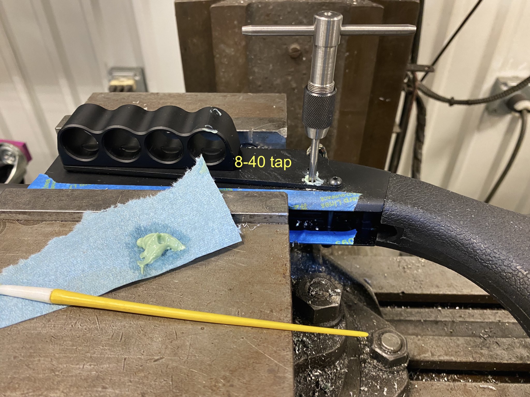

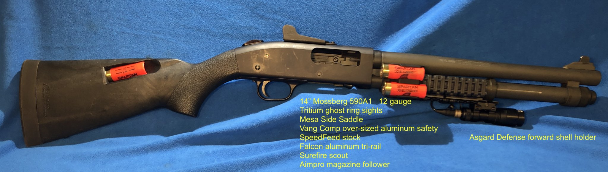

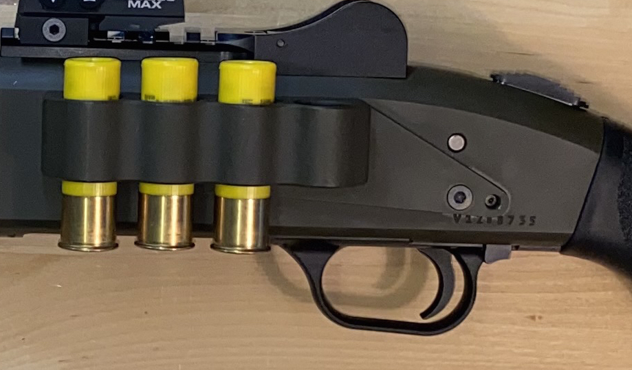

A little long winded. I prefer 4-6 shell max side saddles, Mesa in particular. However their mount replaces the rear trigger group pin with a Chicago styled screw that requires disassembly to remove / clean the trigger group. I modify the sidesaddle by drilling and tapping an 8-40 screw into the receiver forward of the factory trigger guard location and either remove the excess mount or leave it empty to push the trigger group out pin in the usual fashion without any disassembly of sidesaddle fasteners. I have modified my Mossberg 590 Persuader, 590A1 12 ga., 590 20 gauge home defense and 590 .410 in this manner. The 12 ga. 590A1 has the capacity to hold 16 rounds (4-in the stock, 2-forward shell holder, 4-side saddle, 5+1 in magazine / chamber), more than any civilian would require. The 590 20 ga. is perhaps an ideal home defense option, again way too many shotshells than would ever be used; finally, a 590 .410 critter-getter, that can use velcro side cards, veteran company Brown Coats makes a nice product. I modified these mounts / receivers on the mill, however careful drill press, hand drill and Dremel could get the tasks done.
IMG_3347Mossberg 590A1 with Asgard Defense Forward Shell Holder Photos copy 3.JPG
Thanks for these posts. What an education. Appreciate the 00 hallway test, that is what I had in mind for myself, so useful to have that comparison to work with. Also hadn't thought of a hand stop to help manage recoil, great idea. Browncoat looks like another good alternative.
And those are some nice looking rigs.
Yeah even my sticky side is bowing up. Maybe it doesn’t adhere well to paint.
