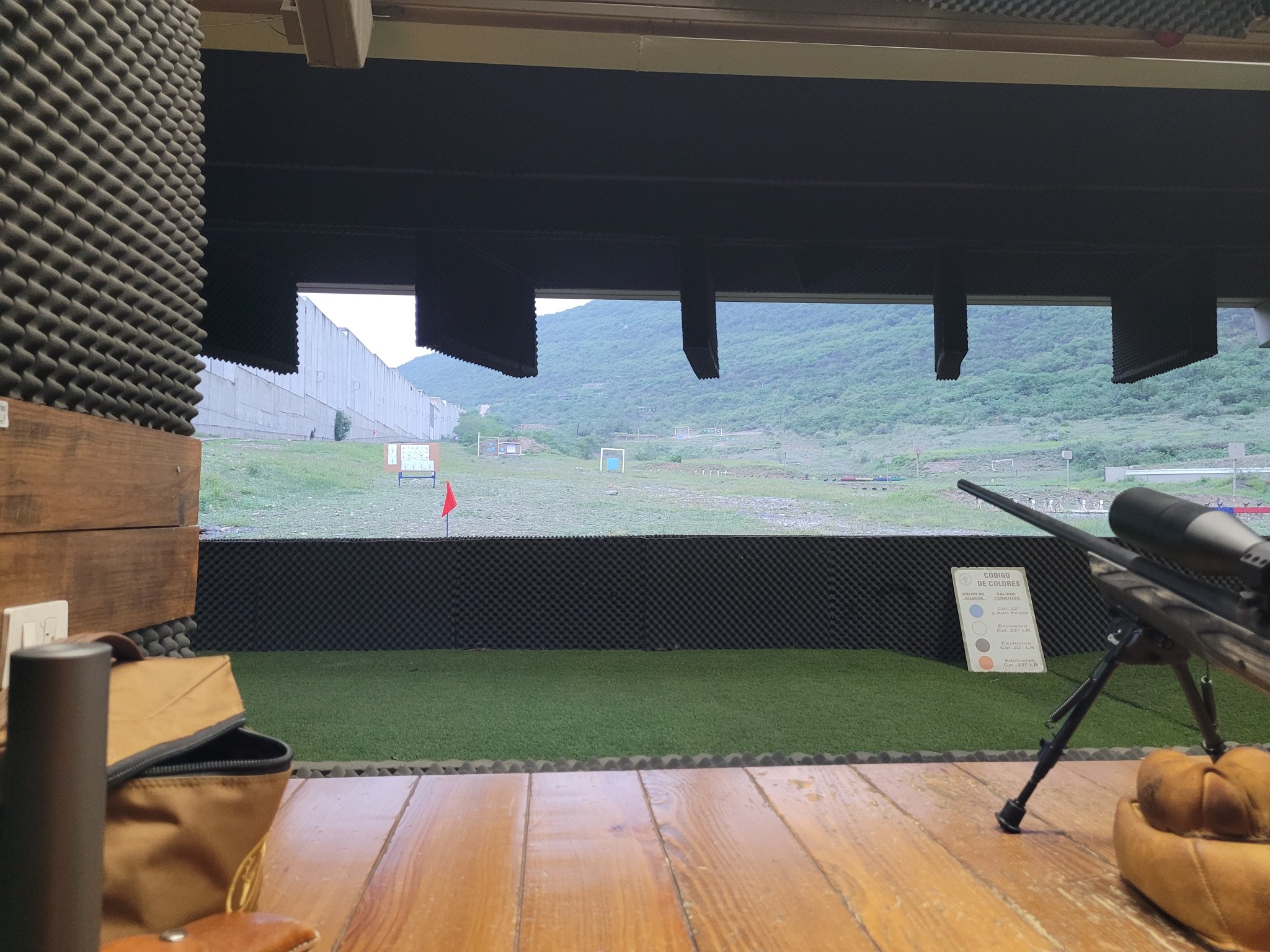

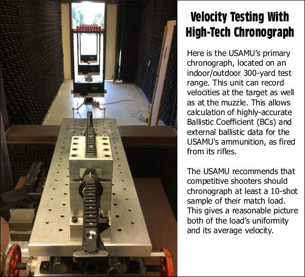

The USAMU Test Shed has all kinds of attenuation built into the structure, much like what you're looking at: baffles, egg-crate type foam, test stand built inside the building (garage aperture secured with a rolling-type door when not in use) with raised earth berms on either side of the shooting lane and nice, stagger-planted tall white pines atop the berms.
It still sounds like you're shooting a rifle from inside a structure.

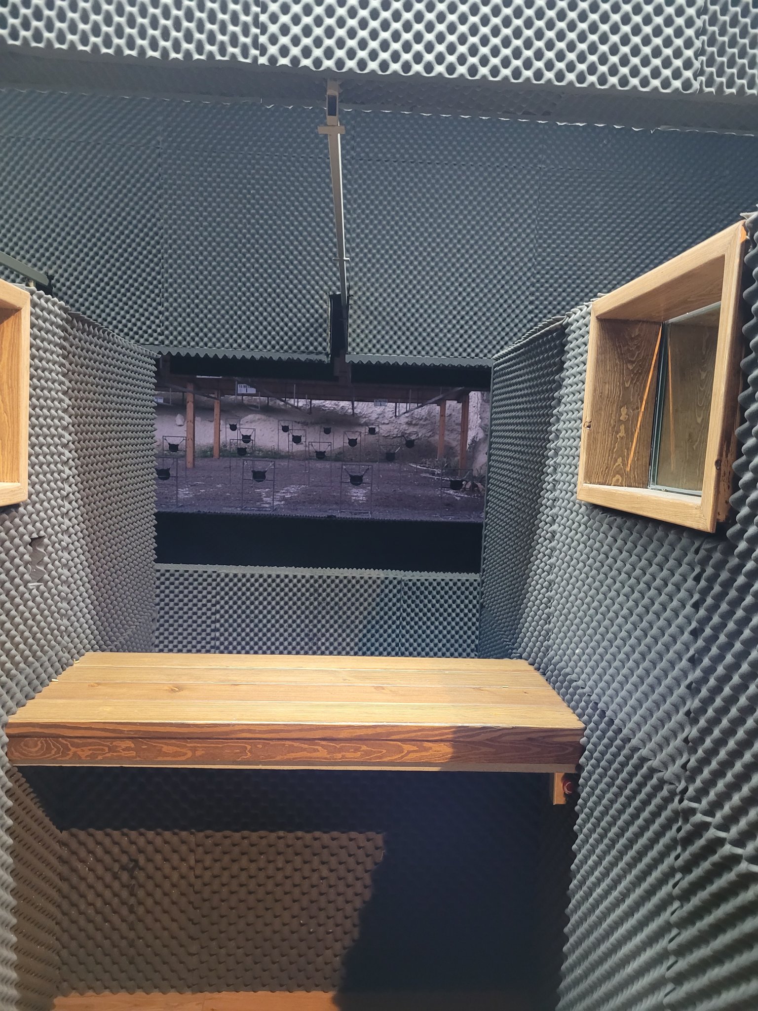

Anechoic Panels. These can be used to partially/completely line the inside of your shooting structure.
Alternatively, build a shooting box. Two 12'x4' Plywood panels can be built into a longish square tube, 2'x12', and lined with the above panels. Support it at bench height and shoot through it.
A problem with all such structures, including the rubber tire stacks, is that they tend to attract stinging insects which use them to build their nests inside. It can get pretty gnarly after that first shot.

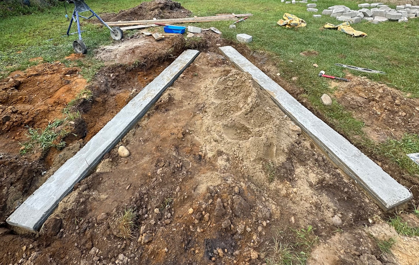

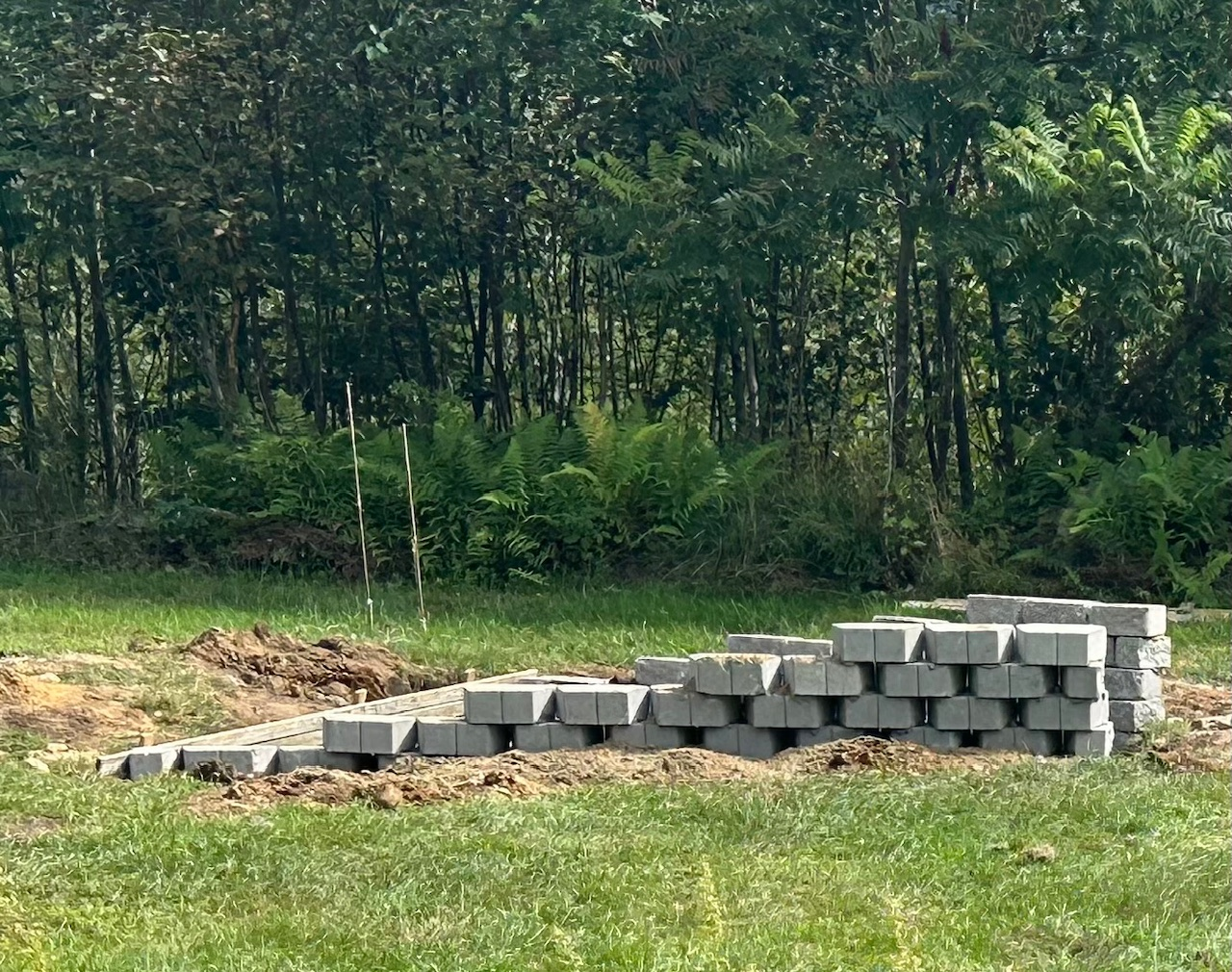

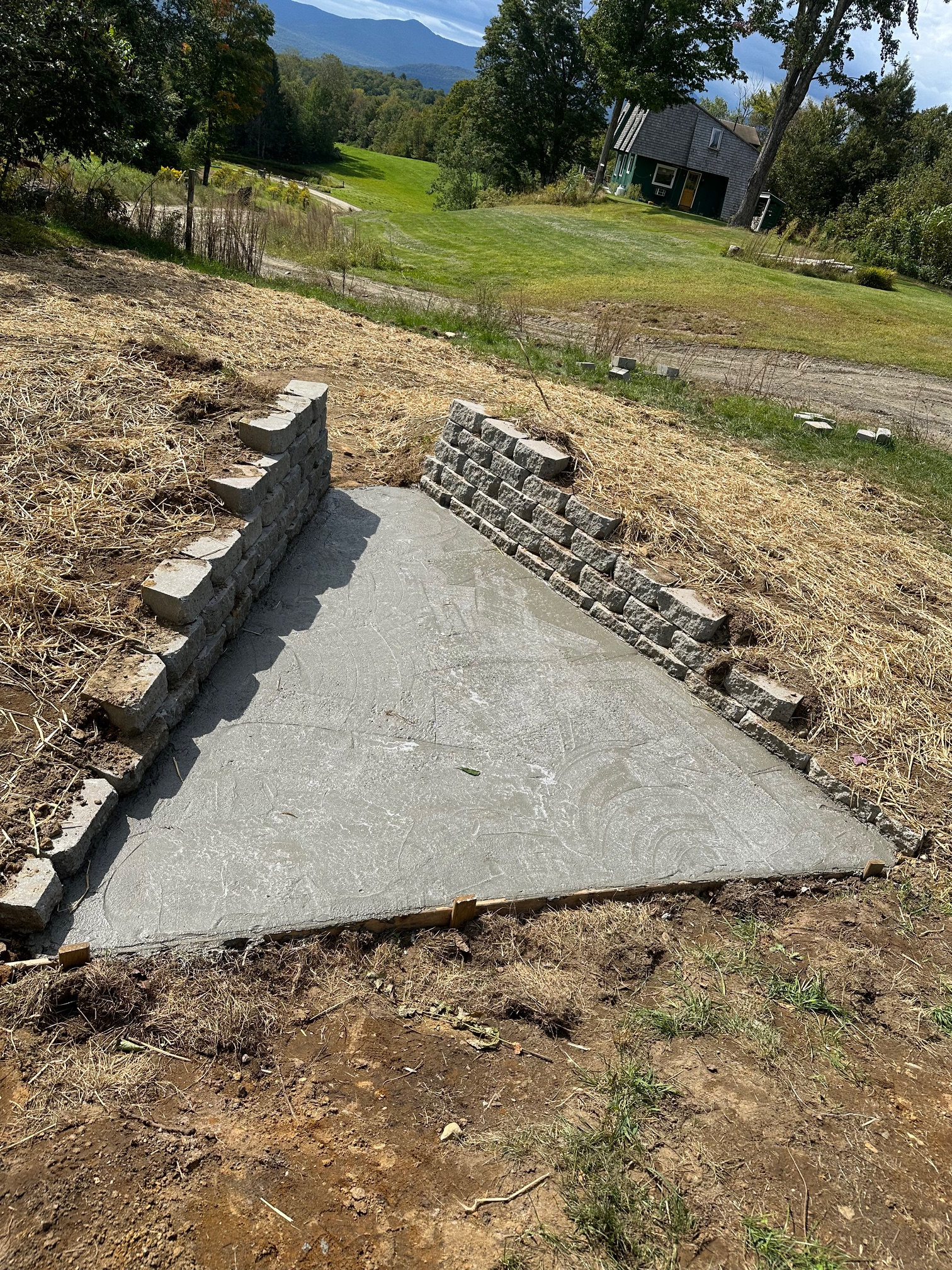

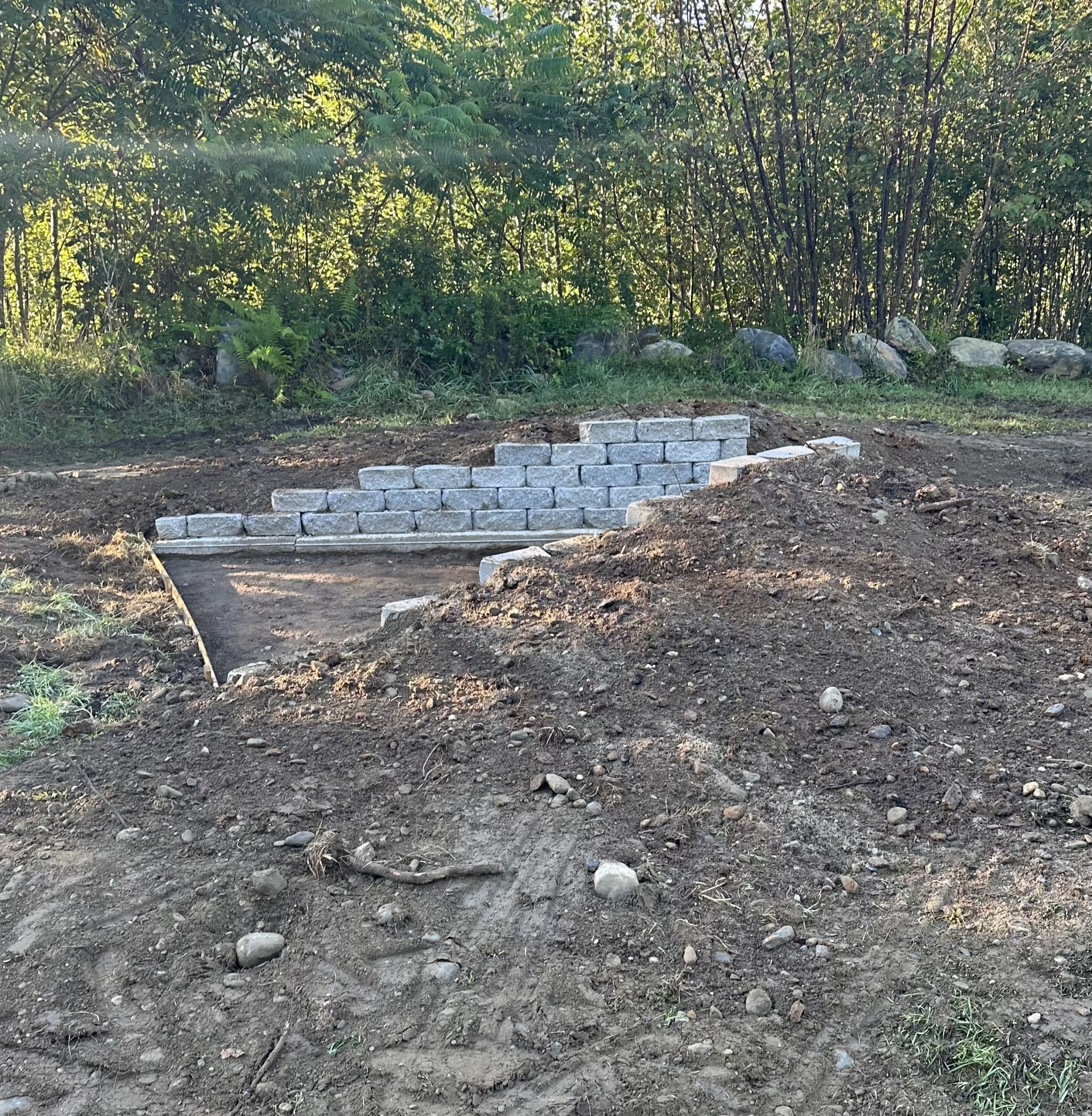

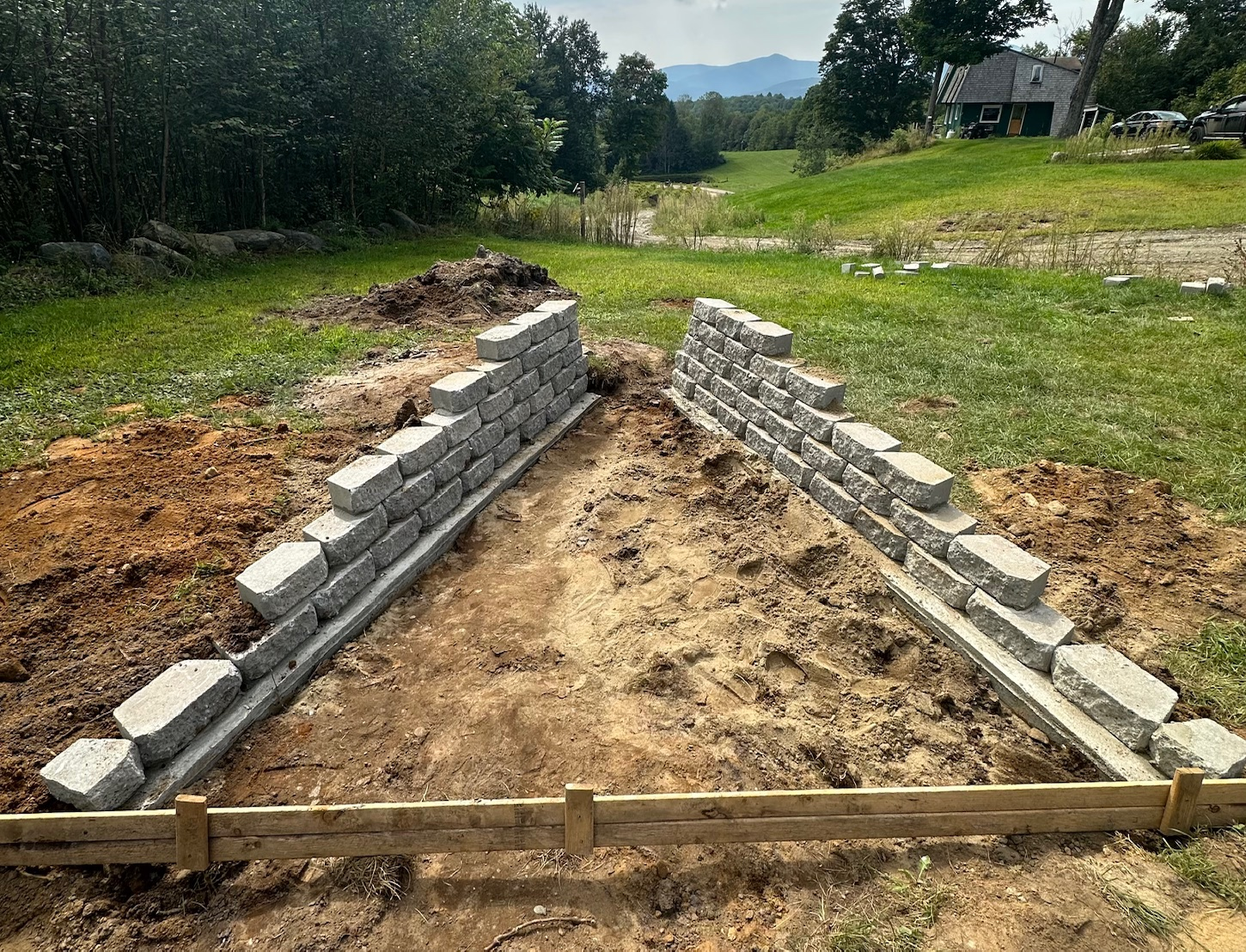

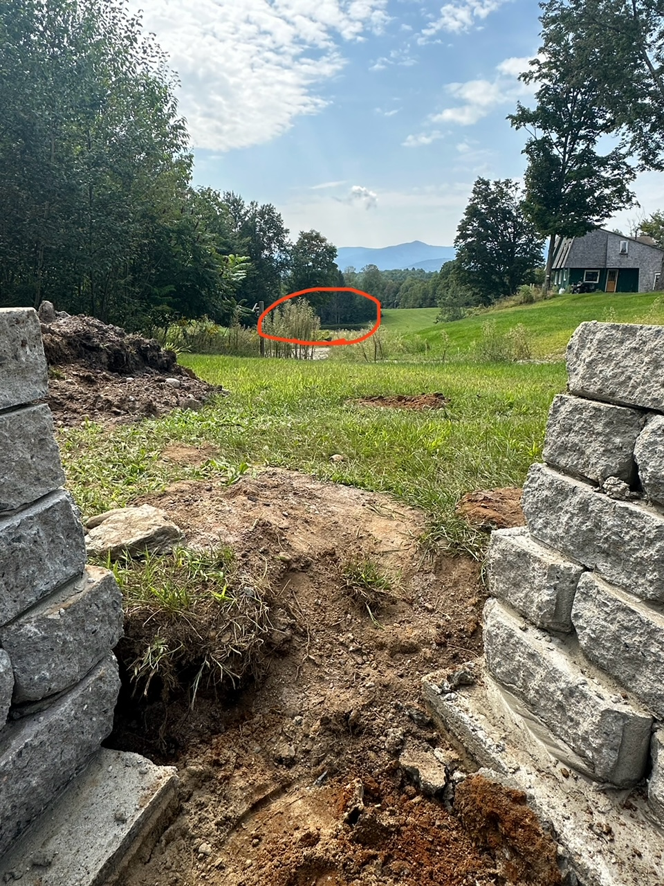

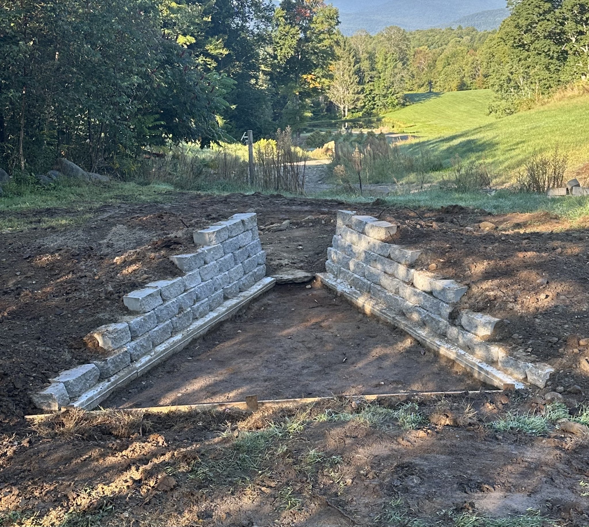

As things sometimes take time…. I finally got my project “off the ground” so to speak. In part because I am putting in a generator shed. So will be getting a concrete delivery. But also because all the new power lines the town I running across my farm have left me with about 40 yards of beautiful topsoil to do… stuff… with.
I actually came up with a design when visiting a part of the Gettysburg battlefield that no one visits… and still has its cannon revetments intact. These were not the “out in the open” field guns of Picketts Charge, but well-emplaced guns at one end of the field.
As a bonus, it will give me a cool place to park nd display cannons!
I tested a mockup using tires and it seems to help a lot. So the permanent structure is going in now. Did the footers today and doing the stone work tomorrow.
Pictures coming…. Quite simple setup.

This overloos my 300 yard steel. To get out to 300 in my AP I have to drive 45 miles. So being able to shoot here on the Schloss matters. This is the top of the plateau and the steel is over my pond. Using the design for the revetments at Gettysburg to create a sound wall that channels sound up and back into the woods about 3 feet behind me. Nice sandy soil. Put in footings first.
Then using retaining wall bricks from Home Depot... Dirt Cheap... Building up wall. In Colonial/Civil War times, they used rocks. I can get cheap concrete blocks from Home Depot. $2.05 each. Had most left over from retaining wall project. Only had to get about 30 more. Built up to create a wall I can shoot in... but also landscape/pull soil around it. So it disappers into the lawn overlooking driveway and range.
Looking downrange... Once I have the walls backfilled, I'll finish the 'ground' and pour a slab that connects the wall. So I'll have a nice smooth surface for shooting mat. The 'front' will get final leveled and sculpted so it's wide open. Right now, the front is a bit high, but I'll re-sculpt the front slope to be perfect to shoot into steel.
Probably hard to see... but the steel is inside the red. That's 300. I'm going to add a couple of pieces. But to get to 300 in my AO is a 45 mile drive. If I can shoot out my back door, so to speak, and attenuate noise... it's a big deal! This will focus sound up and back and my idiot neighbor (over a 90 foot bank and at 340 degrees left) won't hear much. Plus it's an excellent display area for a cannon. Gettysburg style revetment!
Going to let all the concrete/morter set up this week and will finish next weekend right down to the grass seed! But going to work great.
Cost.... about 80 bricks from Home Depot at $2.05 each. About 40 of which were left over from retaining wall. 6 bags Sakrete cement at c. $6 each. 2 bags Sakrete Morter at $8 each. Ish. But still have to pour slab (which will be 'leftovers' from generator shed I am building. So looking at about $300 to build this. At most. And one weekend.
Who doesn't want a revetment overlooking the entry road anyway? Just 'sayin!
Cheers,
Sirhr
PS. about 65 blocks (already had 48 left over from retaining wall) 6 bags Sakrete concrete. 2 bags Morter. And I'll pour the 'slab' when truck comes to do my generator shed. Minimum 4 yard delivery. And will need 2 - 3 for the shed. So the range revetment/noise abatement will be pretty much free. Figure I have about $300-350 and one weekend invested by the time it's done. Already have lots of dirt.
These pics are from a range in Monterrey MX. That is pretty much in the middle of town. Rifle went to 600 or 800 if I recall. Bigger scale then most need.
I have done some decent testing concerning shooting out of buildings and even a good shed does not mitigate the noise that much if the weapon is supersonic.
I recommend you don't worry about building such things.
No points for style on my pour... hard to get a screed board or a float in there. So just did some trowel work and there ya go.
But the whole cost was about $400. And at least I have a nice place to lie when plinking at 300+-. And I'll let you know if it keeps the noise down.
Oh and cannon parking for those beauty shots! ;-)
First gun that I'll test will be my TacOps... finally got suppressor out of jail. Will be dialing it in and having some fun with it (Finally) next weekend!!!
Sirhr
