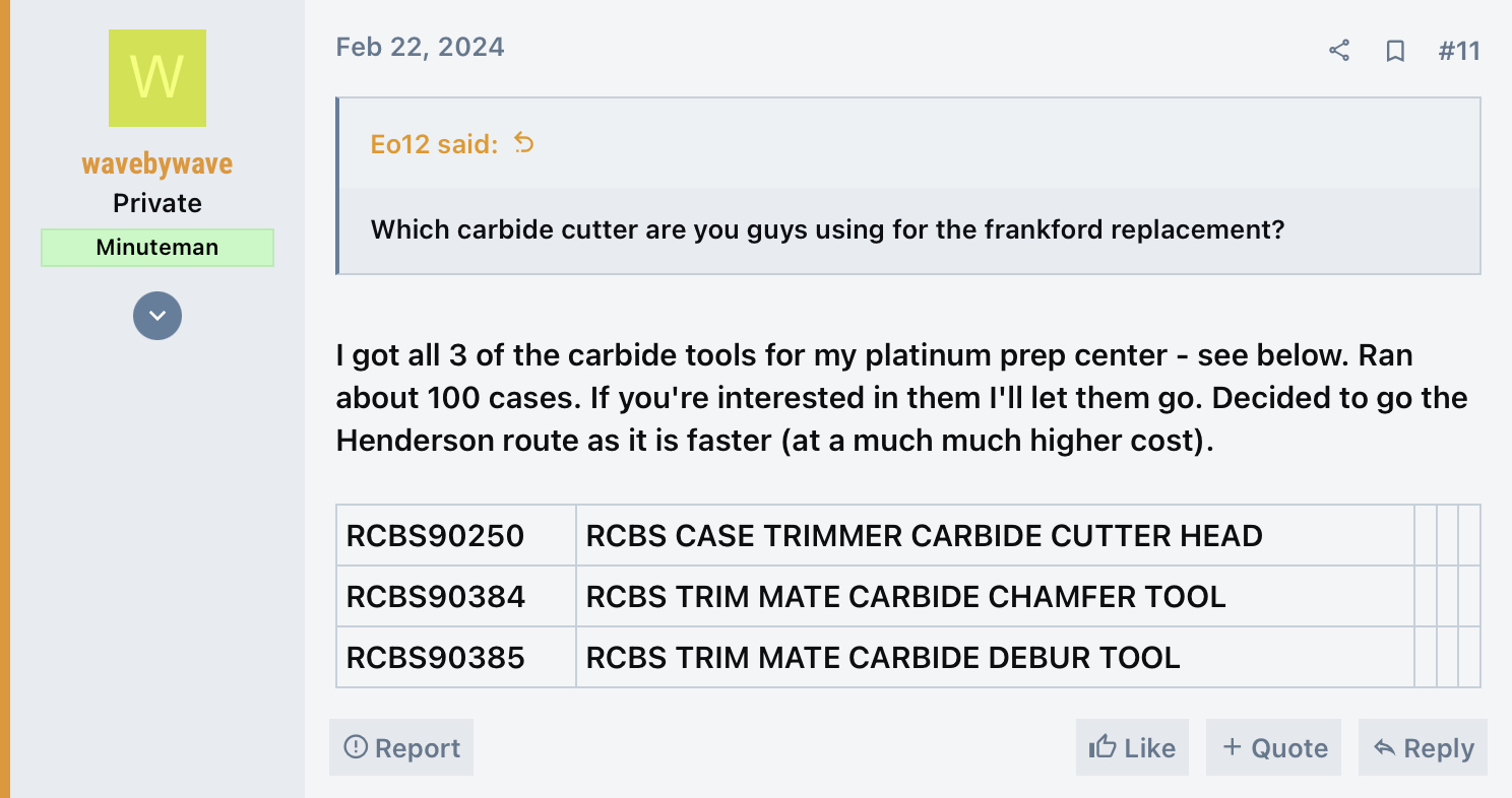

You mean the chamfer and debur cutters on em? What did you upgrade with? I have a giraud but if I'm not actually trimming I also use the FA prep station a lot
I just upgraded the cutter to a carbide and what a difference both in ease of use and dimensional consistency.
I went with a RCBS brush for the pockets.
I just started looking for alternatives for the chamfer cutters. I’ll let you know what I find.

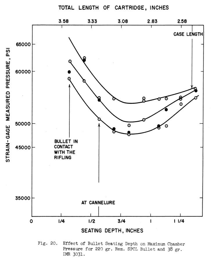

I haven't listened to the podcast... but I also don't think seating depth matters (what matters is them all ending up the same). Use a legit sample size and you'll see the same thing.
Guys can use small sample sizes to form opinions and make decisions if they want, but then they're just seeing what they want to see.
Hmmm?? Am not sure to what extent you're thinking that seating depth doesn't matter.
Seating depth effects pressure and by extension, it effects velocity. Variances in seating depth is going to result in corresponding variances in pressure. Does that matter? I suppose it depends. 🤷‍♂️
Here's a University of Michigan study from 1965 where info about that is shown:
  • BlowBy effects pg 58 -1965 Chamber Pressure report.pdf
Reactions: Aftermath
