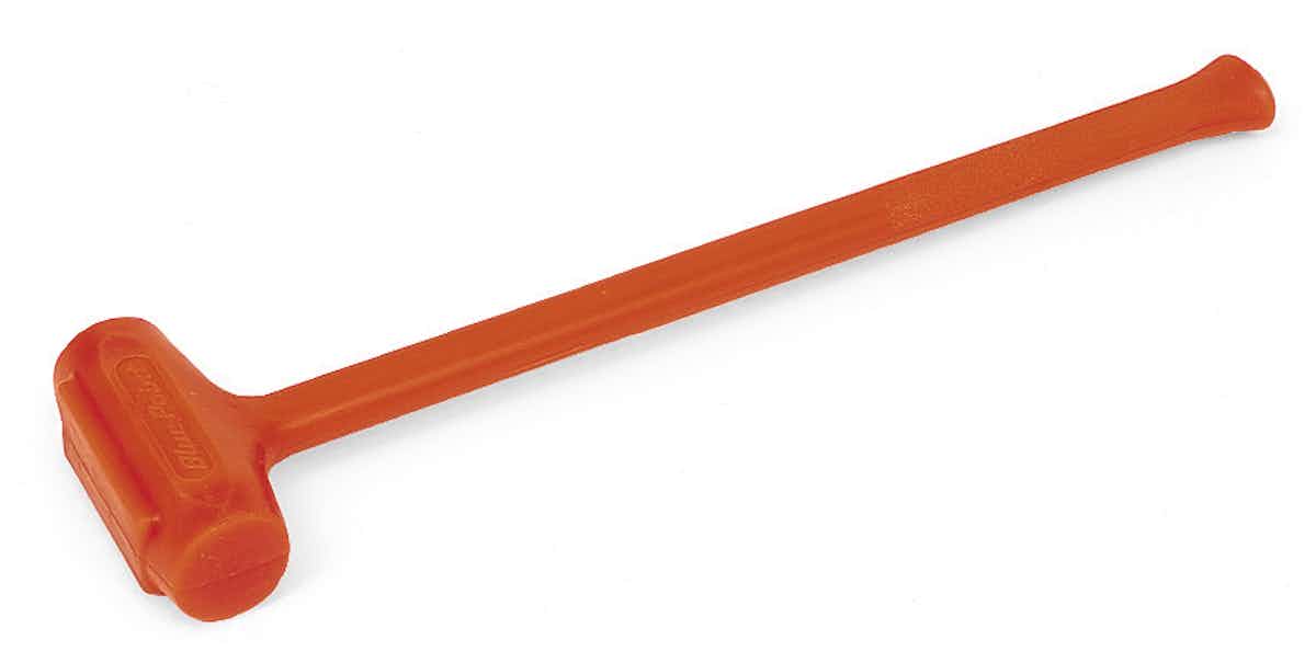

    We use a long handle dead blow hammer at work. Hit it from the back side and rotate the wheel to hit in different areas. When you do get it off, coat the mating surfaces with a very light coating of anti seize. Modern hub centric wheels can be very tight, even on new vehicles.
    5lb, 20 inch handle
