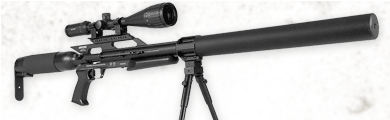

https://www.airgundepot.com/airforce-texan-ss-hawke-scope-combo.html
Take a look at the 45cal Airforce Texan SS airgun.
