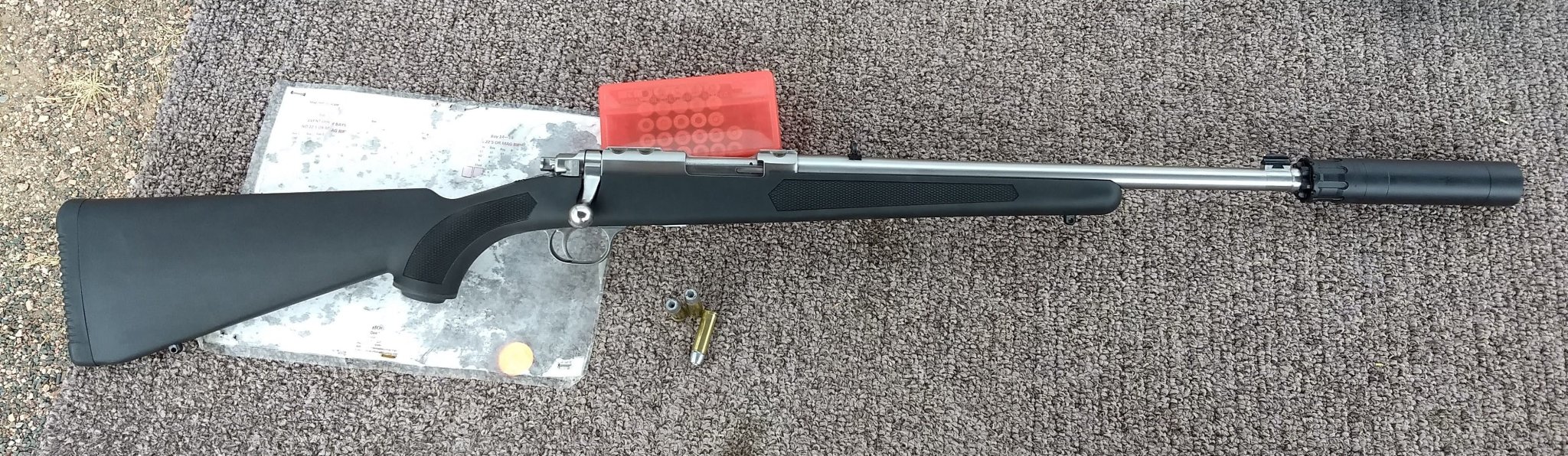

I've been building my own .308 Win subs for almost 15 years, long before I ever had a can, because I had buddies who had them. I used to make subs for them. Use the right primers, powders, and process, and you won't need to do anything special to the cases, you won't need to drill flash holes, or anything you saw online 10+ years ago. And you also won't have any real issues, as long as you don't
I use TrailBoss powder since 10gr fills up a lot of the .308 Win case to give a consistent ignition, and I've NEVER had a hang fire, or any issues. Also, I use Federal "FC" .308 Win brass. Federal brass is shitty, but it does great in low-pressure rounds, like subs. It's actually very consistent. And it's cheap and plentiful. I've picked up probably 500+ free 1x fired cases from the range that people left in the brass bucket just over the last year or 2 alone. I bring them home, decap them, sonic clean them, FL size them, and then polish them, and they're ready to load, and FL sized so they're good to go in any of my .308 Win's. I even make some 168 subs, because they shoot great in my slower twist barrels (5R 11.25 twist), and will shoot very accurately. I've shot sub-MOA groups @ 100 with them, and take them out to 200 & 300 yards on a regular basis. Granted, they were not expandable sub hunting bullets, they were target bullets, but they still shot REALLY well.

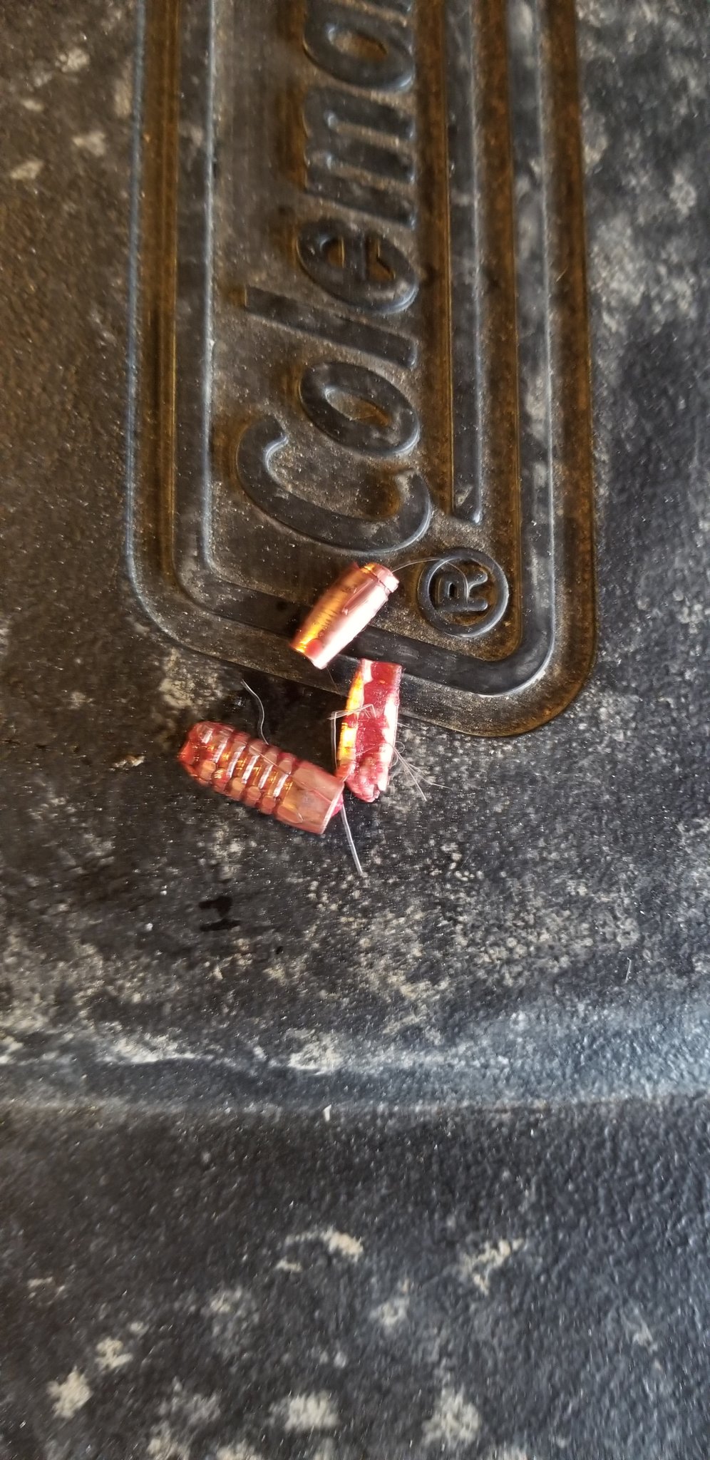

Lehigh Defense 176 grain Controlled Fracturing. 54 yards. 1020 fps (ish).
40 yards recovery.

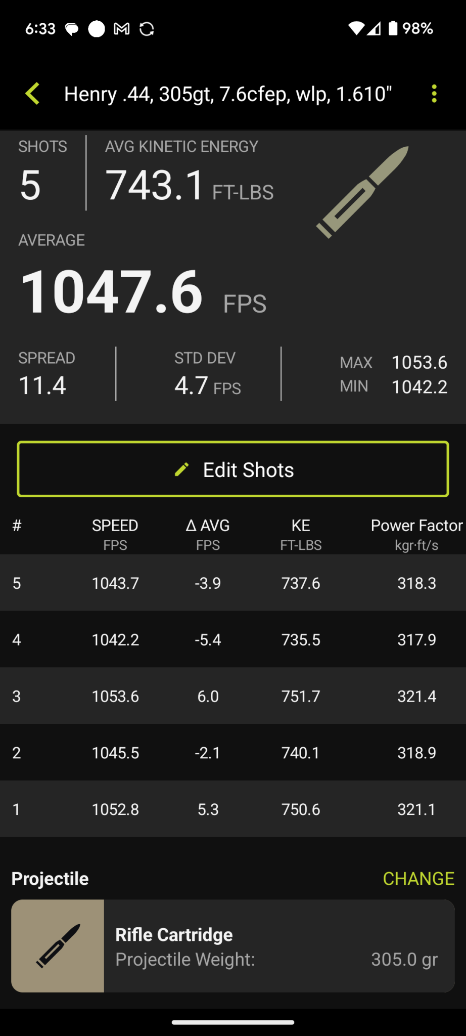

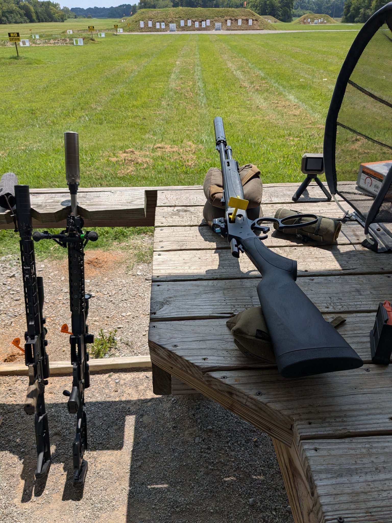

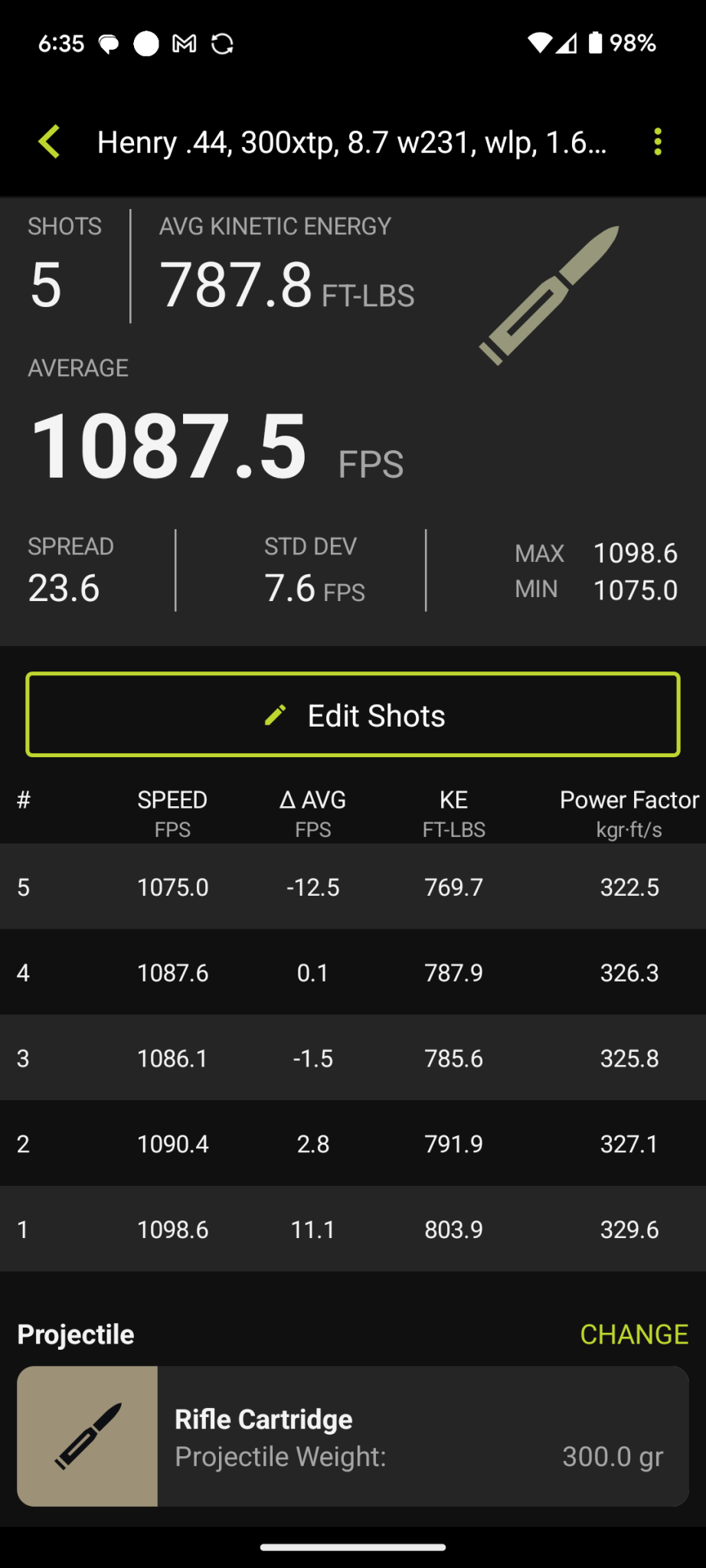

I really like my 44/77 and Henry X, plan on using at least the Henry this year with 305gr cast HPs or 300 gr XTP for deer.
Actually plan on hunting all the rifles in that second picture this year, but the Henry is dedicated to subs, and is exceedingly quiet.

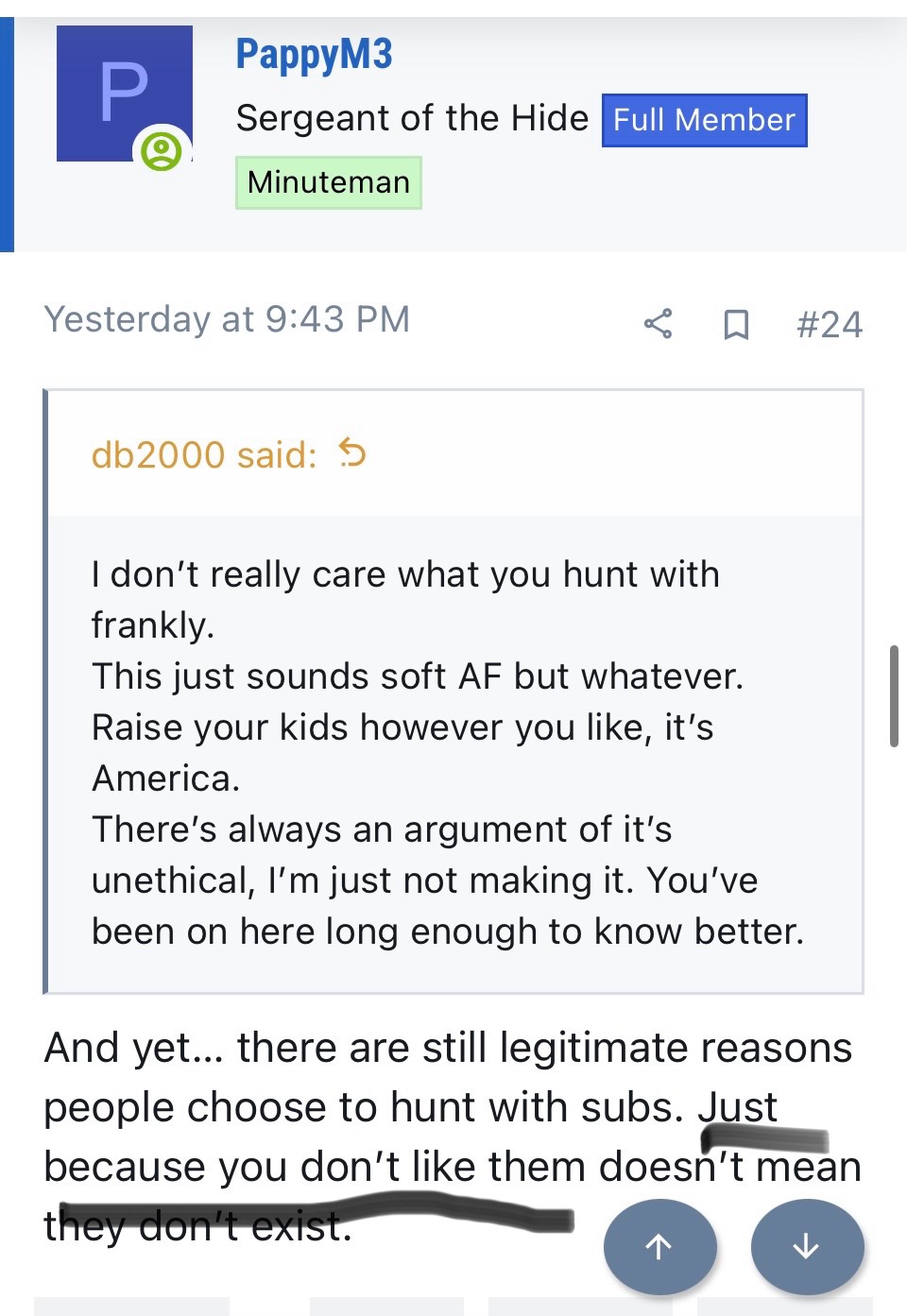

And yet… there are still legitimate reasons people choose to hunt with subs. Just because you don’t like them doesn’t mean they don’t exist.

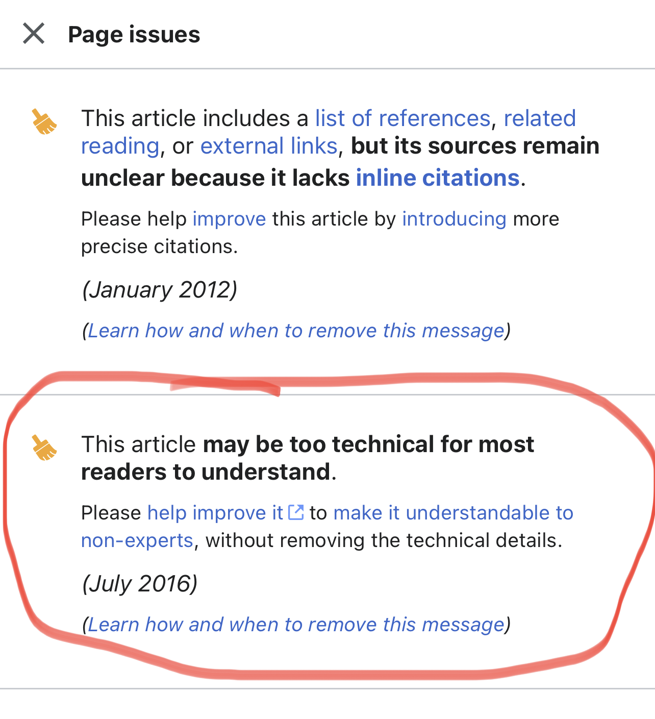

So, this seems to be the paragraph that is creating controversy?
This is not a great paragraph.
First, “you” = @db2000
In the second sentence, “them” could refer to “reasons”, “people”, or “subs.”
For example, Pappy could be saying:
1) db2000 doesn’t like the reasons people hunt with subs.
or…
2) db2000 doesn’t like the people that hunt with subs.
or finally…
3) db2000 doesn’t like subsonic ammo
We can rule out #2 & #3 because it’s obvious db2000 wasn’t trying to say either subs or certain people don’t exist (see last bit of second sentence), either metaphorically or in reality, so that leaves us only #1.
One should not have to work this hard to decipher a paragraph.
For that, I hate you @PappyM3
Lol just kidding
