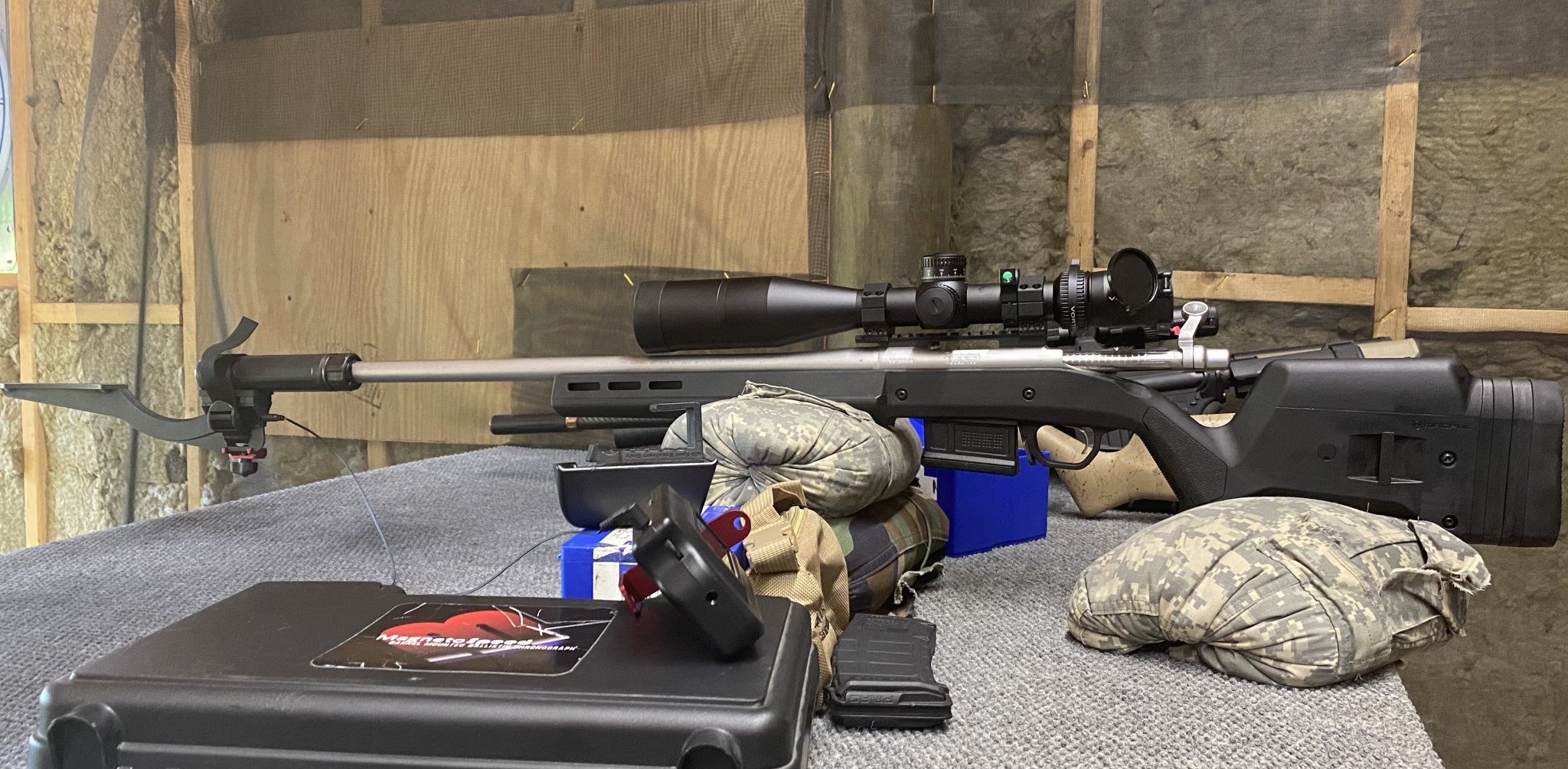

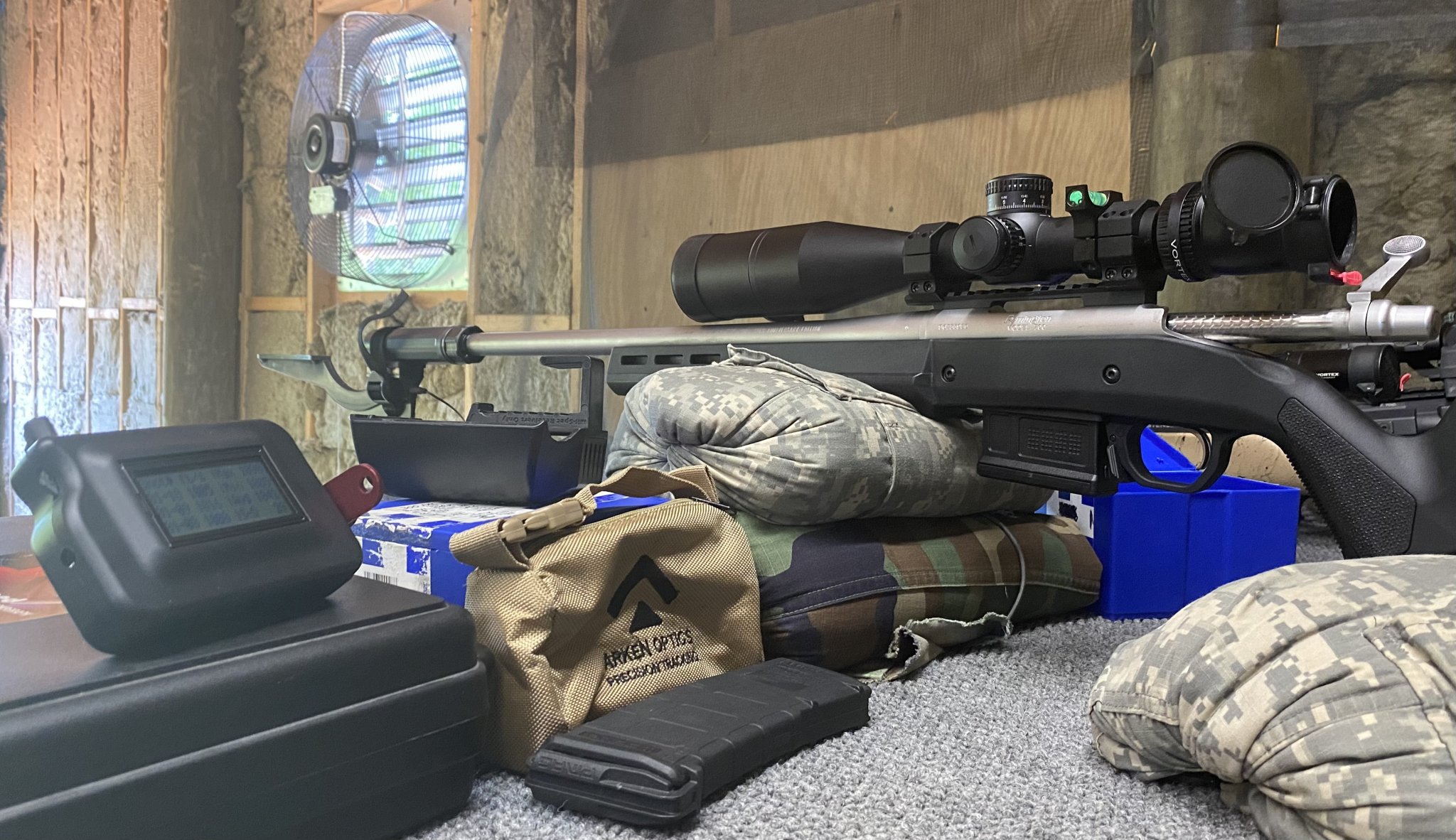

Reminder for posterity, and safety: work your loads down, not up, and always check for keyholing before mounting your can.
.308 Win Subsonic
16.5" Barrel Rem700
10 twist
Federal LC brass, factory flash hole, full length sized.
CCI 200
10.8gr Trailboss
Sierra 200gr SGK
COAL of 2.810" fits in AICS mags.

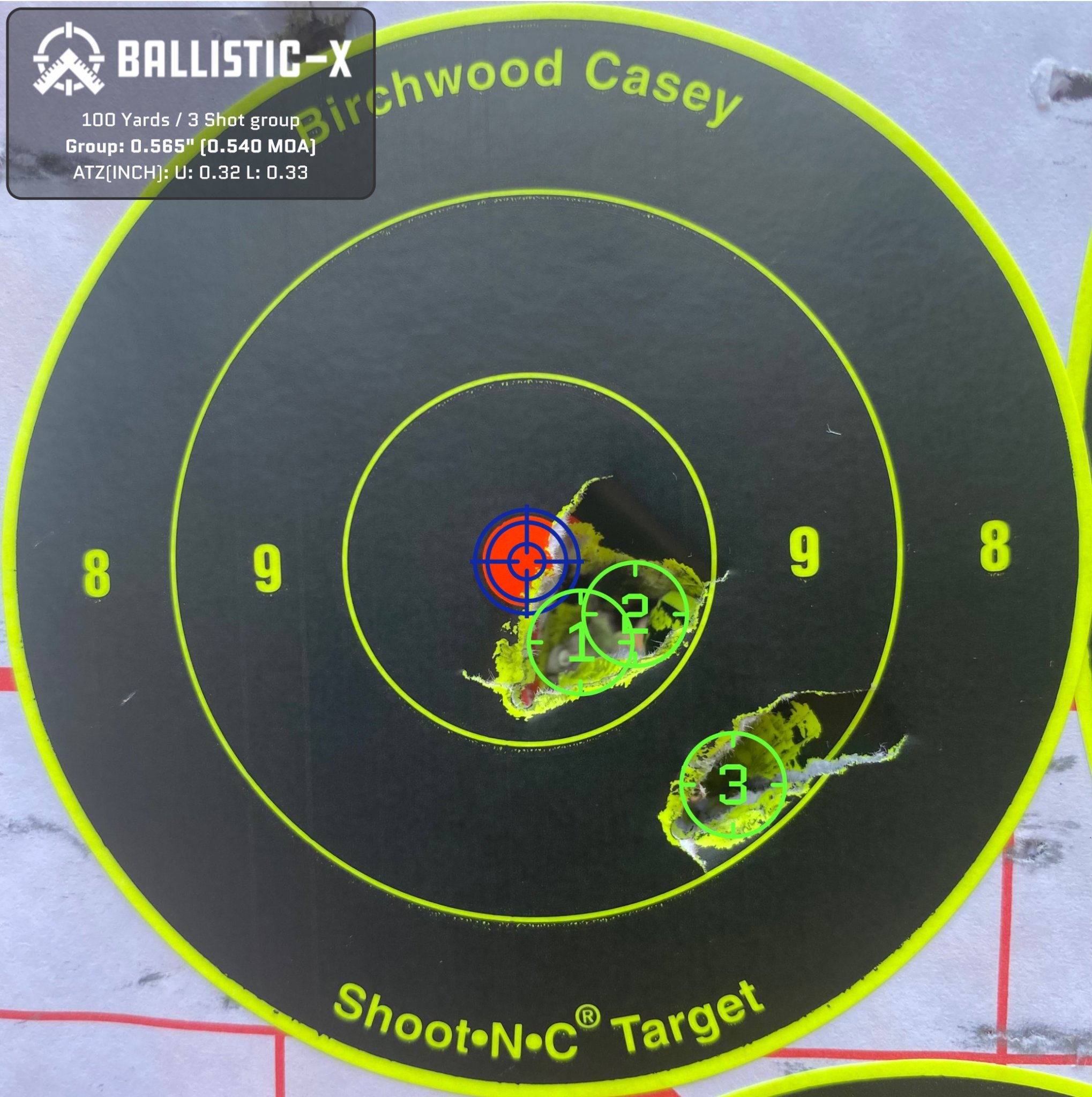

Printed a wallered out clover-leaf 5 round group at 100 yards, 5000'DA. Must be running at the ragged edge of subsonic velocity, round 6 produced a sonic crack as it headed down range, but it cooked in the chamber a bit as there was some nonsense going on a few lanes down that stole my attention for a minute. Hate to goof with a load that shoots like that, but tempted to back it down so a warm day or a hot chamber doesn't wreck my suppressed performance.
For the data hounds, I am not measuring velocity, SD, or ES. Just keeping a few rounds in my hunting pack for close range targets of opportunity so as not to spook the game I'm actually after. Was shooting a very consistent 3 mil low and .5 left between supersonic rounds at 100, so 3 up and .5 right becomes my zero offset. Easy squeezy.
My zero offset is also about 3mils vertical and 0.5 horizontal when compared with 175 SMK out of a 16in barrel.

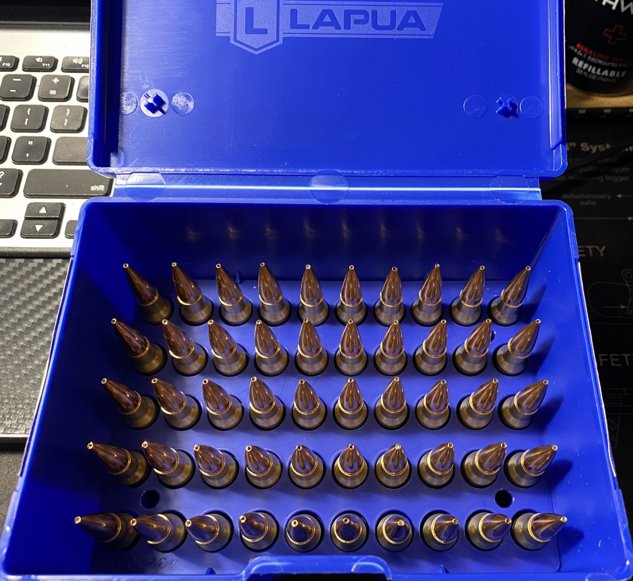

Alright... Going to the range today to try out some 168 Nosler Custom Comp subs in my .308 Win.
I used some old once-fired range pickup FC .308 brass that have been neck-sized and loaded with CCI 250's, and Trail Boss. I already FL-resized them before loading the Berger 210 sub test, so they're fire-formed to my chamber.
Hopefully these won't be an unpredictable shit-show, and they should actually stabilize and group at 100 yards, so I can then take it on out to 200, and get some dope data for my rifle. I don't use a thrower, I literally hand-weigh each charge with a plastic spoon to within 0.05 grains, and check concentricity of each loaded round to ensure the COAL is within 0.0025". I normally don't like my handloads having more than 0.0015", but with subs, it's not going to be THAT precise anyway, so... 🤷🏼

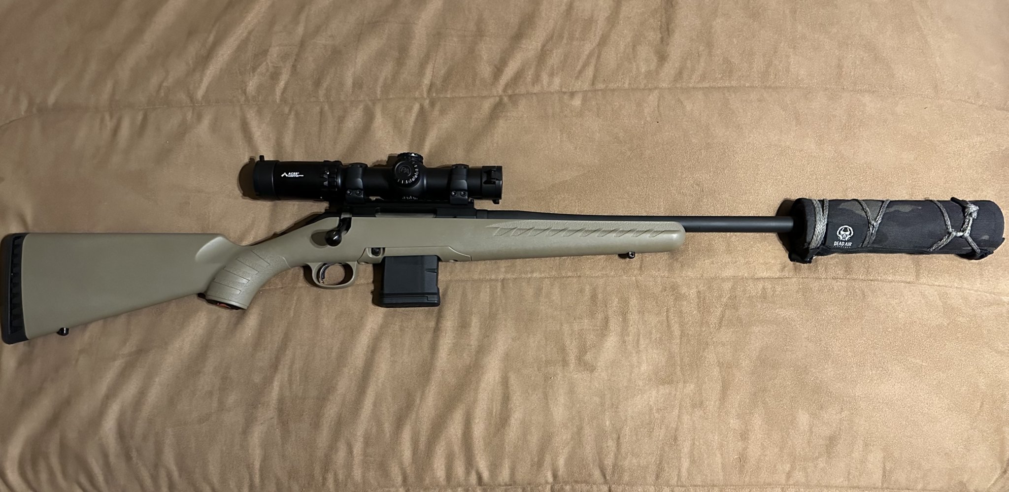

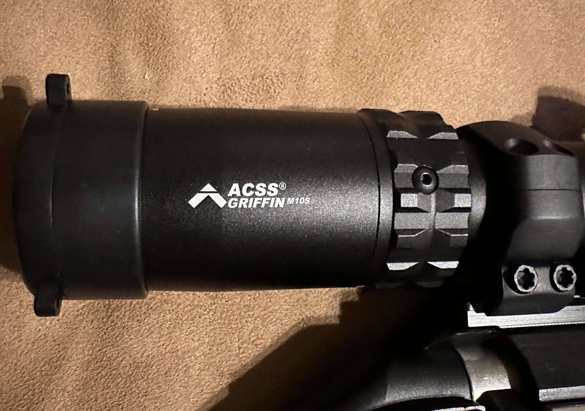

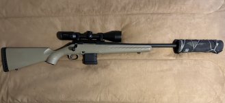

Presenting the world’s most expensively-scoped Ruger American Ranch in .300 BLK… 🤣😂🤣
My local store had 2 in stock Saturday evening when I stopped in there, so I decided to pick one up to play around with. I didn’t have any spare [appropriate] scopes on-hand to put on it, so I had to go with a spare I already had sitting on the shelf. It’s just a temporary setup, but it is a nice shooter. It is ridiculously lightweight with the Kahles Helia KX on top, but the travel bottoms-out right at 100, so it’s not gonna work on this rig. And it’s stupid-quiet with my Hydrogen-L and Nomad-LT with my 220 sub handloads. Sounds like a pellet gun. 👍🏼
Here it is with my Nomad-LT on it.

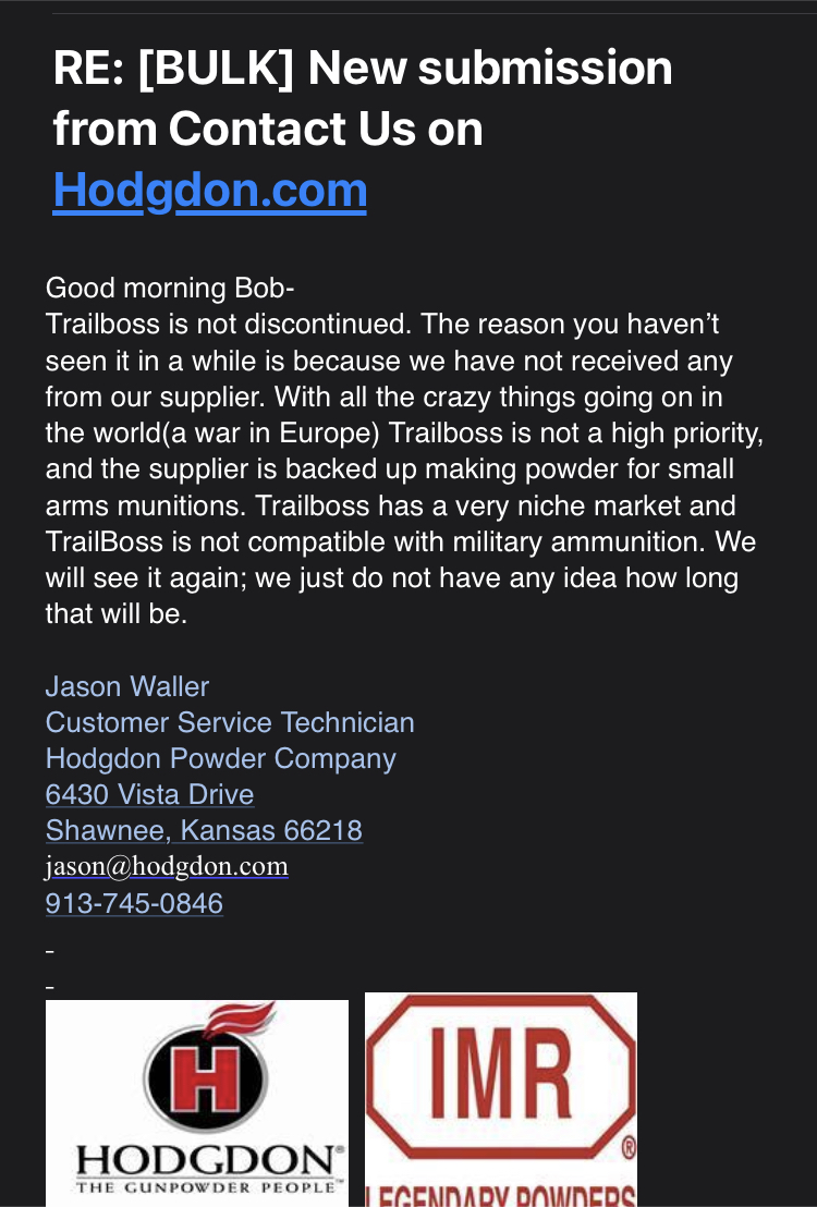

Man, f*** the war in Europe! Let them make their own damn ammo, and stop soaking up all our reloading components! This is the USA…Not Russia, not Ukraine… So stop pandering to them and feeding them our ammo, powder, primers, etc…, and ignoring your customer base here at home. The war won’t last forever, but your reputation of how you ignored your own countrymen’s needs, to profiteer from Elitist billionaire shell corporations to feed the proxy war machine in another country, sure will… 😡
I could be wrong but I thought it’s imported from Australia.
But rant away, I want more subsonic powder.
