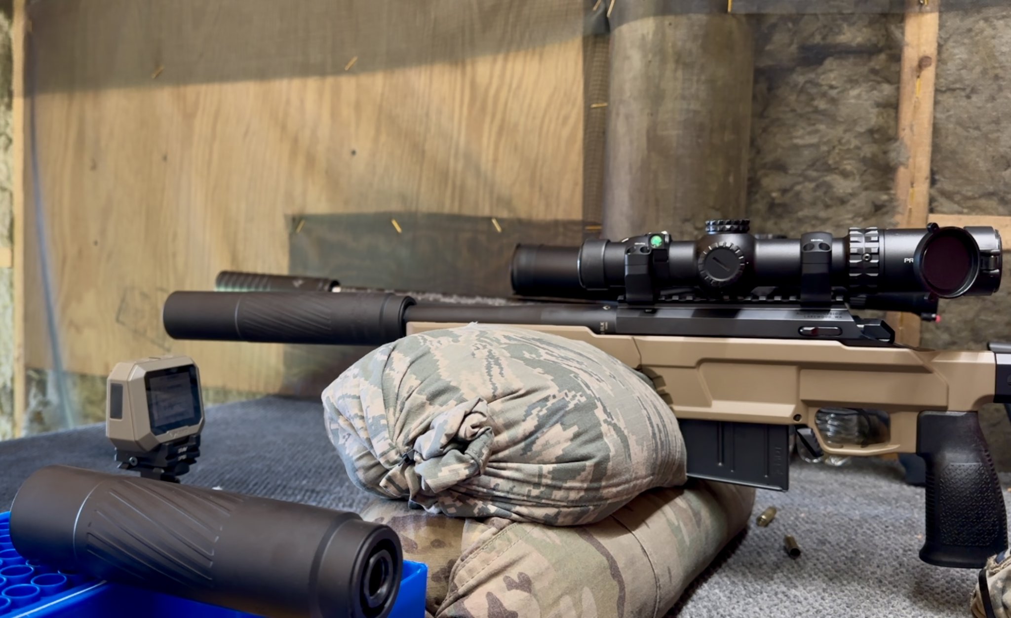

New video of the brand new TBAC Magnus-S HUB can on a 16" .308 Win with my subsonic handloads.

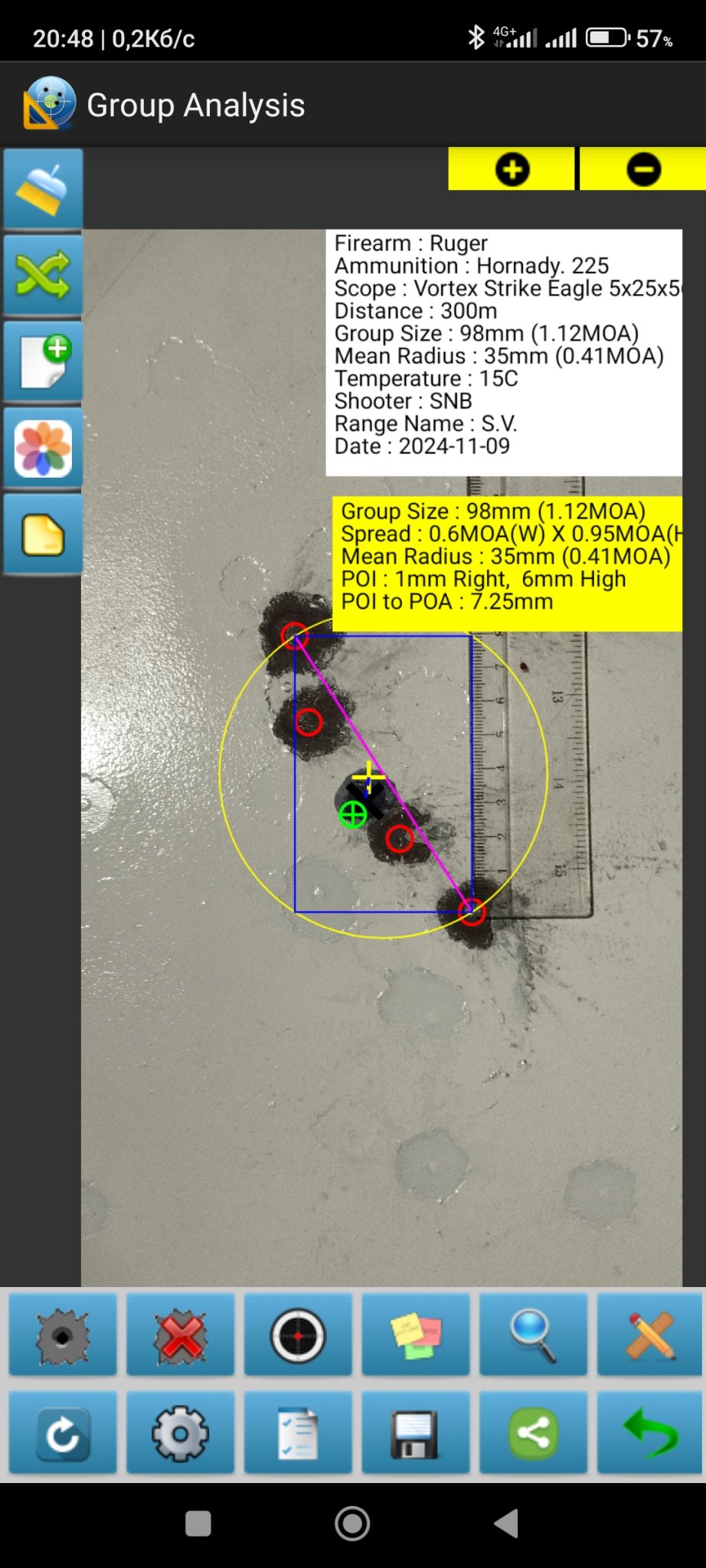

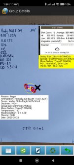

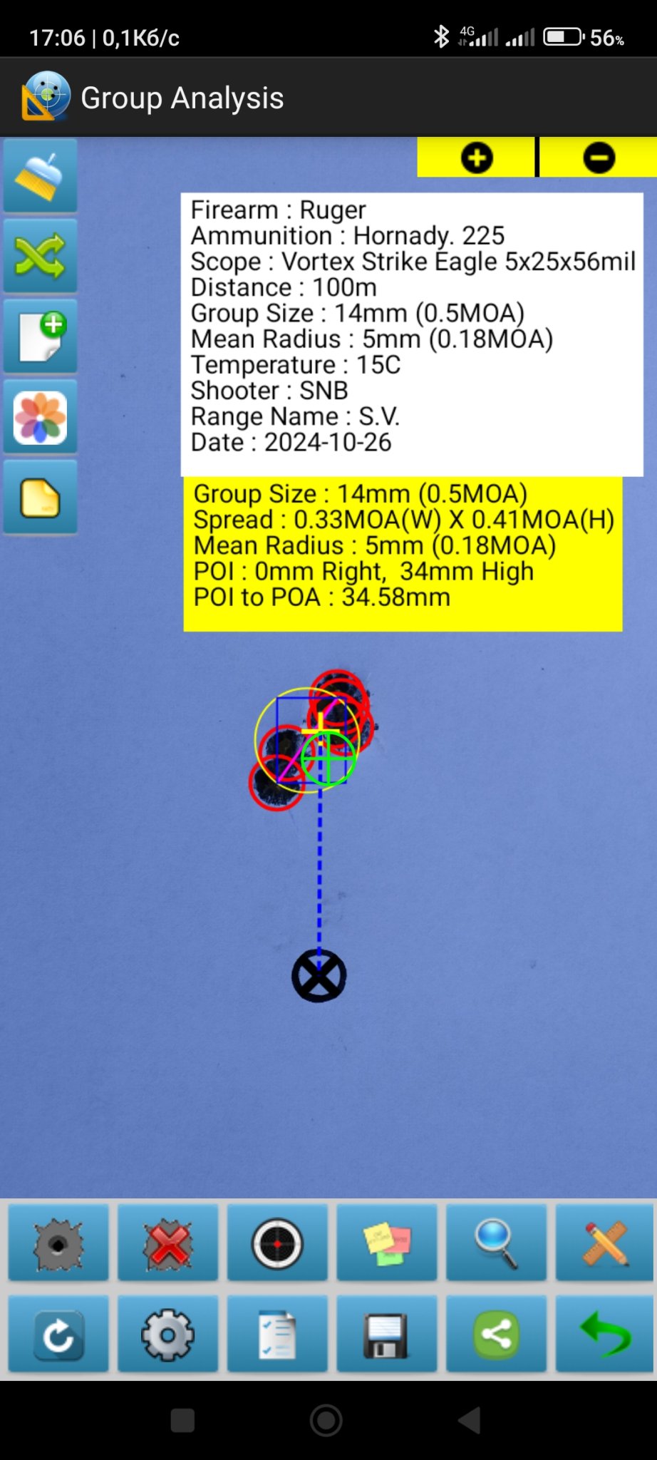

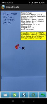

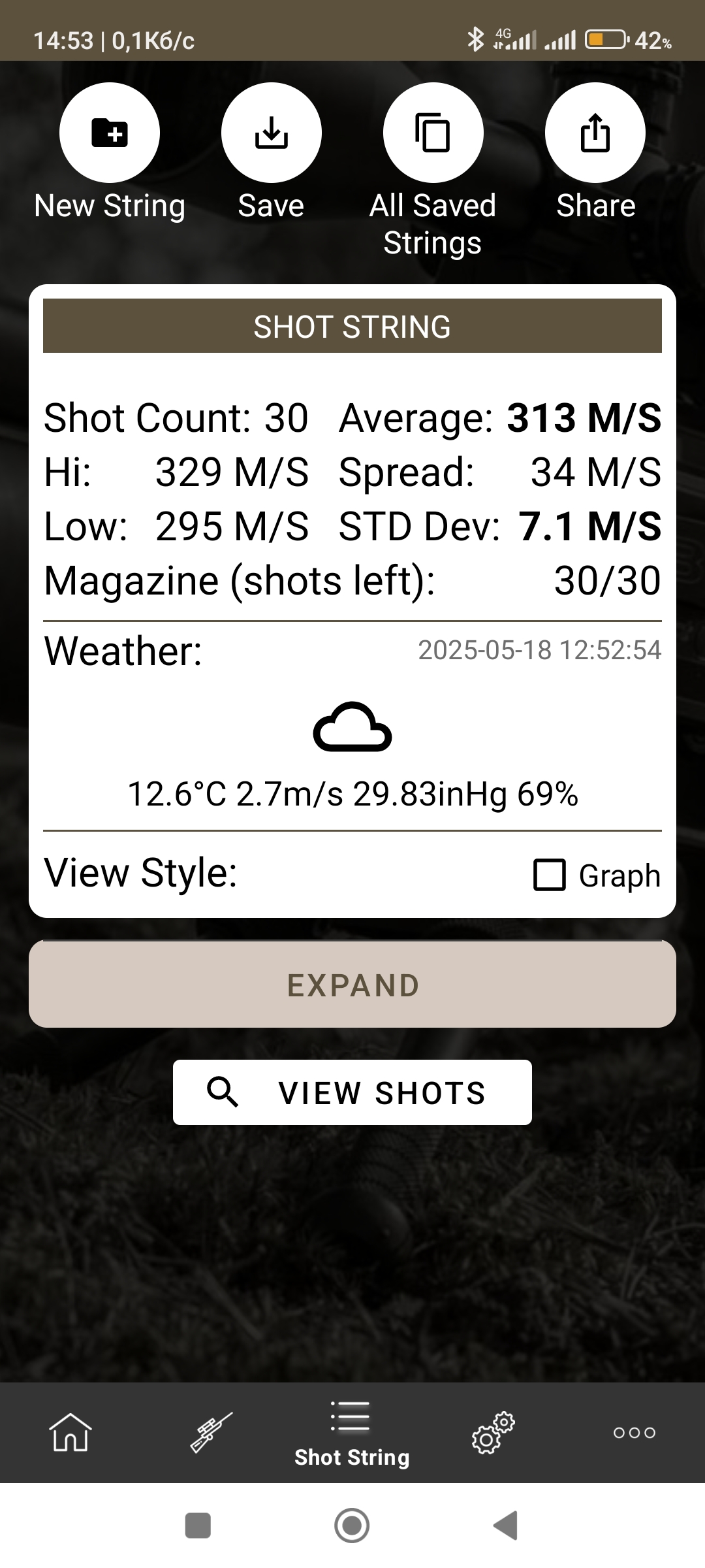

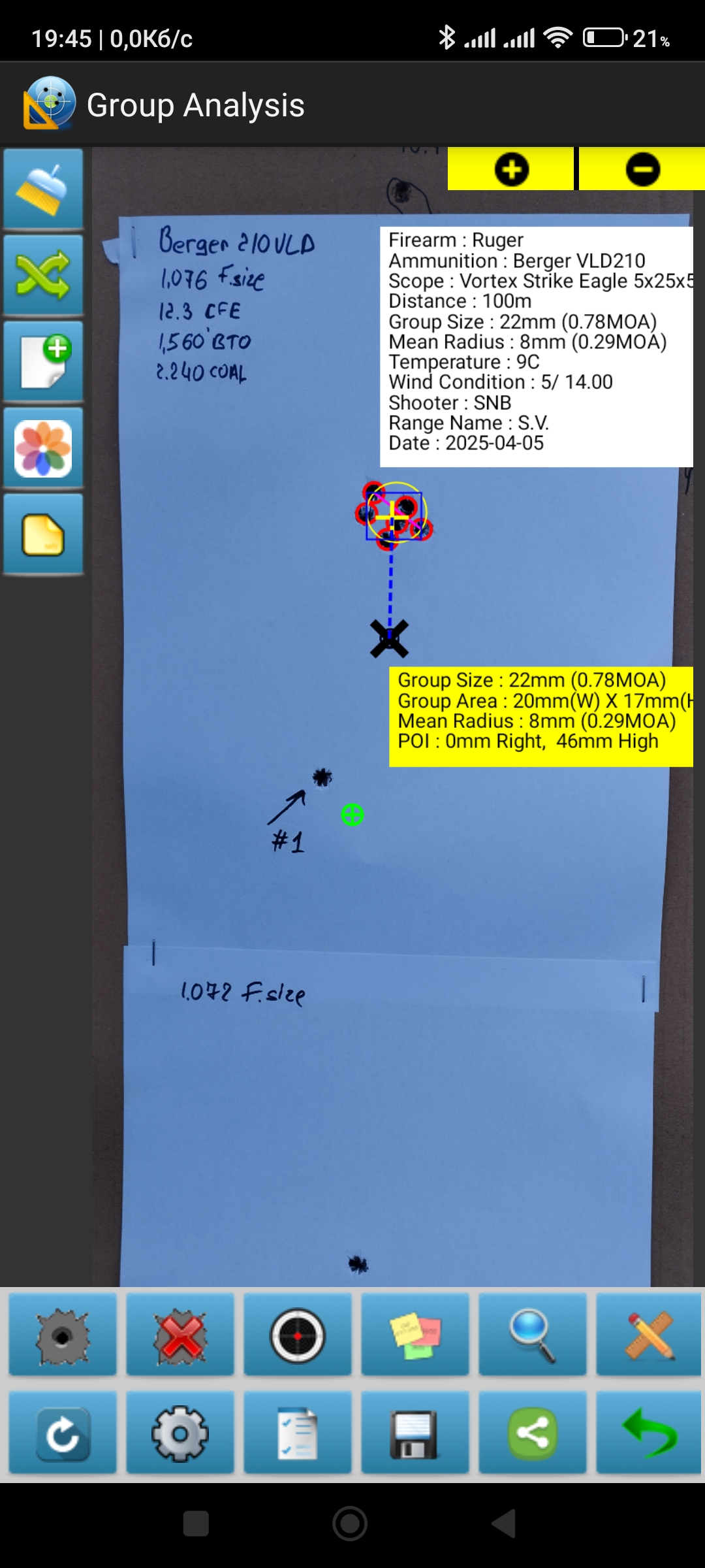

RARR .300 BLK
Indian Creek Design chassis
Hornady 225 ELDM
BTO 1.490 " .100" jamp because of AR style mag.

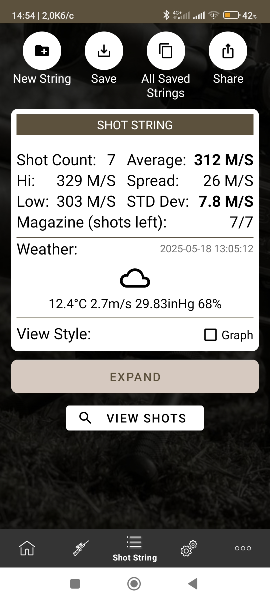

10.9gn CFE BLK
AV 337 ms 13 °C
100м.
This is one of the best group
The average of this particular charge is about 1 moa (100m)

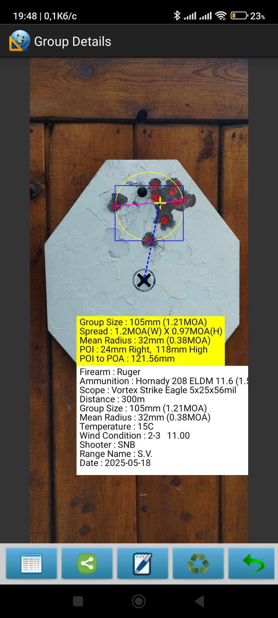

300m. 3 °C
BTO 1.490"

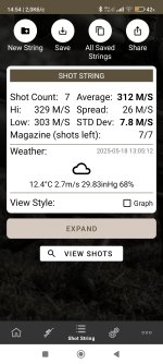

10.8 gn
AV 314 ms

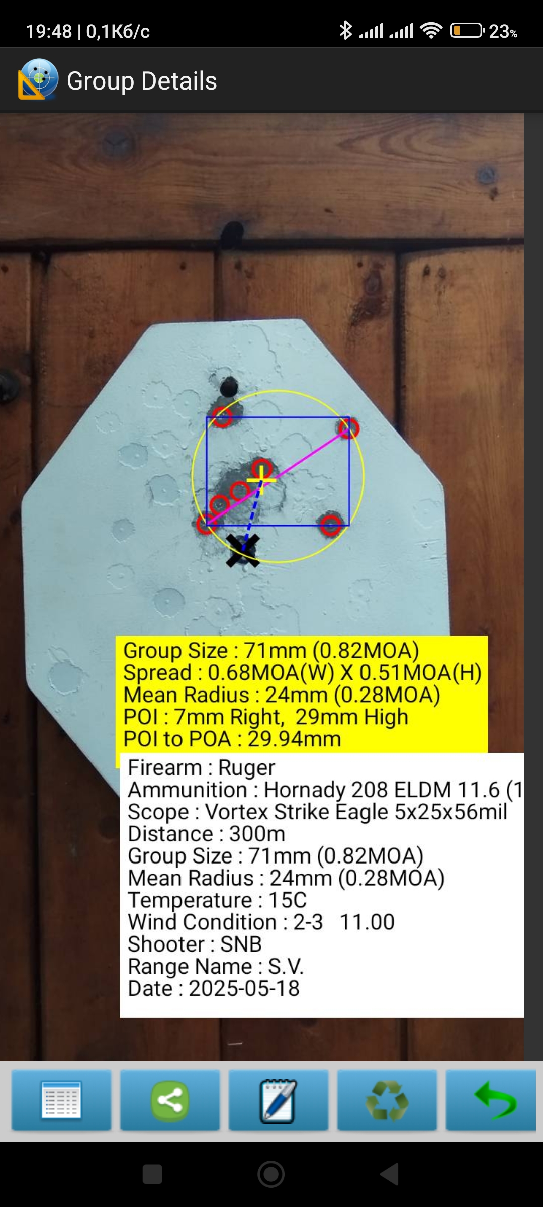

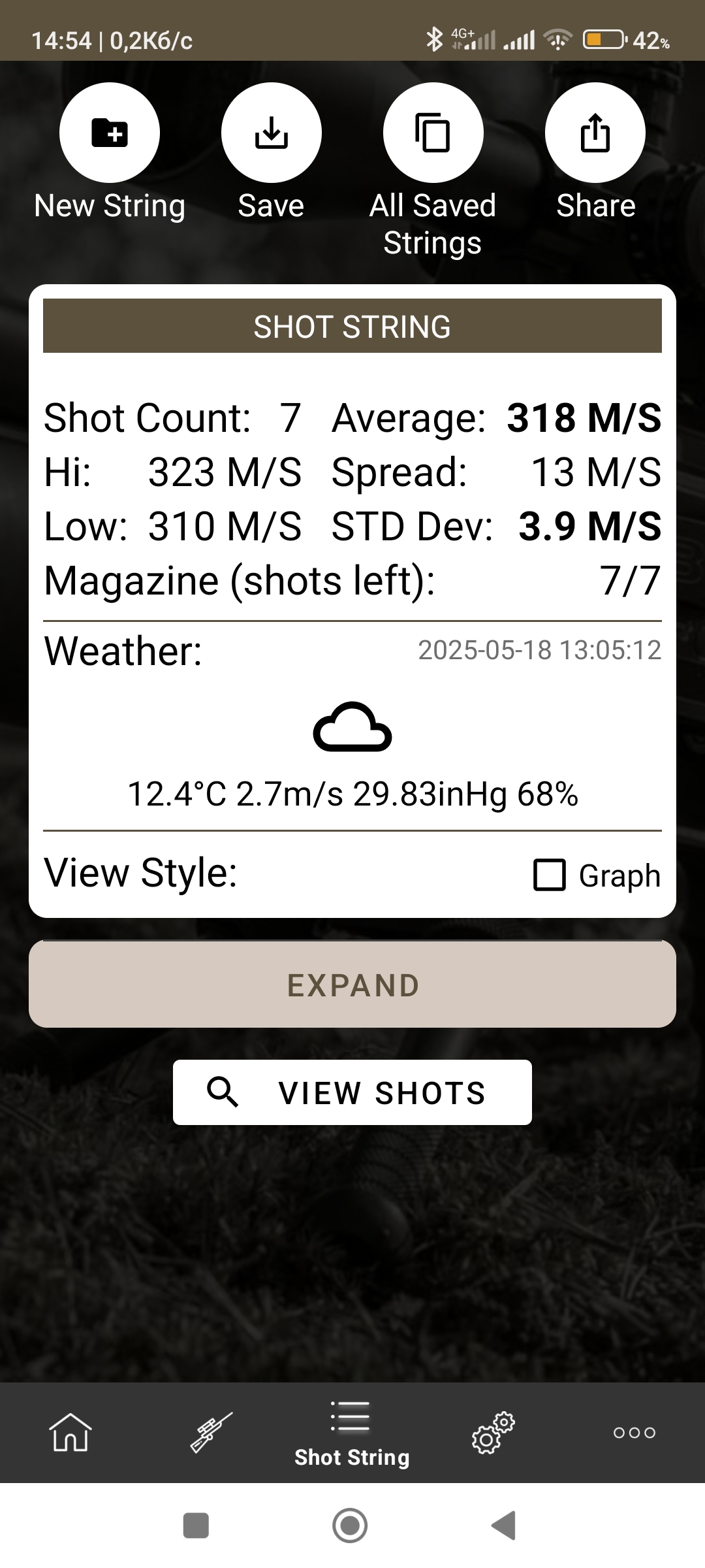

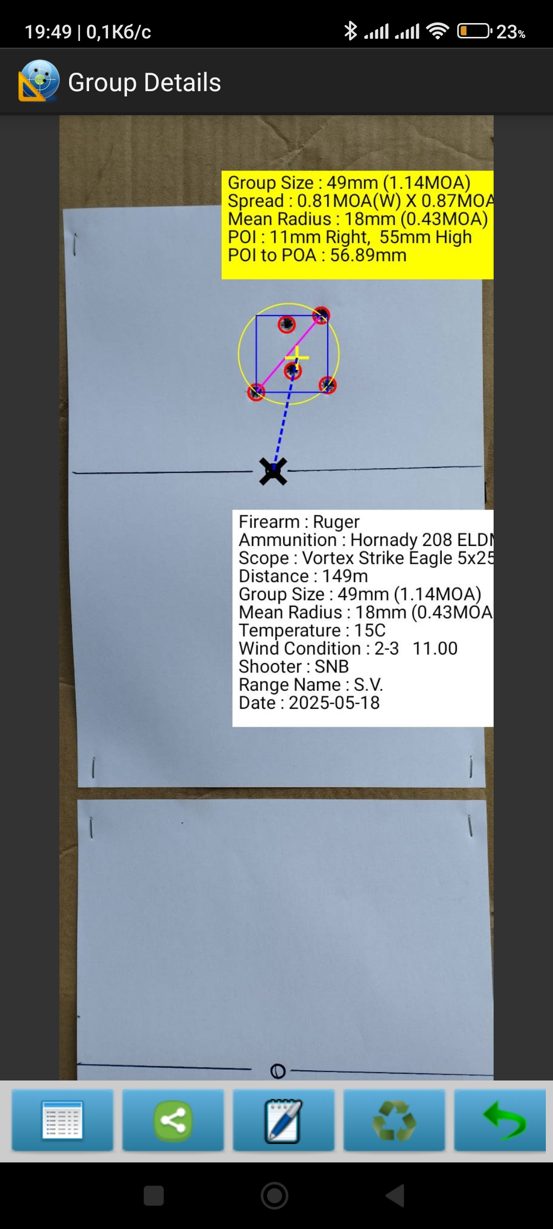

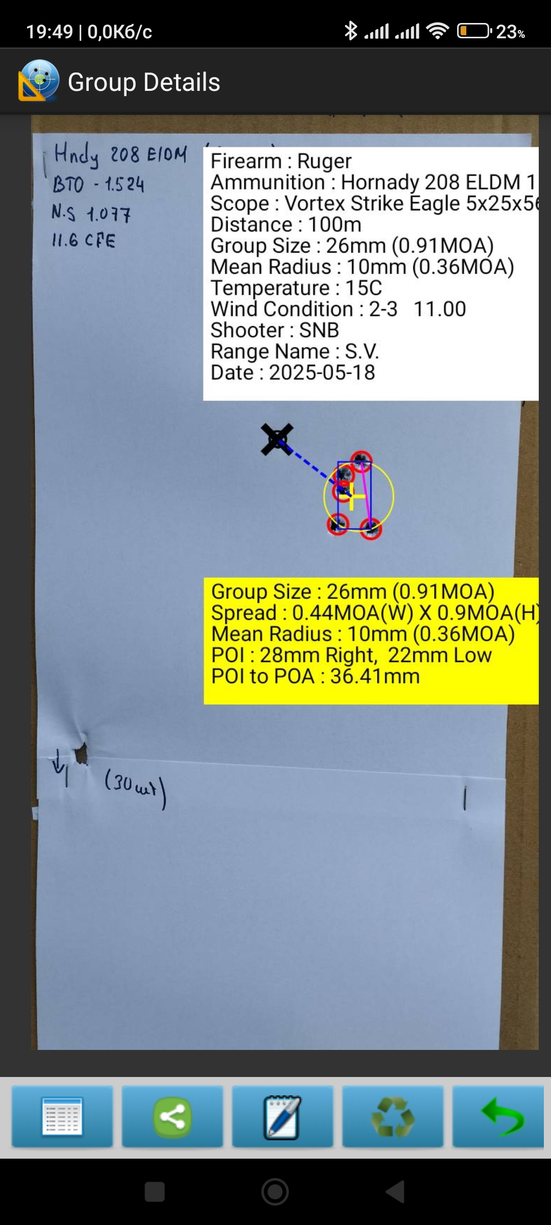

Hornady 208 ELDM
BTO 1.587"
Looks like CFE BLK likes compressed load.

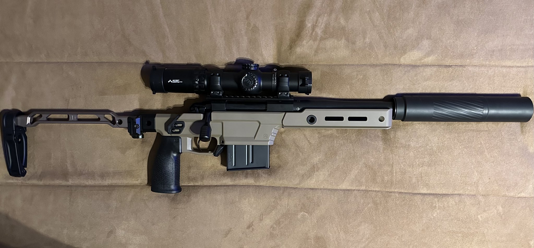

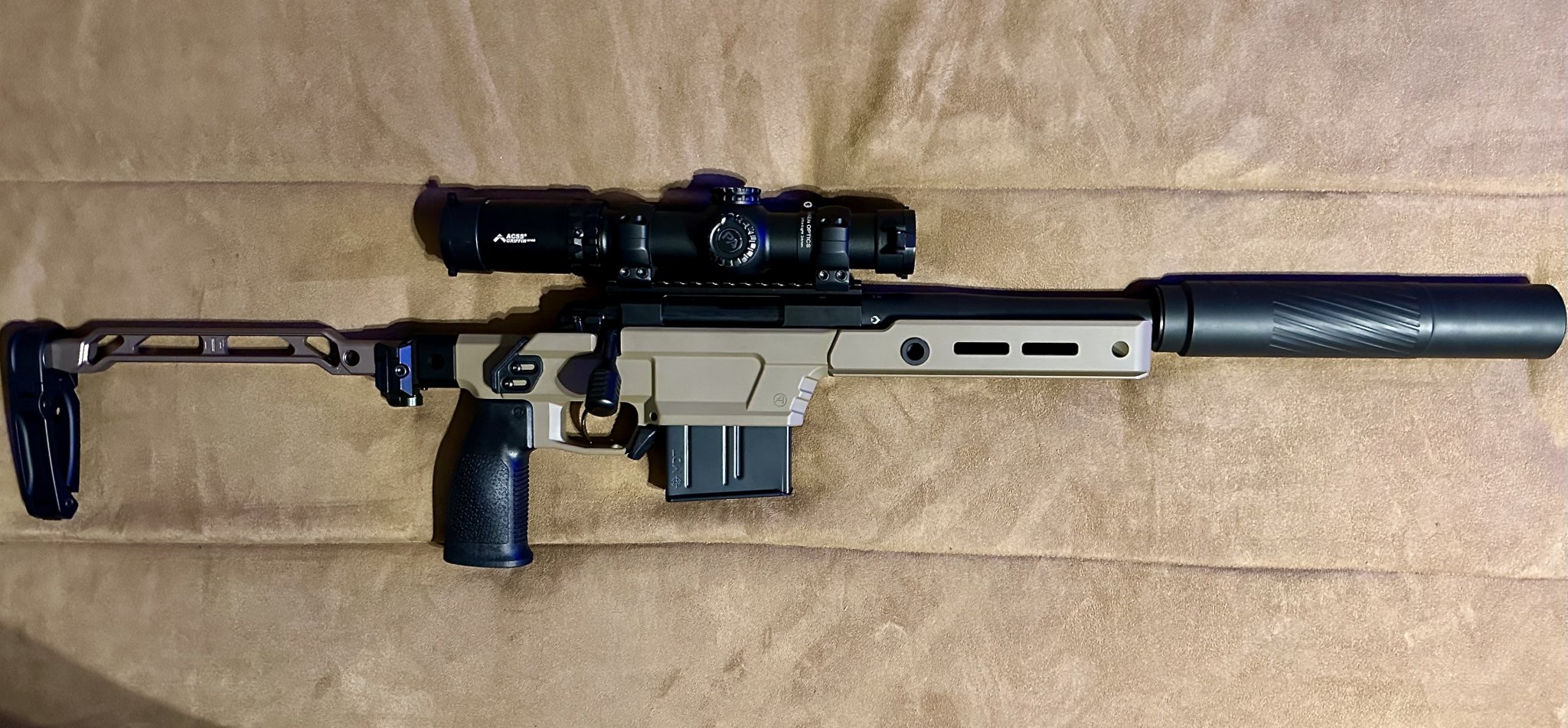

My new Aero Solus 8.3" .300 BLK pistol arrived yesterday! Been waiting on this thing for almost 7 months. It's not completely in it's "final form", as I wasn't expecting it to ship so soon, so I'm still waiting on the grip and a few other odd-n-end things, but I did already have the MDT .223 mags on-hand from another build that wouldn't cycle with the mags, and this one cycles perfectly with them, so that works out. I had already ordered the JMac Customs AB-9R w/ 1913 folding mech, and the Gearhead Works brace. I pulled the PA SLx 1-10x28 34mm LPVO off my Ruger American Ranch .300 BLK, so I can get it ready to sell. I swapped in the new TriggerTech Special and pulled the screw out (puts it right at 1 lbs.). Greased the action with some Aeroshell 33/64, and got it running slick. Retorqued the action back into the chassis. And then checked alignment with both my Magnus-S (7" can), and Magnus (9" can) just to make sure it's 100%...And it is. So, here's some sneak-peak looks... Haven't shot it yet, but will on Thursday when the range opens back up.
TBAC Magnus-S (7" can)
TBAC Magnus (9" can)

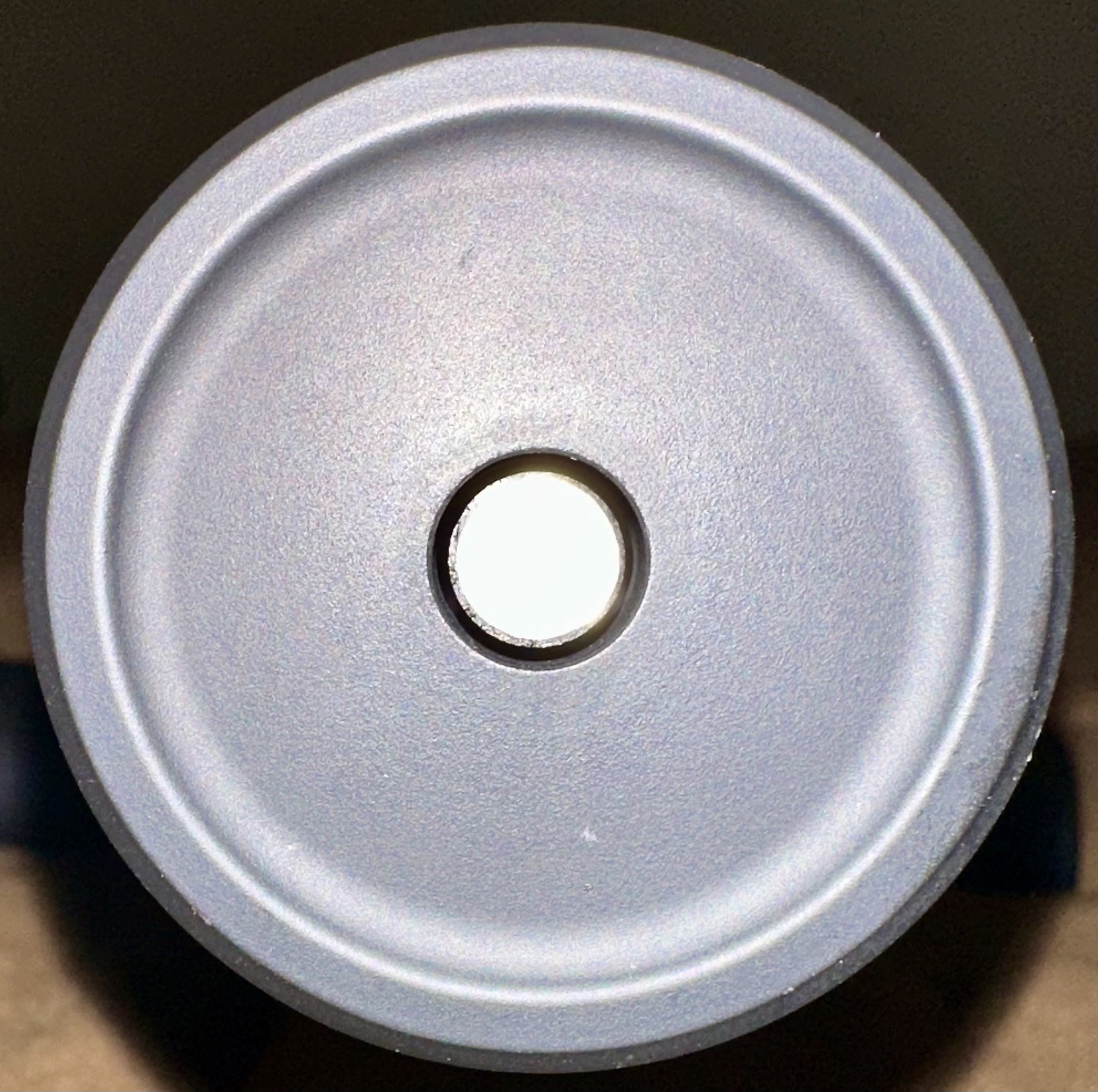

Magnus (9") barrel thread alignment with the can... Near as perfect as possible....My phone was just slightly off-center.

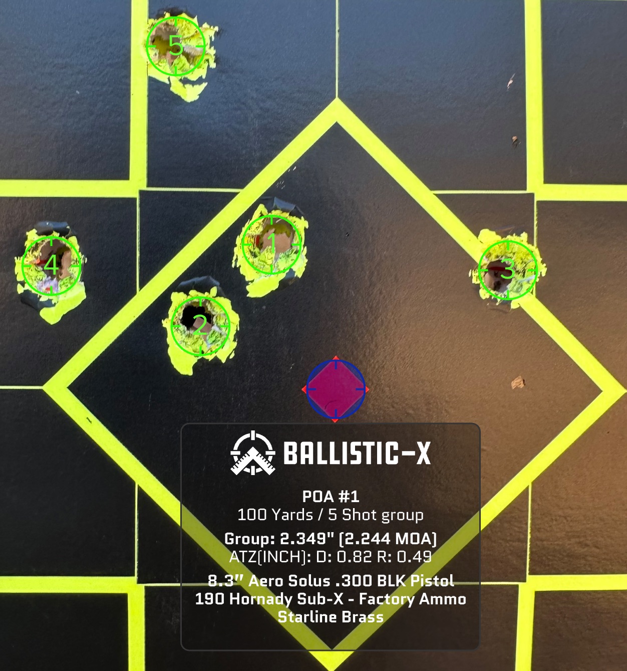

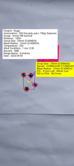

Got her sighted-in, and did some groups with some slightly underpowered loads (about 993 FPS), and also with some factory Hornady Sub-X 190gr ammo (about 990 FPS).
I have some Hornady 190 Sub-X bullets that I will be loading up, and pushing closer to the 1075-1085 mark. But that will be down the road a little bit as I have 500 rounds of factory Sub-X to shoot.
Mind you, I have degrading eyesight in my right eye, and this was only a 10x LPVO, and the orange bull in first group is only 1”, and the orange bull in the 2nd group is about 1/2”… So, considering that, I think the groups turned out pretty decent given all the factors. And the fact it’s only a 8.3” barrel with a 7 twist, it’s pretty damn accurate. I’ll try to get some better groups tomorrow or next weekend with my precision subsonic handloads with Nosler 210 RDF’s being pushed closer to proper 1075-1085 FPS.
The groups are solid for subs, but I think I can get better out of it, as I had no problem running a quick dope chart and taking it straight to 300 yards. And 4/5 shots I’m hitting a full-size D28 at 300 yards, so it’s still pretty dangerous at distance. At 100-150 yards, if it was a deer, and I shot it in the vitals, it would be dead.
It shoots good, it runs smooth, no feeding hiccups with the MDT mags, and it’s ridiculously quiet with the full-size Magnus on there.

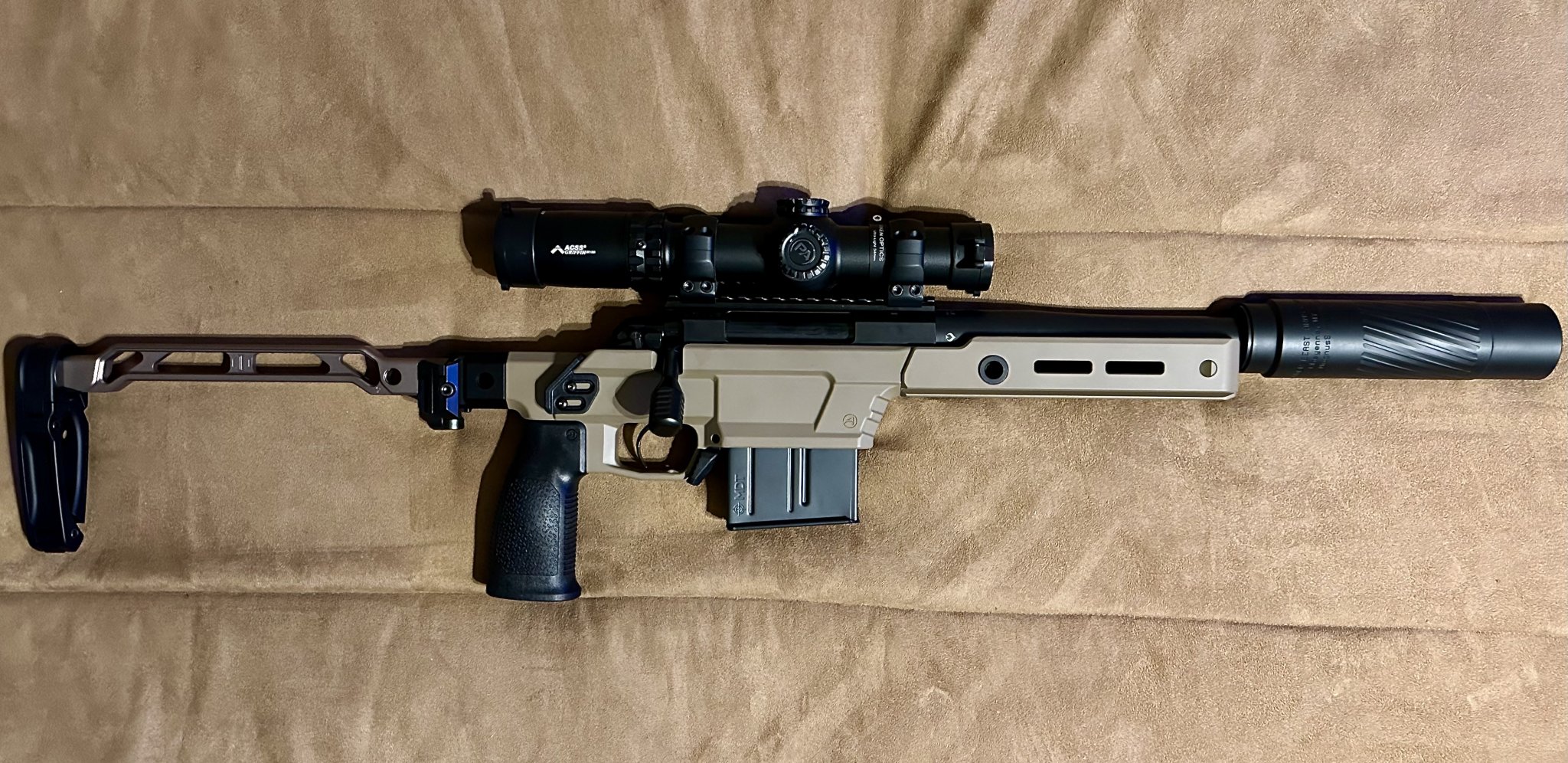

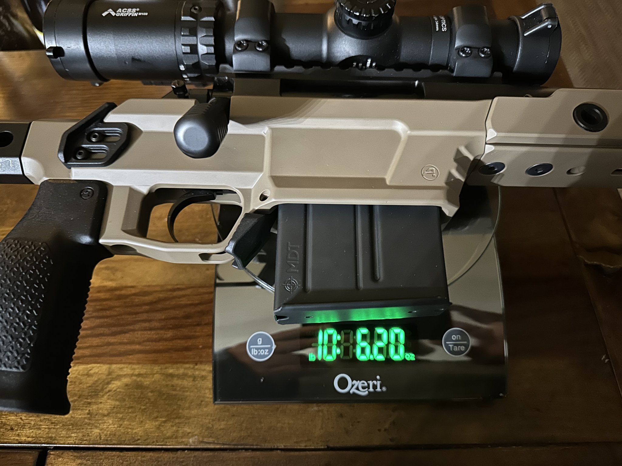

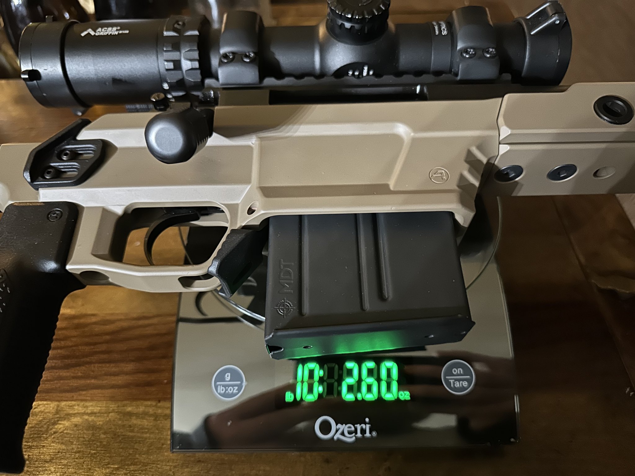

Wow!! That’s crazy heavy for such a small rig!!
Love the look, bet it’s fun to shoot, too!
Would be nice and maneuverable in the deer stand.
Thanks for weighing it, much appreciated!!
Reactions: FuhQ
It’s hefty, but it handles nicely (insert “that’s what she said” joke). 😂 The maneuverability will be nice. For short range (0-150 yards) treestand hunting it will be nice.
The barrel is also a pretty heavy profile, along with the heavy chassis, and the fairly hefty LPVO setup. But it is definitely fun to shoot. The compactness when folded up is nice, too. Toss a QD sling on it, and it would be nothing to pack into the woods.
Reactions: smoooth1

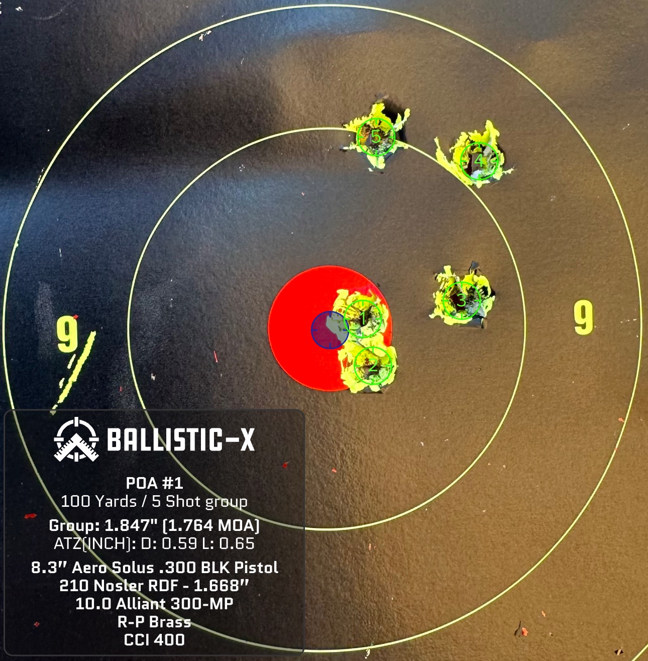

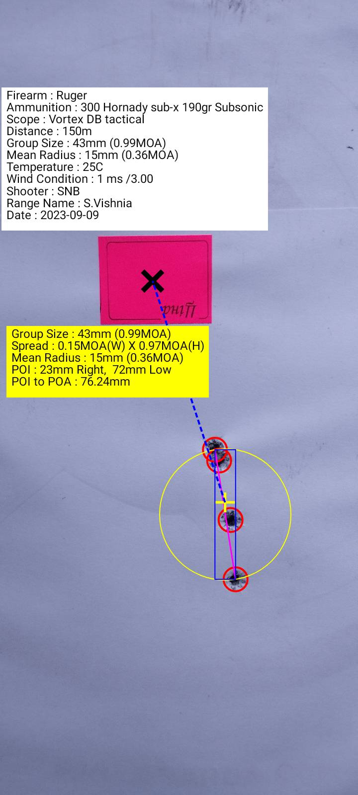

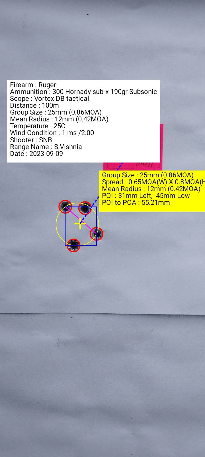

If the weather holds up tomorrow, I'll be testing out some new 190 Sub-X loads with 10.5gr of 300-MP, so hopefully these will be closer to 1050 FPS or so, and group a bit tighter, compared to the 10.0gr load that ended up around 1,000 FPS and were a bit on the loose side of groupings, IMO.
Also, my shipment of 220gr Maker REX bullets showed up, so I'll be working on that, once I nail-down a good hunting load with the 190 Sub-X's.

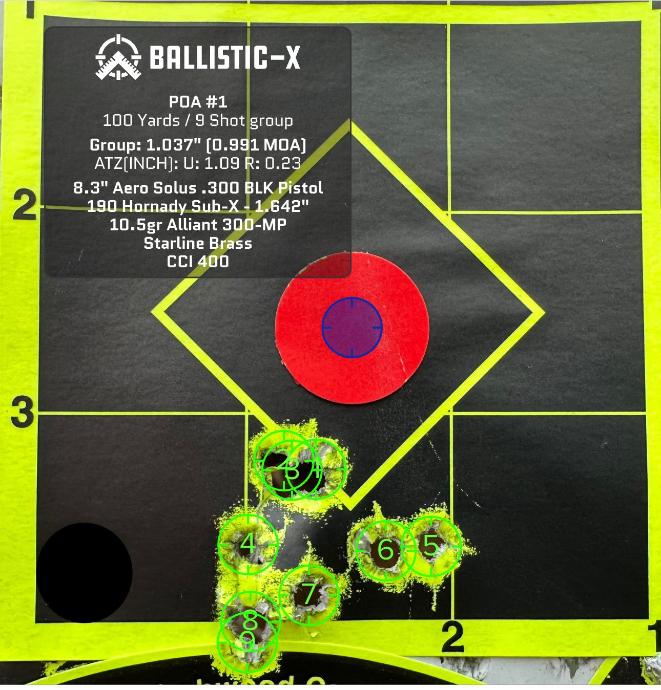

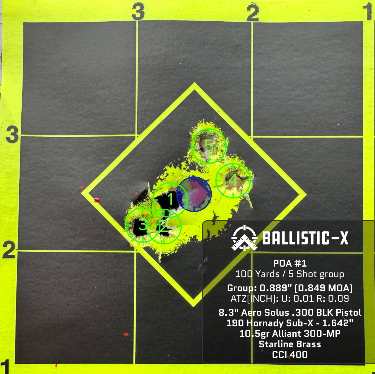

Went and did some load testing on my 8.3” .300 BLK Solus, with the Hornady 190 Sub-X bullets. I used 10.5gr of Alliant 300-MP powder, and it was just a tad too hot, and averaged just over 1100 FPS (about 1105). I'm going to go down about 0.2 grains to be sure it stays subsonic, but hopefully it still shoots this amazing! I’m thoroughly impressed with this little pistol.
Here’s a 9-shot group before I finalized the zero. It was 10 shots, but I made an adjustment after the first shot, so I blacked it out, since it wasn’t part of the same POA group.
Here’s a sub-MOA 5-shot group a little while later after getting it completely zeroed. This thing is ready to smoke some whitetails inside of 150 yards.

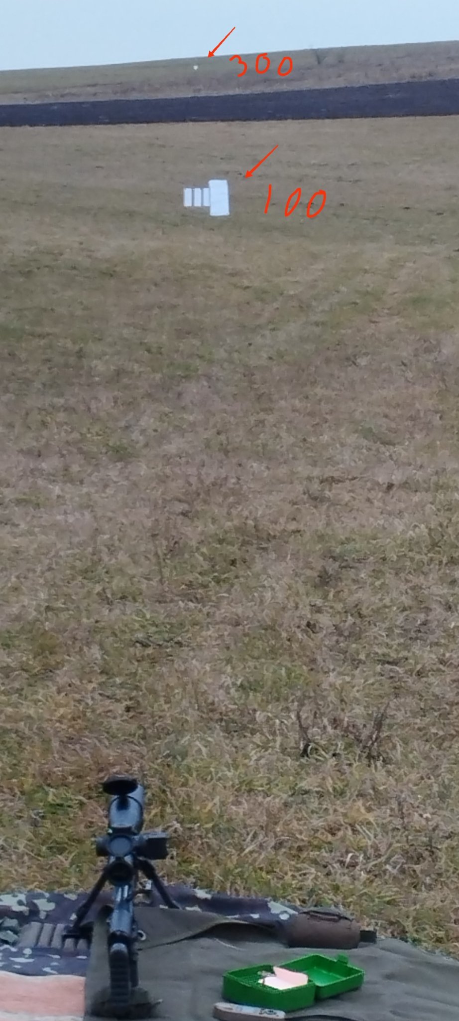

Today was very windy 15-16mph and cold 29.3F.

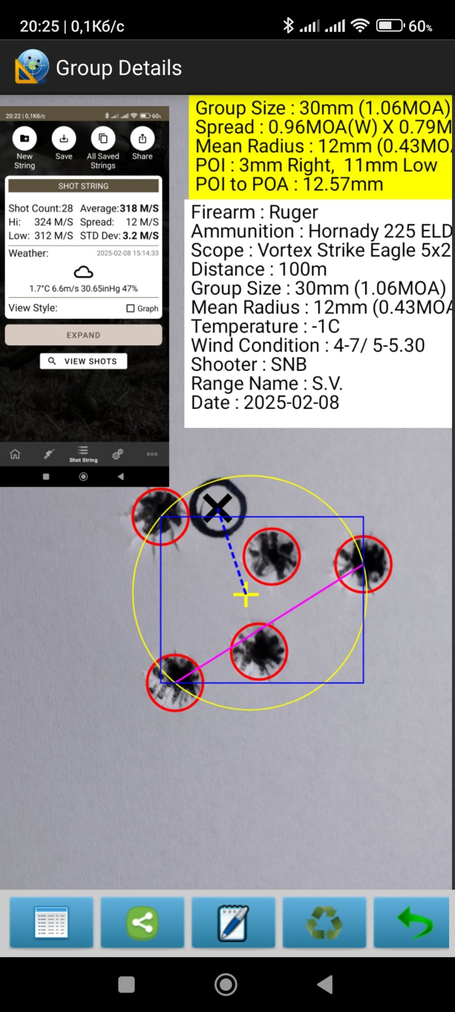

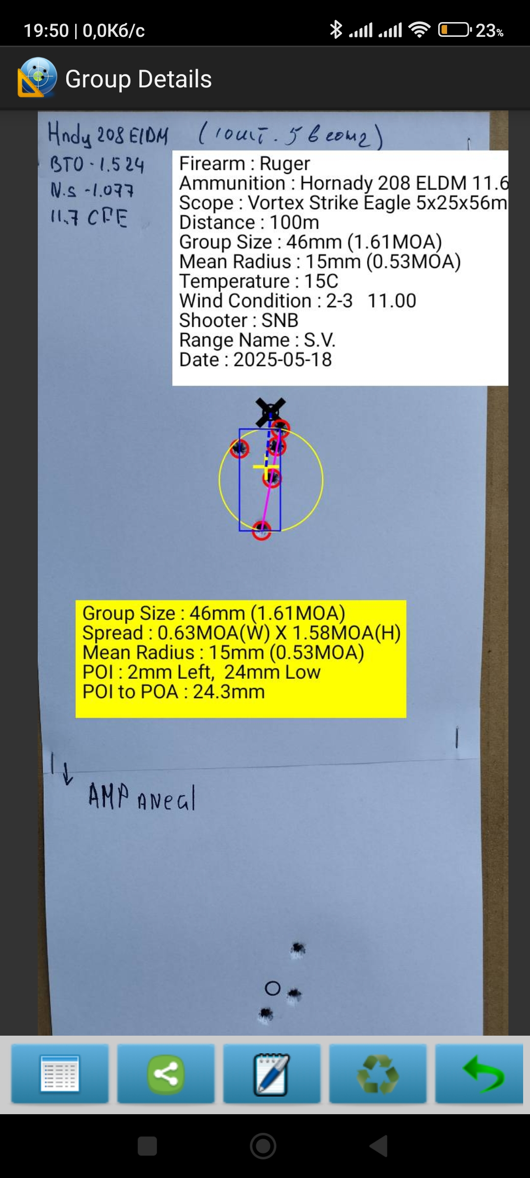

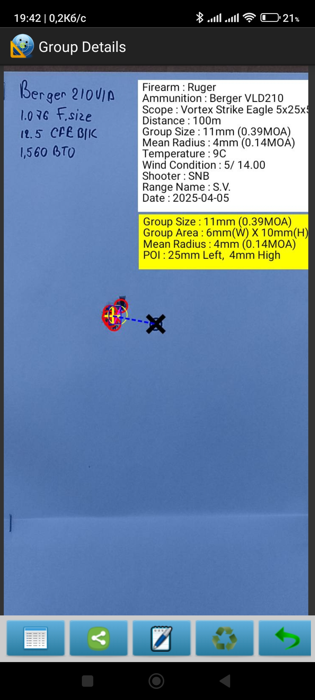

But there was no snow, so I tried again at 100m -300м 225 ELDM.

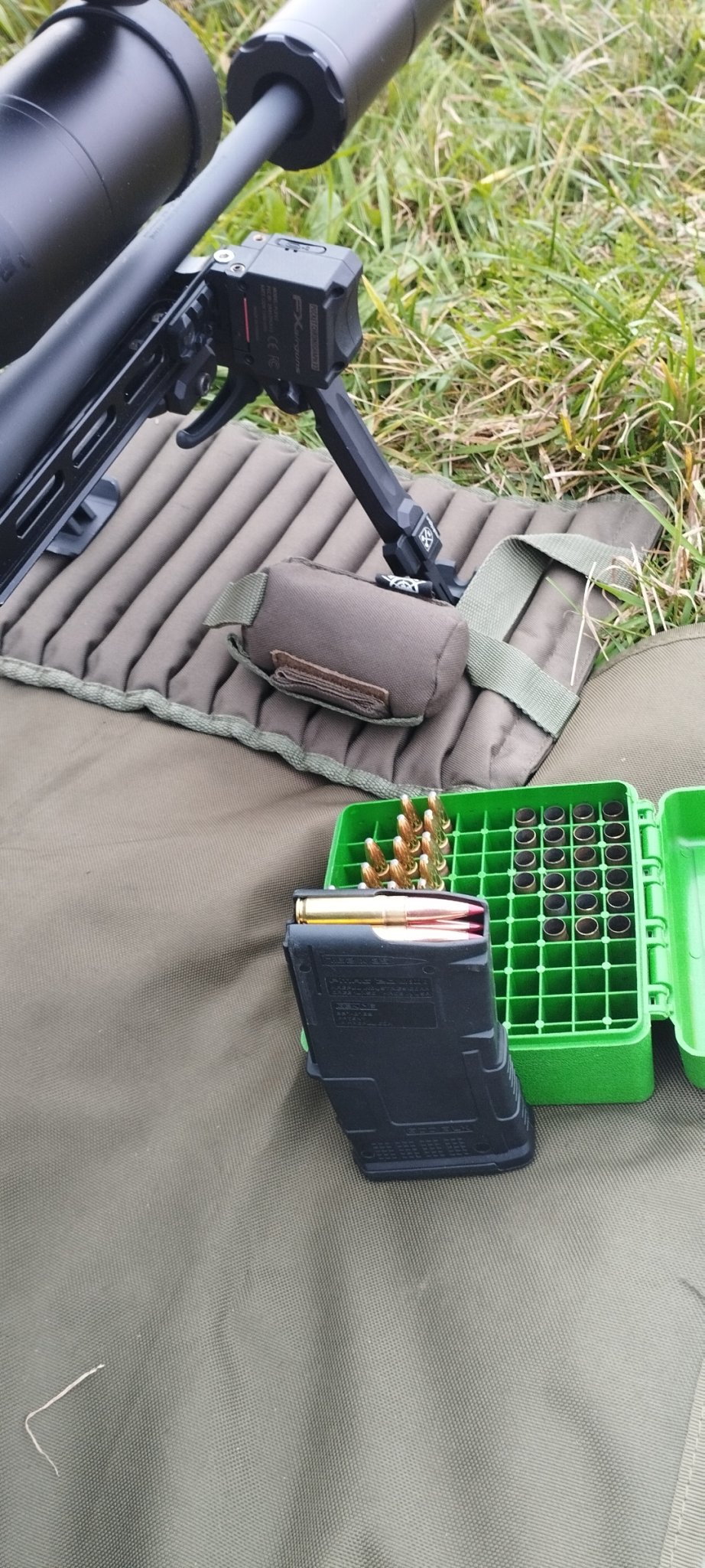

Unfortunately, COL 2,270 at 10.9 CFE BLK(no drop tube) is the maximum AR mag allows.
This circumstance, as well as the fact that jump is already around ,100" doesn't allow me to play with seating depth unlike the 208 ELDM.
This is the best group, the others were 1.5-2.0 MOA.
In general, it is noticeable that thanks to the possibility of fine-tuning the sitting depth It is much easier to achieve acceptable accuracy with the 208 ELDM.I already posted above.
I also shot a 12x17 inch gong at 300m, but I didn't like the result, although almost all the shots hit it.
There was nothing like a group.
In contrast to shooting in more favorable conditions when there was summer weather.

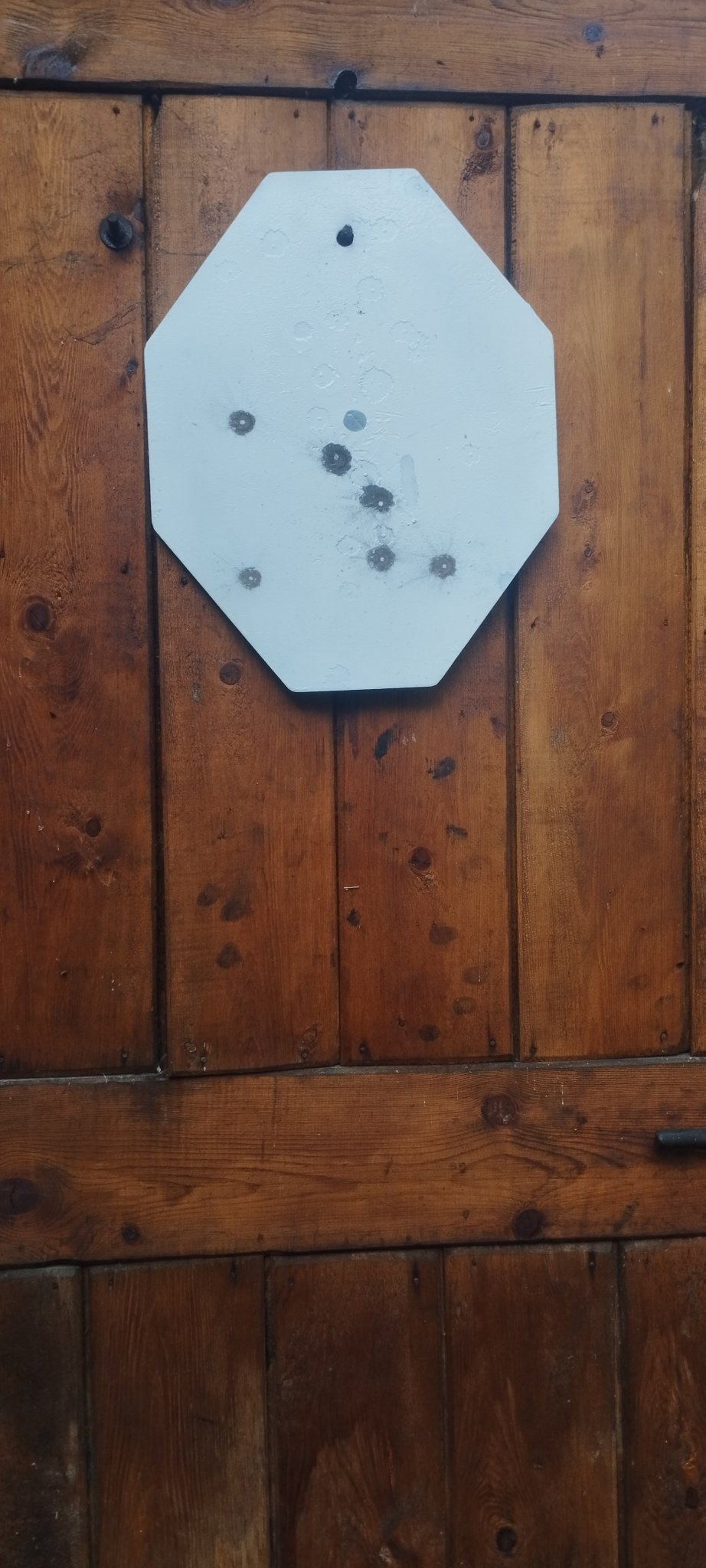

Then the 300m gong looked like this
300 m
without wind
208 ELDM
AV 335 m/s

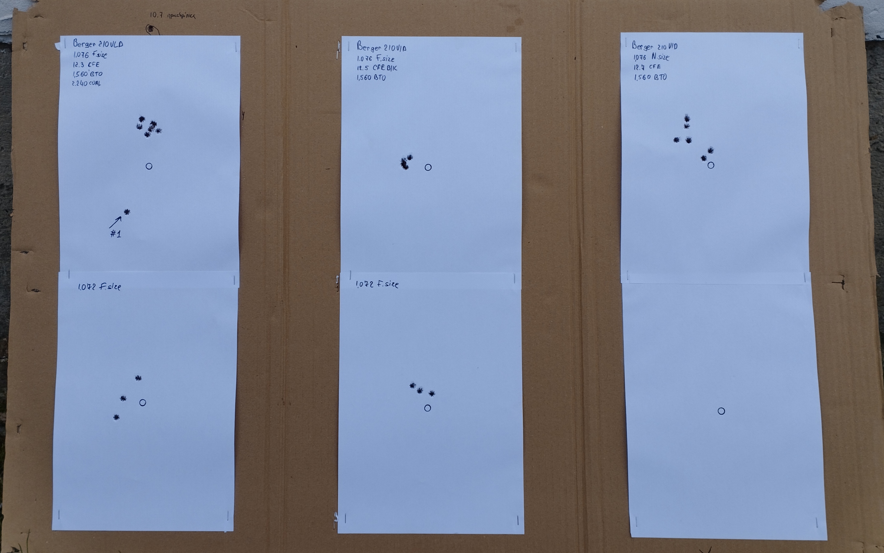

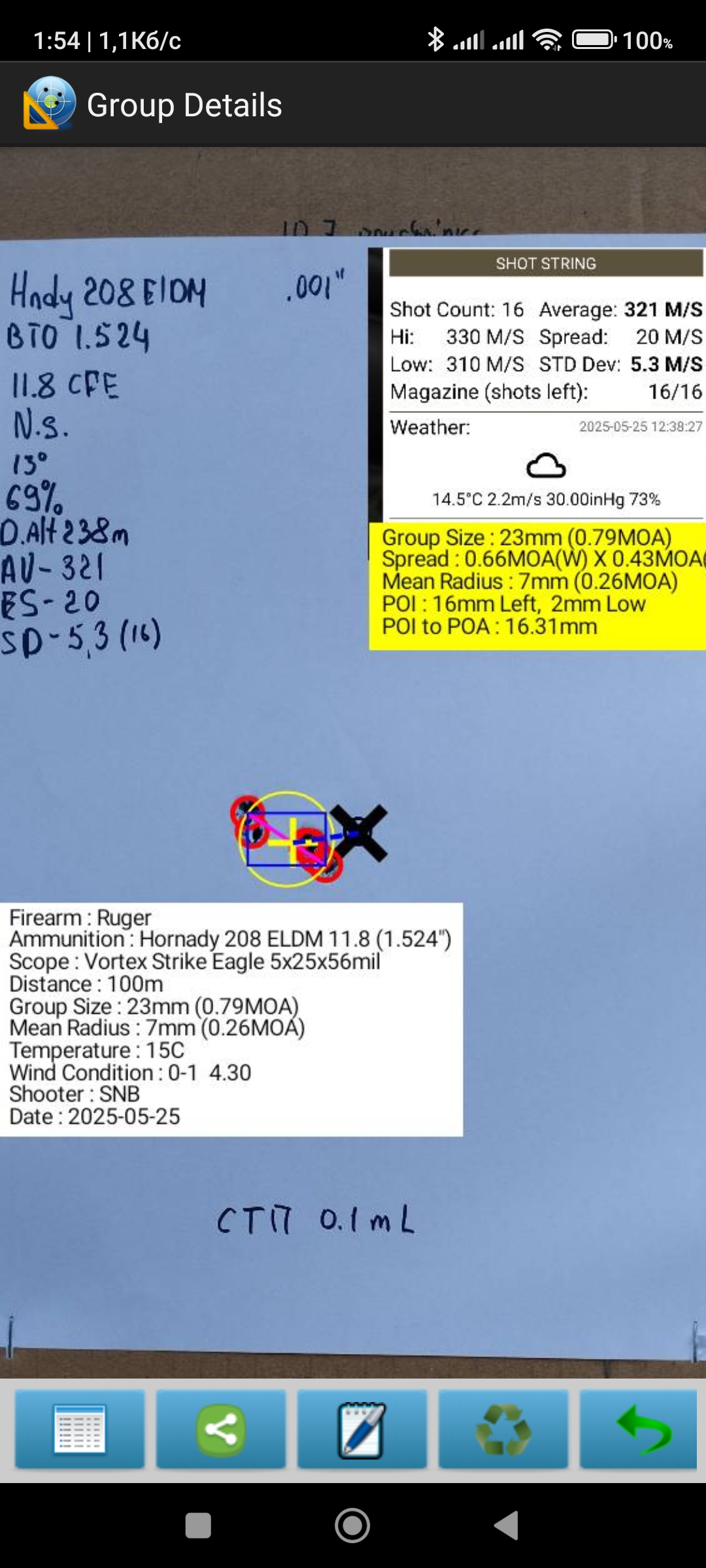

Hornady 208 ELDM seating depth test
