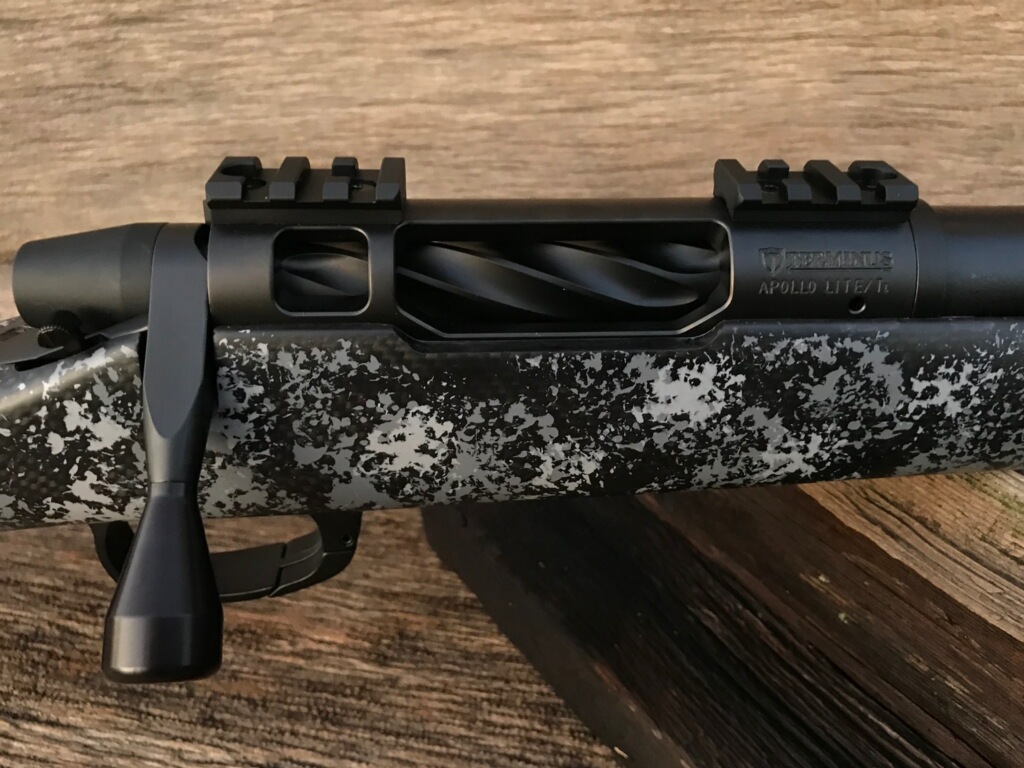

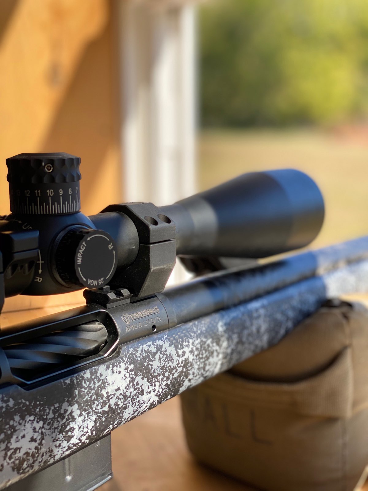

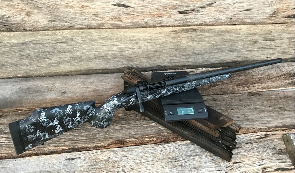

Teaser photos of a lighweight hunting project Joel is working on. 24" 6.5 PRC Apollo Lite/Ti @ 6.5lbs **Posted with Joel's permission**

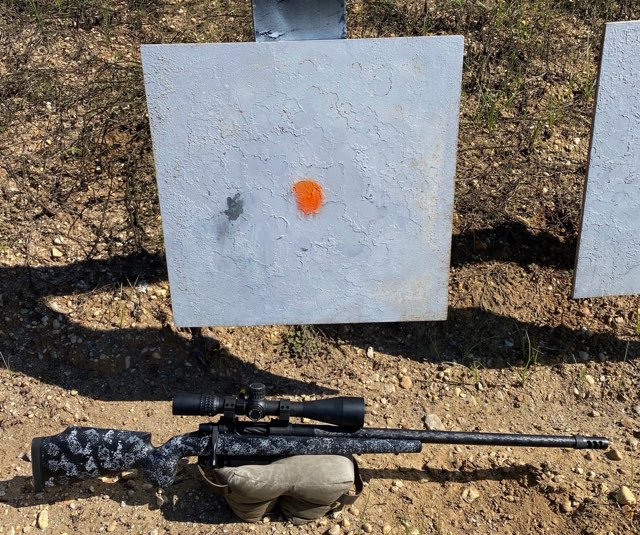

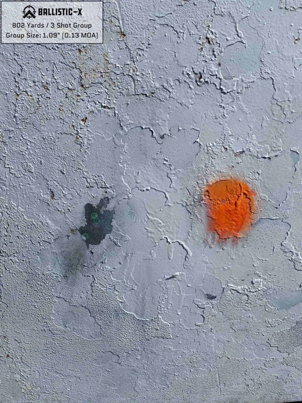

Check out this insane accuracy from Terminus...
Just realized it's almost impossible to see. Here are the actual images...
  • Love
Reactions: Luka and JakeM
Great shooting, but an action has little to do with the precision of a rifle, so I don't think it's fair to credit that to the action...
You are not wrong by what you said, but it can be argued that high tolerances, concentricity, and a solid fire control group play more than a little factor in a bolt action rifle's accuracy. This rifle was also built by Joel Russo, aka Terminus actual, and Joel is a perfectionist, haha. So overall I would say that the quality of an action plays more than a little factor in the overall performance of a rifle.
