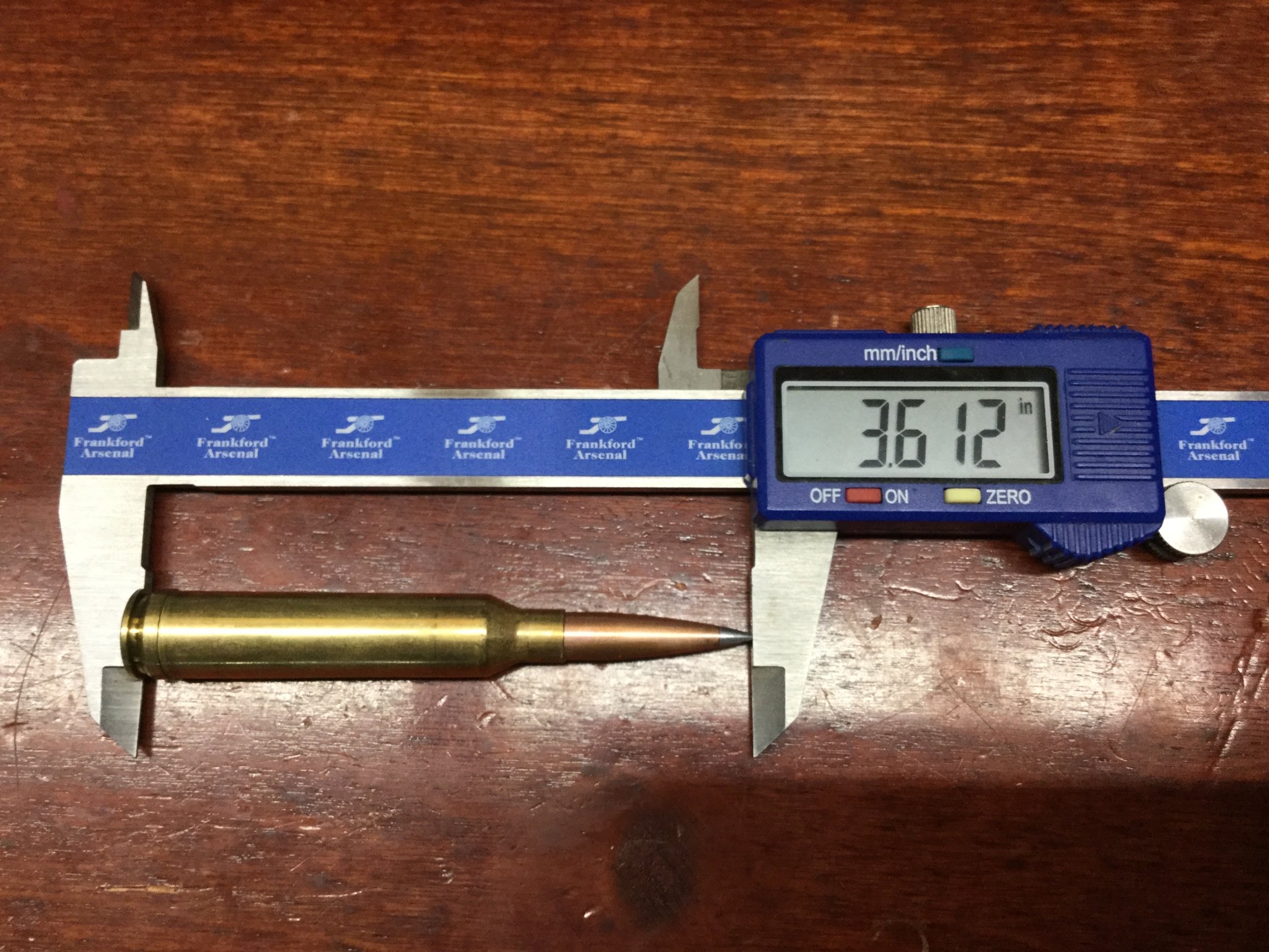

Initially shot them at mag length and now I’m at a single load length and obviously that has an impact so I’m gonna do a short velocity test above my current load.

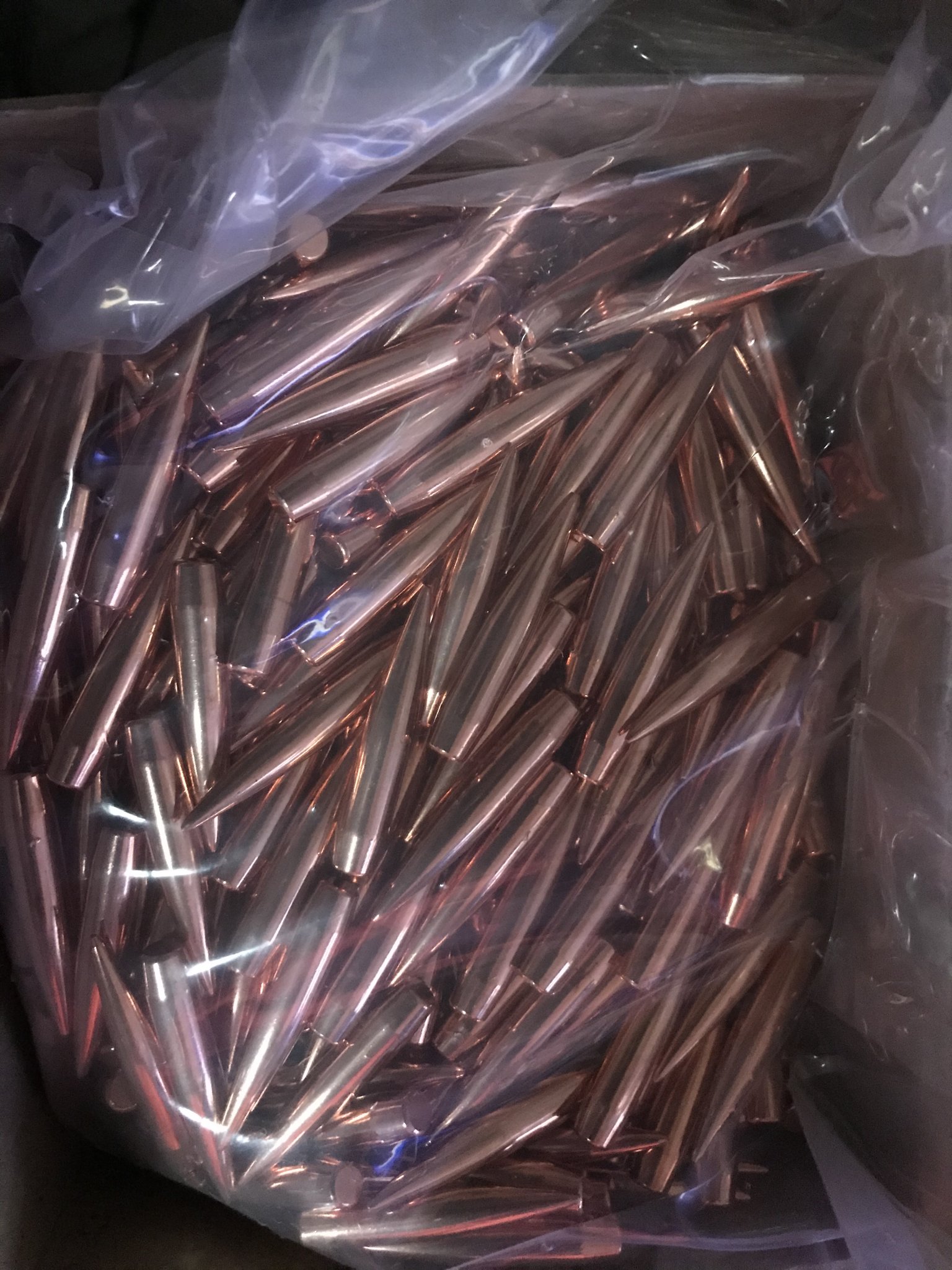

Well I just ordered a big pile of bullets.
In the end I went with the Berger 190’s.
Consistent, a bit cheaper and my current barrel just seems to like them.
The ATip’s BC is better but honestly I’m a bit gun shy locking myself into a Hornandy bullet at the moment.

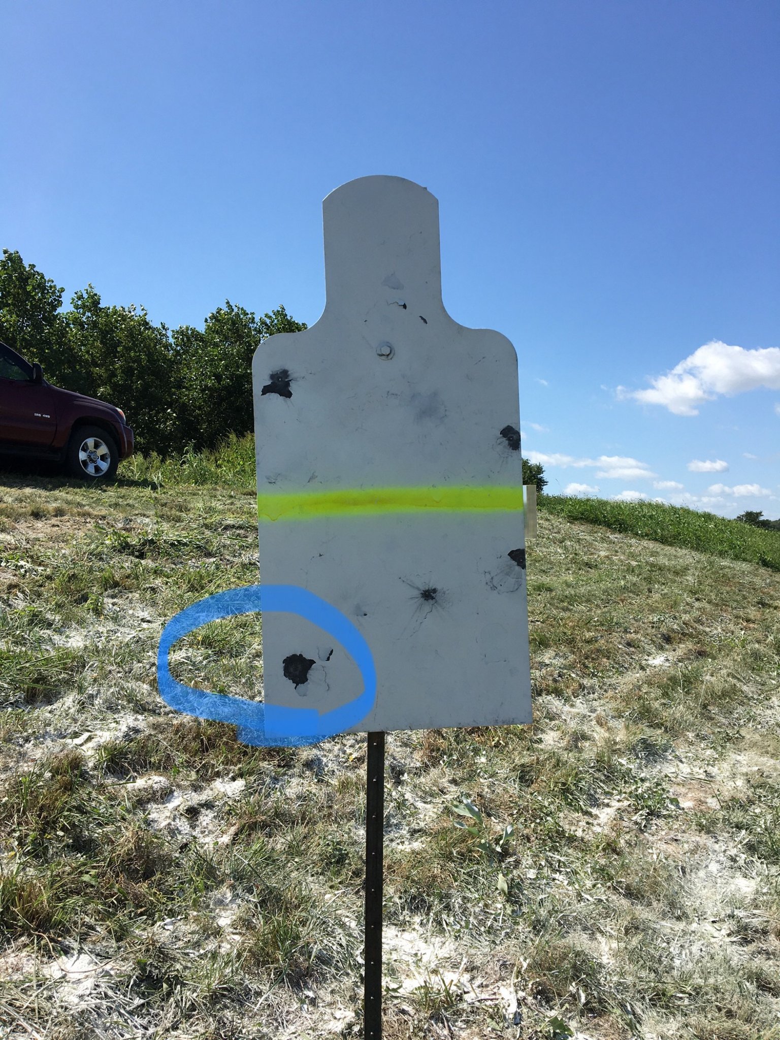

I threw .422 in my Kestrel and was about .2 low which is what about 12.5” at a mile. My cold bore shot was just under the plate came up one tenth and held the same spot and got that impact.
