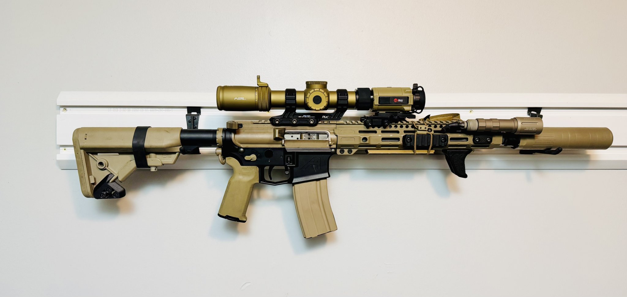

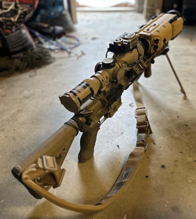

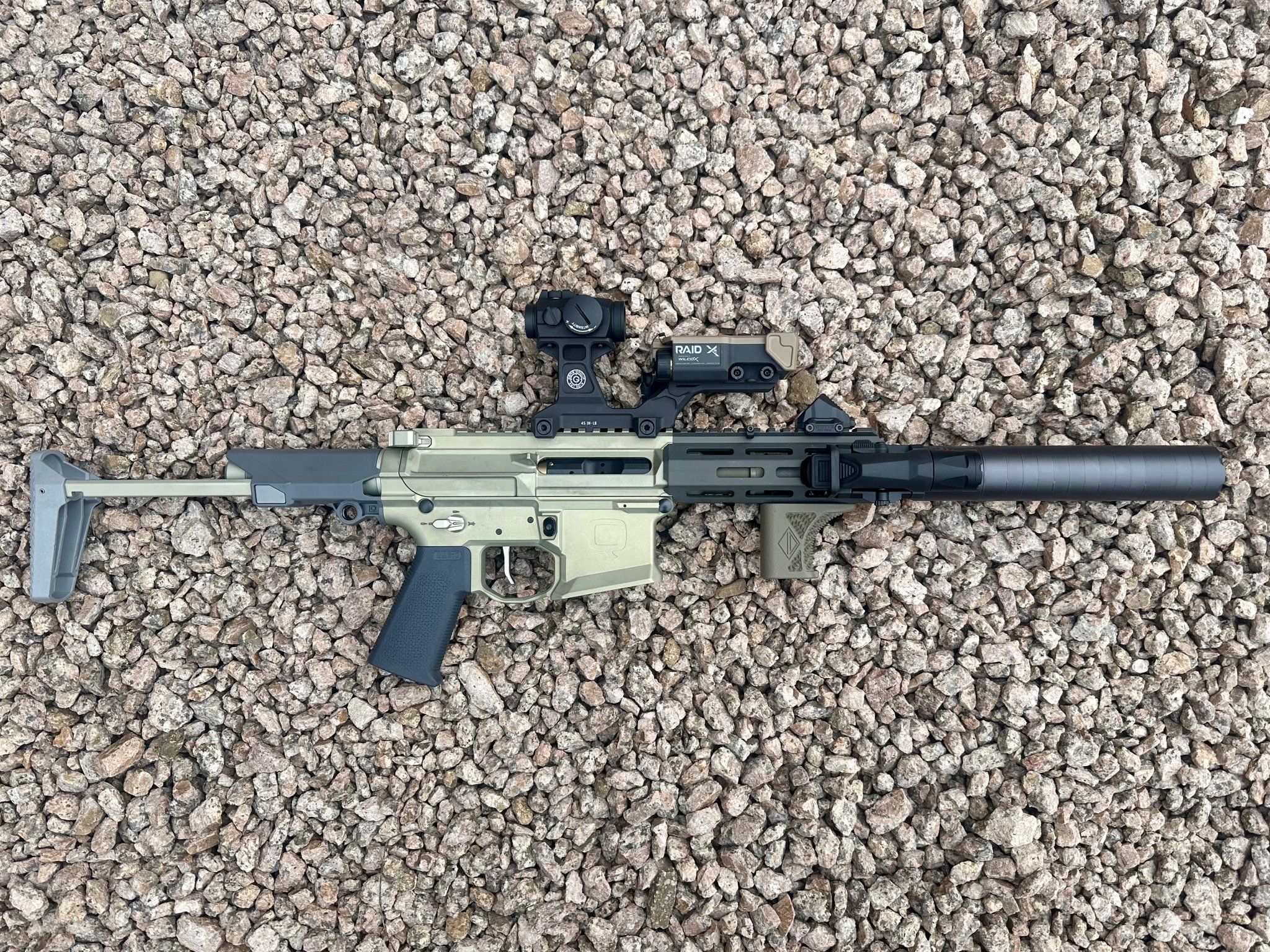

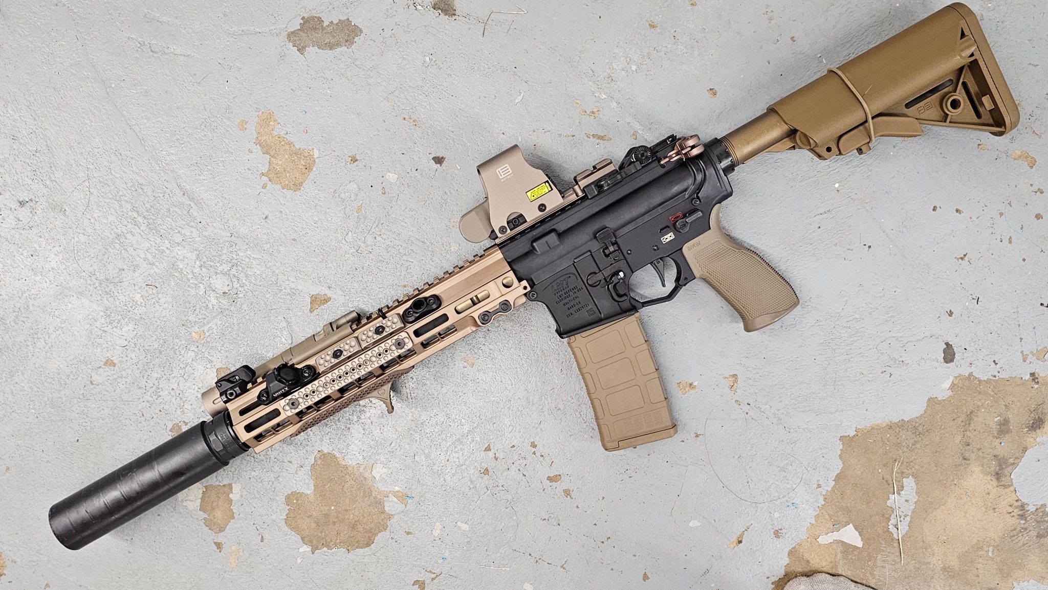

Honey Badger SD (Honey Badger SD specific silencer) but with a 6” rail installed instead of the 12”. Set up for primarily low light. The 12” doesn’t really do much and you need a rail cover as it gets very hot from silencer underneath. The 6” also allows for silencer to be removed while also shortening the stowed rifle for backpack or similar storage/transport.
GBRS Hydra 2.0
Aimpoint T2 micro
Wilcox Raid xe FP
Unity Axon switch for laser
Inforce light
Irregular Defense angled grip
Under 6.5lbs as it sits before ammo weight

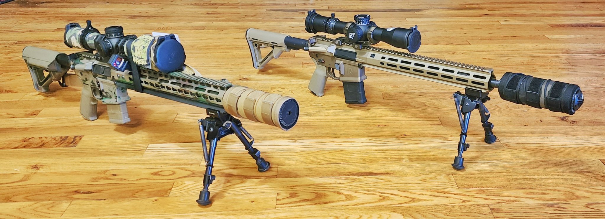

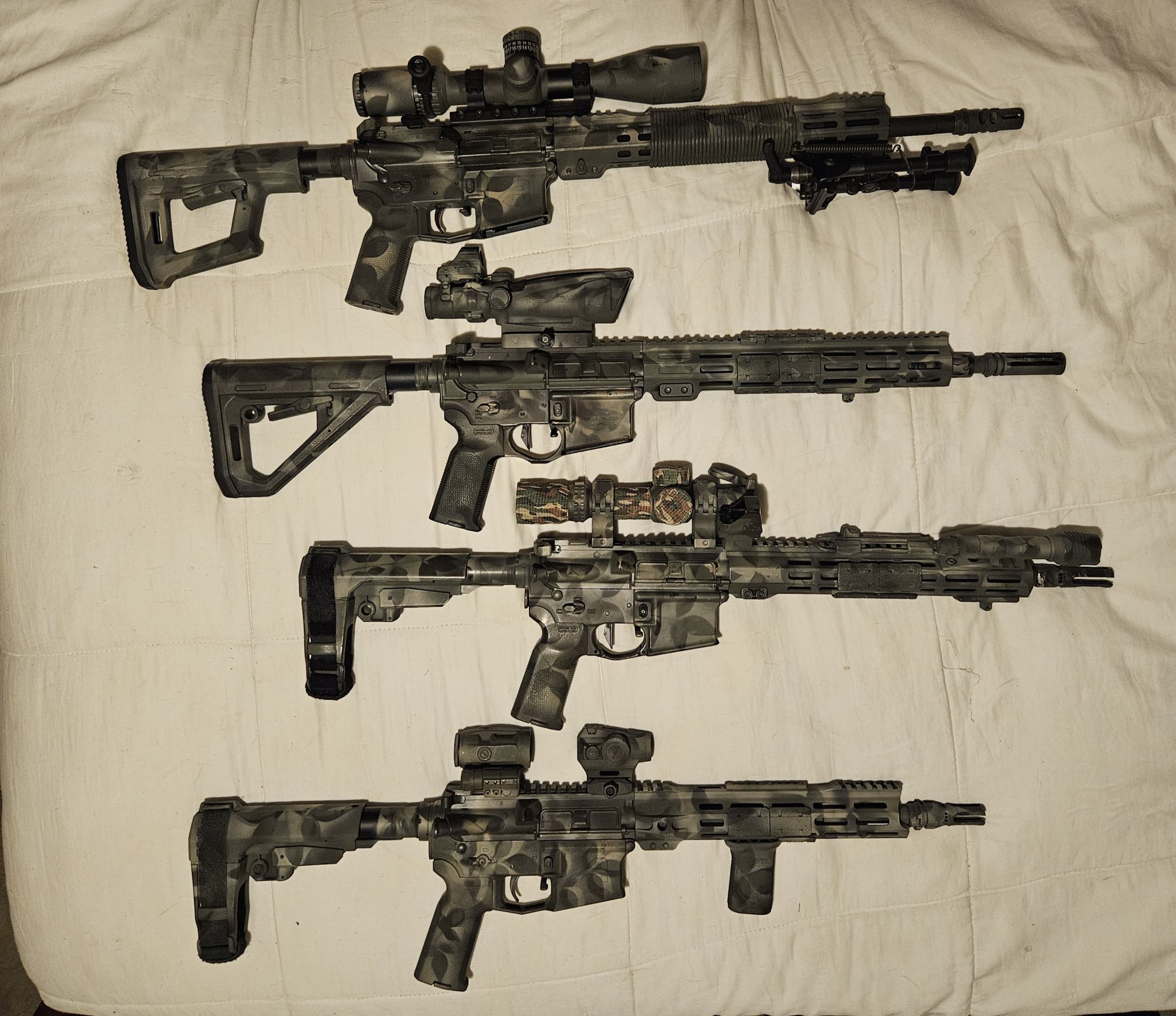

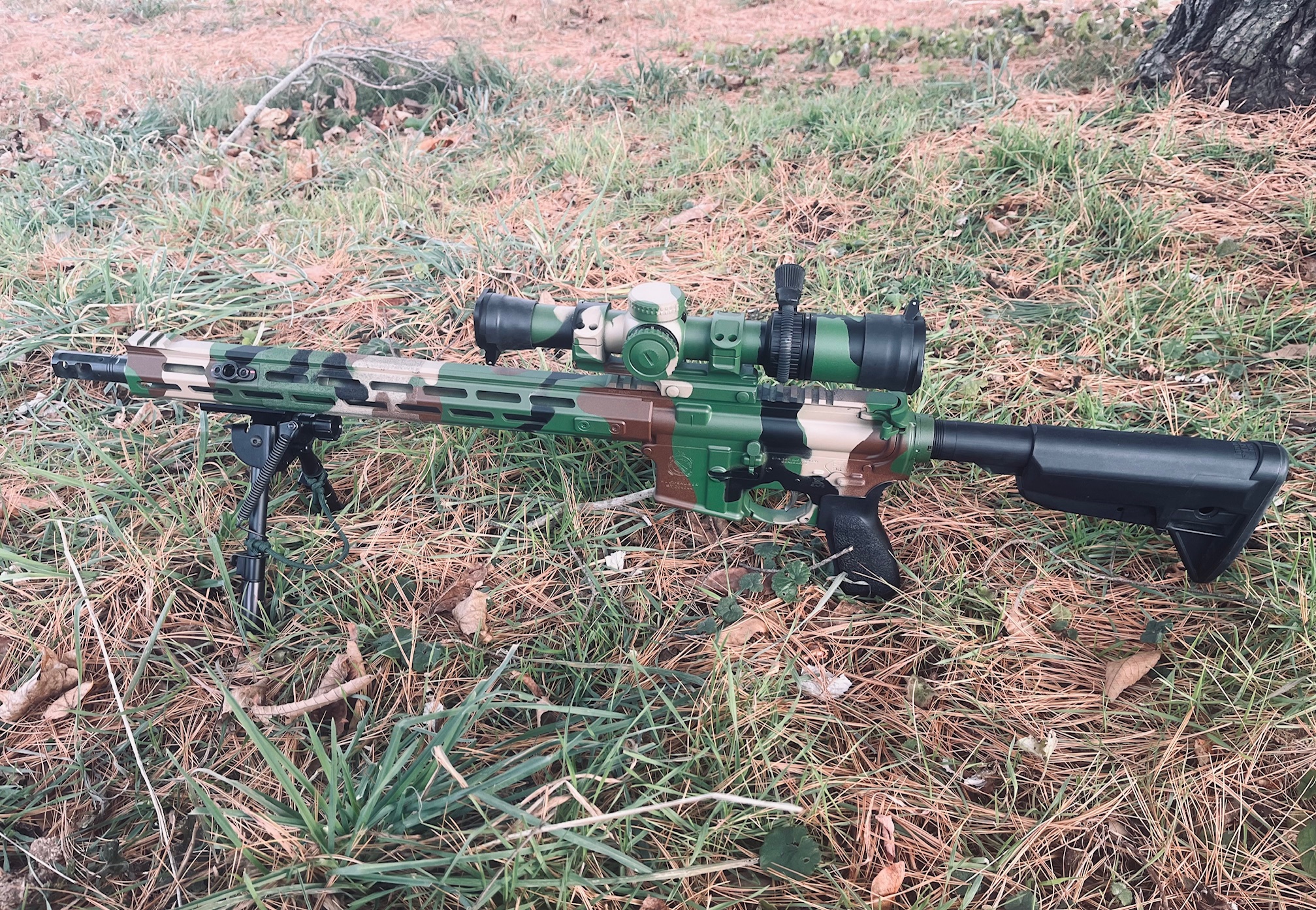

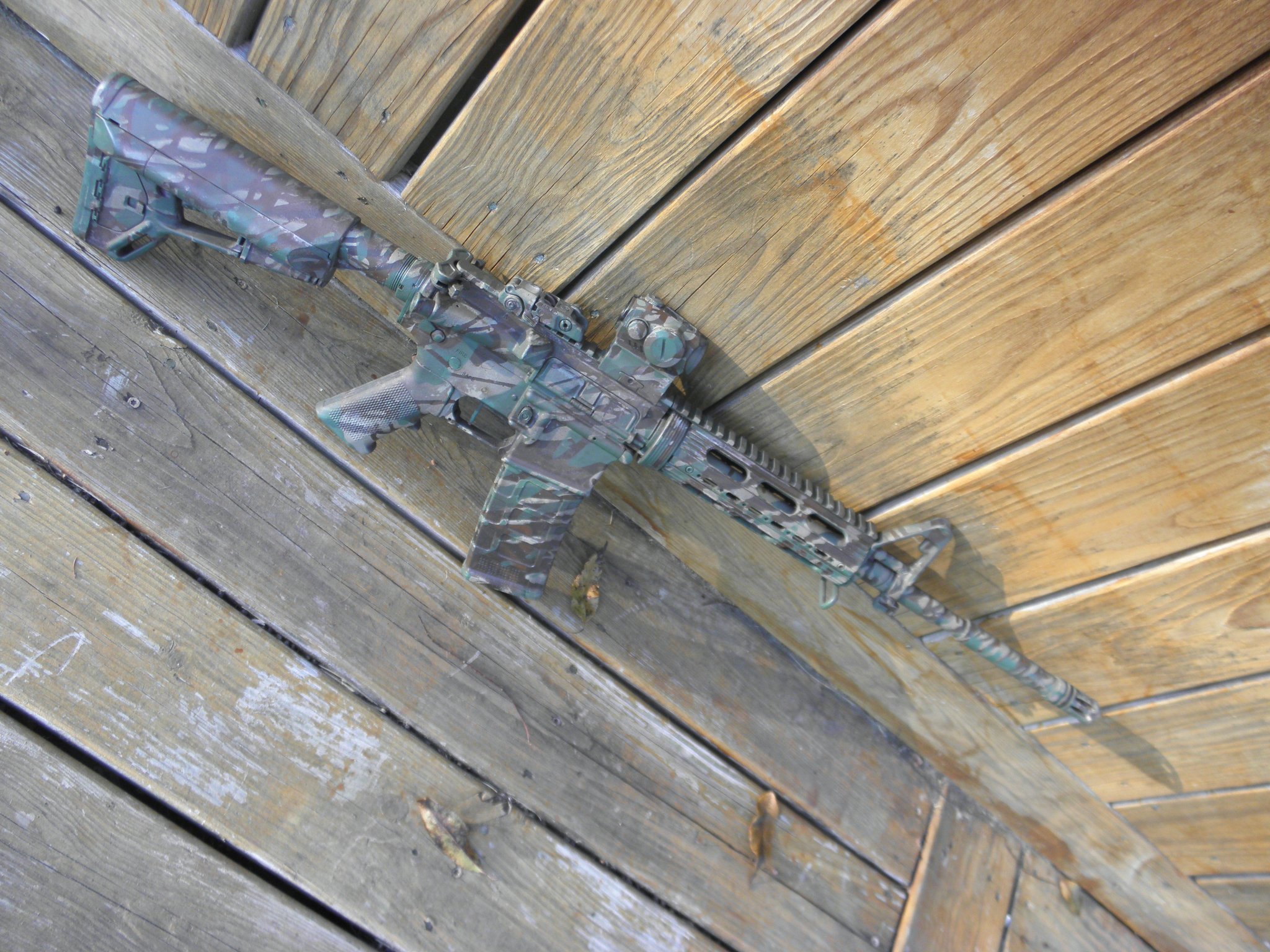

Played around today to recreate God's plaid on one of my AR's.
Rustoleum Camo Flat Black
Rustoleum Ultra Matte Down To Earth
Rustoleum Flat Brown
Rustoleum Satin Seaweed (had to darken it just a touch with some Flat Espresso paint)
Against my woobie it's a pretty good match. This should tighten my groups up by 30% at least.

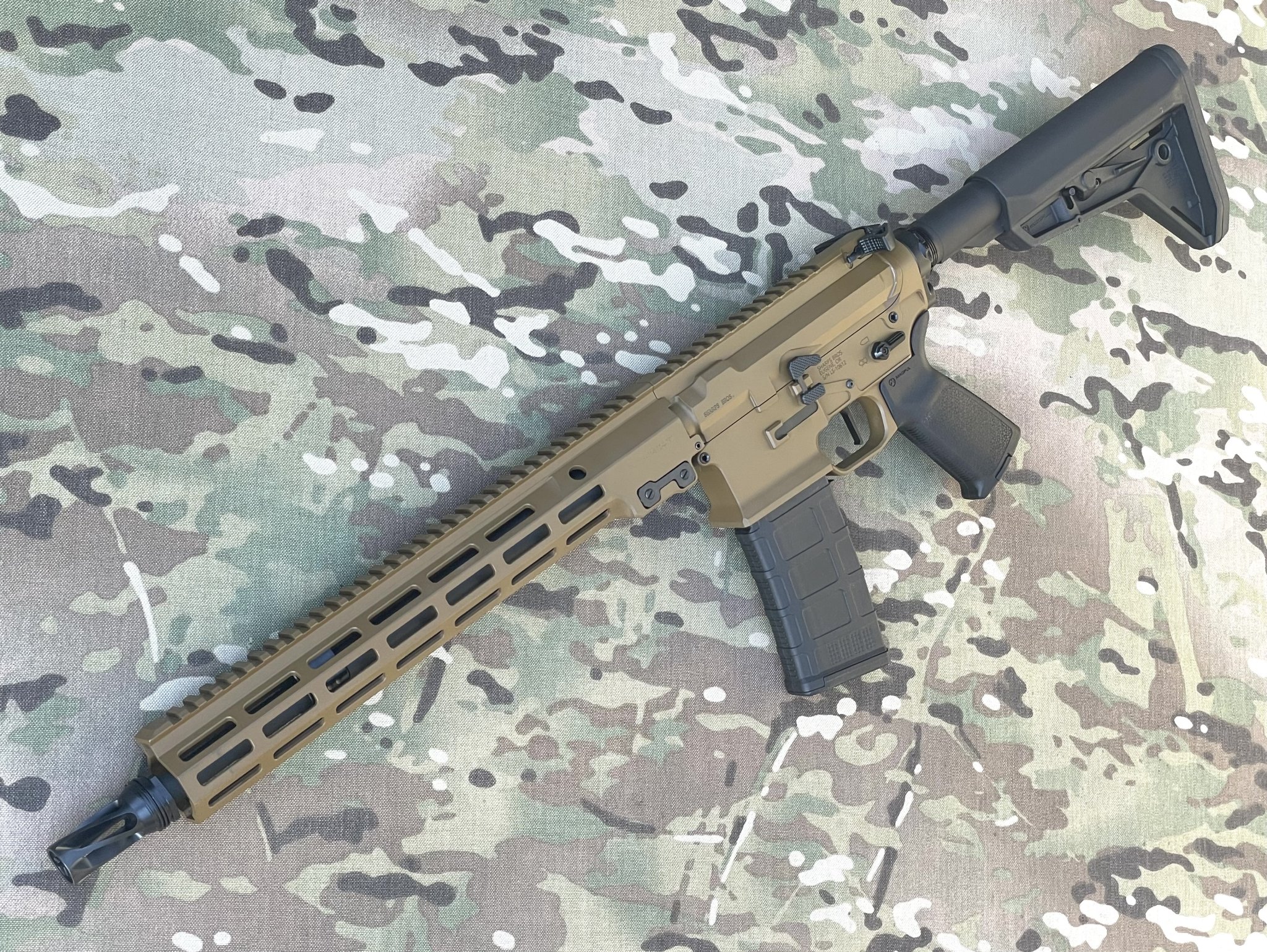

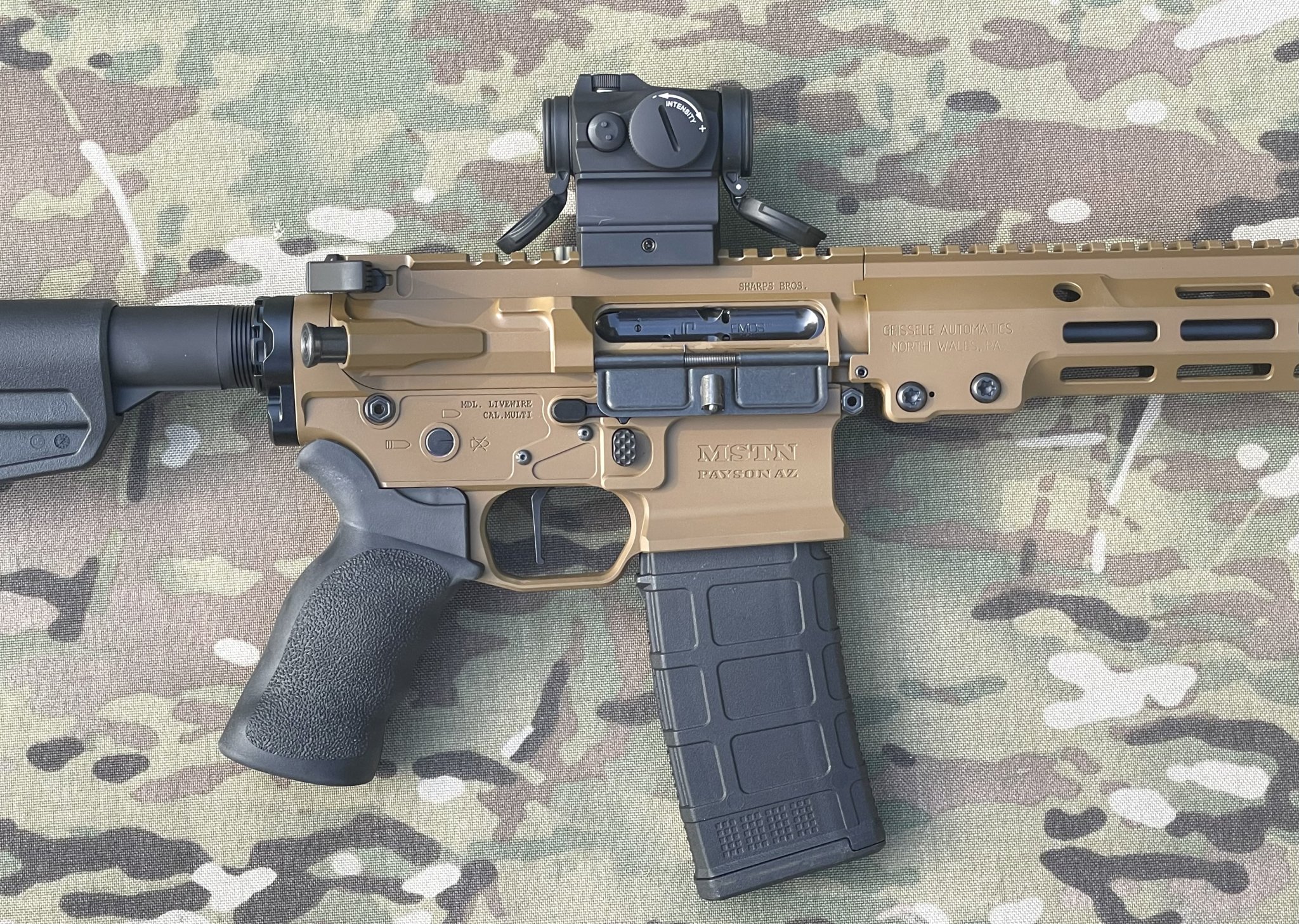

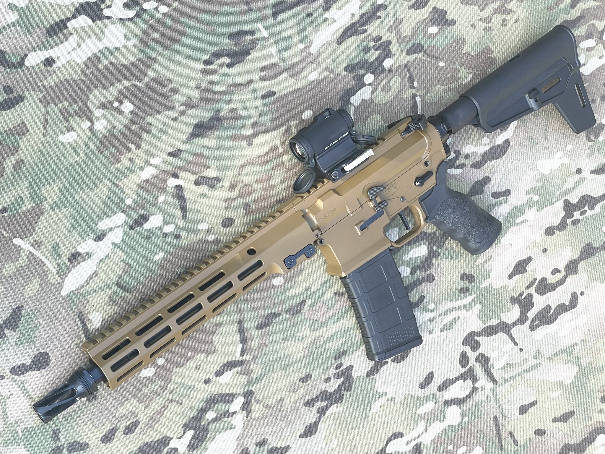

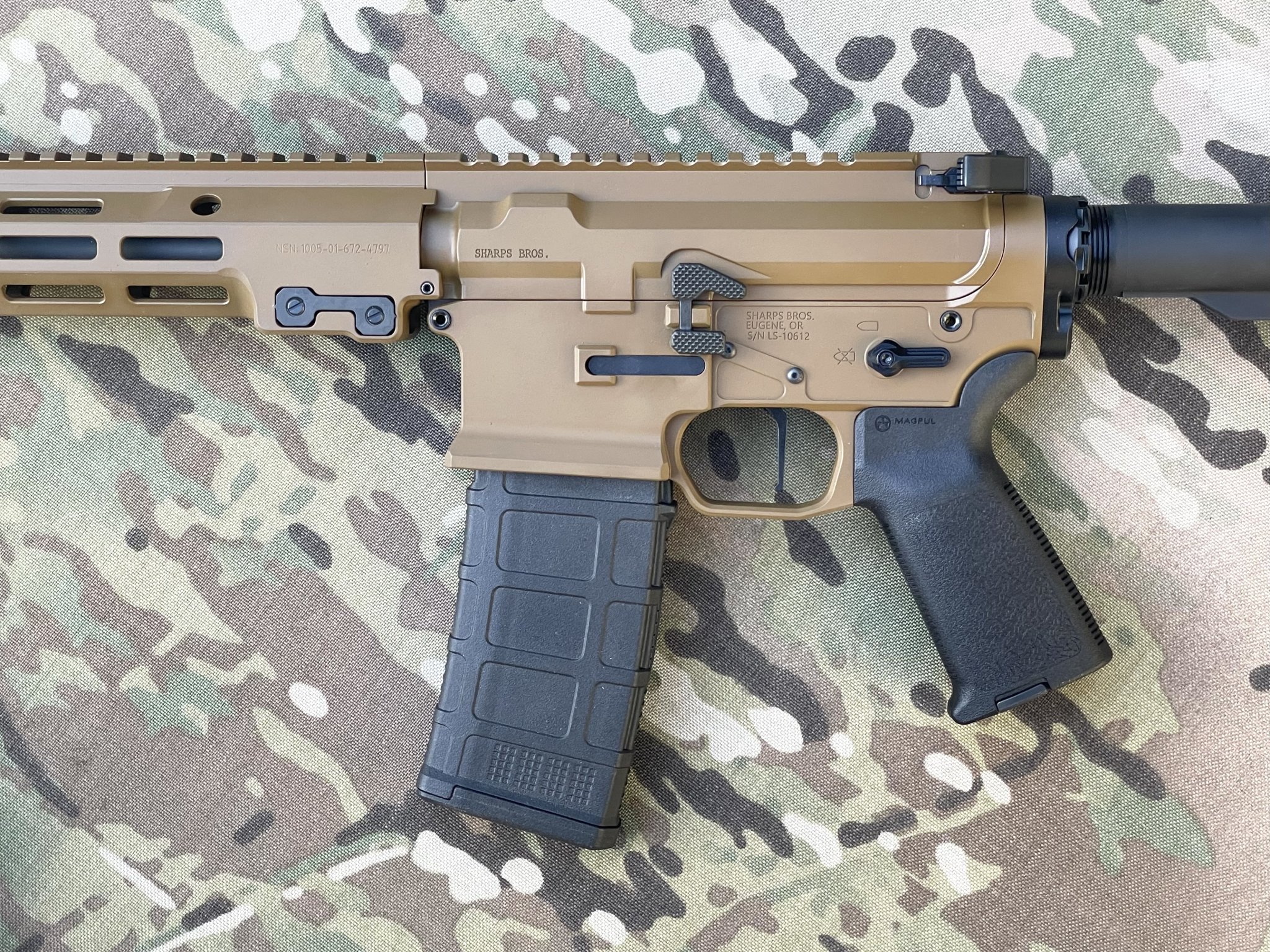

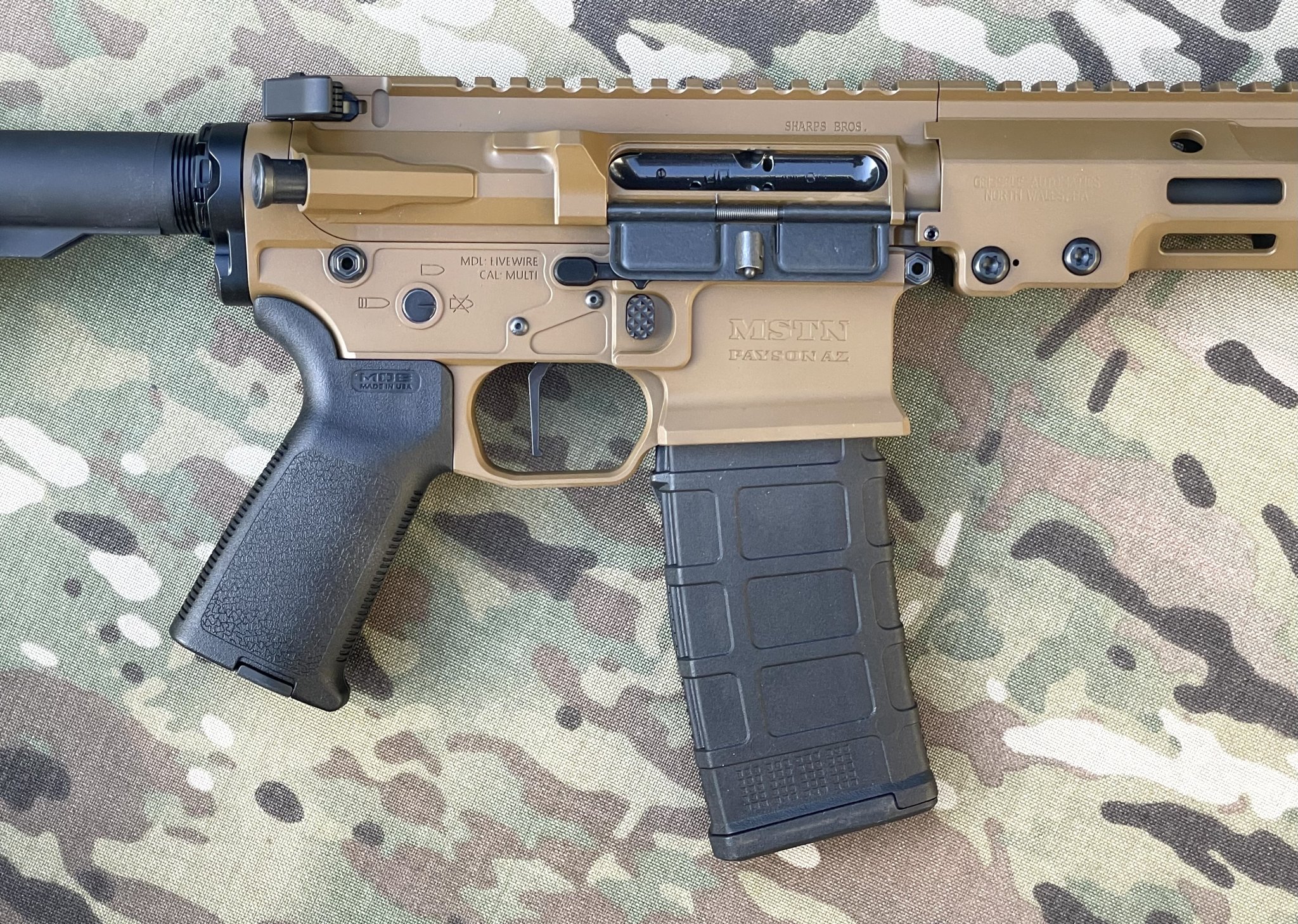

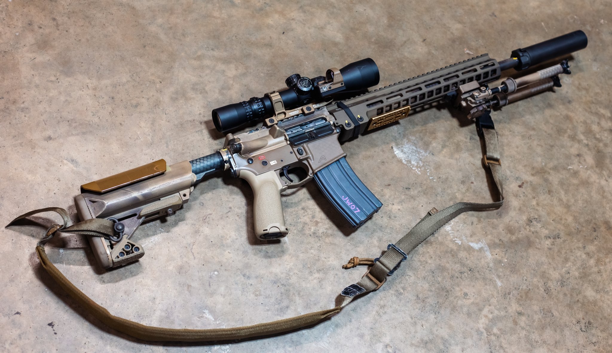

The best "one gun", IMO, is a top quality 14.5" .223 Wylde/5.56 NATO with a pinned and welded muzzle device. With the right optics package (LPVO plus RDS) and quality ammo, it is capable of filling mission roles from arms length to 600 yards. This one starts with a Sharps Bros. receiver set, Criterion Core C/L barrel, pinned and welded HUXWRX flash hide, JP FMOS bolt carrier group, BCM MK 2 recoil system, and TriggerTech trigger. The right Cerakote artist (Ronin ARMS LLC) did it all up in Accuracy Int'l Dark Earth.

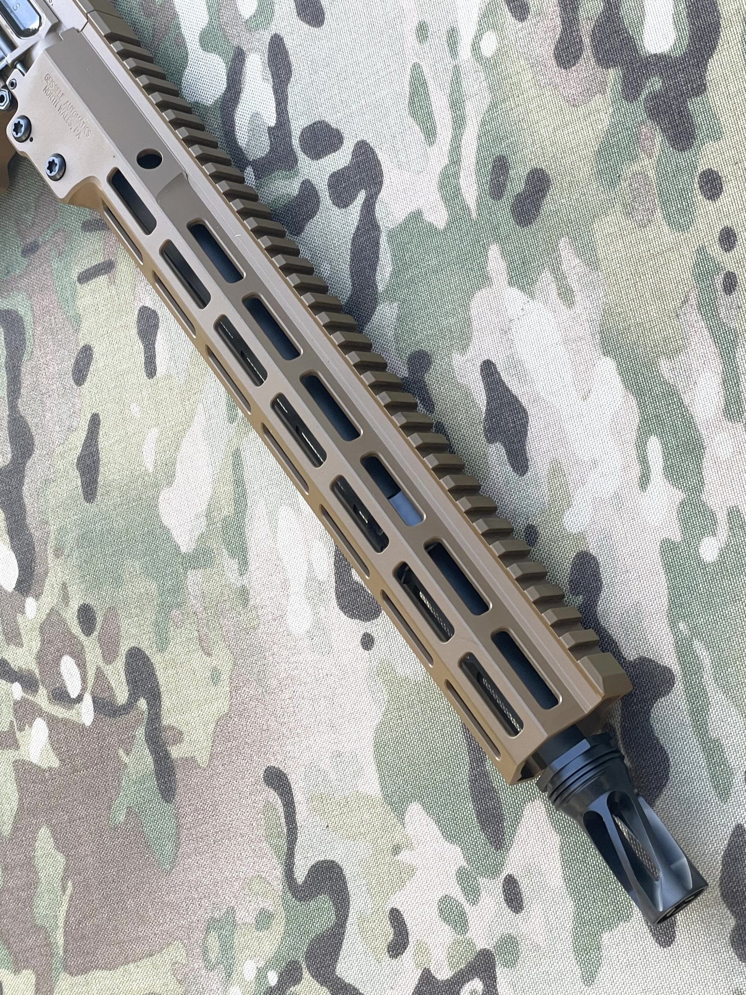

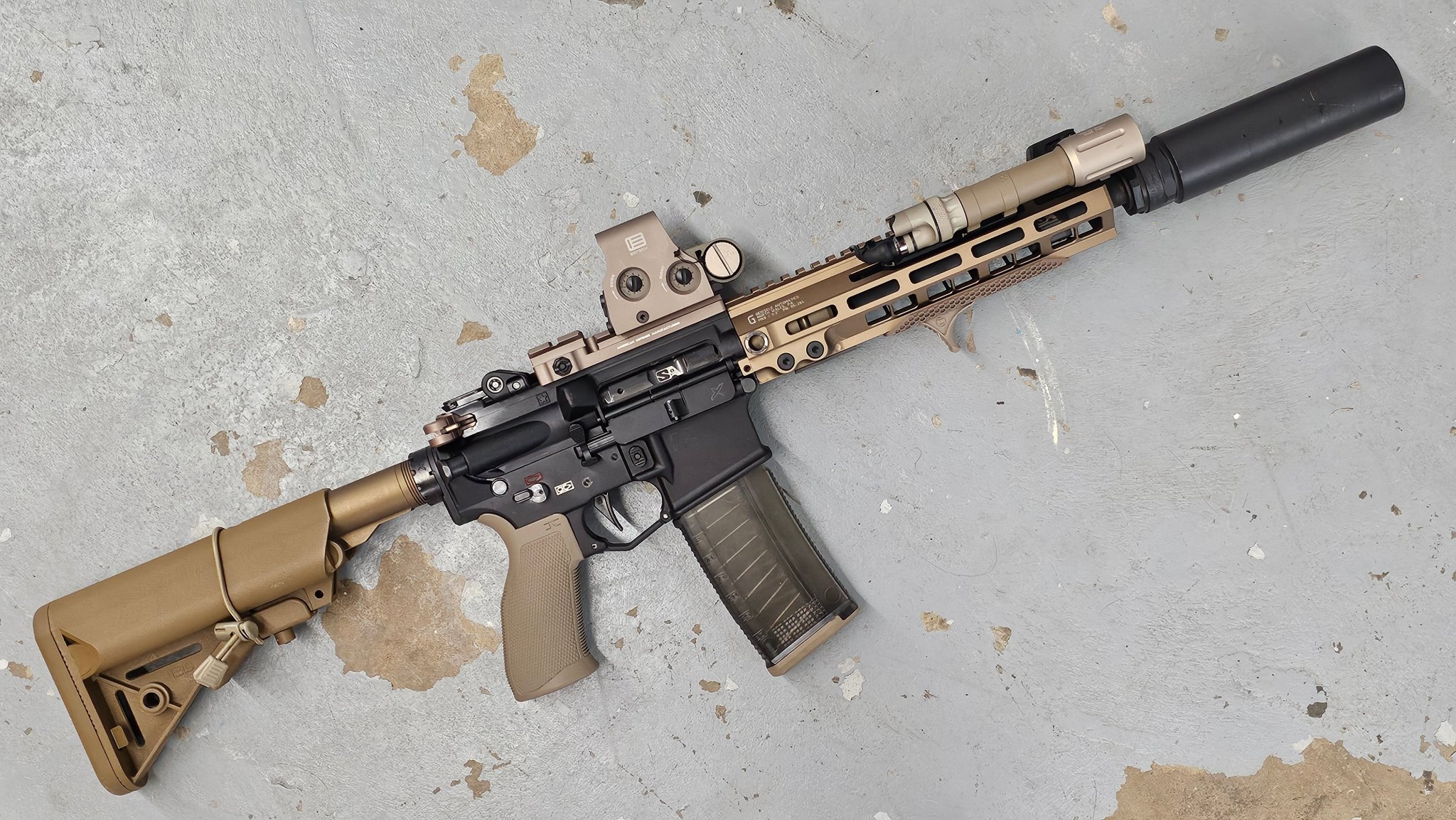

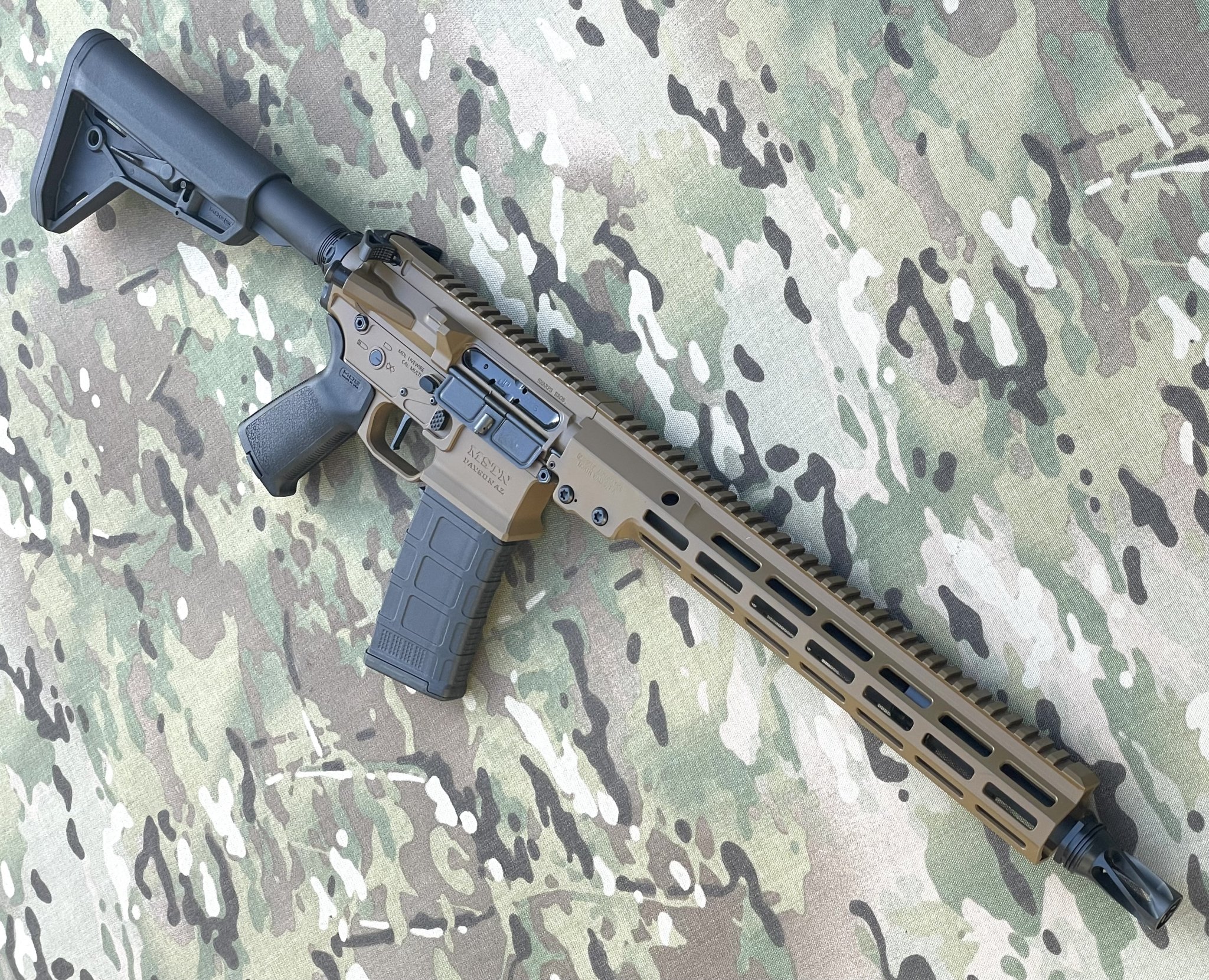

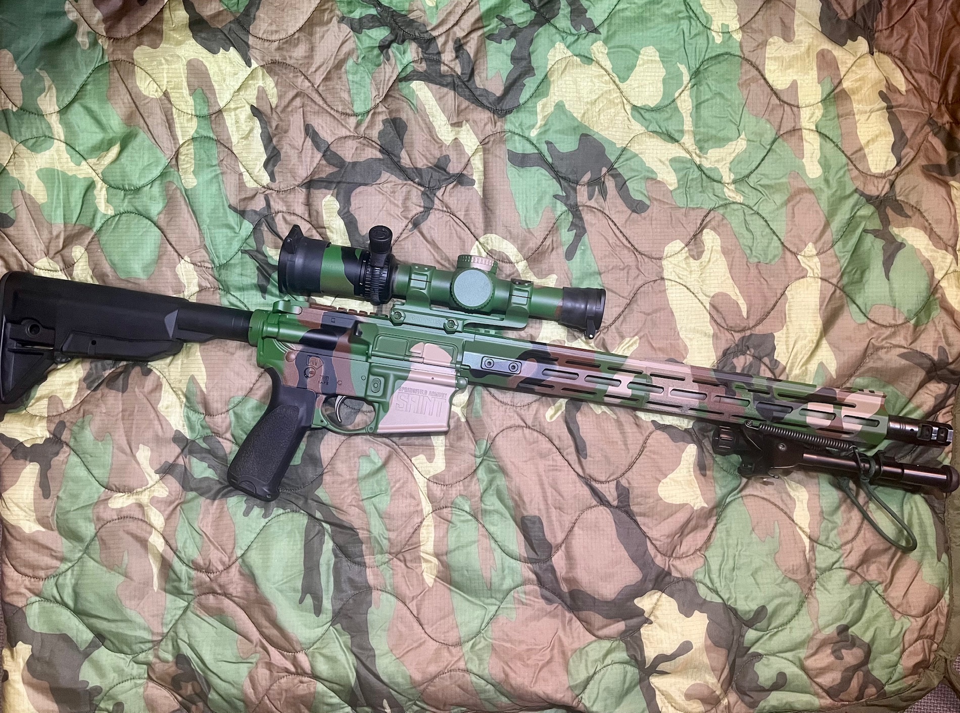

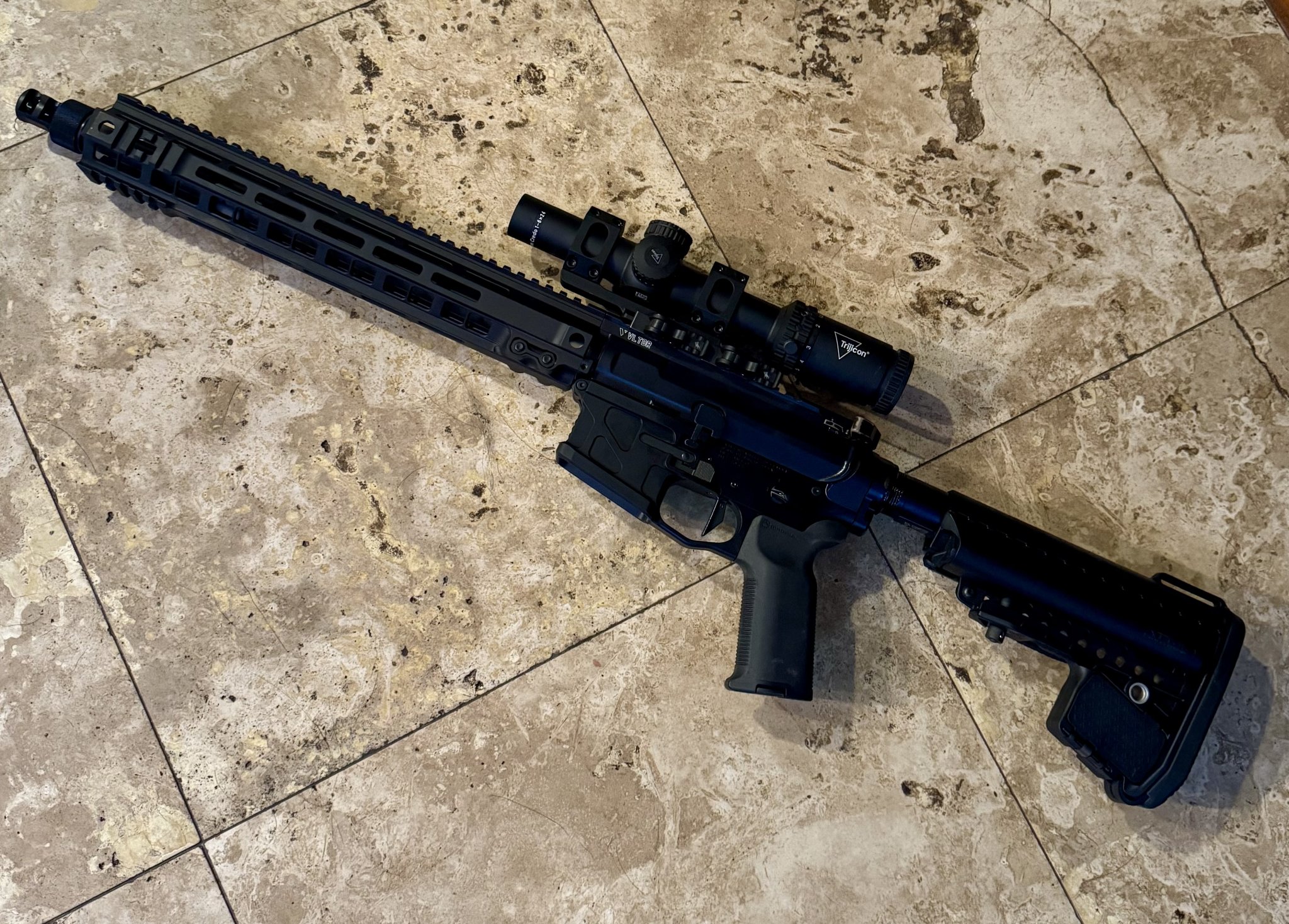

My favorite. Vltor MUR upper, ADM UIC ambi lower, Geissele MK4 13” handgaurd, Criterion Hybrid 14.5” barrel, Superlative Arms piston conversion, Geissele SSP flat trigger, Vltor A5 buffer, Vltor Emod stock, Trijicon Credo 1-6 in ADM Recon mount. (Not pictured is 5.5” K can)

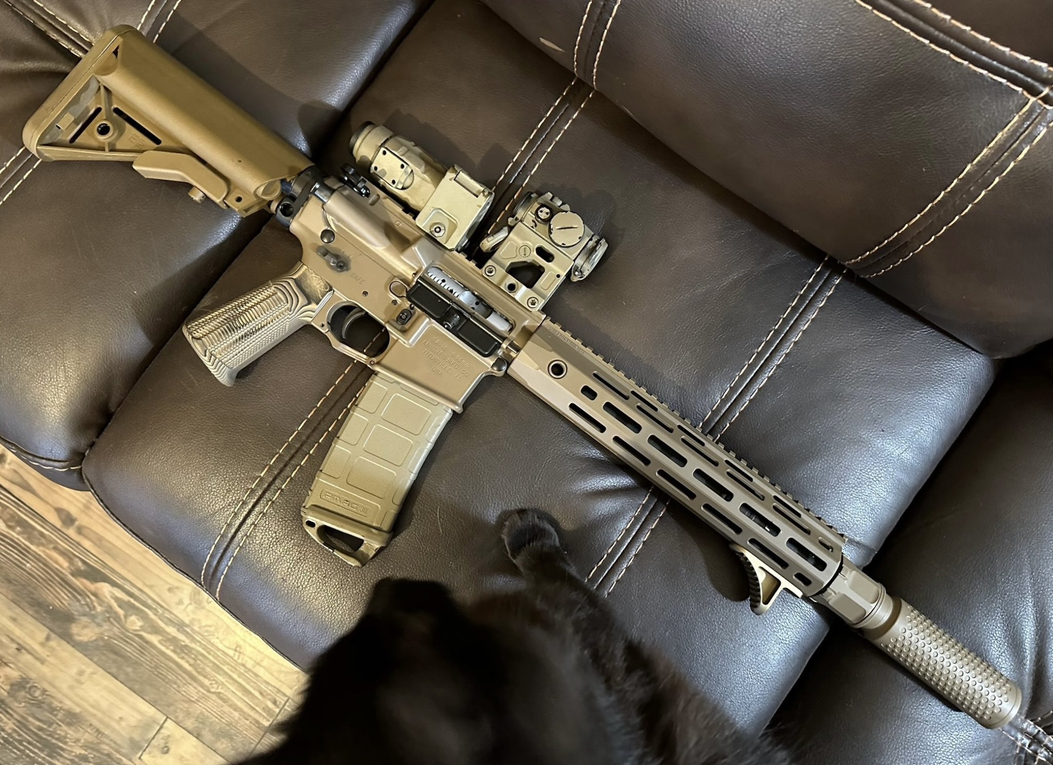

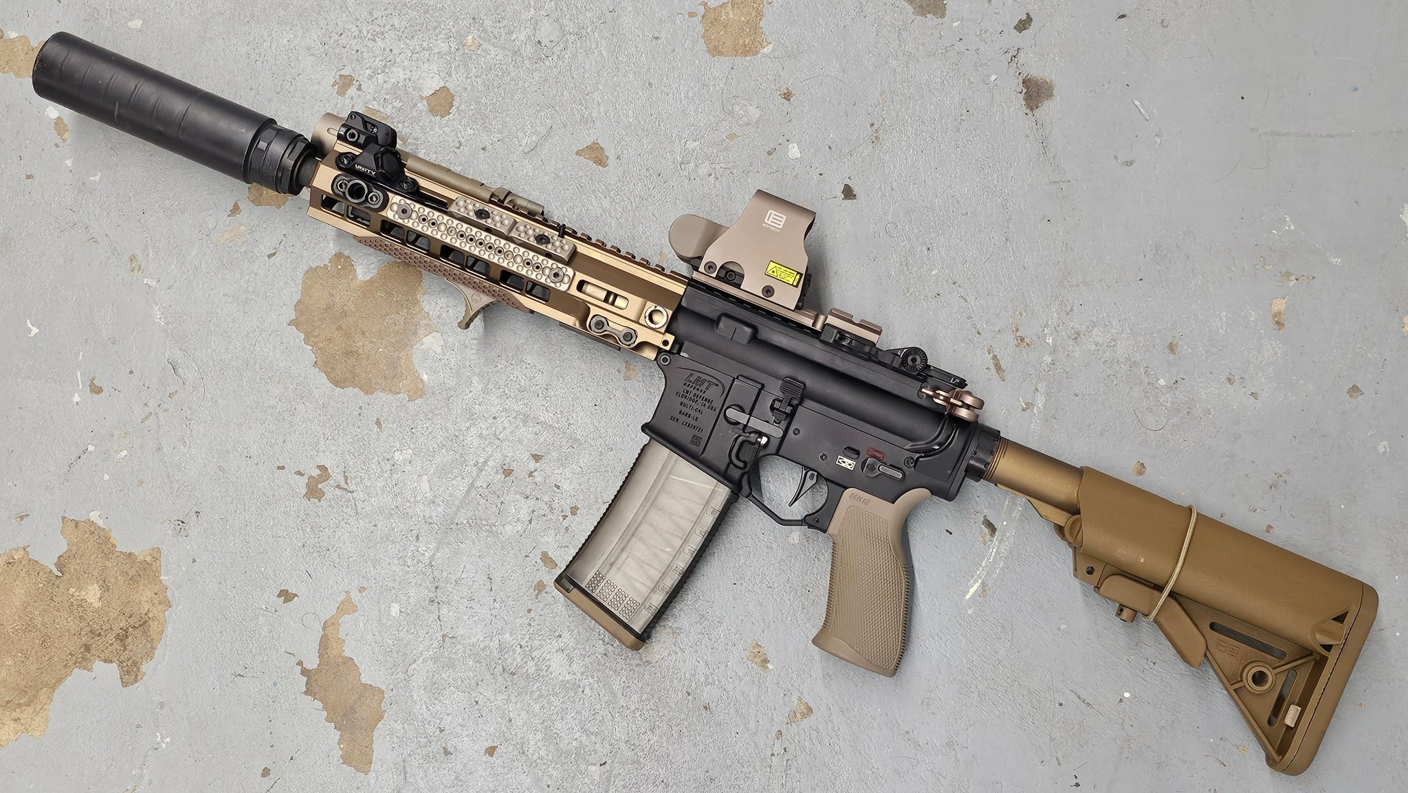

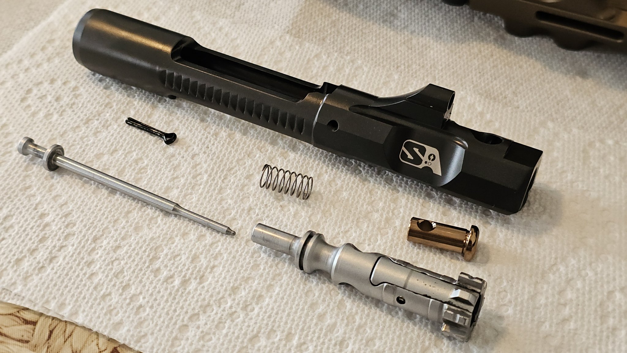

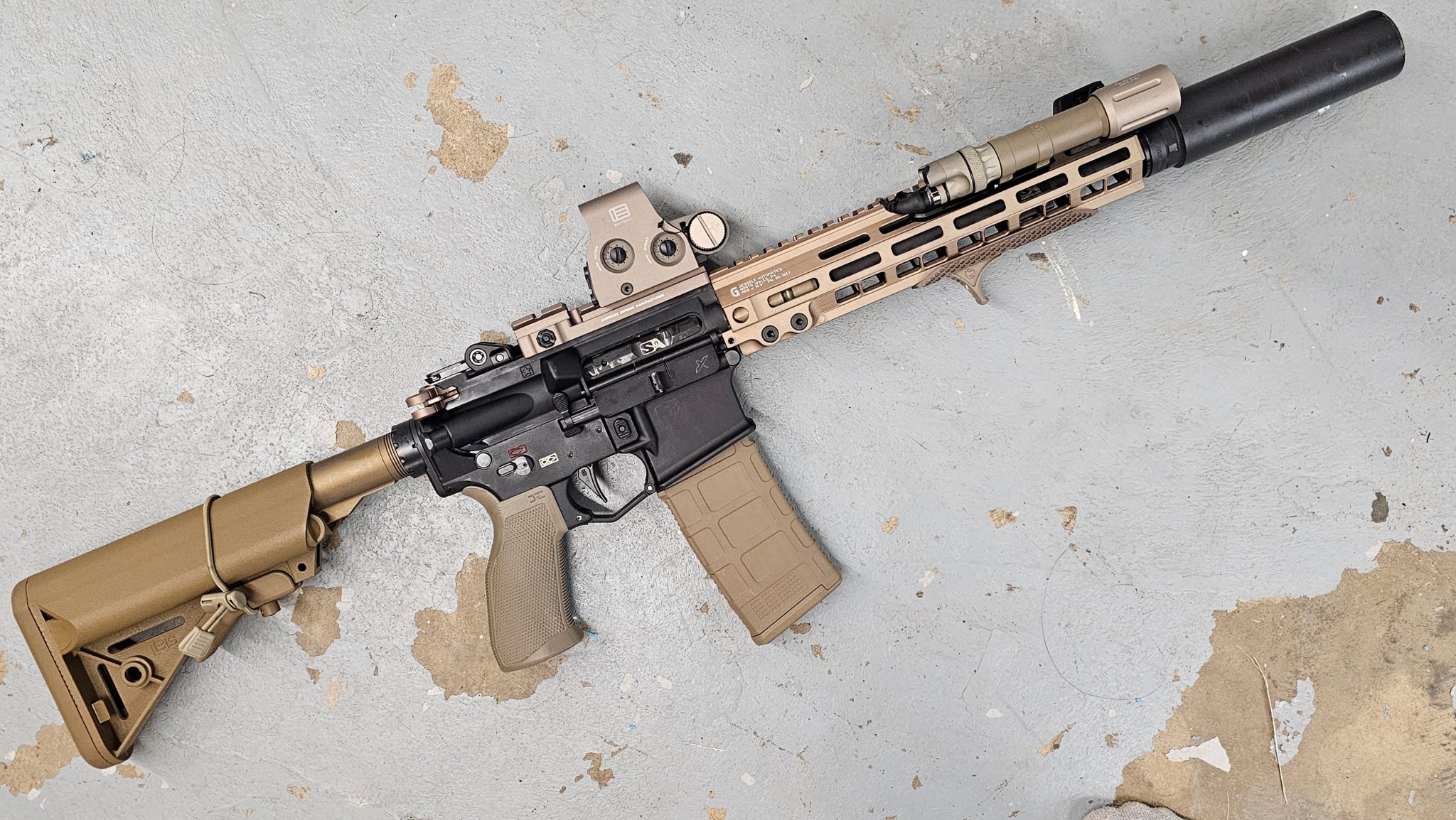

Got the 11.5 together, feels great. Really loving the Wolfpack Armory recessed flash hider and suppressor mount. It tucks the can back far enough that my 11.5 is now no longer than my 10.5 with the old mounting system with a little more rail space too. Blast baffle be damned.
Upper is a 11.5 CHF CL Centurion Arms barrel and a Superlative Arms short stroke piston kit. Running an LMT e Bolt and Lantac domed cam pin in the carrier, A5 system in the buffer with a rifle length Geissele Super42 and BCM Mk2 T3 buffer. Ran incredibly smooth with the 10.5, excited to shoot it with the new barrel.

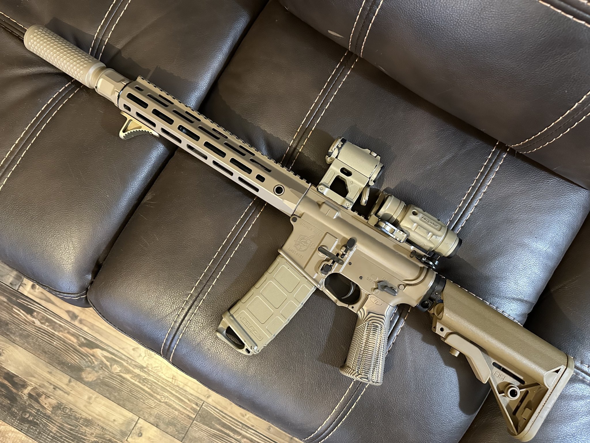

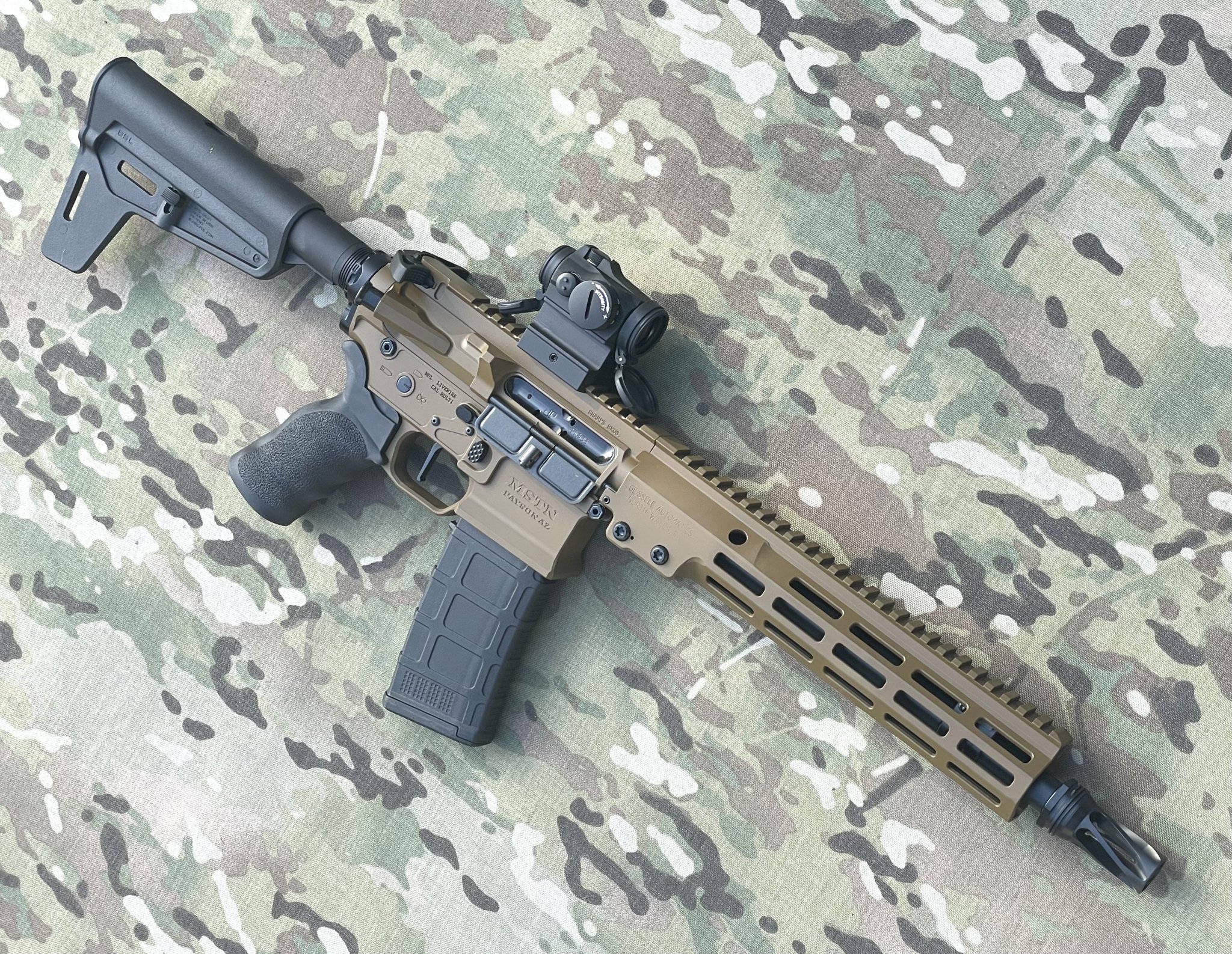

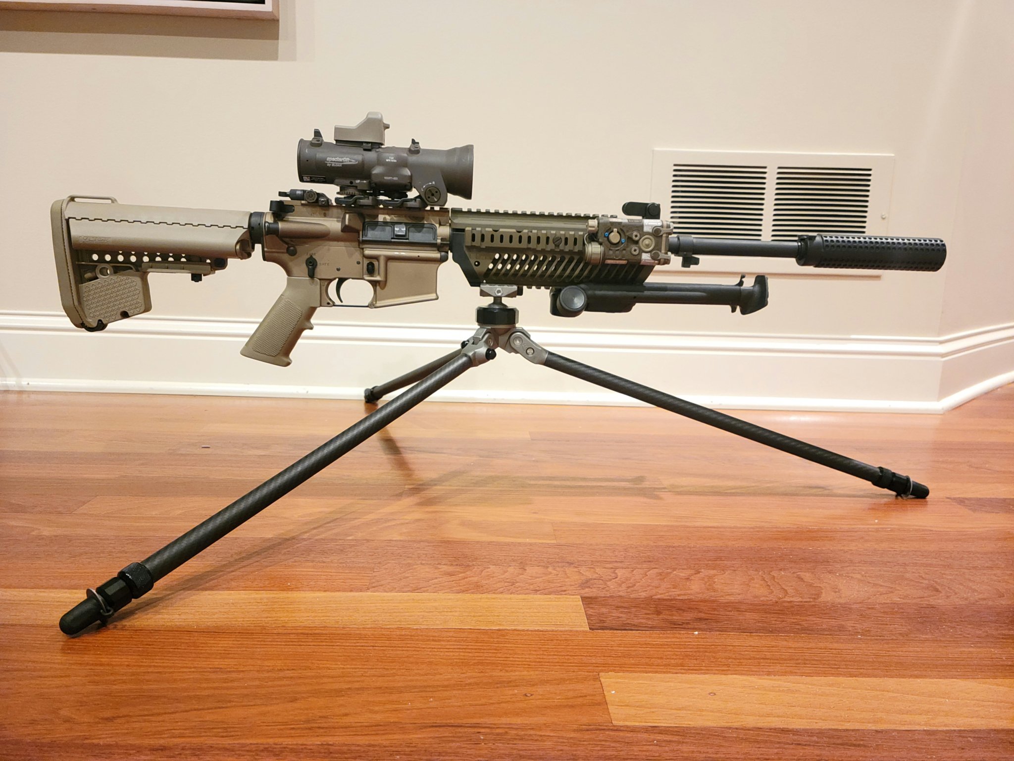

11.5 build with a Roscoe barrel. BCM 10” peen rail, H2 buffer system, GB, and BCG. Geissele G2S and ACH charging handle. M68 W/ matching 3x magnifier on Larue mounts. DA Sandman K. Troy BUIS. Streamlight Protac 1.0 w/ tapeswitch mounted in a Cloud Defensive Mount.

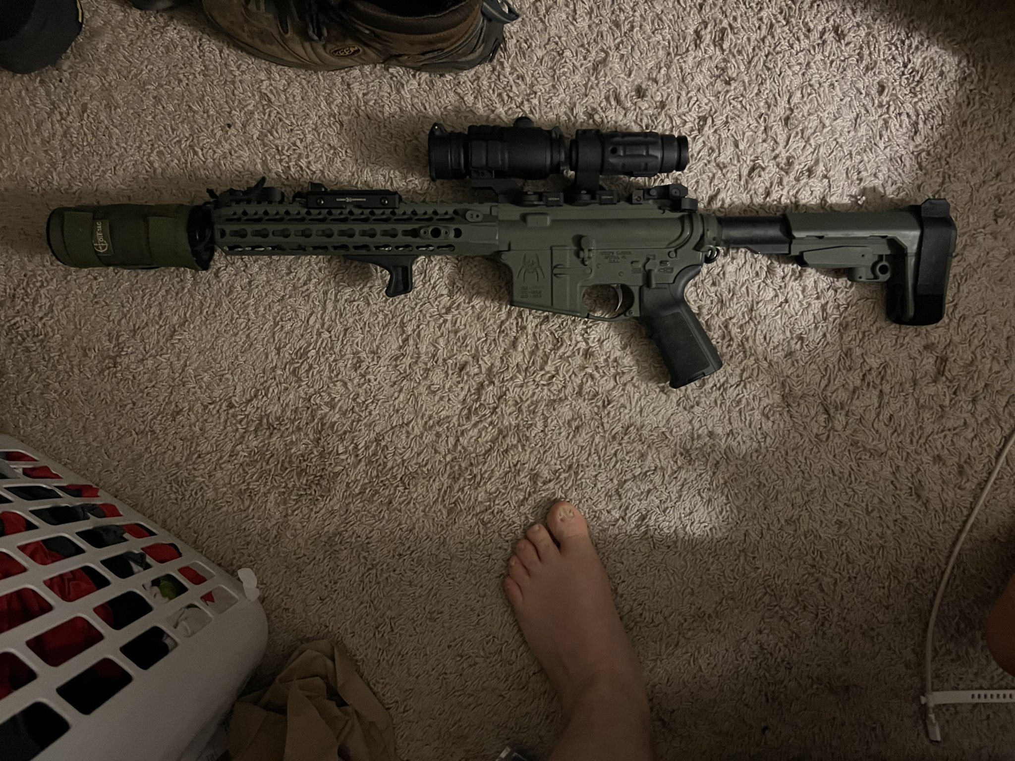

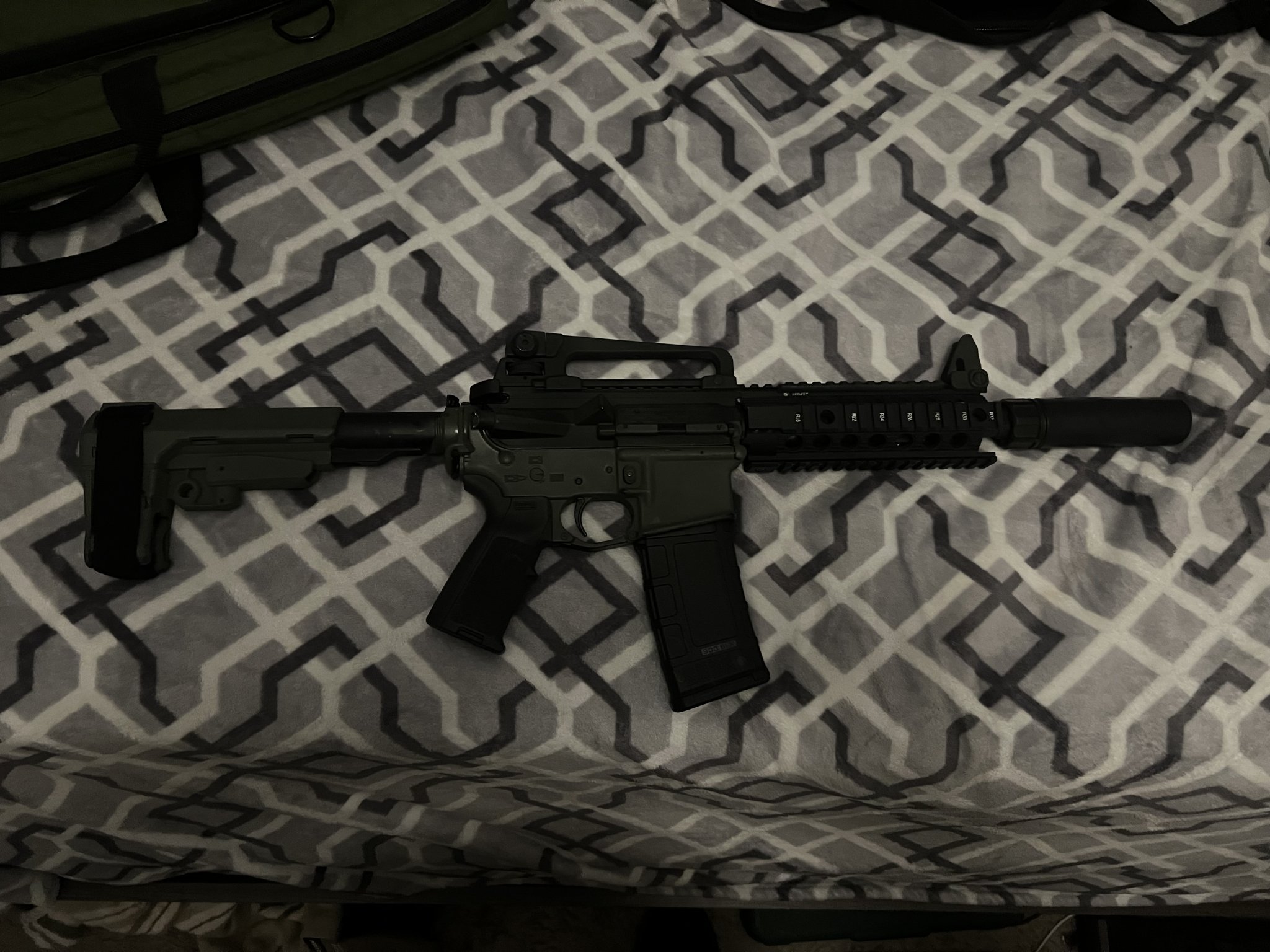

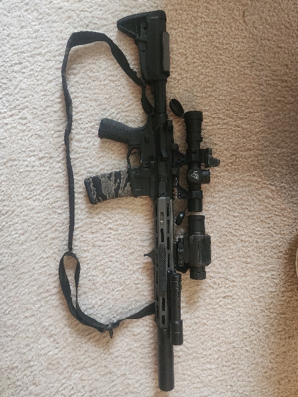

Put the 300blk upper back together. Haven’t gotten an optic (planning on a GLX 1x) yet so I stuck the carry handle on it. Now the optic may just go on the carry handle when I get it. 8” barrel with the SOLGW NOX fits in the Little Trick as my go bag and travel AR.
