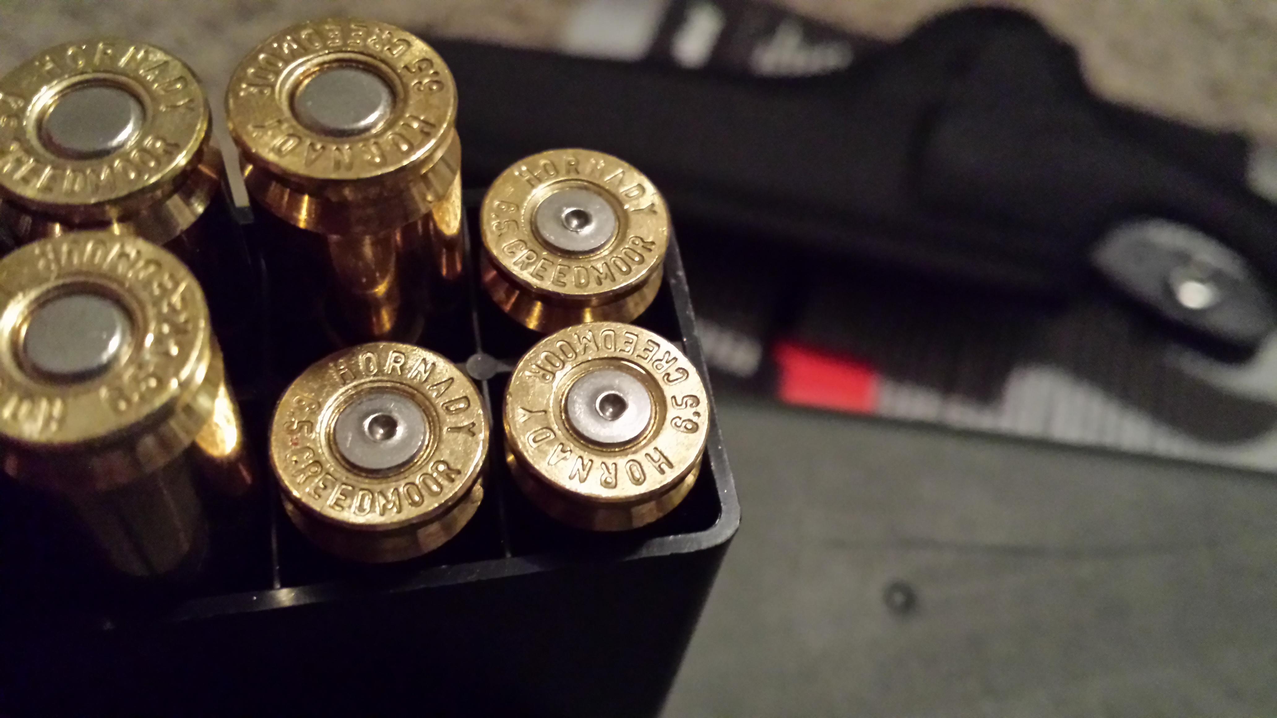

Here's a pic of the original first 3 rounds out of my rifle. The box of lot# 3100xxx primers look exactly the same as these. Does this look similar to your 700 rifle? Should I be sending my new rifle back to savage? I guess my biggest concern is safety in this situation

Yeah those primers are fine. That's not flat at all. Still nice rounded edges. Those "craters" are just from firing pin hole. My .308 looks the exact same.
Thanks for all the input. And [omgtkk] that seems to be the only "problem" I've noticed since I started shooting. I've only ran 25 rounds thru the gun but ill continue shooting now that I know it's not an issue. I have some 314xxxx lots I plan to shoot next so hopefully I can come up with some good groups.

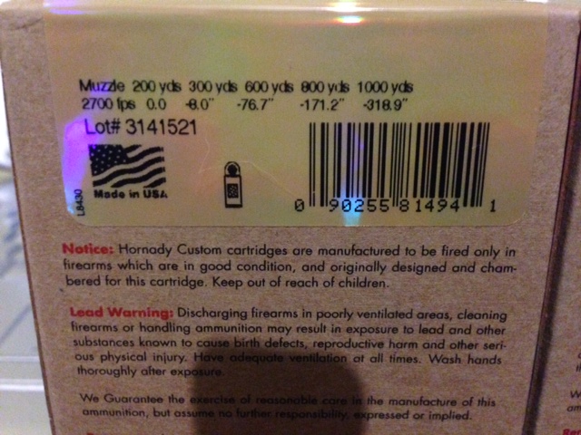

Got a few boxes of 140 and 120 ammo from Sportsmansguide.
Curious to see no recommended load data on the 140's Lot #3141521.
The recommended load for the 120's uses Varget.
Glad I have H4350 and Varget in the cupboard anyway.
Will report accuracy later.

Everyone was complaining when the data was there so don't be surprised it's not there anymore. I am sure now people will complain it's not there :rolleyes:
