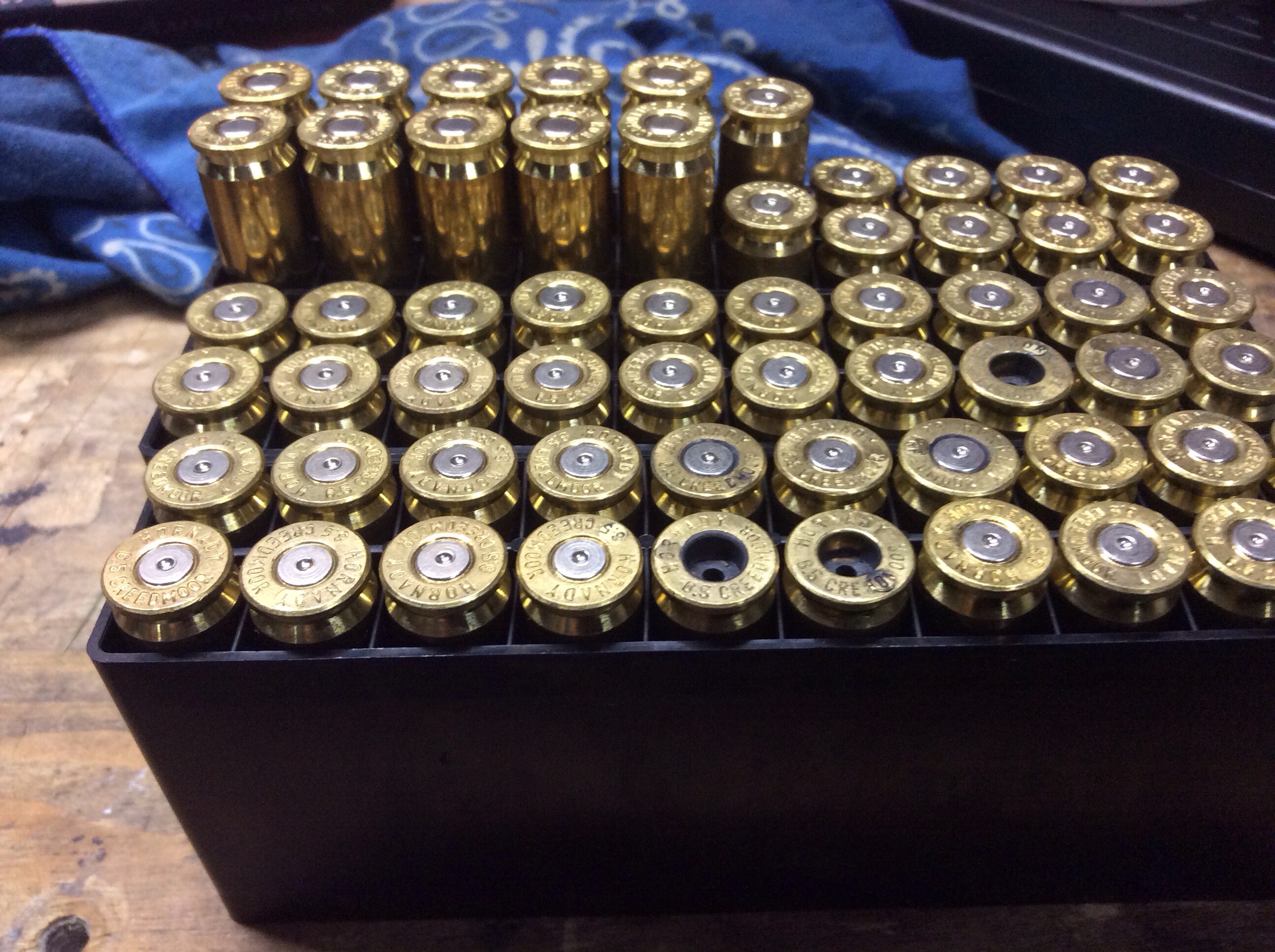

My plan was to reload the brass from lot 313xxxx after going through the empties I had about 40 pieces of brass that showed ejector marks on the case heads and some carbon in the letters on the case heads, I left them out and cleaned the rest 5 more case that I cleaned had scary loose primer pockets when I reprimed the brass so I tossed them as well.
Never had any issues like this before.
I'm lot number 3133158. I shot 100 of these yesterday in brand new rock barrel. Shot like shit best group of day was close to 3/4. Worst was around 2 inches at 100 yards. Had flattened primers and a few with swipes. It was 66 degrees and sunny while shooting. Oh and it was nasty powder. My rig was completely fouled out after 100 rounds. If I wasn't just trying to burn the ammo for break in and brass I'd be super passed.
I have about 10 shells left in the last box so I broke one of these apart. I will break the rest up for bullets and brass. Or maybe just load 41.5 of H4350 and see how they do.
That's because they are using R17 at a very dangerous pressure rate. Like the post just below this one... That's wayyy to much powder. If its 19, which I doubt bc people are reporting freaking highhh velocity ) then it would make sense. But you might as well pull all the bullets and resize. That shit is dirty, and a waste of range time and bbl life

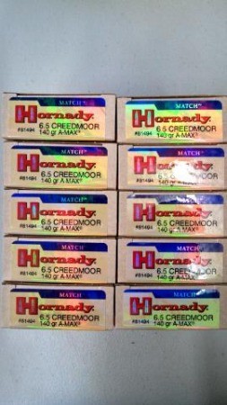

The top 20 are from a 3122982 lot # and the bottom 20 are from lot # 3132438. This isn't a lighting trick or anything. The old ones are more "brassy" in color.
New (bottom) vs Old (top) fonts.

Okay, so I tracked down some of the "older" stuff for sale but here's the dilemma: It appears to be Lot# 3131512 is partially in the old box and partially in the new box. I think I'm going to take the gamble on a couple of cases of it just to have it on hand in the event that Hornady drags its ass on getting this problem fixed. Am I screwing up by grabbing it?
ETA: I was misinformed. The gentleman with the ammo got back in touch with me to say it was actually 2 different lot#s.
I'd already done the purchase, and he went out of his way to be honest about it, so I just told him to let the order stand so it looks like I'm going to end up with about 8 boxes of the old stuff (old box) and a full case plus 2 boxes of 3131512. I'm taking the gamble that that early into the 313 lot#s the ammo may still be okay. If not, then I have a ready excuse for shitty performance "It's not me, it's the ammo, honest."
It is so shitty right now with the stuff I got, last night I pulled 160 bullets out of the same lot of manufactured hornady 140 amaxs. Going to stuff them with h4350 and a 140 hybrid
