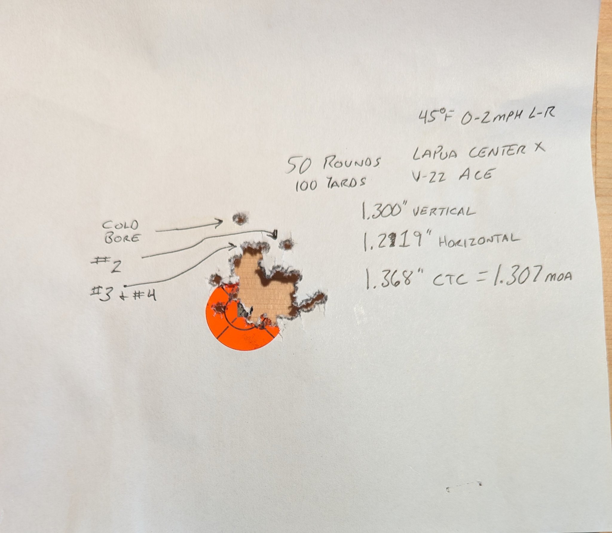

Honestly I like it.

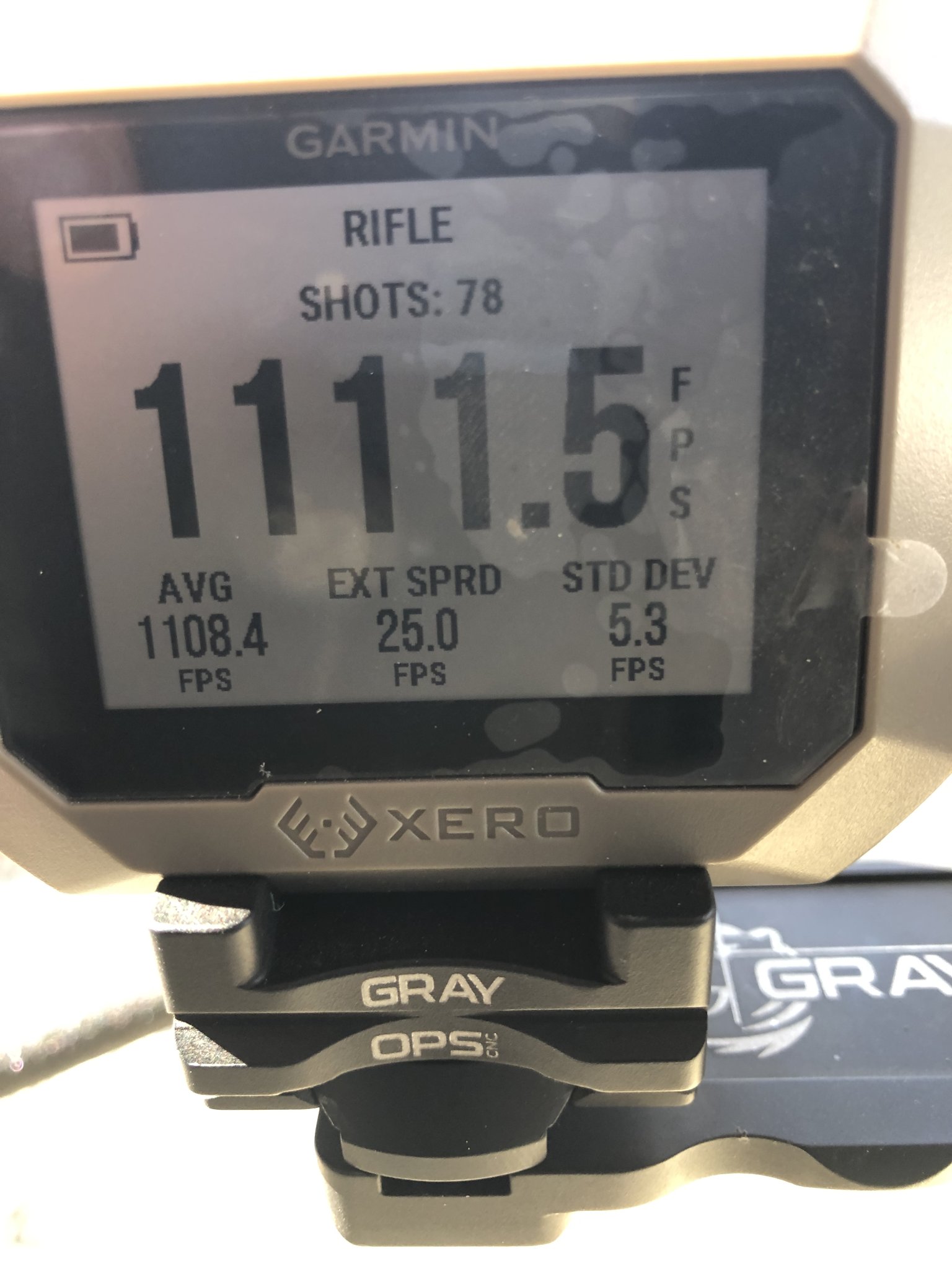

I just did a tuner test and shot 390 rounds of a random lot of center x. SD was 9.1. ES was about 60. Not too bad IMO.
For sure. I have been shooting Center X since it’s release, there have been some phenomenal lots. Back when it was $10-$11 a box it couldn’t be beat but the last few years it hasn’t been as consistent from lot to lot.
With all of my testing I was seeing similar numbers for 10 round strings fairly consistent, when I bumped up to 20 rounds the SD would usually go into the low teens. I don’t remember the ES anymore unfortunately.

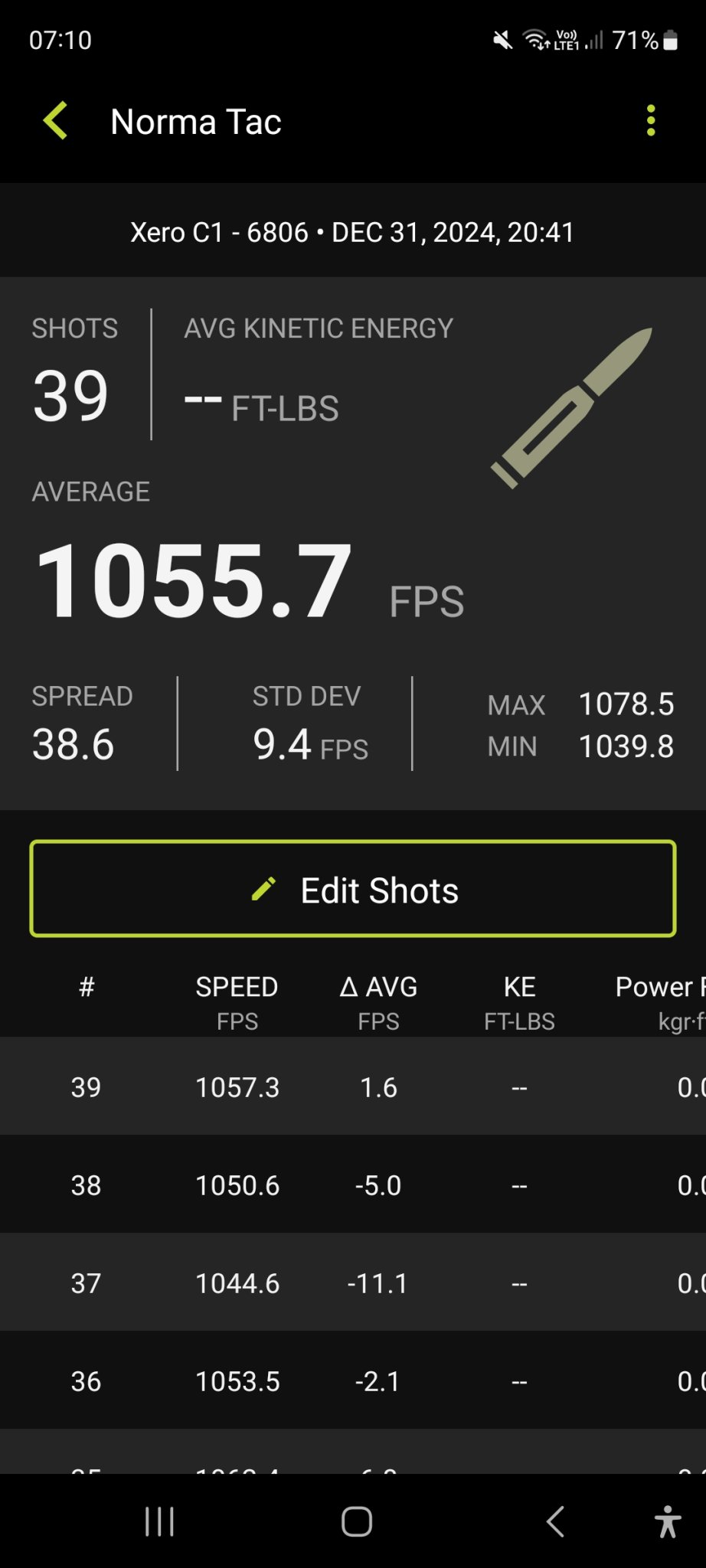

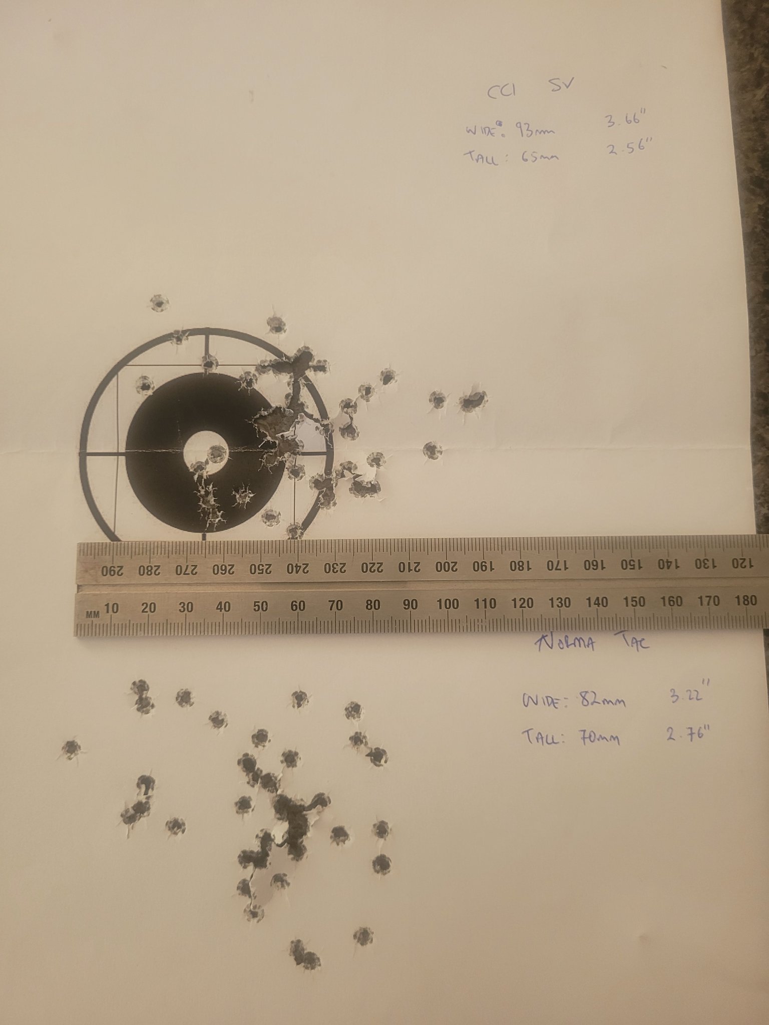

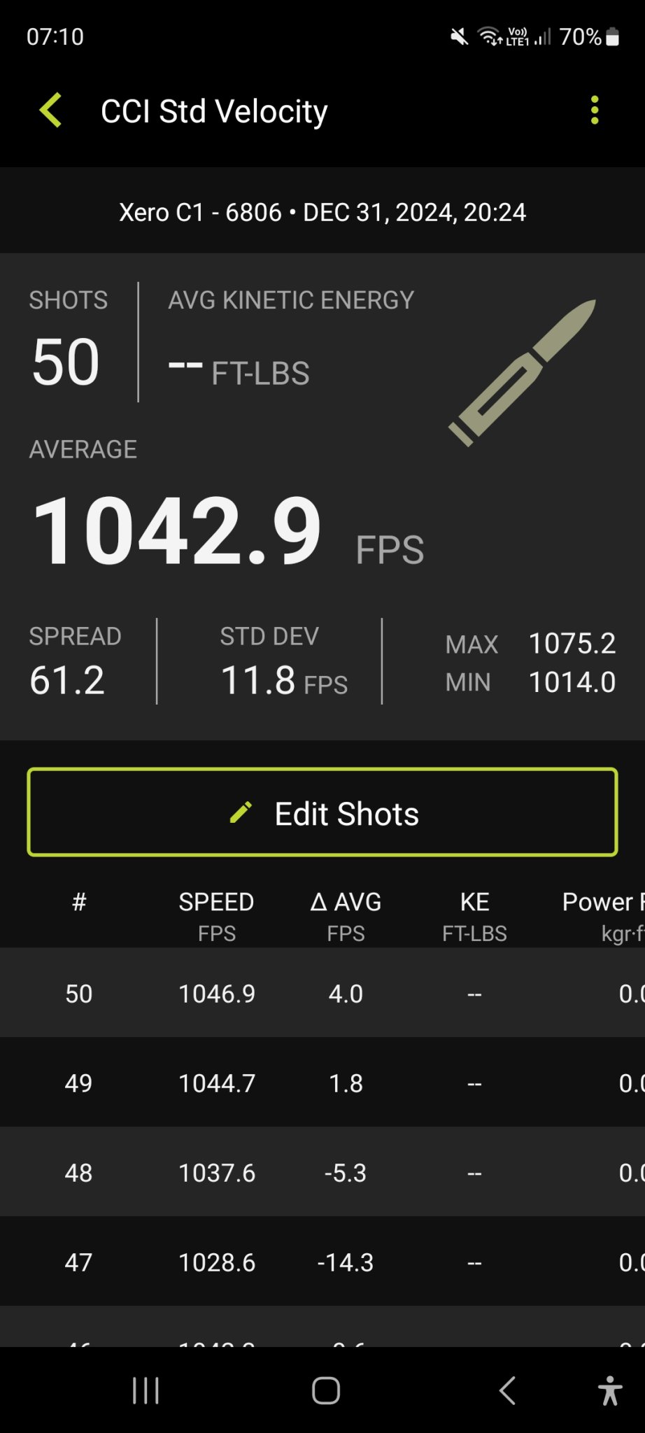

Not exact a whole box at 100, but close.
Was needing to do some testing so thought why not give this ago.
Target was at 114m (125yards) and no attempt and wind calling was made, wind as very strong and gusty but shooting in a valley meantit was reasonably sheltered.
Top group is 50 rounds of CCI Std Velocity, bottom is 39 rounds of Norma Tac.
The Norma shoots amazing inside 50m and has a very low ES/SD but at distance the accuracy isn't great.
