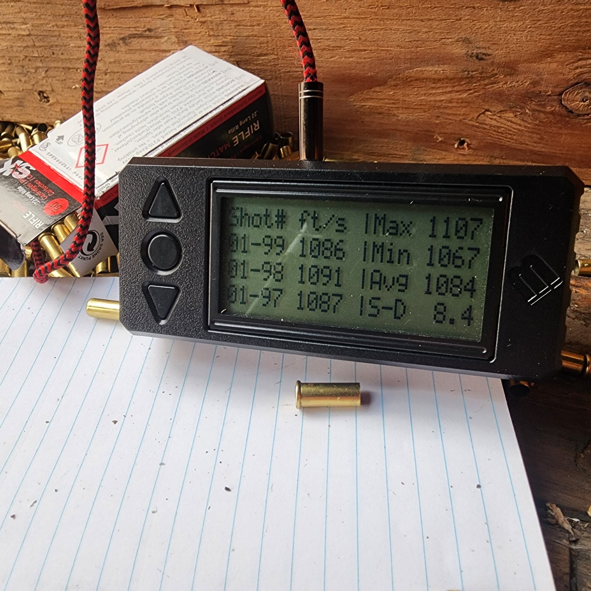

Post # 251, Lapua Long Range w/lube
Hi vel. 1089, low vel. 1056, E.S. 33 fps, weighted ave. 1074.
The spread between the Hi vel to the weighted ave. is 15 fps; the spread between low vel. and weighted ave. 18 fps. (15+18=33).
The difference between the high and low spread from the weighted ave. would indicate to me that the ammo was pretty constant.
Post # 272 Lapua Super Long Range w/lube
Hi vel. 1101, Low vel. 1061, E.S. 40 fps, weighted ave. 1083.
The spread between the Hi vel. to the weighted ave. is 18 fps; the spread between the low vel. and weighted ave is 22 fps (18+22=40).
Again, the difference between the high and low spread from the weighted ave. indicates pretty constant ammo.
Post #258 Lapua Long Range w/o Lube
Hi vel. 1122, low vel. 1047, E.S. 75, weighted ave. 1071.
The spread between the Hi vel. to the weighted average is 51 fps; the spread between the low vel. and weighted ave. is 24 fps (51+24= 75).
The difference between the high vel. from the weighted average is twice as much as the low vel. to the weighted average. However, the weighted ave. for the No Lubed rounds is 3 fps lower than the other Long Range rounds (post 251), so I would assume there were only a few shots of the No Lubed rounds that shot at the high velocity level as the weighted ave. indicates this. The question for me is where did these high velocity rounds occur in the shot string? If it was in the first few shots, did these first rounds lay down a fouling layer that provided enough lubrication for the subsequent rounds? Or did the high velocity rounds occur late in the string and the increase in fouling created higher pressure? Even though the weighted ave. velocity between the No Lube rounds were only 3 fps lower than the other Longe Range rounds shot with lube, The Hi and low velocities were higher and lower by over twice as much in the non-lubed rounds than the same rounds with lube. I will admit that I was impressed with how good the No Lube group looked compared to the other groups. Maybe it takes more than 50 rounds of non-lubed rounds before you can see the effects of no lube on the bullet on the target?

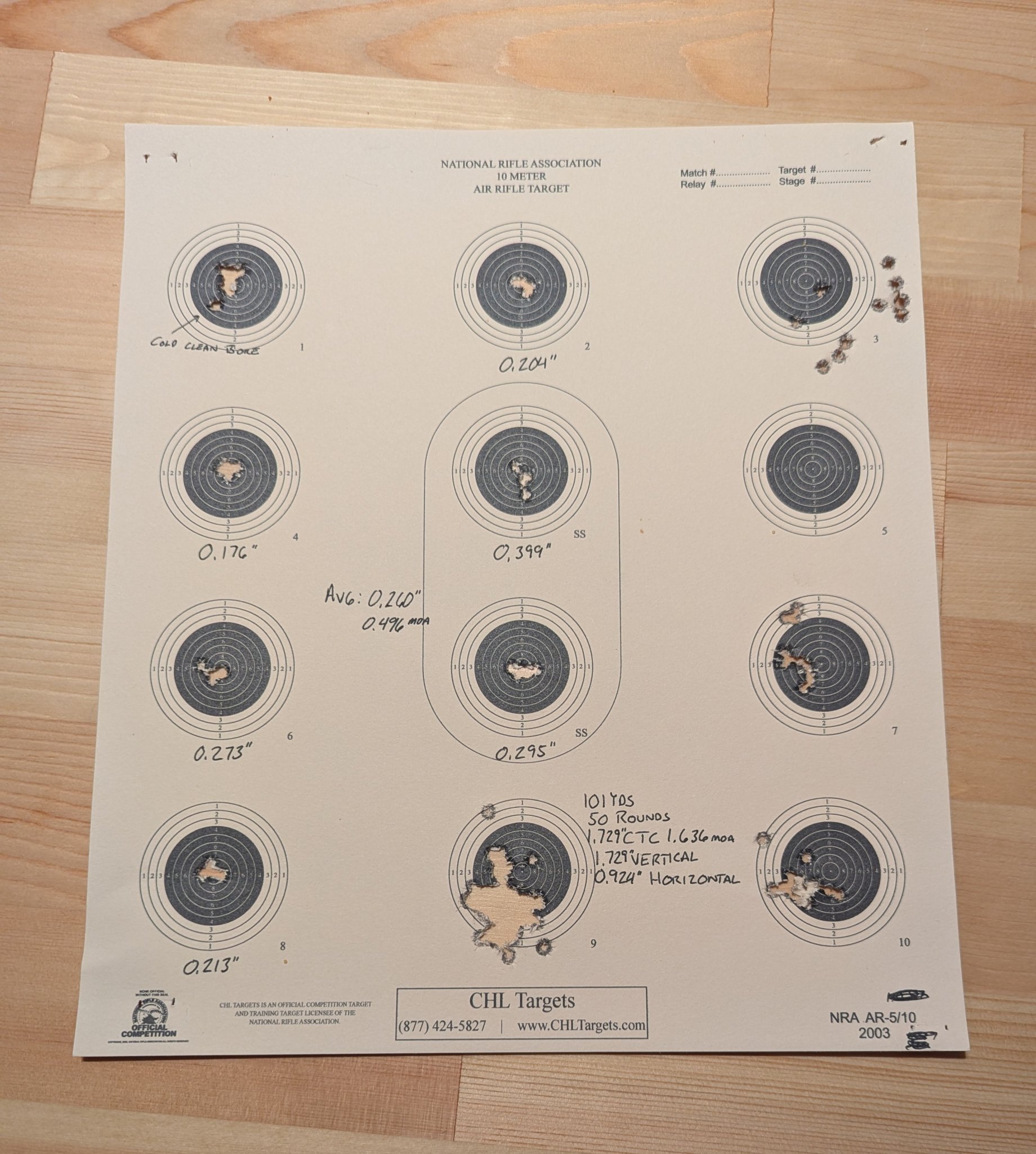

Reading through this thread and got to the end. Did this test happen?
Hey chilly, lead deposits became a problem.
With a freshly cleaned bore, accuracy is similar,
but by the end of a full box of no-lube cartridges
lead deposits are visible (borescope) the length of the bore.
Lubrication is necessary to minimize the accretion of lead
and lengthen the intervals between cleanings.
This was what I expected to see, what was unexpected
was how well the unlubed bullets grouped.
But when you remember that lead can be used as a lubricant also,
it explains why the results from lube/no-lube are similar.
At least from the first box. As the cast bullet shooters pointed out,
lubrication is needed to slow the process of lead deposition.
Eley's blurb of lubricant being for facilitating chambering
was an incomplete statement. It's also needed to slow leading.

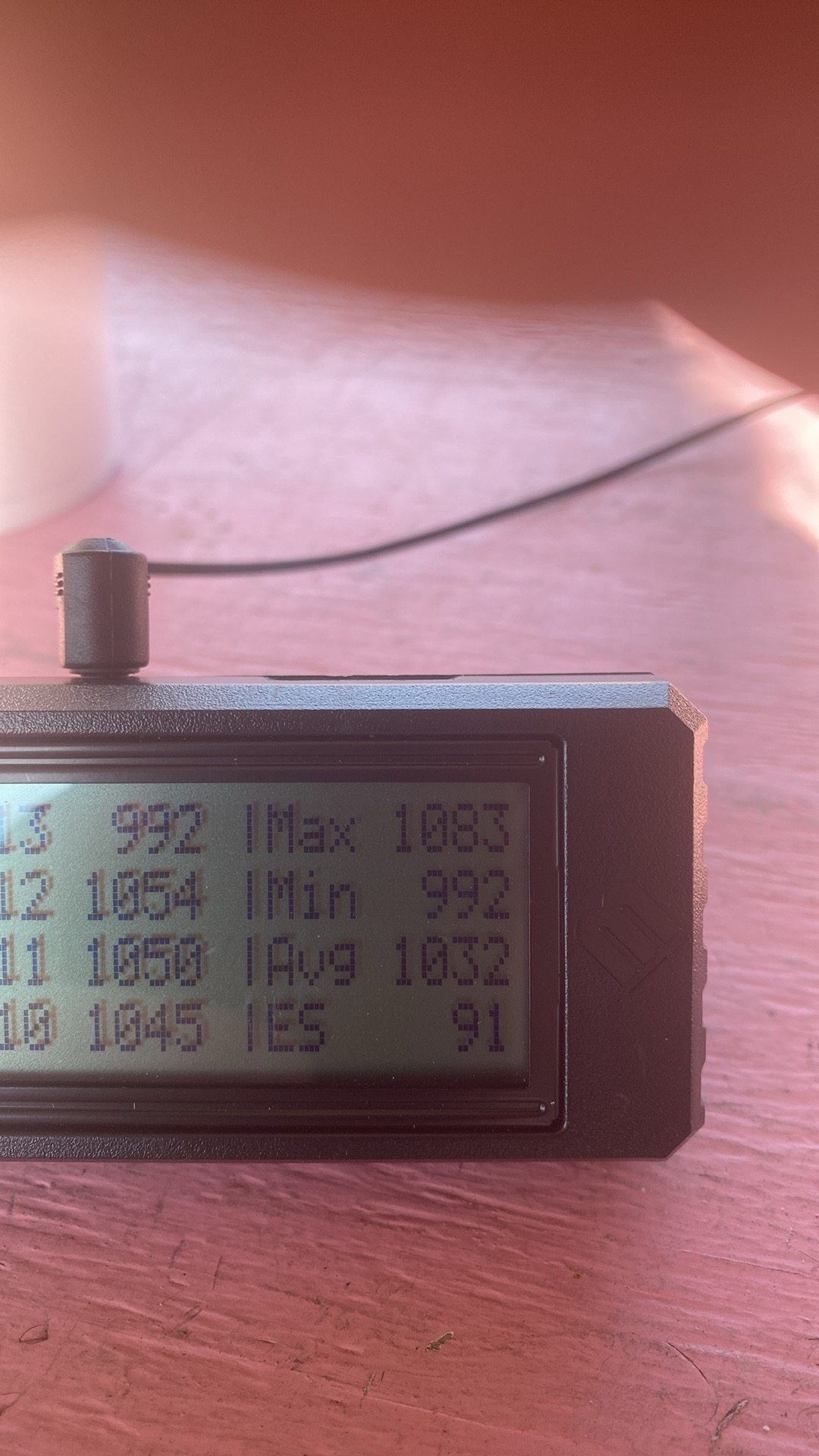

So I went out today testing the Vudoo some more. I shot 5 shots then shot 5-25 across a magentospeed. Upon arrival the chamber was decarboned but had 600ish rounds on the barrel. after some action torque testing, I got that where I wanted. that was done at 50yds. I then moved to 100 for the 50rnd box at 104.4yds. I do believe I called the pulled shot low but cant be certain.
The rifle is an early vudoo 360, MTU 20", ATACR 7-35, TT Diamond, BA comp, Atlas bipod, rear bag. CX ammo.
I had pretty wild ES for CX (im thinking maybe because no carbon ring)?

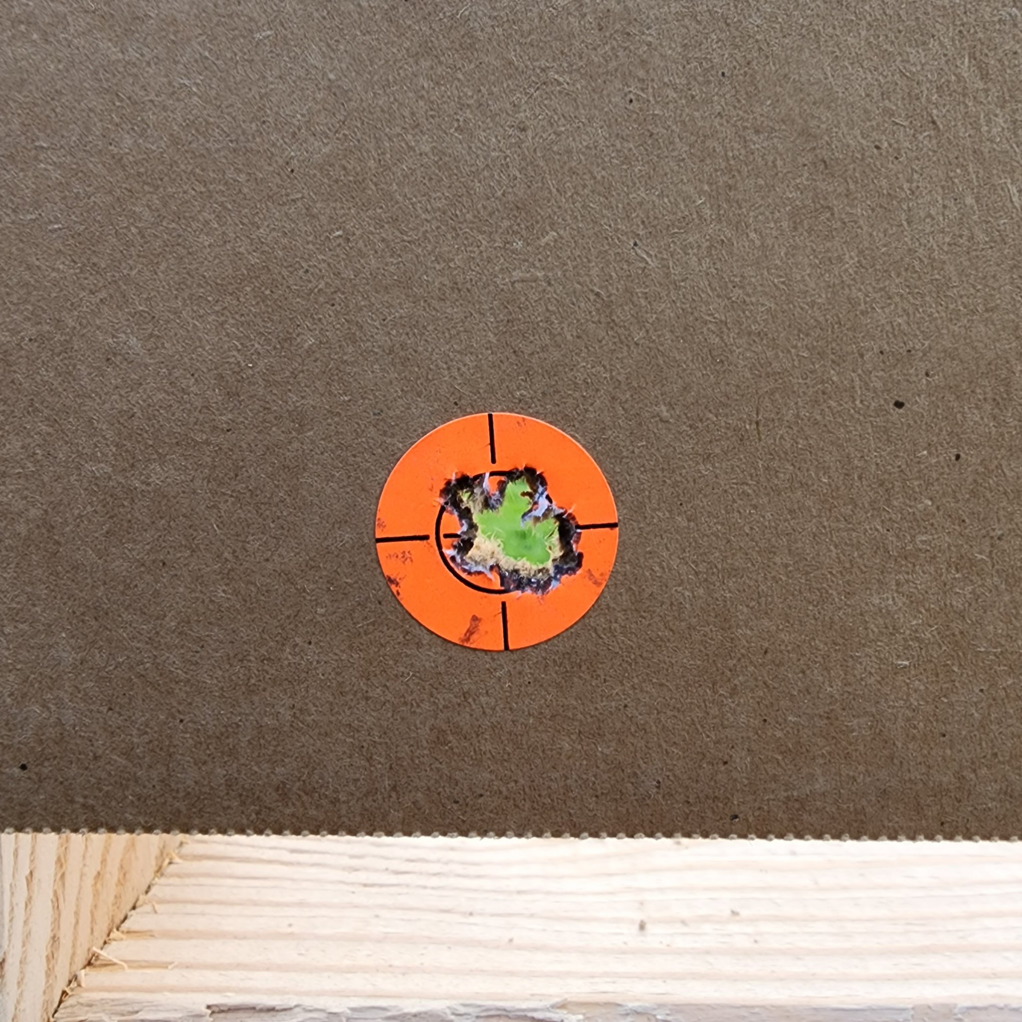

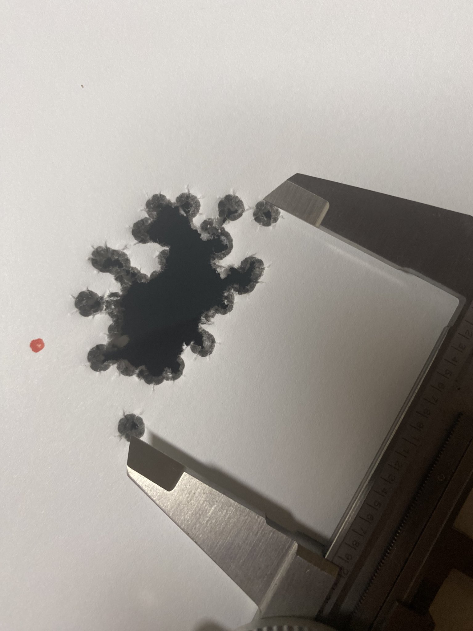

The first time I shot 50 at 100, the results were surprising. Below is the target, with two obvious outliers.
The widest outside-to-outside measurement was 1.709" -- or about 1.5". (Edit: that's about 1.5" center-to-center.)
I've tried 50 at 100 on a couple of other occasions without equalling the results of the first time. That was a lucky box of entry level match ammo, but I must admit I'm reluctant to use the good stuff for this kind of test.
I would expect that most lots of match ammo would have enough outliers in each box that would make 50-round sub-1.5 MOA groups at 100 unusual.

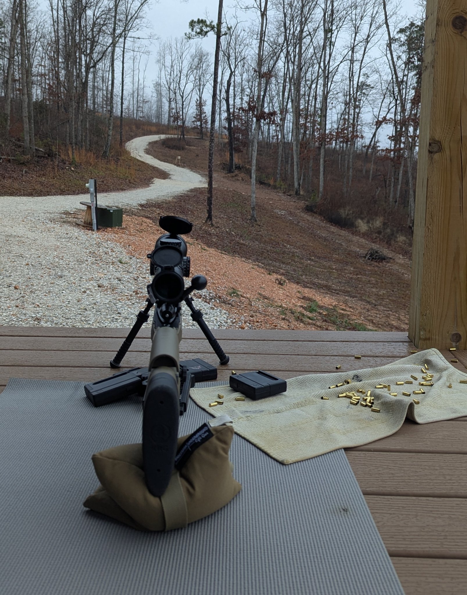

Got out for the first time in a long time to shoot a little. This thread popped into my head when I was confirming data, so I loaded up 5 mags of a random lot of Center X. I certainly left plenty on the table with the target I was using, the resolution of the reticle is crap on this dark target especially in low light. But here it is none the less.
Conditions were high 40's / low 50's, 2-4 mph wind from 11 O'clock. Shot with a Gen 2 VGW ACE barrel prone and rear bag.
Bottom center target obviously. The vertical is from the wind coming down the hill, but I have no idea about that one high round.

2 moa is not unexpected at 100 yards outdoors, even with wind flags.

I can’t really say for a 50 round string as I have no other data points, however with this rifle I can repeatably hold MOA or slightly less for 10 round groups @ 100 yards. I feel like the majority of the time the group dispersion is horizontal, vertical usually isn’t the factor that opens the group. Obviously this is all wind drift not being correctly accounted for by me. When I shot the 50 round group in question I had a headwind at 11-ish o’clock, I am certain this played a roll in the vertical. In addition to that I had very poor resolution of POA with the dark colored paper & black bull in low light (the fog had just lifted and the sun was setting) combined with a non-illuminated reticle. I will definitely give it another go soon with a different wind condition & I’ll post it up so we can see what it looks like. I wish I still had my chronograph but I was tired of the big ass Labradar so I sold it and just haven’t purchased a Garmin yet.

It would’ve been interesting to see what the chrony data was for this group.
I don’t have access to Lapua ammo but figured centre X was similar to Eley Match/Tenex, and from what I’d seen from Tenex was a lot less vertical than this group.
It’d be interesting to see if it was ammo, condition, or shooter related (not shit posting).
As you pointed out groups at this distance are usually wider (due to wind) but perhaps the 11 oclock wind was giving you grief.

I recently sold a LR and bought a Garmin, only used it a few times but am already in love with it.
So much quicker and easier to setup, and no issues dropping shots. Being able to attach to the rifle is also amazing as you can basically track every shot that you fire.
Eley Match/Tenex has a lot less vertical in all my testing. But oddly enough, has more horizontal, like the wind affects it more or something. I don't know why.
