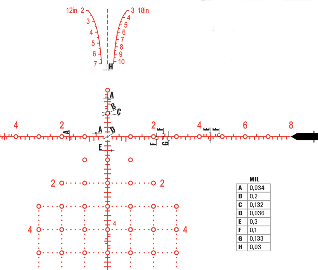

Thinking out loud, a reticle for the OEM crew
Plot didn't come out super clean, but here's a first go at it.
Not trying to be a dick here - but this is the reticle we are trying to avoid. Lines above, lines through, lots of numbers, busy(er) tree. We want simple, straight forward for new shooters. If I have to re-adjust my eyes when looking at a reticle to understand it, its too much stuff. I think the lines above and through make me do this. If you have had a couple years behind fist focal plane reticles this reticle becomes easier. Think day 1 shooters and get them to intuitively understand the reticle and be able to see thier misses. Just my 2 cents
JMHO, but I think the circle would be helpful as a cross over scope, when hunting on lower mag.
I think the lower cost scopes would do well to also allow a bit of cross over. Since most getting into this sport (generally) are trying to have gear that is dual purpose. But that's just my thought...
I like the circle. I'll say this - I am in the market for a new optic and if any one of several brands I looked at used this instead of the current options they offer, they would have my money in hand already. That's everything from entry level to high(ish) end German stuff...
It grinds my gears to no end that optics makers seem to think everyone who isn't in the market for competition optic wants some crappy BDC variant or a standard #4.
Today it only takes a few loud voices to ruin something
so rather than have it, better to just remove it
I'd really not like for that to be the case here - the reticles that @Jack Master showed look great, and for an entry-level optic, would likely see a lot of use, especially as a capable FFP option for new and relatively experienced shooters alike. Having one of these on a hunting gun would be a great thing. I get the "not wanting to have a few loud voices ruin something", but, if it's your product and you stand behind the design intent and the context, let people get angry, especially if the product works and you can justify its existence.
There's a certain song that goes "It's alright now, I've learned my lesson well; you can't please everyone, so you've got to please yourself". Perhaps that's applicable here?
I totally agree here; why on earth optics makers still think that BDC is preferable is totally beyond me. I forsee this changing in the next 5-10 years though as more people begin to understand just how magically useful and adaptable angular units of measure-based reticles are (go figure). I mean, technically BDC values are angular subtensions as well... but how many of us actually go to the trouble of figuring out the differences in MIL/MOA on a BDC reticle?
Of the three reticle choices, I think that the circle and point designs are the most applicable, with the circle likely being the best for newer shooters... Sounds like @Jack Master conducted a test with a limited sample from the applicable user group... and the circle is preferred by all; that is a statistically significant event, in that 8/8 = 1, which equals 100% of the respondent group. That is pretty convincing evidence that the circle is the right design, at least so far...

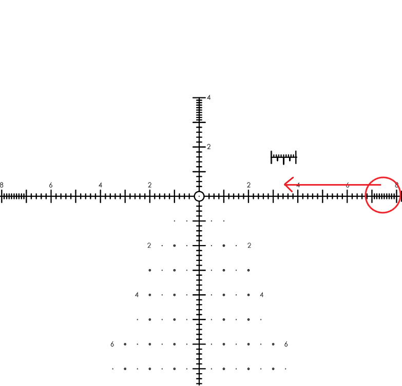

Leave the circle please. The small center dot without the circle or a fair amount of open space around it gets lost at low power. Many people use a scope at lower power. Personally I’ve commented that many of today’s reticles do not work well at lower power. Now, do not twist that and claim I said they don’t work at lower power. They do, just not as well due to the FFP issues and the compromises the manufacturers have to make. Ila made a solid point in noting roughly what power the reticles posted represent. One should learn from that.
The idea was to have a fairly simple, but useful reticle. Something that a new shooter can use relatively quickly and learn without getting lost or frustrated.
But then again, what isn’t good about this? Tell me what shot either in competition or otherwise that you would not be able to make with this reticle over another one?
We know that in today’s world there’s a lot of good enough scopes mechanically and glass wise. The main interface, the reticle should appeal to the shooter to their uses. Some people still use a reticle to range targets, some people think that’s useless and don’t. I don’t care what you do, but the reticle needs to be capable.
My hat is off to Frank, Jack and Ila. Ignore the people with no useful commentary and drive on with those who actually bothered to read the thread and understand what your attempting to accomplish.
Reactions: ZG47A and jbrand11

  • Bold outer lines (0.4 mil thick) that start at 6 mil from center. This helps bracket when using low magnifications. For reference, outer bold line of my SKMR3 are 0.3 mil thick, gen 2 mildot are 0.75 mil thick. I think having the bold outer lines on top as well as right and left are important for newer shooters, which are also presumably new to using a FFP reticle, but as I mentioned likely have hunted with or used SFP optics. The typical complaint is that "I cant' see the reticle". An open top and/or moving the outer bold lines to 10+ mils out from the center will make it more difficult on the newer shooter IMO.
  • Inner reticle is 0.043 thick, which is the thickness of the Mil-XT reticle I had in the 4-16 ATACR. The SKMR3 and EBR-7C that I have are in the 0.035 mil thick range. Similar to the above comment, I think having being little thicker on the inside portions of the reticle would help for a cross-over design and help newer shooters pick-up the center on low mag. In my mind, this type of scope has a max mag of 15x - 18x (maybe 20x)
  • The center floating dot is 0.043 mil. A larger center dot may be a better option. Personally, I think any additional box, circle, quadrant, etc. will be too busy/distracting and also covers up the area that is most important.
  • Having uniform heights for 0.2 mil subtensions will likely require the shooter to count. Whereas varying heights are more intuitive to jump to the correct hold (for me). This has always been the case for me, even as a new shooter.
  • I think dots for the tree instead of lines helps to make the reticle appear less cluttered. I just went with the dimensions that Vortex uses in their EBR-7 series (0.06 mil for 2/10 and 0.09 mil for whole mil). The Vortex tree blends into the background in my Gen 2 Razor, which I like. The 0.2 mil dots could get removed in exchange for 0.5 mil dots.
  • Numbers are easy to remove and I could go either way.

In the end the center circle is a fine aiming point on lower magnifications, its a 0.2 reference at higher magnifications. No one likes it because its not what you are used to seeing. You might have though different on Day 1.
How about Point, but with small dots added where the corners of the Box would be? I would personally prefer thinner lines as well, but understand that would not have the widest appeal. Just another data point for consideration. I'm probably not buying cheap scopes anymore, but wish I had this option when I was buying them.

I think if you what a basic ranging function it needs to fit the target scopes.
The 1/10 mils finish 8 mils out from the optical center, now are all cheaper scopes even going to have this much FOV around 25 power?
Secondly being cheaper, image quality could be an issue the further out from the optical center you go so putting fine detail out there could just be a waste of time if there is any sort of optical aberration.
Maybe move it closer in and also simplify one side of the 1/10 mils to 1/2 and 1/4.

I understand what you want and why you want it there.
Here are my questions (Honest Questions)
1. Who is actively using a milling for ranging? I mean seriously using it, not "double checking" but is the primary ranging system.
2. Since the the proliferation of laser rangefinders in the last 20 years, why wouldn't you use a rangefinder? What forced you into milling? (okay maybe a battery failure but this is once in a blue moon and you have to range at the edge of the glass.) 2 is 1 and 1 is none. Have extra batteries.
3. Do you range mil things as an active use? Or is it an exercise to be an exercise and practice a legacy skill that is no longer used?
4. For a brand new shooter (imagine your 3rd best friend's wife's sister) on thier first day of shooting, does this complicate the reticle for them?
The ease of this reticle is a massive draw for new shooters. The symmetry. The optical balance. The easy repeating patterns. Its not meant to be for the guy that has used a milling reticle for 5 or 10 years.
Again, I understand why YOU want it, but do the majority of modern day shooters use it? Not all reticles NEED to be military grade.
Its important to ask this questions and to honestly answer them.
Its like cutting off the ends of a ham to cook it in the oven. Your Great grandmother did it so your grandmother did it, so your mom did it, so you do it because its about a "better flavor". But the only reason it was done in the first place was to fit the dam ham in the tiny pans and ovens in 1910. We have big ovens and pans now and no longer need to cut the ends of the ham off.
I'm open to moving it. I just need a really good reason to move it that relates to new shooters on a basic level.
