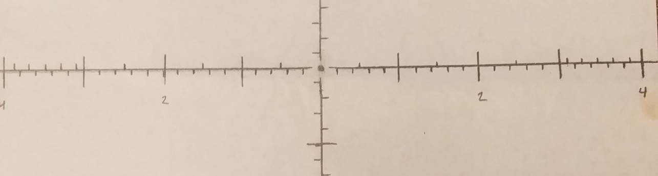

This is better IMHO on the horizontaltal wind hold, don't make newbies count all all the way across very fine lines
This style would break it up justa little like and no worries just better design...
Problem with wind is you need to sometimes adjust spontaneously wind hold while looking thru the glass..
On the Y axis I see less need because newbies can dial and count before the shot for dope since its off a chart
Just my $0.02

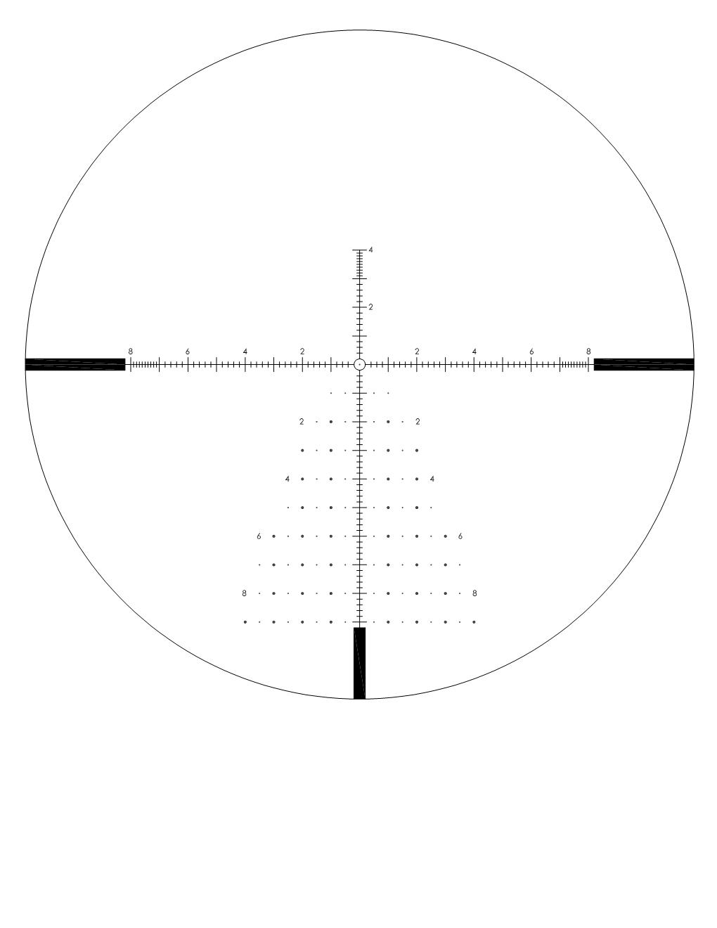

I think a reticle that goes 3 Mils above horizontal is nice and I really like an applicable Ranging System like what is on the Zero Compromise line that allows to quickly range shoulder length. Xmas Tree is okay as long as it starts narrow (not as much need at closer ranges) but pushes out wide in the higher MILs.
Just my thoughts... I love the floating dot, or open area.. don't like floating T...
Just me but since this reticle design discussion is aimed to the new shooter (to quote Jack....imagine your 3rd best friend's wife's sister), personally I think emulating the ZCO MPCT3 would be a move in the wrong direction.

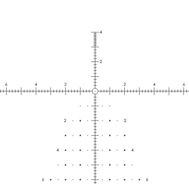

So after talking with frank and having a quick design meeting this is where we ended up. We added 2 small wind dots at the 1 mil holdover. This tree will handle most centerfire cartridge wind calls up to 20ish mph winds but still keep the reticle cleared up around the center aiming point.
We also kept the center circle. It draws the eye to it quickly as well as gives a defined 0.2 aiming cross to the right and the left of the center dot. It will also make the reticle easier to use on lower powers.
This reticle design is intended for newer shooters. We need something simple without the bells, whistles, and whizzbangs. I think we are getting there.
I would definitely put a scope with that reticle on one of my rifles. Love the reticle design.

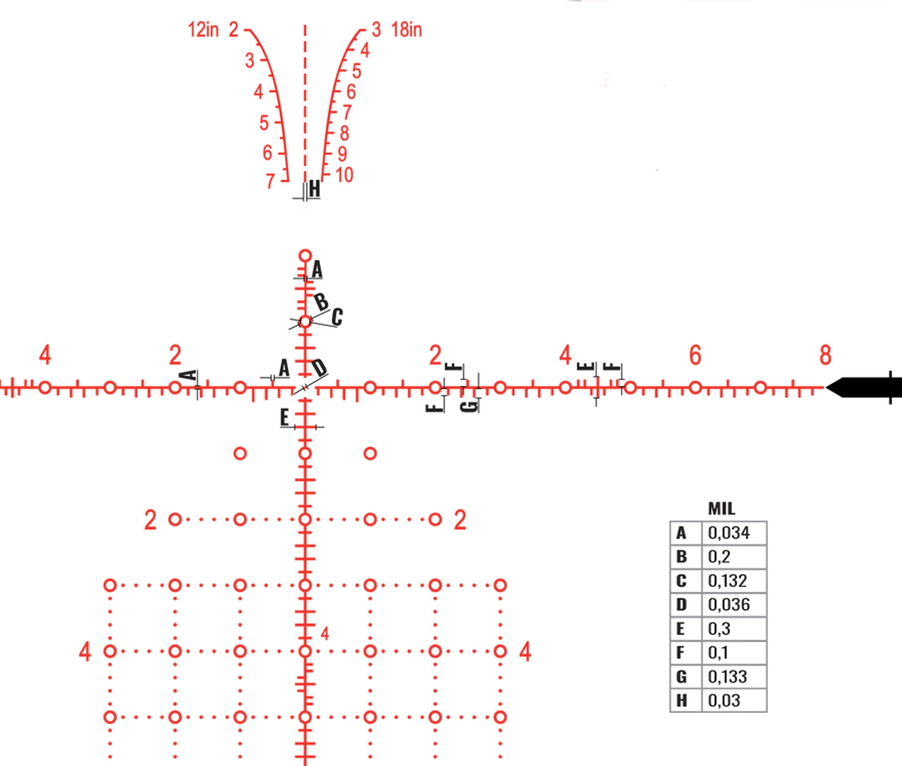

This is a good simple reticle except for those huge numbers which are ridiculous. I'd rather have their FML instead even though it only has holds to 5 mil. I do like the tapering bar on low mag in the FML1.
I wish Ilya's FML-TR1 tree reticle was available back when I bought my FX 5-40x56!
Mentioning also that the mil reticle in my old IOR 6-24 FFP was IMHO too thick. Sure it'd be better suited when using low mag because of the line thickness but I learned I liked mid to high mag in a 24x scope. The few times I was dialed down to 6 power was when I was shooting through the chrono.
In a medium magnification FFP mil scope like a 3-18 and 4-16 a line thickness of .06-.07 is about right because most would assume a guy buys these kind of scopes to use on lower mag otherwise they might as well have bought a scope with higher magnification.

So, after looking that the Riton, Arken, et al, recently I really dislike some of the reticles they use.
I get asked by the OEMs all the time about a SH reticle and normally the thinking is, nah, I don’t want my stuff in low cost scopes, but then after mulling over it for a few days I was thinking, what if, we helped them early and they didn’t have to sweat a reticle
I am thinking a simplistic hold over, well laid out, I have a plan, but not overly complec, no trying to reinvent the wheel.
I know what it should like like, do you think they it would be something along with a minor fee, no Horus $400, more like $50 and call it good
If you think about it further, when IOR used Scott to design a reticle on here it‘s all those years ago, it’s still used today, this site did a floating dot before any other scope outside the few benchrest versions with a dot.

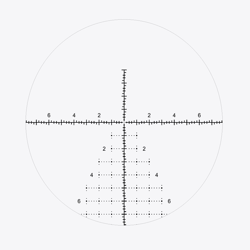

@lowlight the reticle on the 3-24x56 Riton is a little bit different. They have another reticle on the X5 5-25x50 and X7 4-32x56 that I like better. Simpler. Has some varying in the placement of each .2 mark to help getting lost in the .4-.6 holds.
Why does my brain and eyeballs hurt when looking at this reticle? This is the complicated stuff we are trying to avoid.
1/2 lines below, center, center, 1/2 line above... I'm dizzy from just figuring that out.
Its like my brain and eyes are out of focus when I look at it.
.2, .4, .6, .8 mils. I like it. I have a ZP5 MR4 also and while I love that scope when I'm trying to make a .4 or .6 mil wind hold I get lost in the reticle and take too much time to discern which is .4 and which is .6.
Like any reticle, it takes some getting used to, and also like any reticle, you won't build one that EVERYONE thinks is perfect.
I was mainly pointing out Riton had other reticle options beside the one on the 3-24x56 that Frank tested.
Glad that I'm not the only one - it's like climbing a ladder with your eyes for every .2Mil increment, but in a saw wave pattern which makes the pattern very busy to my eyes...

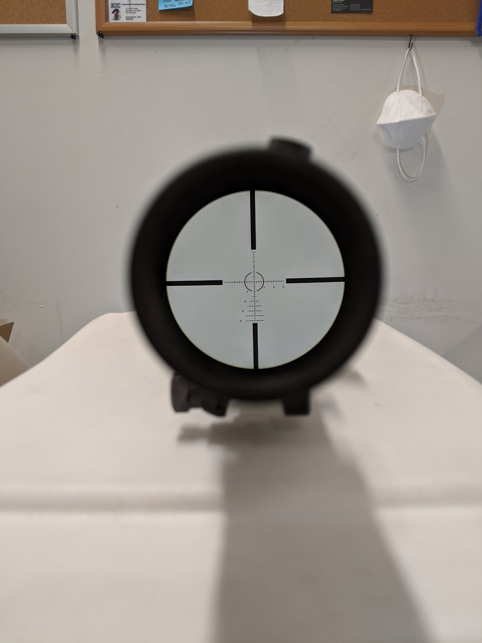

Couple of comments for testing reticles for real-world use:
First, if its designed or shooting @~12x on a 3-15 style optic, has anyone tested images at BOTH 100% and at 33% in image viewer to ensure the lower power really "works"? I found this is a worthwhile exercise.
Second, test the image against a low-contrast background. Ie, something where the target is actually difficult to pick out. Try to use images from something designed to avoid detection not enhance it (like a target with high-vis contrast)...alot of the hunting gear sites have good pictures for this exercise.
...not how different a reticle looks overlayed onto this kinf of background than a plain white or grey or blue etc backgrond...and then check both high and low power to see if one completely disasppears or is still useful.
This is much better conditions for testing an optic that will be used for crossover / or field use IMHO.
