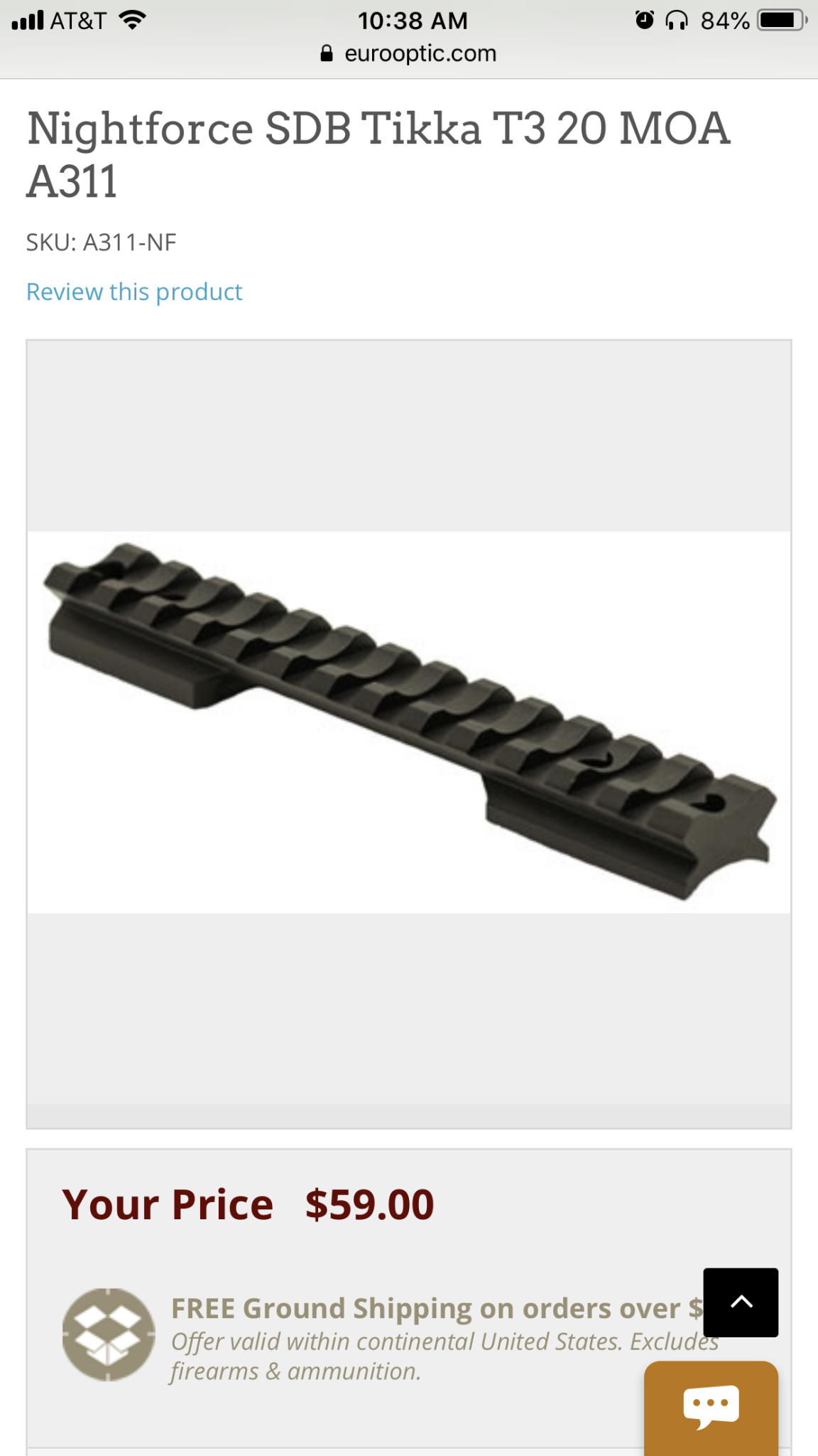

Anyone know if the T1X will accept T3 top rails? EuroOptic is sold out of the Contessa 20moa rail, but they have the Nightforce T3 20moa rail in stock.

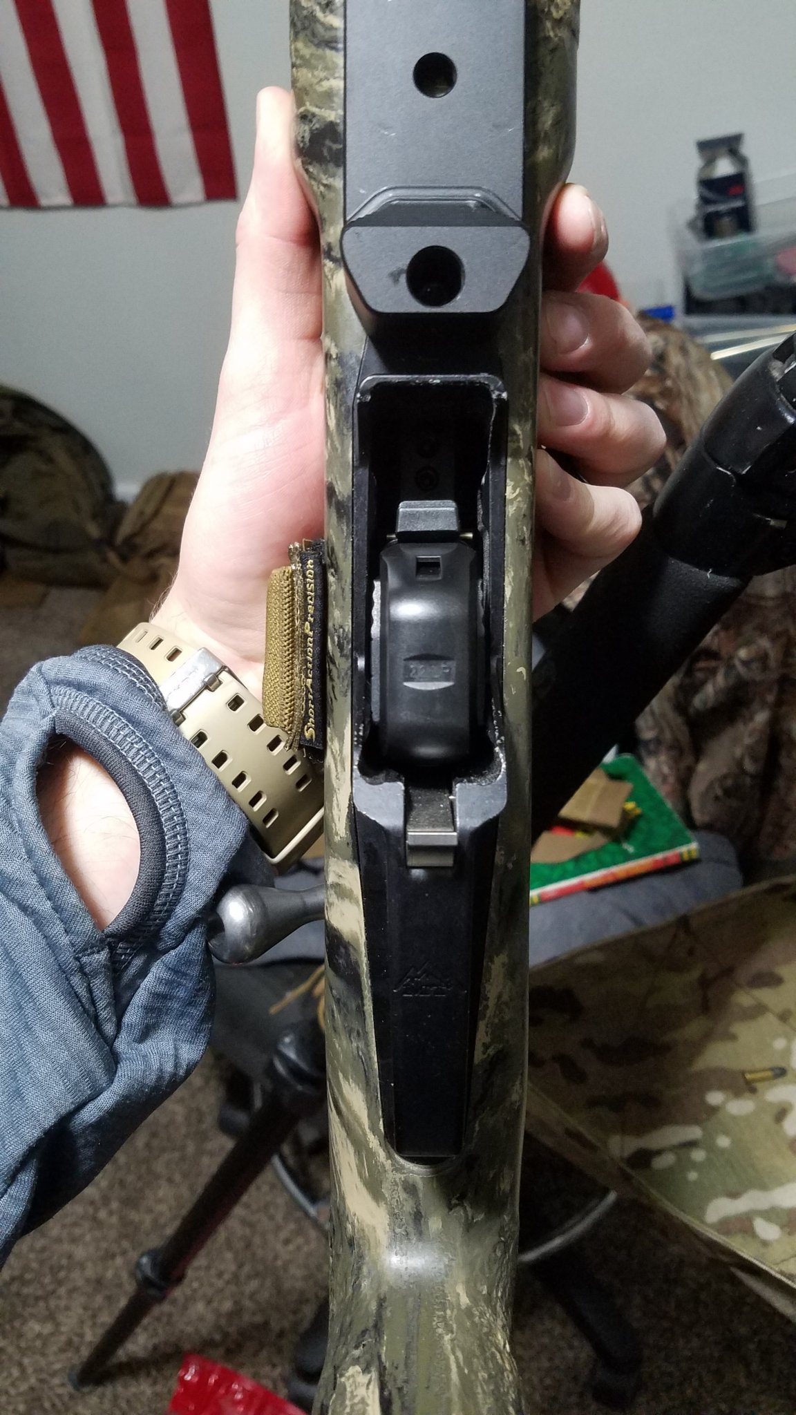

For data sake if it helps anyone narrow down what is causing the ejection issues, my T1X was dropped into a T3X CTR stock.
Has anyone found another pic rail that fits? I waited too long and EuroOptic is sold out of both the 0moa and 20moa contessa rails.

DIP industries. 0moa in stock 25moa back ordered. High quality.

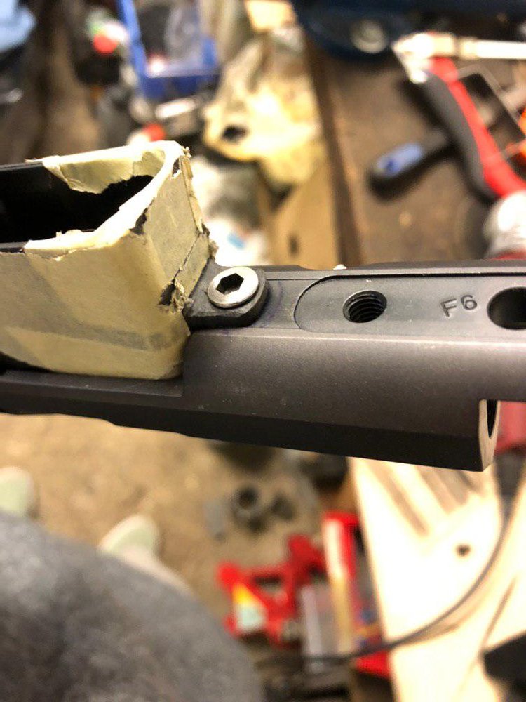

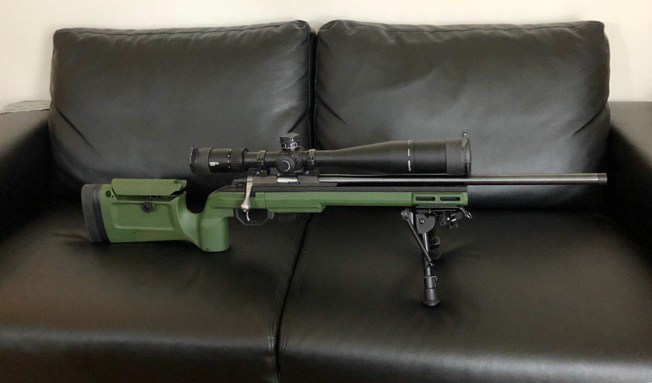

Didn't want to wait ages for actual T1x Bravo so decided to fit it in T3 version. Thanks skinnj1 for the description of what has to be done.
Ordered the stock in January and finally got it after two months (yes, sometimes it's hard to get US stuff in Europe :) ).
After the research I found that there are basically two (or more) ways of fitting it in:
  1. Mill enough metal from the aluminum frame where trigger guard gets attached.
  2. Completely cut "bridge" that holds trigger guard, shorten the trigger guard and use metal/plastic insertion to the rail to hold a trigger guard in. Like guns_not_groceries posted: https://www.snipershide.com/shooting/threads/tikka-t1x.6841183/post-7530623
    Instead of an aluminum I 3D printed it from ABS plastic.
I decided to try the first method and then go to second if it won't work.

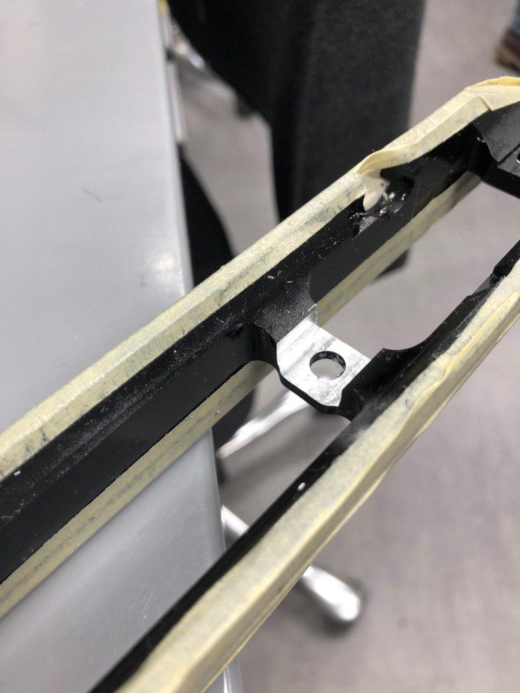

First I used a file to make the magwell attachment point a bit thinner, because I was afraid that there is not enough metal on the frame to fit it as it was. Originally it was 4mm thick and I sanded it to 3mm. (Please do this on your own risk, because plastic is kind of a fragile part and hard to fix after it got broken).
(I also made it shorter, which isn't really needed).
7041621

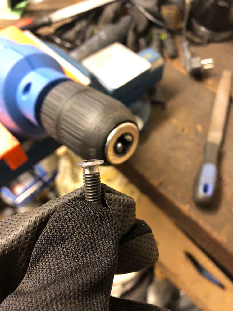

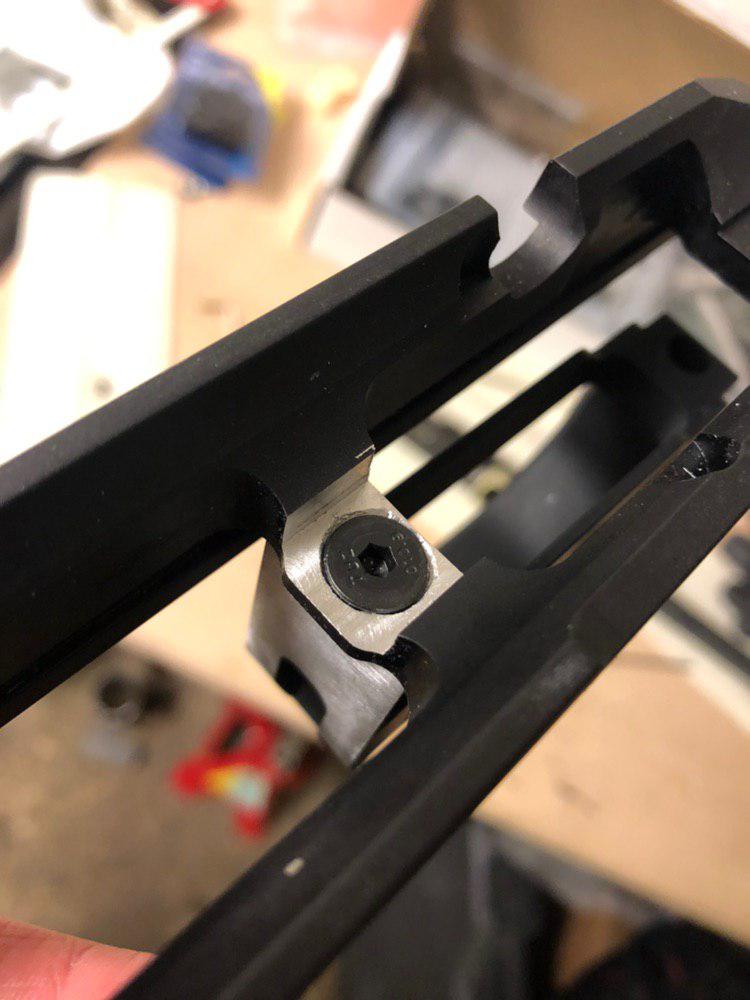

The second problem is a 6mm screw with a huge head. I replaced it with a flat countersunk from which I removed cone using a drill + angle grinder.
7041626

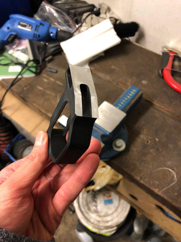

Trigger guard. I ground it like in guns_not_groceries post.
7041630

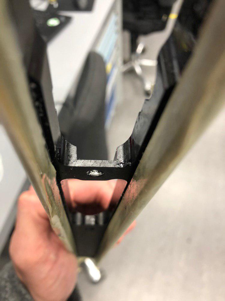

And the last thing, aluminum backbone. This was the main problem that bothered me, because I din't have any friend with a milling machine and machine shop could ask the price of an actual stock for this small job.
Luckily I found a milling machine in a local library workshop and here is the result:
70416347041635
The original trigger guard screw is way too big to fit even after filing, so I went with 5mm flat countersunk:
7041636

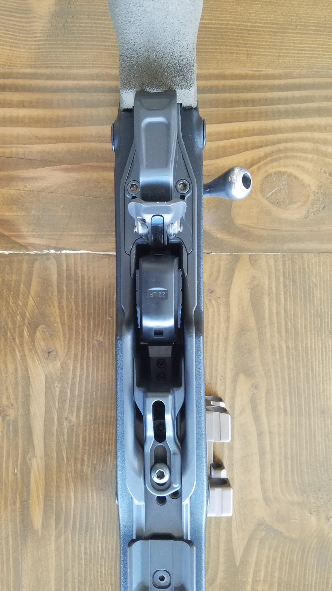

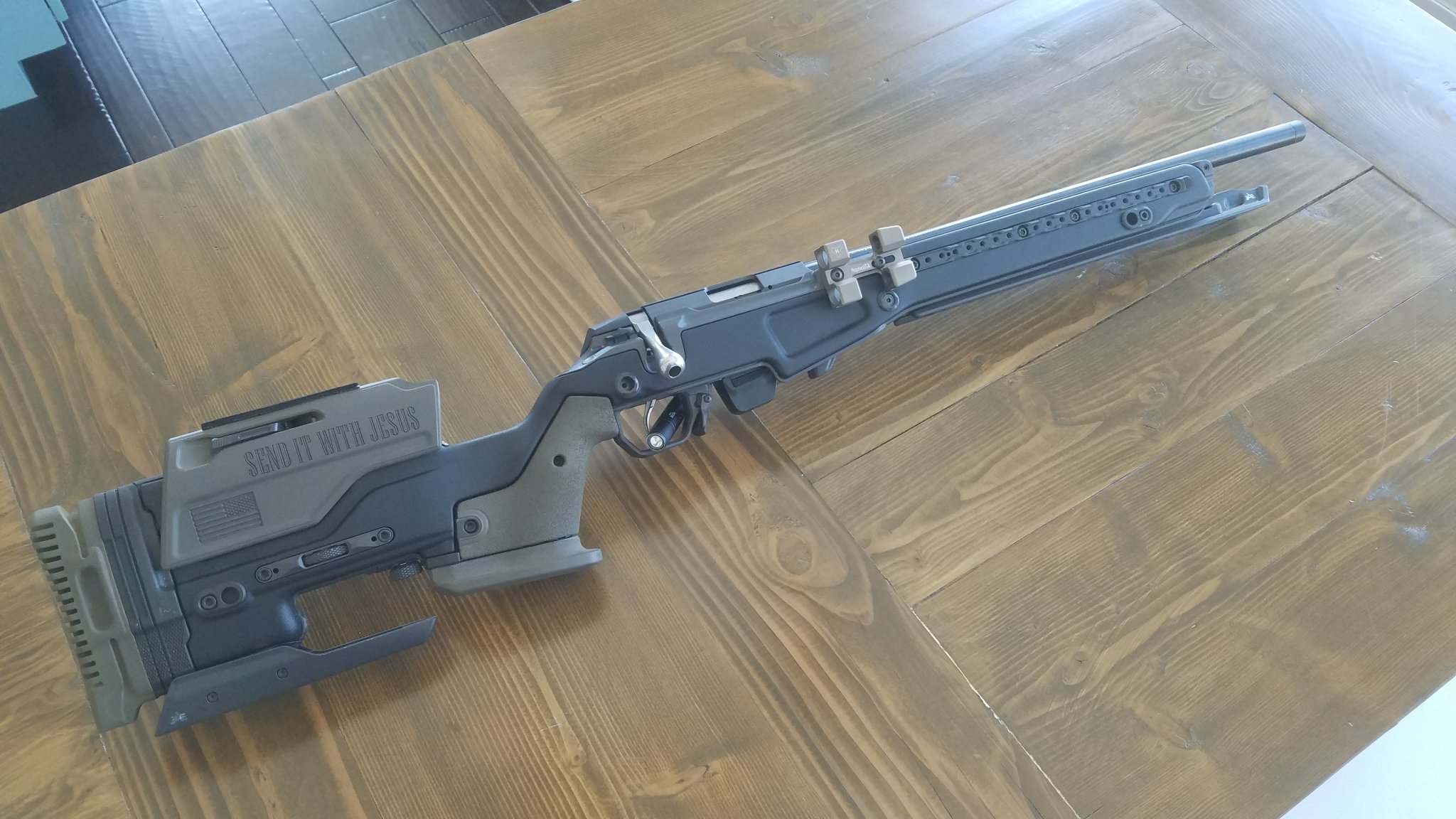

T1X fits into the J Allen. Action is a bit tight but I got it seated and torqued. The action screws are going to require some additional shims to get it to cycle at 65inlbs. Mag ctach/release is easy to reach and mags drop/insert with ease. I will report back once I get the extra shims!
7044638
7044639

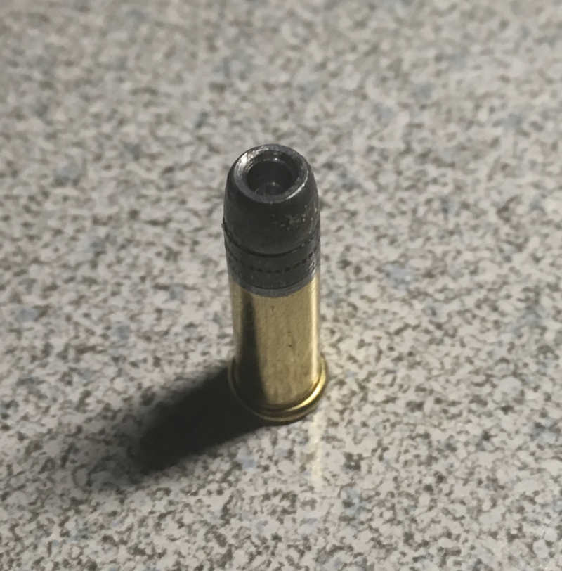

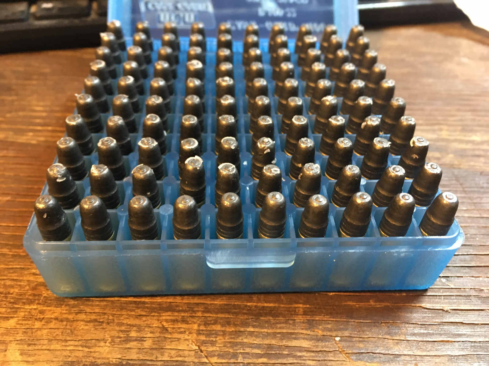

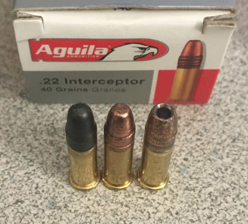

No time for it right now, as I have too many other rimfire projects, but I want to test the efficiency of hollow-points made from a Aguila 22 Interceptor which are 40 grain and rated at 1,470 FPS. It deformed the copper wash, but that shoun't have any negative effect. Left to right - CCI SV (unmodified), Aguila Interceptor (unmodified), Aguila Interceptor resized with an overly large hollow point:
7044827
A CCI SV taken to the extreme:
7044938
When you take it this far, it won't feed reliably from a magazine. But it's fine for my Thompson/Center Encore single shot or revolvers. I want to (eventually) make some gelatin blocks to see how the 22LR hollow-points behave.
That one definitely looks good. This is where I'm at with the reformed ammo. I did the CCI Quiet for my Sako Quad with the intent of using that rifle specifically with quiet ammo. There were two reformed bullets with my die so I tried to get the flat top as close to the one sent as I could. This might be a tiny bit flatter.
I didn't go too crazy with the HP.
Flat top with the SV.
Less of a HP with these one's I'm testing.
Just for the heck of it I thought I would try a flat top HP combo.
I'll also be doing some tests with rim sorted ammo to see if there is a difference. It will most likely eliminate the flyers.
