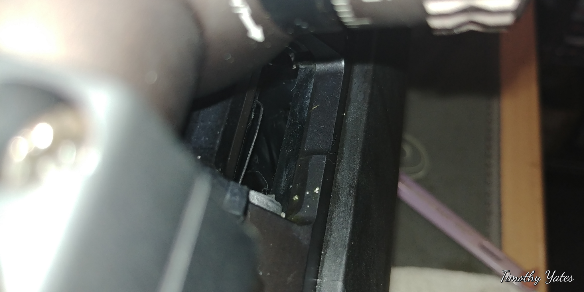

All the ammo I tested last week was for naught. I incorrectly mounted the action/barrel in the Bravo stock and apparently had the recoil lug on top of/next to the receiving hole for lug as the barrel was canted upward a a pretty fair angle in relation to the stock. I was wondering why my POI had changed up 1 MIL. Likely effected the grouping I would imagine since there was some pressure on the barrel itself. Back to the drawing board. ?

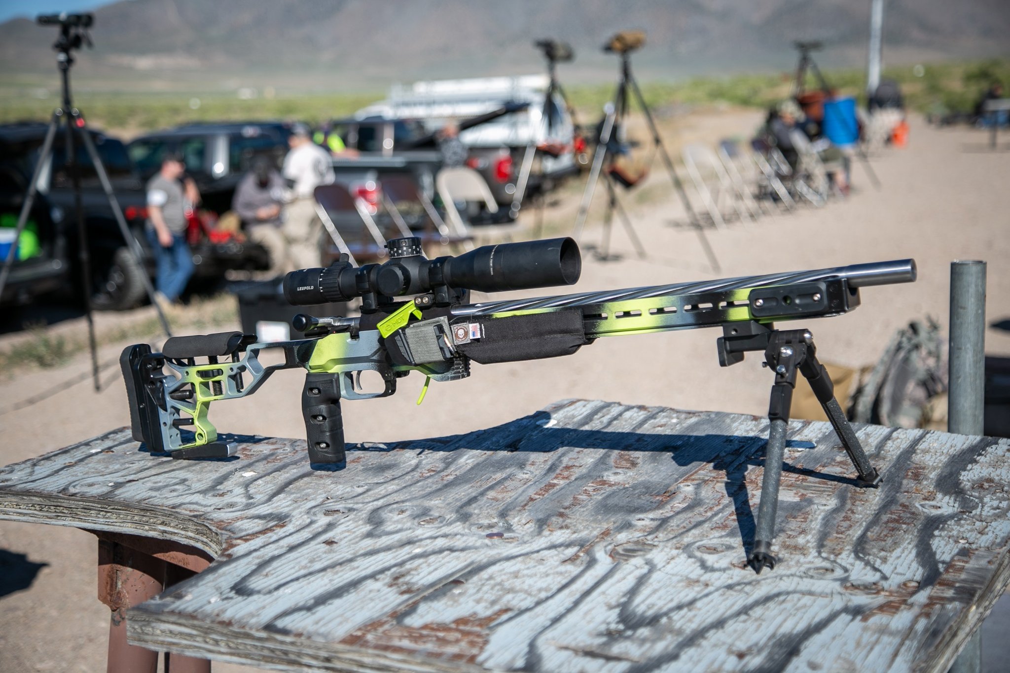

I put both my rifles in a KRG Bravo. I was actually so impressed with the T1x and Bravo I sold one of my other rifles and bought a Tikka T3x CTR and put it in a Bravo. I mounted the same optic on both rifles as well so the T1x is a complete smaller version of my 6.5 CTR.

I don't. But it became quit obvious when I had it sitting on a table and I looked over and the barrel was canted up and the chassis was near level. It was obvious to the naked eye. I was in haste when I threw it back together and wasn't paying close enough attention and quite frankly, I'm embarrassed I shot 250 rounds through it w/o noticing it. Even when it told me when it was shooting a MIL high and slightly right. ?
